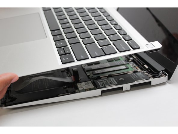

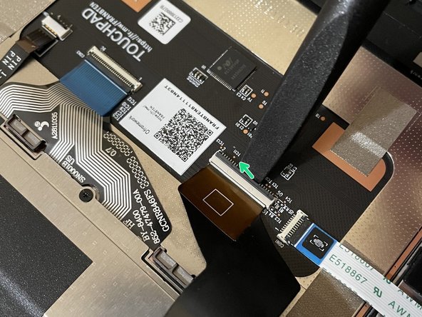

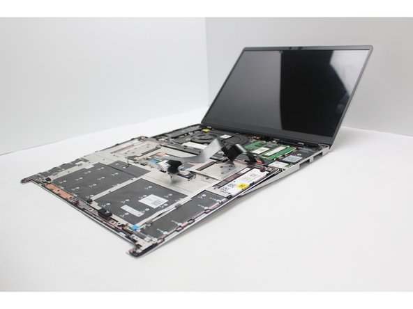

    Important: Pull the Input Cover off carefully as it is still attached to the Mainboard via the Touchpad Cable. You don't need to disconnect this cable to do most repairs. You can just flip the Input Cover over. If you do want to disconnect it though, make sure to disconnect the Mainboard side using the finger loop over the orange label.
    While that’s true for most repairs, it’s pretty much essential to disconnect that cable for this repair, so I think the guide should probably amend this boilerplate!
    Mike Shaver - Resolved on Release Reply
    You should flip the keyboard around the x-axis (so that the back edge comes towards you as you flip) and not the z-axis (resulting in the left edge rotating to the right). I started to do the z-axis and the touchpad cable was getting twisted. I am capable of messing up all instructions. This is my anti-super-power... or joker power in the Wild Cards universe.
    Brian - Resolved on Release Reply

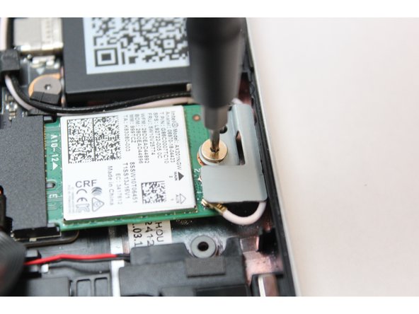

  2. Using the T5 bit in the Framework Screwdriver, unscrew the fastener on the WiFi module. Remove the fastener and gently lift off the WiFi Bracket. Remove the fastener and gently lift off the WiFi Bracket.
    • Using the T5 bit in the Framework Screwdriver, unscrew the fastener on the WiFi module.
    • Remove the fastener and gently lift off the WiFi Bracket.

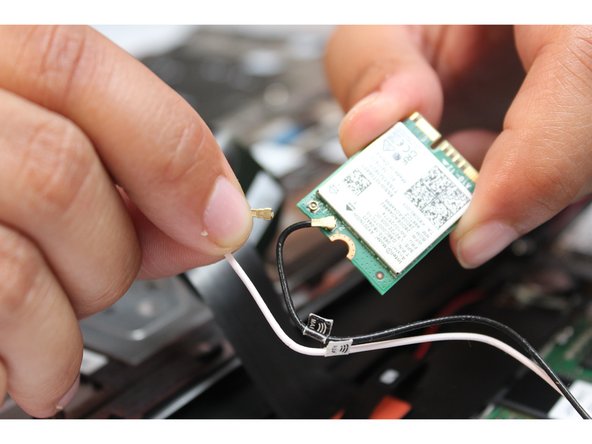

  4. Carefully grip the white antenna cable and using a slight amount of force pull it off the module. Repeat for the black antenna.
    • Carefully grip the white antenna cable and using a slight amount of force pull it off the module.
    • Repeat for the black antenna.

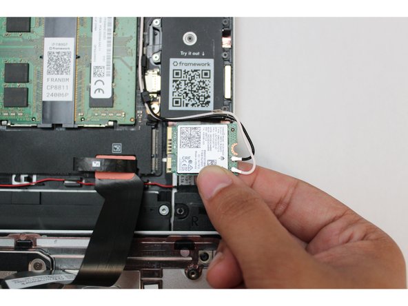

  5. Connect the black and white WiFi Antennas into their respective sockets on the module.  You can see a little triangular indicator on the module's label pointing out which color goes where.  Make sure to align them well before applying force to click them into place, as the connectors are small and fragile. If you need a video overview on this, check this out.
    • Connect the black and white WiFi Antennas into their respective sockets on the module. You can see a little triangular indicator on the module's label pointing out which color goes where. Make sure to align them well before applying force to click them into place, as the connectors are small and fragile.
    • If you need a video overview on this, check this out.
    • Once both the black and white WiFi Antenna cables are connected to the module, make sure they are rotated downwards as indicated in the second picture with the blue arrows.
    • While keeping a finger on top of the antennas to hold them in place, insert the WiFi module into the socket on the Mainboard.

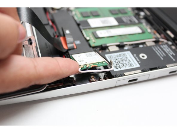

  6. Once the module is properly inserted into the Mainboard, carefully route both the black and white WiFi Antenna cables into the black rubber routers as indicated in the first image. Place both the cables behind the metal structure located near the top right of the WiFi module as well. The antenna cables should not touch the Speaker located below.  Use the spudger end of the Framework Screwdriver to carefully push the white cable away from the Speaker if it is touching it.
    • Once the module is properly inserted into the Mainboard, carefully route both the black and white WiFi Antenna cables into the black rubber routers as indicated in the first image. Place both the cables behind the metal structure located near the top right of the WiFi module as well.
    • The antenna cables should not touch the Speaker located below. Use the spudger end of the Framework Screwdriver to carefully push the white cable away from the Speaker if it is touching it.
    • Place the WiFi Bracket over the WiFi module and place the fastener in the hole. Using the T5 bit in the Framework Screwdriver, screw the fastener into place.
    The space between the edge of the wifi card and the sidewall of the case is very narrow. As such, connecting the antennas to the wifi card AND then keeping them connected while you insert the card and tighten the wifi bracket is extremely tricky (I say this as a fairly experienced PC builder). After 20 tries I gave up (shame, shame) and paid a local PC repair shop to do it--and they struggled with it as well. There is probably a special place in hell waiting for whoever invented NGFF cable connectors.

  7. Before closing up the laptop, make sure that the Touchpad end of the Touchpad Cable is fully seated in the receptacle. The cable should be inserted far enough that the white line almost touches the receptacle.

Please update this guide to include instructions for the newer, plastic fastener. It took me quite a while to understand how to reattach it. You need to ensure the white and black connectors are angled in such a way as to let you slide the fastener over the end of the WiFi module. The attached picture helped me figure it out.
Kent Richards - Open Reply
