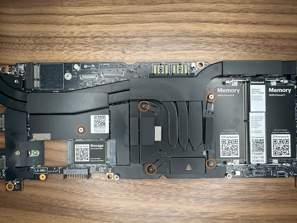

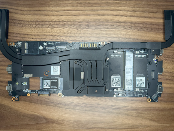

  1. Unscrew CPU Heatsink screws in order as labeled 1-4.
    • Unscrew CPU Heatsink screws in order as labeled 1-4.
    • These screws are captive so you do not need to worry about losing them.
    • Unscrew the 5th screw to the left of the CPU Heatsink on the metal plate.

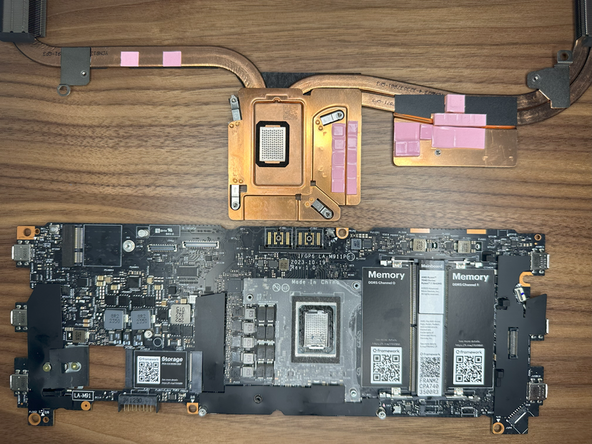

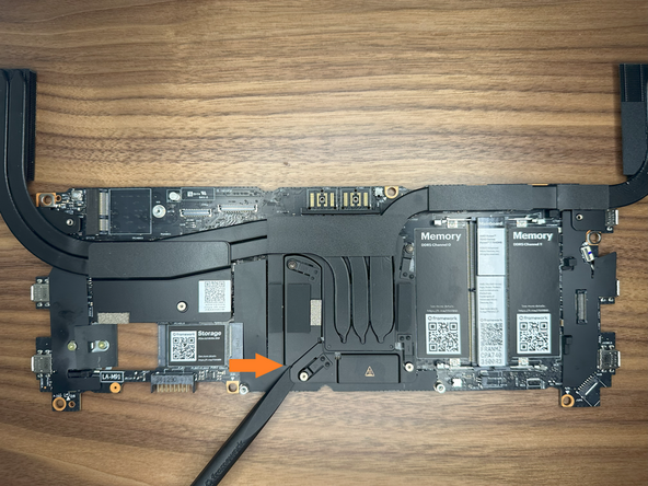

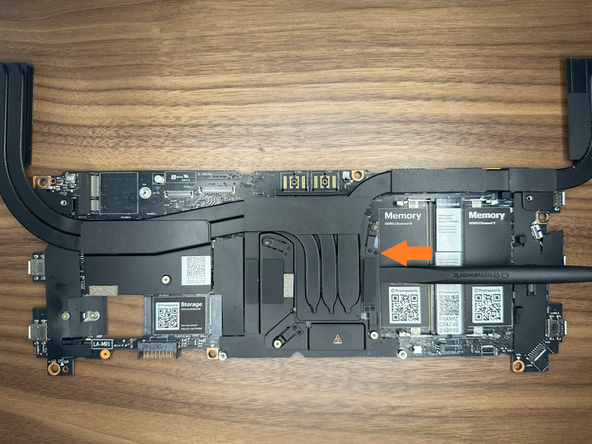

  2. Using the spudger side of the Framework screwdriver, pry the CPU Heatsink away from the mainboard. Work around the sides slowly prying it away. Make sure in this process you do not bend one of the Heatsink pipes when using force.
    • Using the spudger side of the Framework screwdriver, pry the CPU Heatsink away from the mainboard.
    • Work around the sides slowly prying it away.
    • Make sure in this process you do not bend one of the Heatsink pipes when using force.

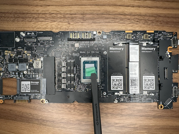

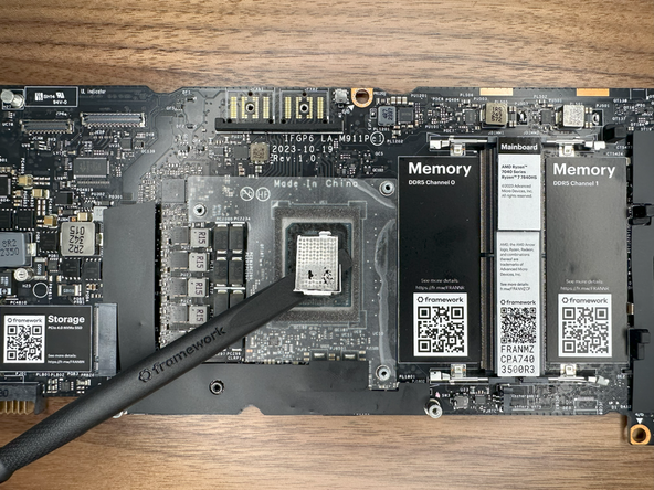

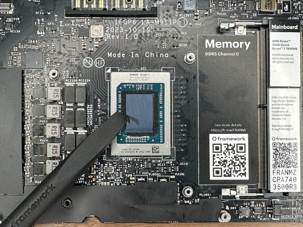

  3. Using the spudger, remove the liquid metal from the CPU die. Once mostly removed use Isopropyl Alcohol to clean the CPU die further and remove any remaining bits of the Liquid Metal. Verify all parts of the Liquid Metal are removed, make sure the CPU die is clean and reflective.
    • Using the spudger, remove the liquid metal from the CPU die.
    • Once mostly removed use Isopropyl Alcohol to clean the CPU die further and remove any remaining bits of the Liquid Metal.
    • Verify all parts of the Liquid Metal are removed, make sure the CPU die is clean and reflective.
    • Make sure there are no remaining parts of Liquid Metal in the system. If parts remain in incorrect spots, it can cause a short in the system.

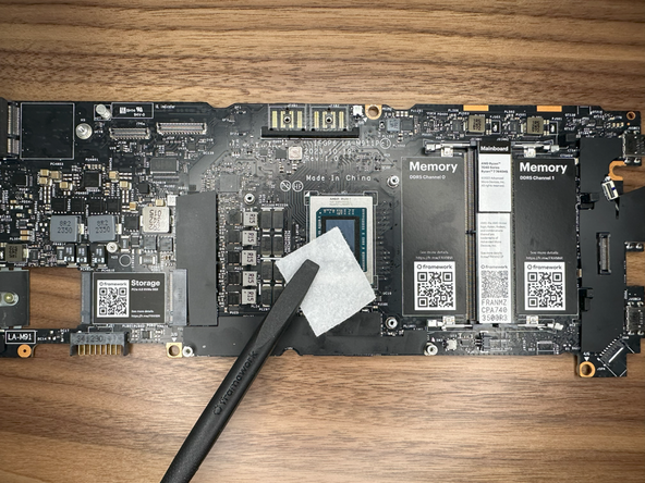

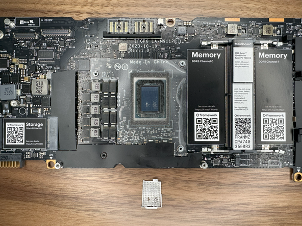

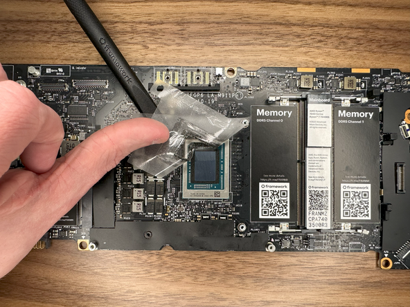

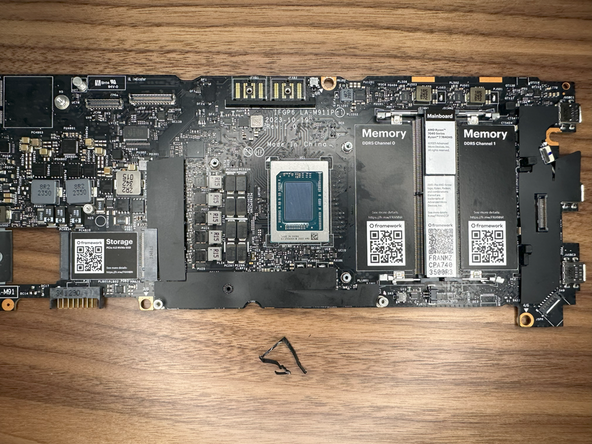

  4. Gently peel away the clear protective tape surrounding the CPU. Remove the black Sponge surrounding the CPU Die. Do a final wipe down with Isopropyl Alcohol to remove any remaining bits of Liquid Metal, Sponge, or Residue.
    • Gently peel away the clear protective tape surrounding the CPU.
    • Remove the black Sponge surrounding the CPU Die.
    • Do a final wipe down with Isopropyl Alcohol to remove any remaining bits of Liquid Metal, Sponge, or Residue.

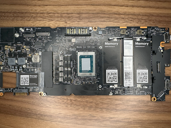

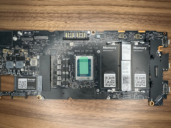

  5. Make sure that your CPU Die and mainboard look like this with the Liquid Metal and Black Sponge removed.
    • Make sure that your CPU Die and mainboard look like this with the Liquid Metal and Black Sponge removed.

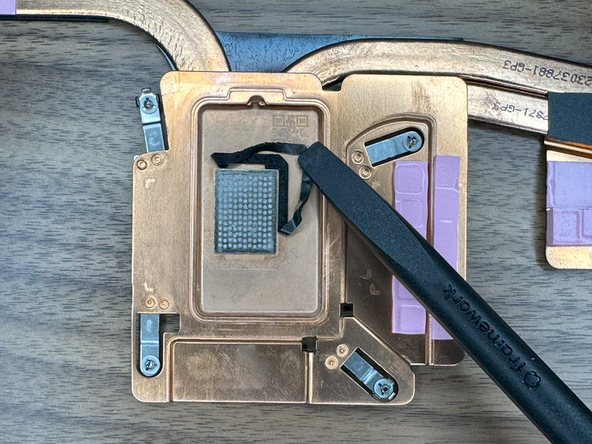

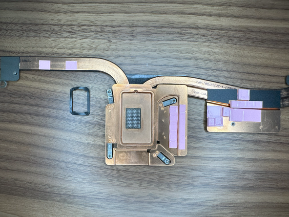

  6. Using the Spudger of the Framework Screwdriver, remove the sponge on the Heatsink. Using the Isopropyl Alcohol, clean off the sponge residue and wipe down the silver honeycomb textured plate. Using the Isopropyl Alcohol, clean off the sponge residue and wipe down the silver honeycomb textured plate.
    • Using the Spudger of the Framework Screwdriver, remove the sponge on the Heatsink.
    • Using the Isopropyl Alcohol, clean off the sponge residue and wipe down the silver honeycomb textured plate.

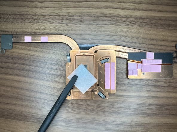

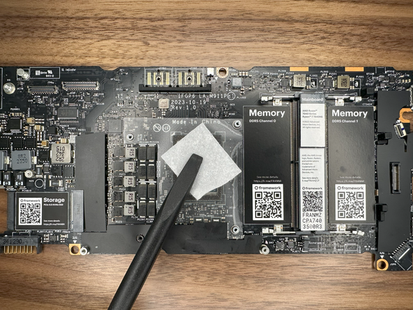

  7. Gently remove the Clear backing on the PTM and apply it to the CPU die. The PTM may be bigger than the CPU die and this is okay. Make sure the PTM is centered and has equal overhang on all sides. With the PTM on the CPU die, gently press against the Green backing; making sure it is applied successfully.
    • Gently remove the Clear backing on the PTM and apply it to the CPU die.
    • The PTM may be bigger than the CPU die and this is okay. Make sure the PTM is centered and has equal overhang on all sides.
    • With the PTM on the CPU die, gently press against the Green backing; making sure it is applied successfully.
    • Gently and slowly remove the Green backing from the PTM.
    • PTM should now be successfully applied to the CPU!
