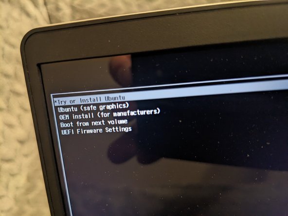

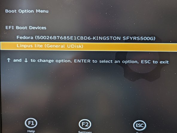

  5. Boot to Live Ubuntu USB:  Insert the USB drive into the powered-off machine, then power it on. If an OS is already installed, immediately begin tapping F12 as soon as the power light comes on. Start tapping before the Framework logo appears.
    • The Live USB will boot to the Desktop then automatically open the installer. Select a Language as well as any needed accessibility options. Then select a keyboard layout.
    • Set up an internet connection. There may be a prompt to update the installer. Do so if connected to the internet. Close the installer, then open it again from the desktop on the lower right corner.

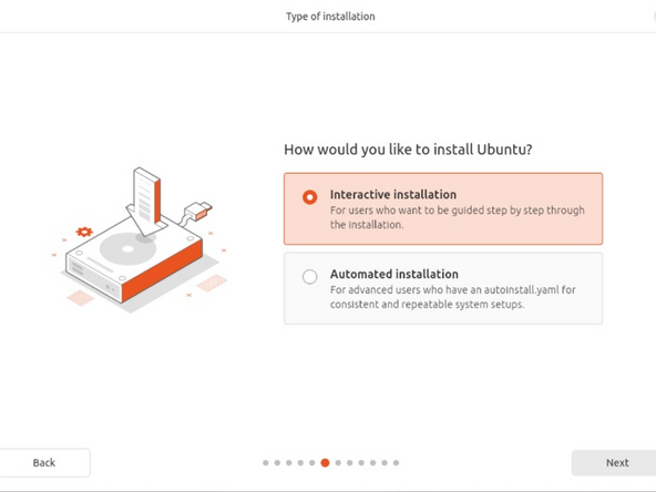

    • If the installer has been updated, open the installer again after it closes to complete the update. Repeat the steps on this page from the start. Then select installation type. This guide follows the Interactive option.

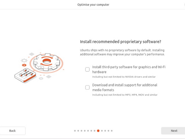

  6. While connected to your network, select Normal installation, Download updates while installing Ubuntu and Install third party software, then press continue. This process may take a few minutes and appear to idle a bit, then the next screen appears - installation type.
    • While connected to your network, select Normal installation, Download updates while installing Ubuntu and Install third party software, then press continue. This process may take a few minutes and appear to idle a bit, then the next screen appears - installation type.

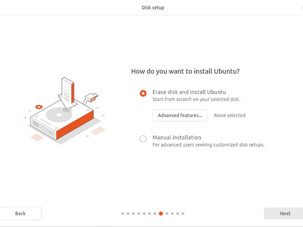

  7. Next we’ll choose the installation type. Erase everything is the correct choice for users with a new Framework Laptop 16 (AMD Ryzen™ 7040 Series) looking to use the entire hard drive for Ubuntu. Press Install Now, then when prompted, then click on Continue. Next you’ll be prompted to choose your location on the world map. Select your time zone location, click Continue.
    • Next we’ll choose the installation type. Erase everything is the correct choice for users with a new Framework Laptop 16 (AMD Ryzen™ 7040 Series) looking to use the entire hard drive for Ubuntu.
    • Press Install Now, then when prompted, then click on Continue.

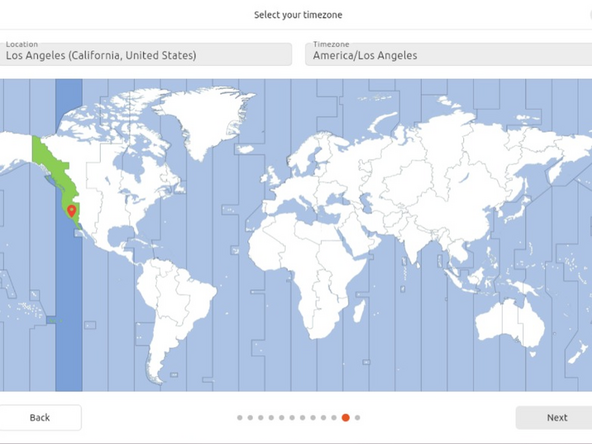

    • Next you’ll be prompted to choose your location on the world map. Select your time zone location, click Continue.

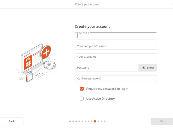

    • Create a username, a computer name (anything will do), and a password to login with. Also make sure you select Require a password to log in. Then press Continue.

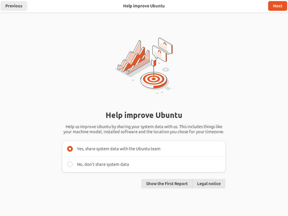

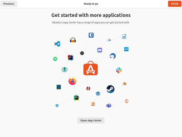

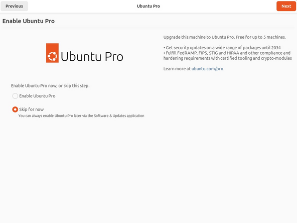

  8. Once rebooted, simply follow the prompts for whether or not you are using Ubuntu Pro and if you wish to send back error reports. Repeat this process with the other screens as seen in the provided images, while making selections and choices that best match your needs. Repeat this process with the other screens as seen in the provided images, while making selections and choices that best match your needs.
    • Once rebooted, simply follow the prompts for whether or not you are using Ubuntu Pro and if you wish to send back error reports.
    • Repeat this process with the other screens as seen in the provided images, while making selections and choices that best match your needs.

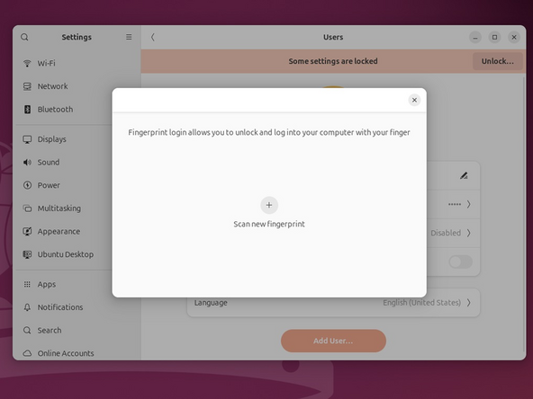

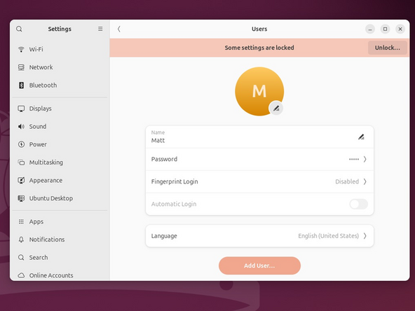

  9. Let's setup fingerprint login. Click on the horizontal bar in the upper left, search for user. Choose Fingerprint Login. Then select Scan new fingerprint. Select your desired fingerprint. Carefully tap your finger tip on the sensor (power button). You may need to try a few attempts as everyone's prints are different.
    • Let's setup fingerprint login. Click on the horizontal bar in the upper left, search for user.

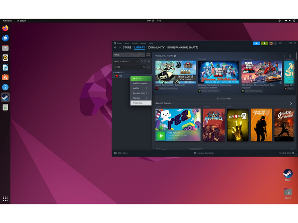

  10. If you are looking to run Steam games, please follow our guide links below. One NVMe Drive Guide. Two NVMe Drives Guide.
