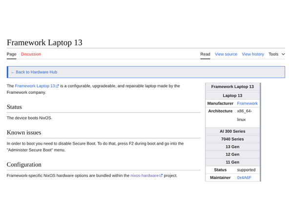

  3. To install NixOS, Secure Boot must be disabled! By default NixOS will not boot with Secure Boot enabled. Please refer to our explanation of Secure Boot to learn more To disable secure boot: Boot into BIOS by tapping F2 just before the Framework splash screen.
    • To install NixOS, Secure Boot must be disabled! By default NixOS will not boot with Secure Boot enabled. Please refer to our explanation of Secure Boot to learn more
    • To disable secure boot:

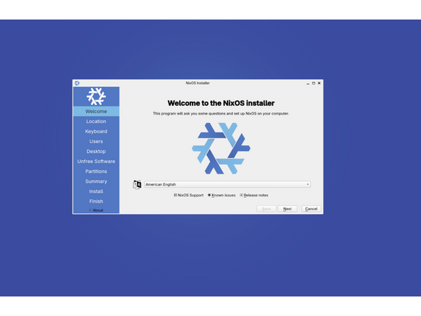

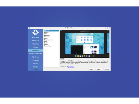

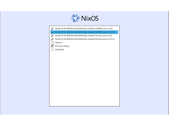

  5. When the installer first displays a list of kernels to choose from, select the latest one. At the time of this guide, that was kernel 6.15.x - for the sake of this guide, we will assume you've selected GNOME. When the installer appears, you will be asked to connect to a network. Connect to wi-fi. It will cycle through the checking process again, then allow you to select your language and press the next button. Select your location keyboard and then setup your user account.
    • When the installer first displays a list of kernels to choose from, select the latest one. At the time of this guide, that was kernel 6.15.x - for the sake of this guide, we will assume you've selected GNOME.
    • When the installer appears, you will be asked to connect to a network. Connect to wi-fi. It will cycle through the checking process again, then allow you to select your language and press the next button.
    • Select your location keyboard and then setup your user account.
    • Next, you will want to choose your desktop - as mentioned previously, for the sake of this guide, we will assume GNOME.

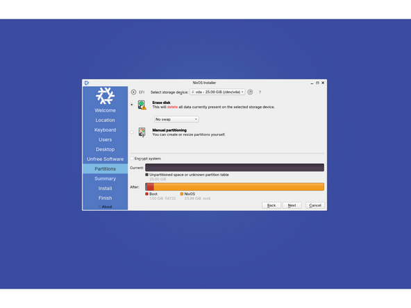

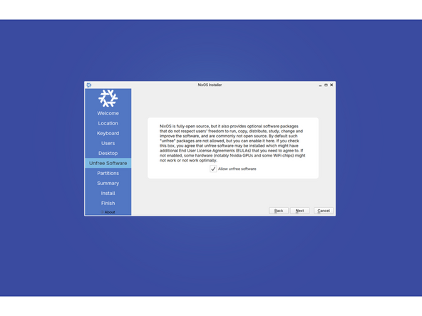

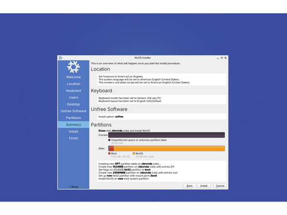

  6. Next you will be asked if you would like to have access to non-free software. This is recommended for most users, but if you understand it can affect access to proprietary blobs and related, you can elect to not choose it. The next option is to choose your partition setup. For most people, the desired choice will be to erase disk. Advanced users, may instead elect for manual partitioning. And now, we arrive at the summary screen where you can determined if the settings are what you would like. And you can press the install button to begin writing your selections to the drive.
    • Next you will be asked if you would like to have access to non-free software. This is recommended for most users, but if you understand it can affect access to proprietary blobs and related, you can elect to not choose it.
    • The next option is to choose your partition setup. For most people, the desired choice will be to erase disk. Advanced users, may instead elect for manual partitioning.
    • And now, we arrive at the summary screen where you can determined if the settings are what you would like. And you can press the install button to begin writing your selections to the drive.

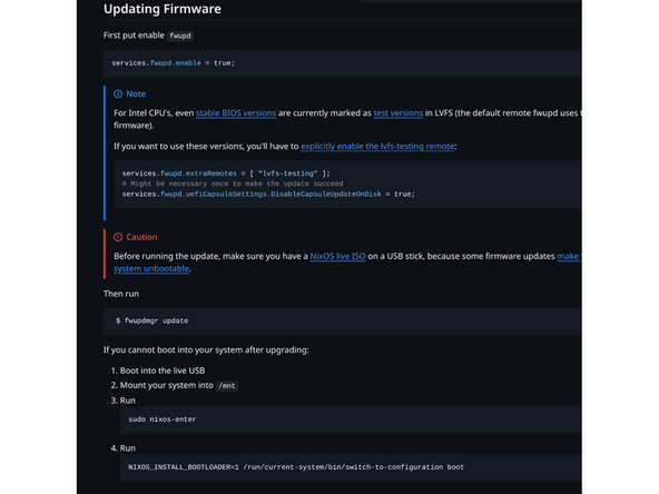

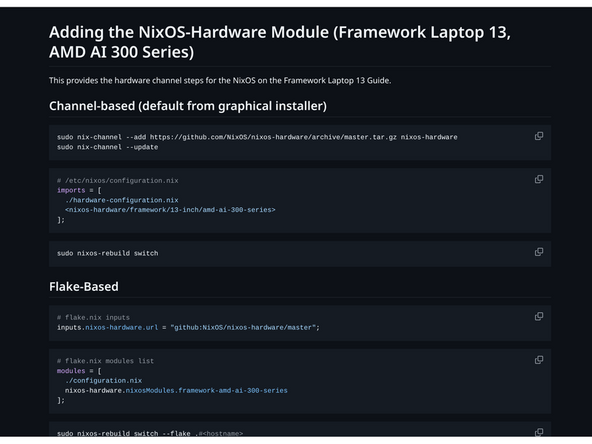

  7. Framework hardware quirks and fixes for NixOS are maintained in the nixos-hardware project, which isn't part of NixOS by default. Add the module for your CPU generation. If you installed using the graphical installer in Steps 1-6, you're on a channel-based system.
