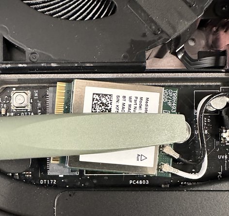

  22. Use your Framework Screwdriver to loosen the captive T5 Torx screw securing Wi-Fi module. The module might pop up at a shallow angle when you loosen the screw.
    • Use your Framework Screwdriver to loosen the captive T5 Torx screw securing Wi-Fi module.
    • The module might pop up at a shallow angle when you loosen the screw.
  23. Grip the end of the Wi-Fi module with the screw hole and slide it out of its socket. Don't pull the module too far from its socket, as it's still connected by two cables.
    • Grip the end of the Wi-Fi module with the screw hole and slide it out of its socket.
    • Don't pull the module too far from its socket, as it's still connected by two cables.
  24. Rotate the Wi-Fi module towards the top of the laptop to keep it out of the way of the Mainboard. If the antenna cables disconnect, follow these steps to reconnect them. If the antenna cables disconnect, follow these steps to reconnect them.
    • Rotate the Wi-Fi module towards the top of the laptop to keep it out of the way of the Mainboard.
    • If the antenna cables disconnect, follow these steps to reconnect them.

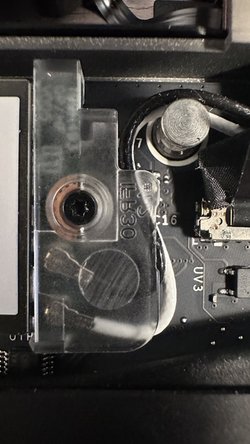

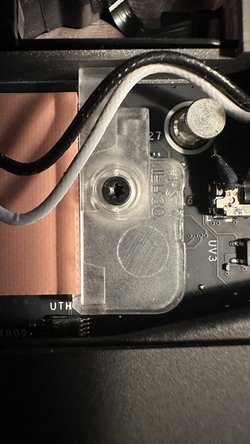

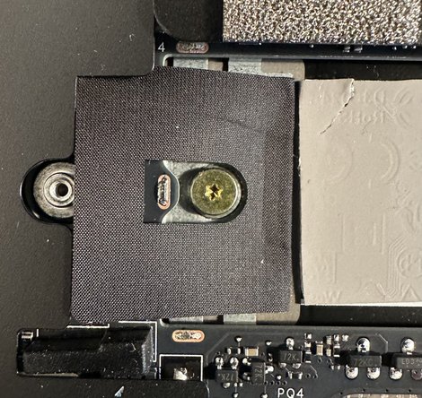

  37. Lift up the interposer door to reveal the screw underneath. The Mainboard screws are ordered from 1–6. You don't have to follow the order, but you can use it to help keep track of the screws you've removed. Use your Framework Screwdriver to remove the six 2 mm‑long T5 Torx screws securing the Mainboard.
    • Lift up the interposer door to reveal the screw underneath.
    • The Mainboard screws are ordered from 1–6. You don't have to follow the order, but you can use it to help keep track of the screws you've removed.
    • Use your Framework Screwdriver to remove the six 2 mm‑long T5 Torx screws securing the Mainboard.

  54. Rotate the Wi-Fi Module back into place, making sure the antenna cables wrap around their silver peg on the Mainboard and tuck underneath the heat sink. Rotate the Wi-Fi Module back into place, making sure the antenna cables wrap around their silver peg on the Mainboard and tuck underneath the heat sink. Rotate the Wi-Fi Module back into place, making sure the antenna cables wrap around their silver peg on the Mainboard and tuck underneath the heat sink.
    • Rotate the Wi-Fi Module back into place, making sure the antenna cables wrap around their silver peg on the Mainboard and tuck underneath the heat sink.
    Remove the plastic retention bracket, if installed.
    Paul Wilson - Open Reply
  55. Hold the Wi-Fi module by its edges. Don't touch the gold contacts with your fingers. If you do, wipe the contacts with a clean, lint-free cloth to remove any finger oils. Align the Wi-Fi module's gold contacts and notch with the socket on the Mainboard.
  56. Slide the clear Wi-Fi module cover on the module and align its screw with the screw hole cutout. Slide the clear Wi-Fi module cover on the module and align its screw with the screw hole cutout.
    • Slide the clear Wi-Fi module cover on the module and align its screw with the screw hole cutout.
  57. Use your Framework Screwdriver to tighten the captive T5 Torx screw securing Wi-Fi module. Use your Framework Screwdriver to tighten the captive T5 Torx screw securing Wi-Fi module.
    • Use your Framework Screwdriver to tighten the captive T5 Torx screw securing Wi-Fi module.
    Due to the slightly different design of the bracket that came with the motherboard, the wires need to be routed a bit differently.

  62. Use your Framework Screwdriver to install the 2 mm‑long T5 Torx screw securing the SSD. Use your Framework Screwdriver to install the 2 mm‑long T5 Torx screw securing the SSD.
    • Use your Framework Screwdriver to install the 2 mm‑long T5 Torx screw securing the SSD.
    Remove screw, if present.
