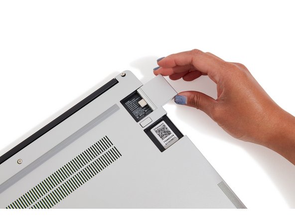

  4. Insert the Expansion Cards of your choice into any of the empty bays. If you have a Framework Laptop 13 (AMD Ryzen™ 7040 Series) please see this article showing which Expansion Cards are compatible with each port.
    • Insert the Expansion Cards of your choice into any of the empty bays.
    • If you have a Framework Laptop 13 (AMD Ryzen™ 7040 Series) please see this article showing which Expansion Cards are compatible with each port.
    • Slide the Expansion card into the bay, pushing until it clicks.
    • The first few times you insert or remove a card, it'll take a little more force.

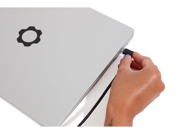

    • Connect the USB-C cable from the Power Adapter into the USB-C Expansion Card. Connect the AC Cable to a power source.
    • The Framework Laptop ships in a mode where the battery is disabled until power is first plugged in, so you really do have to plug in power at this step!

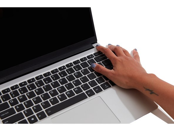

  5. Turn the Framework Laptop over and open it.
    • Turn the Framework Laptop over and open it.
    • Power on the laptop by pressing the power button, and get ready to start using your Framework Laptop!
    • The first boot may take a bit longer (10-30 seconds) while the system recalibrates the installed memory.
