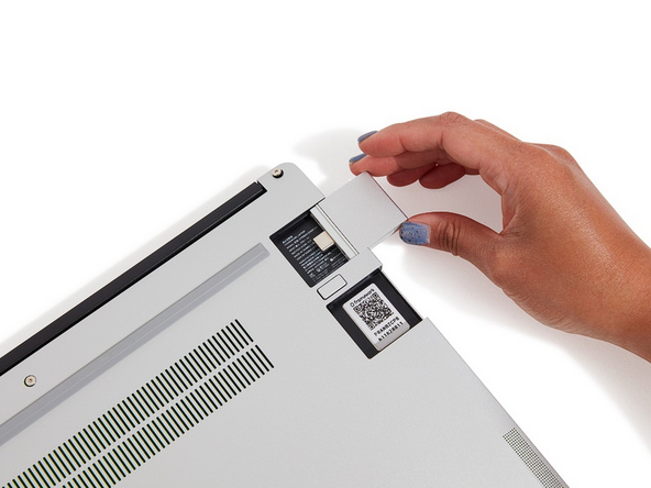

Insert the Expansion Cards of your choice into any of the empty bays.
The text, logo, and QR code on the Expansion Card must be facing down (facing the laptop). Slide the Expansion card into the bay. Using two or more fingers push the card until into the bay until it clicks.
You will have to use a slight amount of force to ensure proper installation of the Expansion Cards.

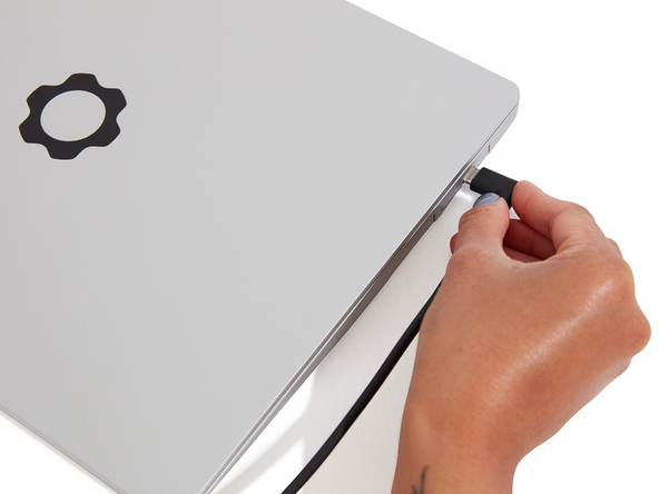

Plug your power cable into the USB-C Expansion Card.

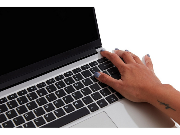

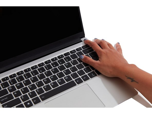

Open the lid on your Framework Laptop and press the power button.
Note that your first boot will take a while before the logo comes up on screen as the system does memory training. The more memory you've installed, the longer this could take (on the order of a minute or two with 64GB!)
