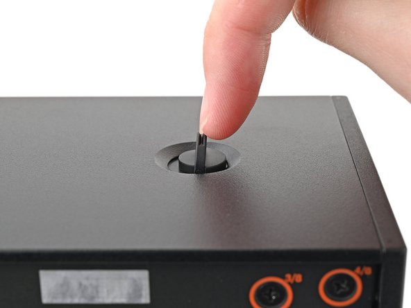

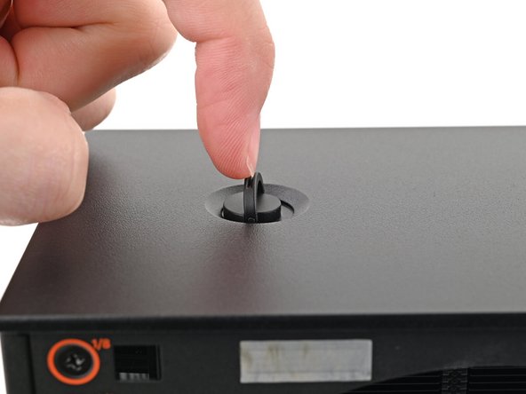

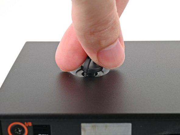

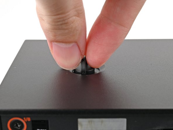

    • Remove the Handle.

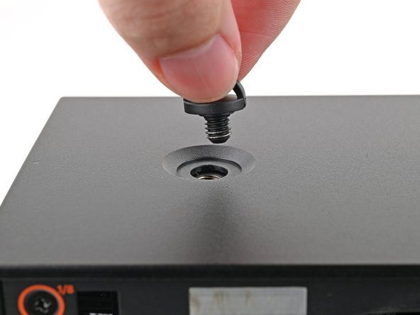

    • Remove the Top Panel screw.

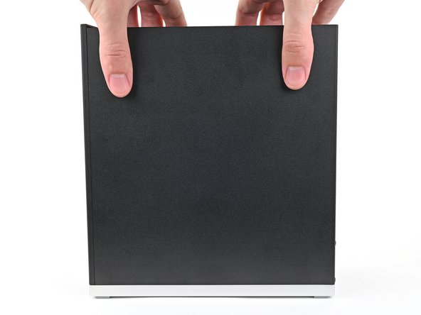

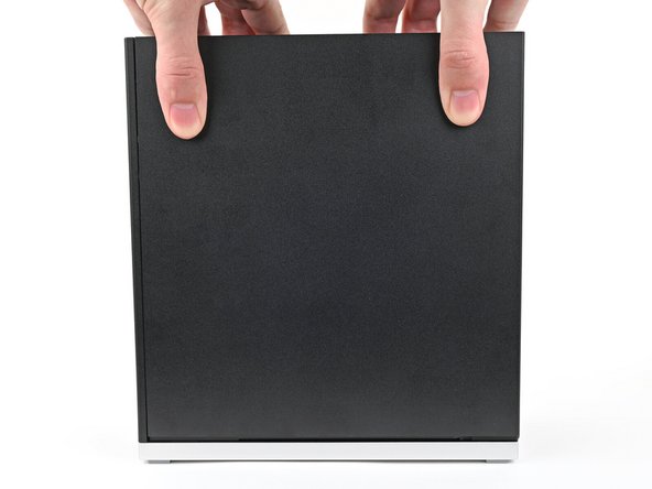

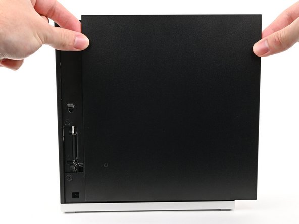

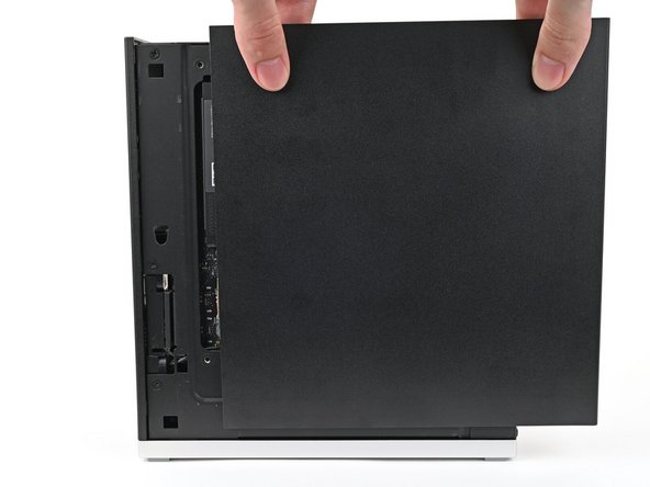

  7. Use your fingers to grip the top of the Left Panel and slide it upward to release its clips. Remove the Left Panel. Remove the Left Panel.
    • Remove the Left Panel.

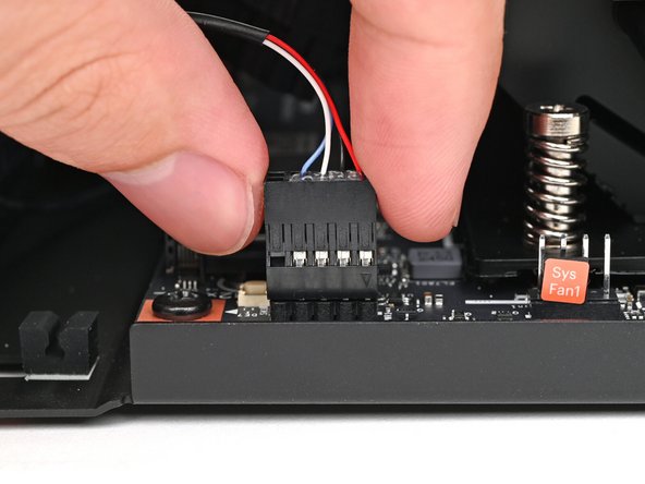

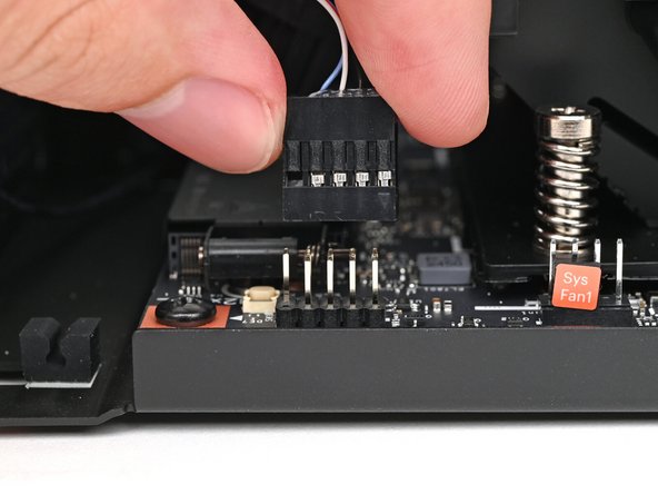

  9. Use your fingers to lift the APU fan cable connector off its four‑pronged socket on the Mainboard. Use your fingers to lift the APU fan cable connector off its four‑pronged socket on the Mainboard.
    • Use your fingers to lift the APU fan cable connector off its four‑pronged socket on the Mainboard.

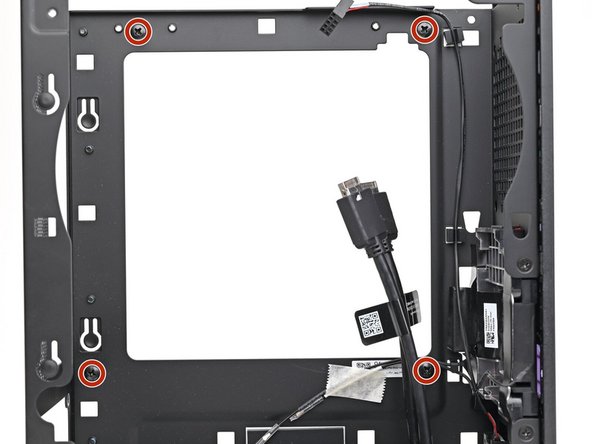

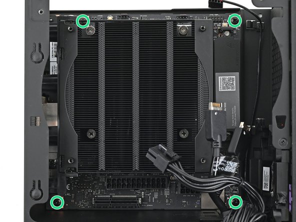

  11. Use your Framework Desktop Screwdriver to remove the four 27.3 mm‑long Phillips screws securing the CPU fan and fan duct. Use your Framework Desktop Screwdriver to remove the four 27.3 mm‑long Phillips screws securing the CPU fan and fan duct.
    • Use your Framework Desktop Screwdriver to remove the four 27.3 mm‑long Phillips screws securing the CPU fan and fan duct.

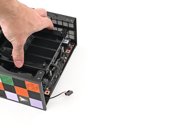

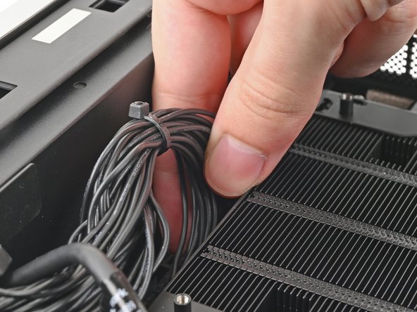

  13. Lift the fan out of the chassis, making sure the cables thread through the side of the heatsink. Lift the fan out of the chassis, making sure the cables thread through the side of the heatsink. Lift the fan out of the chassis, making sure the cables thread through the side of the heatsink.
    • Lift the fan out of the chassis, making sure the cables thread through the side of the heatsink.

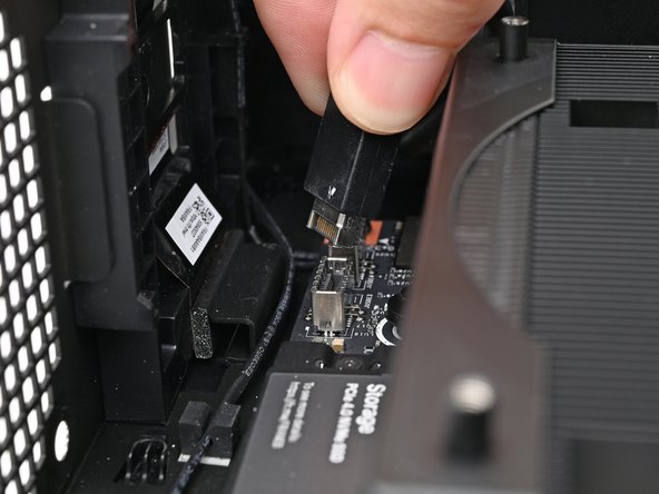

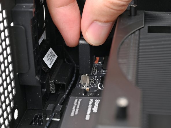

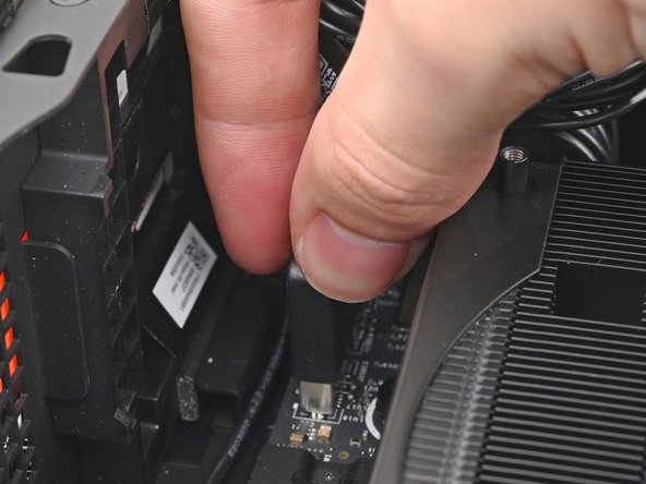

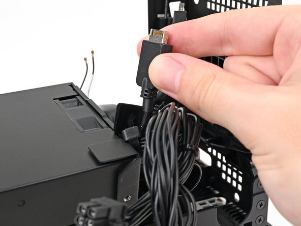

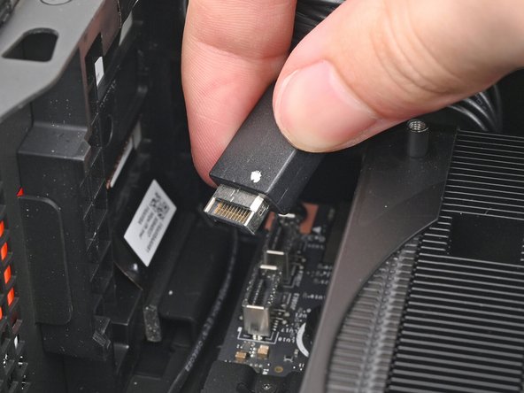

  14. Pull the top Expansion Card connector straight out of its socket in the Mainboard to disconnect it. Pull the top Expansion Card connector straight out of its socket in the Mainboard to disconnect it.
    • Pull the top Expansion Card connector straight out of its socket in the Mainboard to disconnect it.

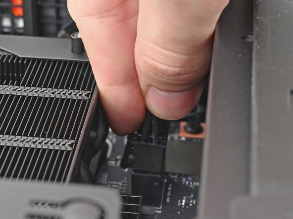

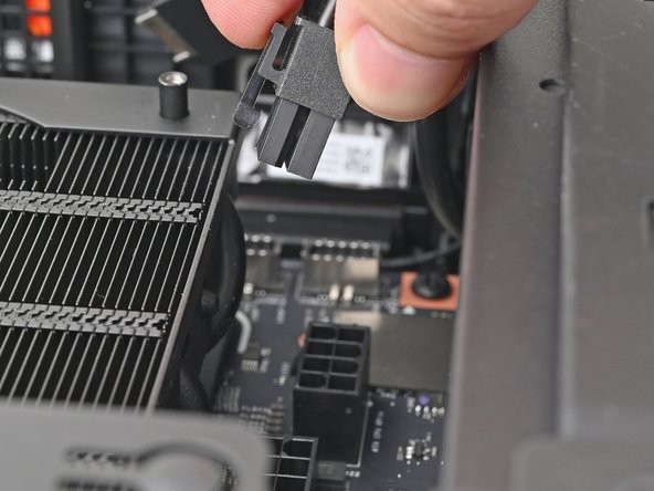

  15. While squeezing the clip on the main power cable, pull it straight up and out of its socket to disconnect it. While squeezing the clip on the main power cable, pull it straight up and out of its socket to disconnect it.
    • While squeezing the clip on the main power cable, pull it straight up and out of its socket to disconnect it.
  16. While squeezing the clip on the CPU power cable, pull it straight up and out of its socket to disconnect it. While squeezing the clip on the CPU power cable, pull it straight up and out of its socket to disconnect it.
    • While squeezing the clip on the CPU power cable, pull it straight up and out of its socket to disconnect it.
  17. Pull the bottom Expansion Card connector straight out of its socket in the Mainboard to disconnect it. Pull the bottom Expansion Card connector straight out of its socket in the Mainboard to disconnect it.
    • Pull the bottom Expansion Card connector straight out of its socket in the Mainboard to disconnect it.

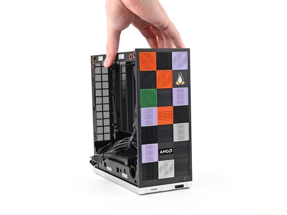

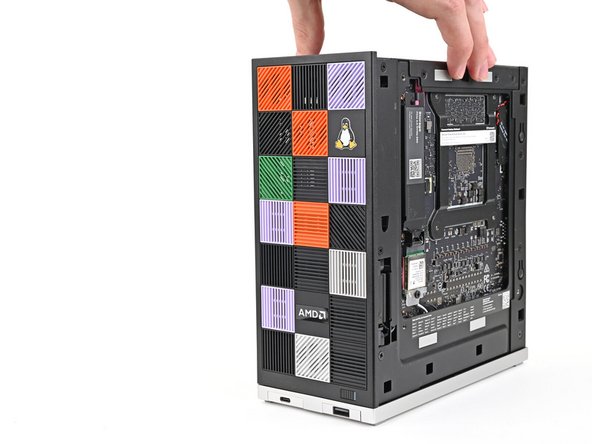

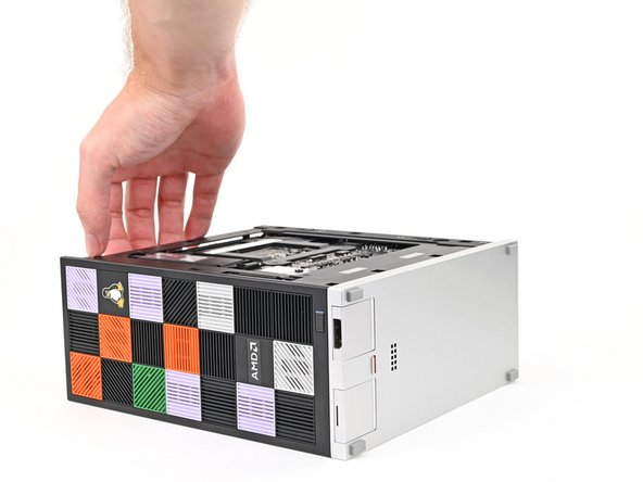

  18. Lift the Desktop so it stands upright on your work surface. Lift the Desktop so it stands upright on your work surface.
    • Lift the Desktop so it stands upright on your work surface.

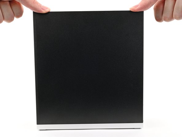

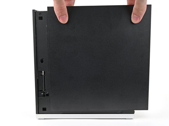

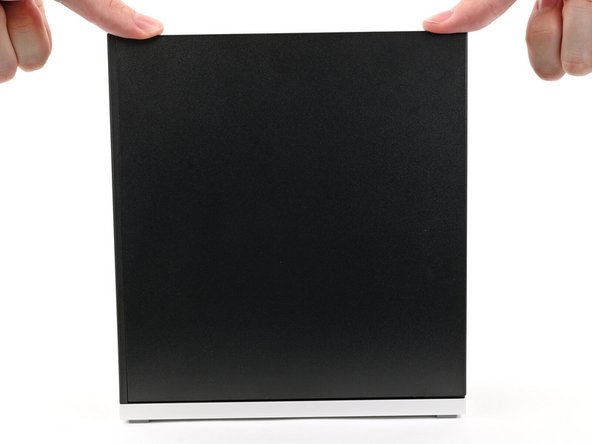

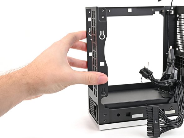

  19. Use your fingers to grip the top of the Right Panel and slide it upward to release its clips. Remove the Right Panel. Remove the Right Panel.
    • Remove the Right Panel.

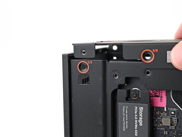

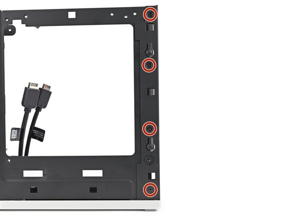

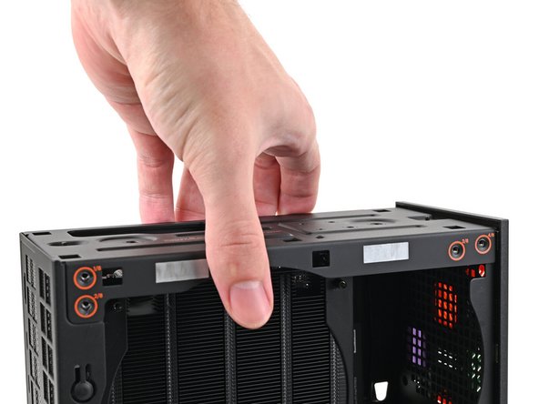

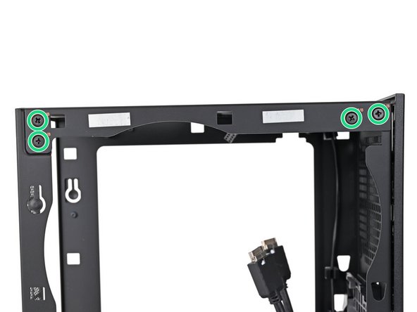

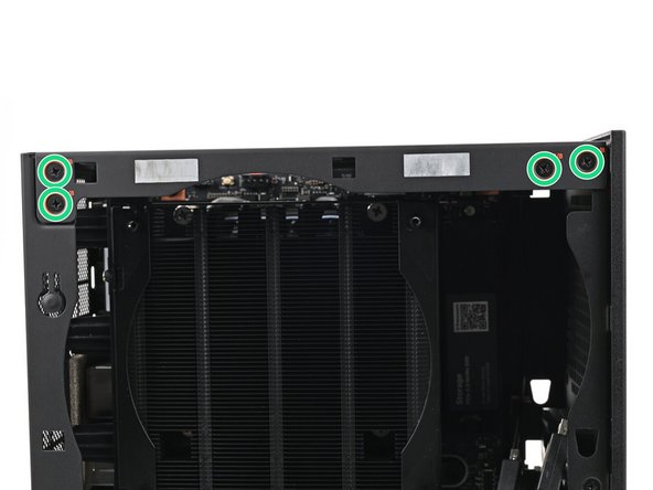

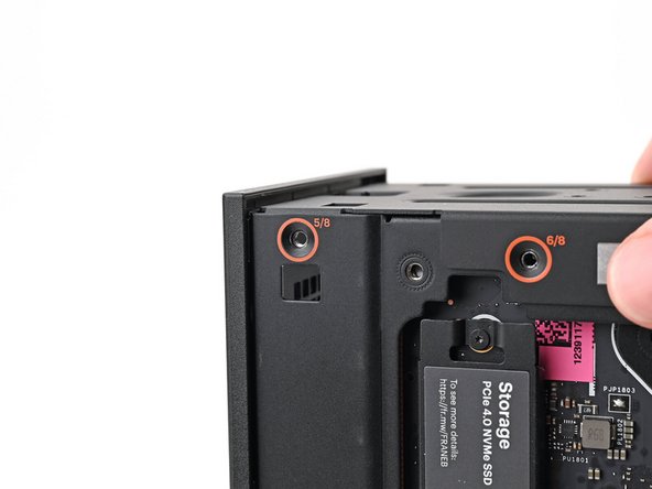

  20. While holding the Desktop steady, use your Framework Desktop Screwdriver to remove the eight 4.0 mm‑long Phillips screws securing the top plate. While holding the Desktop steady, use your Framework Desktop Screwdriver to remove the eight 4.0 mm‑long Phillips screws securing the top plate. While holding the Desktop steady, use your Framework Desktop Screwdriver to remove the eight 4.0 mm‑long Phillips screws securing the top plate.
    • While holding the Desktop steady, use your Framework Desktop Screwdriver to remove the eight 4.0 mm‑long Phillips screws securing the top plate.

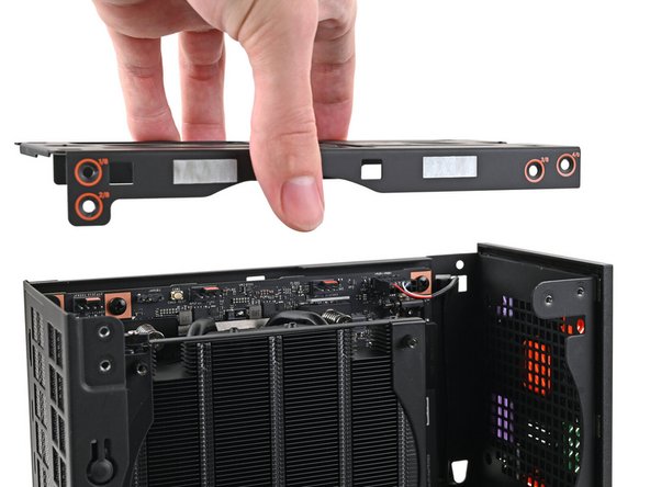

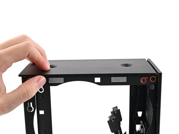

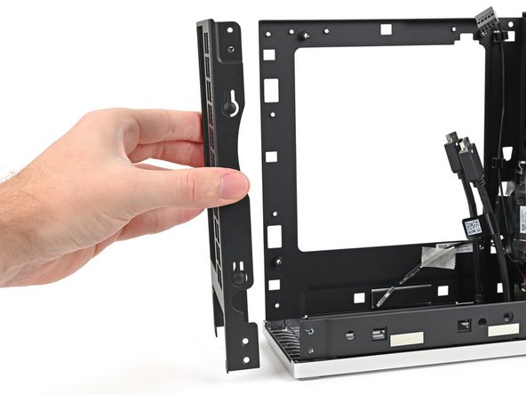

  21. Lift the top plate off the Desktop and remove it. Lift the top plate off the Desktop and remove it.
    • Lift the top plate off the Desktop and remove it.

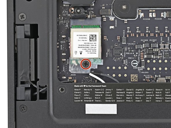

  23. Use your Framework Desktop Screwdriver to remove the 7.0 mm‑long Phillips screw securing the Wi-Fi module. Use your Framework Desktop Screwdriver to remove the 7.0 mm‑long Phillips screw securing the Wi-Fi module.
    • Use your Framework Desktop Screwdriver to remove the 7.0 mm‑long Phillips screw securing the Wi-Fi module.

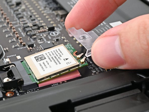

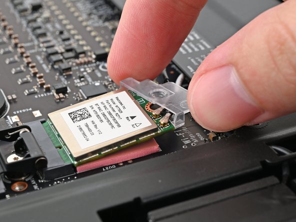

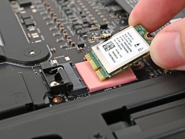

  24. Use your fingers to slide the Wi-Fi module cover straight off the bottom of the module. Remove the cover.
    • Use your fingers to slide the Wi-Fi module cover straight off the bottom of the module.
    • Remove the cover.

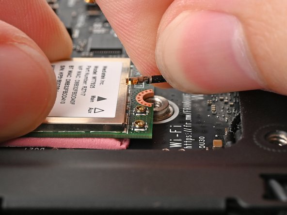

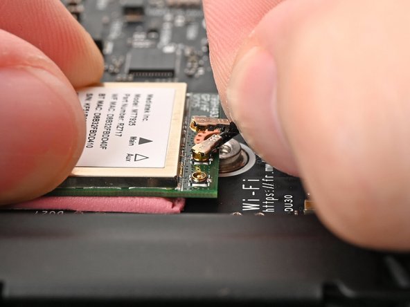

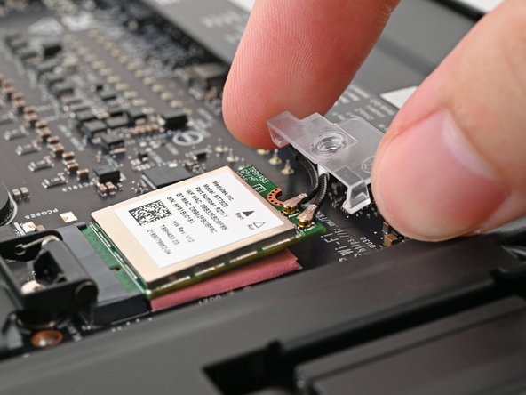

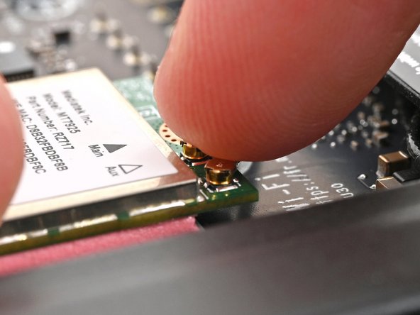

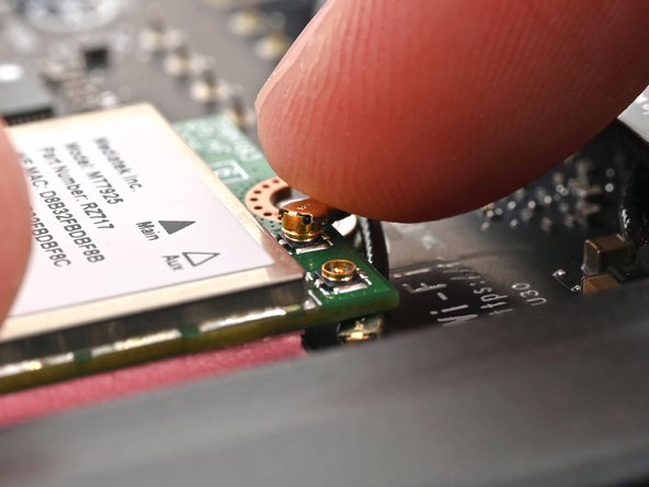

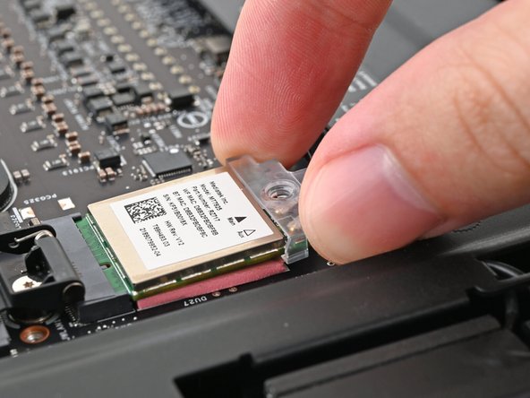

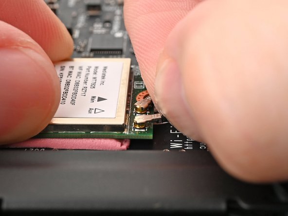

  25. The Wi-Fi module has two delicate coaxial cable connectors. Follow this step carefully to avoid damaging them. Press and hold the Wi-Fi module down with your fingers. Use your fingers to grip the white antenna cable, as close to the metal head as possible.
    • The Wi-Fi module has two delicate coaxial cable connectors. Follow this step carefully to avoid damaging them.
    • Press and hold the Wi-Fi module down with your fingers.
    • Use your fingers to grip the white antenna cable, as close to the metal head as possible.
    • If you have angled tweezers, slide one arm of a pair of tweezers under the antenna connector, as close to the metal head as possible.
    • Gently lift the connector straight up to disconnect the white antenna cable.
    • Repeat the procedure with the black antenna cable.

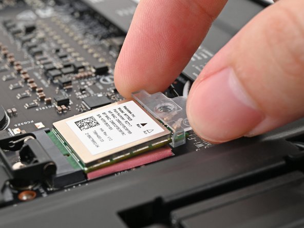

  26. Grip the Wi-Fi module by its edges and pull it straight out of its socket. Remove the Wi-Fi module.
    • Grip the Wi-Fi module by its edges and pull it straight out of its socket.
    • Remove the Wi-Fi module.

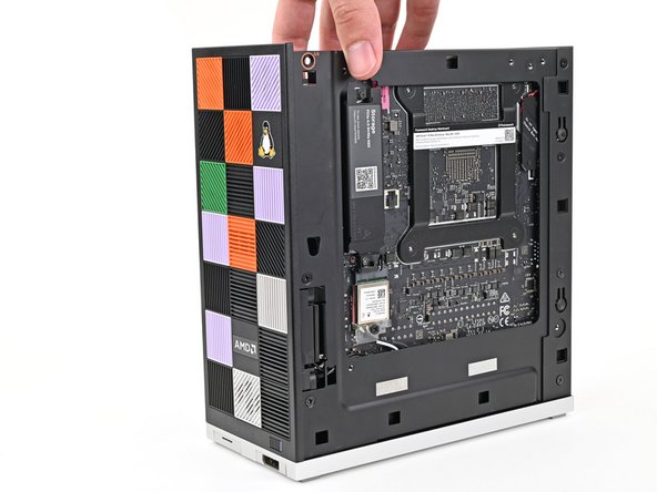

  27. Rotate the Desktop onto its right side so the Mainboard is facing upward. Rotate the Desktop onto its right side so the Mainboard is facing upward.
    • Rotate the Desktop onto its right side so the Mainboard is facing upward.

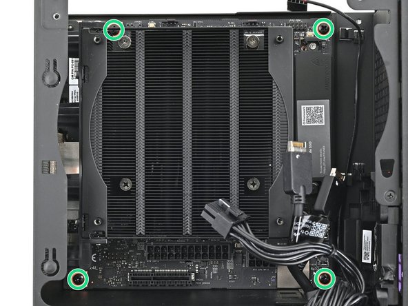

  29. Use your Framework Desktop Screwdriver to remove the four 8.2 mm‑long Phillips screws securing the Mainboard. Use your Framework Desktop Screwdriver to remove the four 8.2 mm‑long Phillips screws securing the Mainboard.
    • Use your Framework Desktop Screwdriver to remove the four 8.2 mm‑long Phillips screws securing the Mainboard.

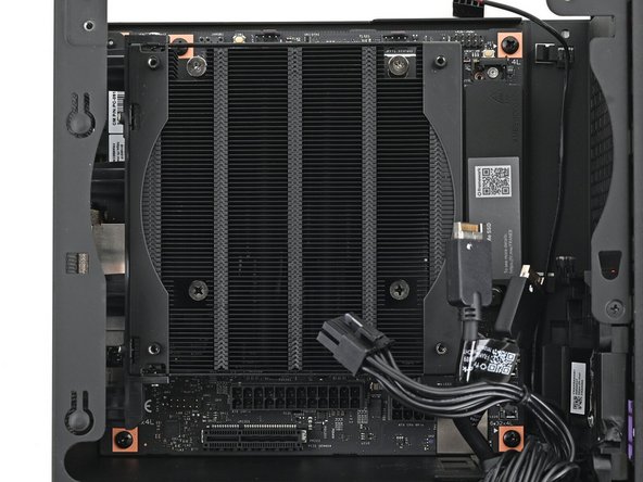

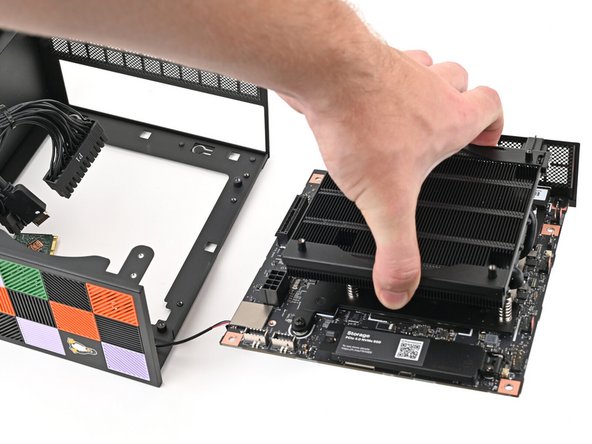

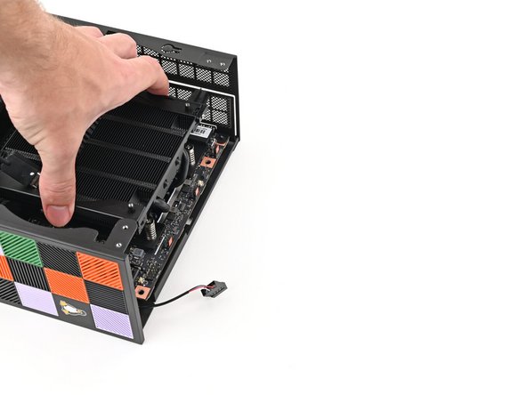

  30. Grab the Mainboard by its heatsink and pull it towards the front of the Desktop to slide it out of the rear port cutout. When handling the Heatsink, grab from the left and right sides (sides facing Front Panel & Back IO) as shown in the image to prevent bent fins and possible damage to the Heatsink. Slide the Mainboard towards the top of the Desktop to remove it from the chassis.
    • Grab the Mainboard by its heatsink and pull it towards the front of the Desktop to slide it out of the rear port cutout.
    • When handling the Heatsink, grab from the left and right sides (sides facing Front Panel & Back IO) as shown in the image to prevent bent fins and possible damage to the Heatsink.
    • Slide the Mainboard towards the top of the Desktop to remove it from the chassis.

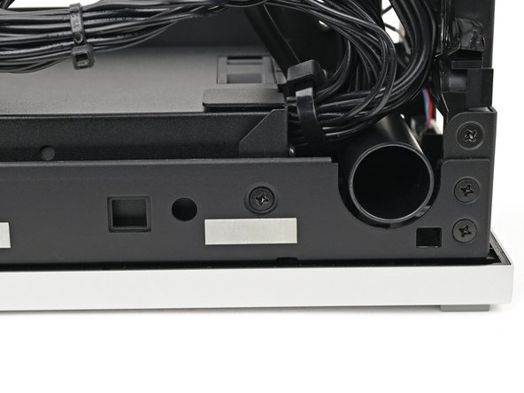

  31. Use your Framework Desktop Screwdriver to remove the three 5.9 mm‑long Phillips screws securing the power supply. Optionally, you can remove the six 4.0 mm‑long screws securing the rear plate to make removing the power supply easier. If you don't remove the rear plate screws, skip the next step.
    • Use your Framework Desktop Screwdriver to remove the three 5.9 mm‑long Phillips screws securing the power supply.
    • Optionally, you can remove the six 4.0 mm‑long screws securing the rear plate to make removing the power supply easier.
    • If you don't remove the rear plate screws, skip the next step.
  32. Pull the rear plate off the back of the Desktop and remove it. Pull the rear plate off the back of the Desktop and remove it.
    • Pull the rear plate off the back of the Desktop and remove it.

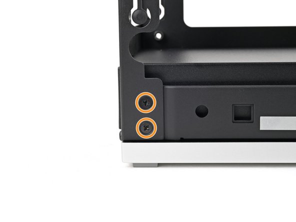

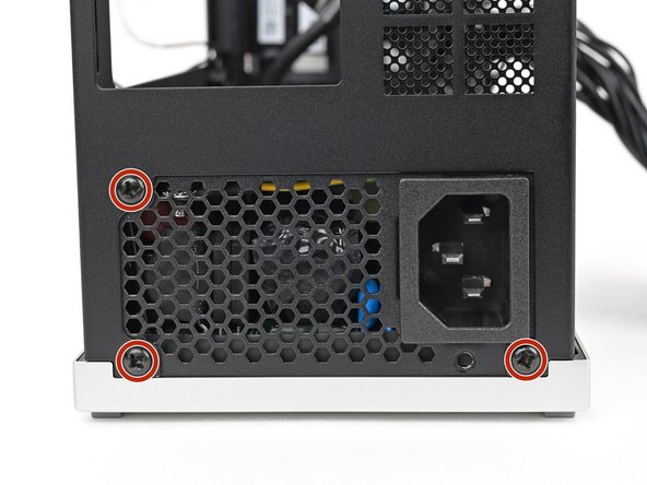

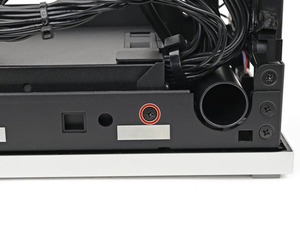

  33. Use your Framework Desktop Screwdriver to remove the 4.0 mm‑long Phillips screw securing the power supply. Use your Framework Desktop Screwdriver to remove the 4.0 mm‑long Phillips screw securing the power supply.
    • Use your Framework Desktop Screwdriver to remove the 4.0 mm‑long Phillips screw securing the power supply.

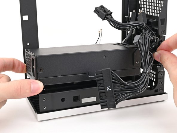

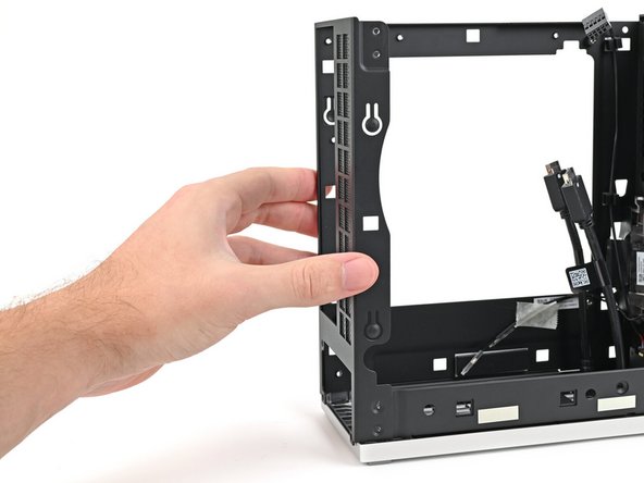

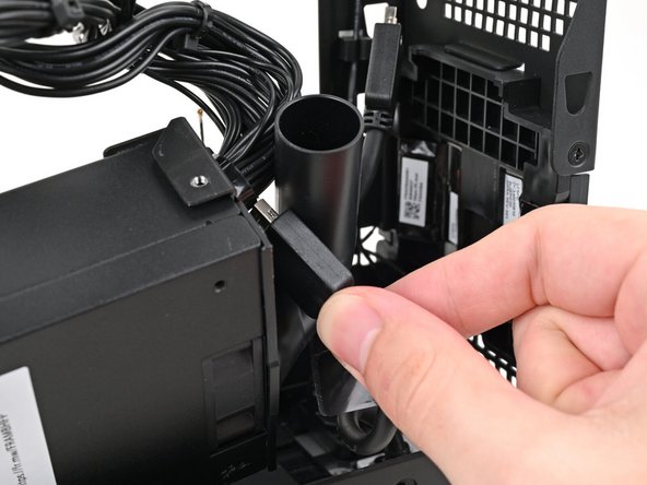

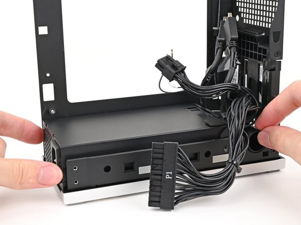

  34. Lift the power supply out of its slot and let it rest on the left side of the Desktop. Lift the power supply out of its slot and let it rest on the left side of the Desktop. Lift the power supply out of its slot and let it rest on the left side of the Desktop.
    • Lift the power supply out of its slot and let it rest on the left side of the Desktop.

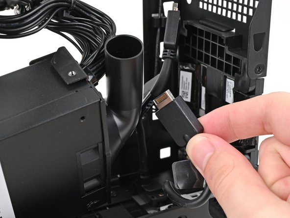

  35. Push the right Expansion Card cable through the gap between the power supply and its duct. The gap is very small and might require some force to thread the cable through. Remove the power supply.
    • Push the right Expansion Card cable through the gap between the power supply and its duct.
    • The gap is very small and might require some force to thread the cable through.
    • Remove the power supply.

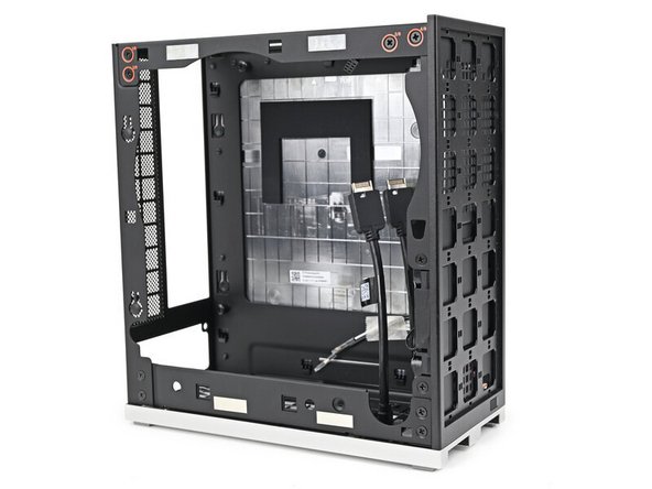

  37. Your replacement case requires some disassembly before transferring the internals. The next 12 steps will show how to disassemble the case. Use your finger to lift up the two D-rings on the Top Panel screws. Use your finger to lift up the two D-rings on the Top Panel screws.
    • Your replacement case requires some disassembly before transferring the internals. The next 12 steps will show how to disassemble the case.

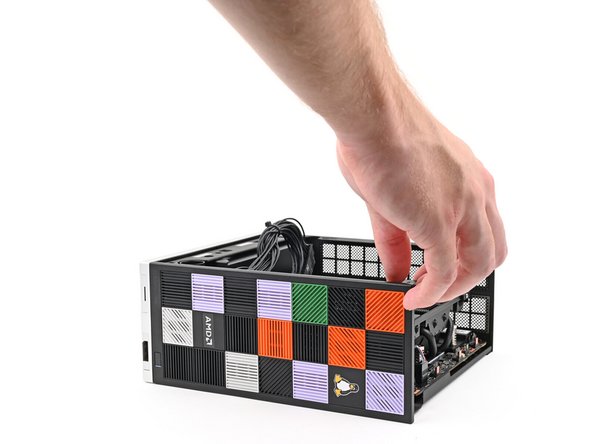

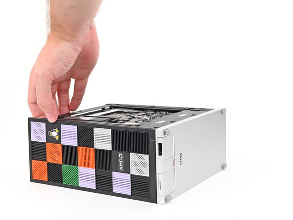

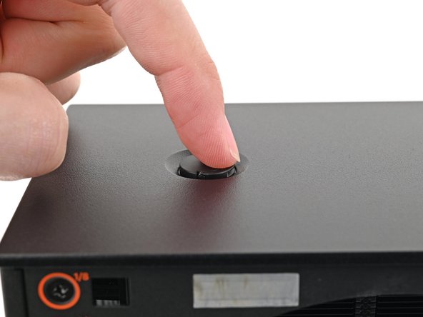

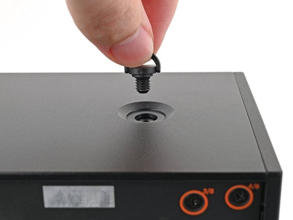

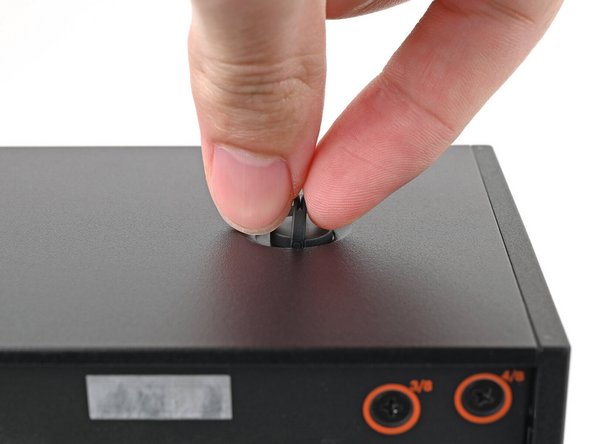

  38. Use your fingers to twist the screw counter-clockwise and loosen it. Remove the Top Panel screw. Remove the Top Panel screw.

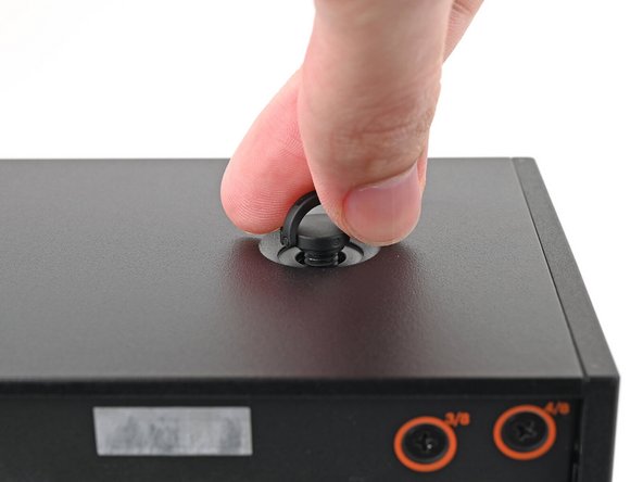

  39. Repeat the same procedure for the other Top Panel screw. Repeat the same procedure for the other Top Panel screw. Repeat the same procedure for the other Top Panel screw.

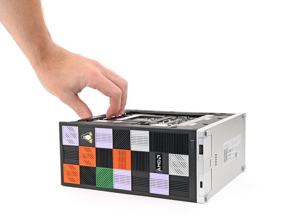

  40. Slide the Top Panel towards the rear of the computer to release the clips securing it to the chassis. If you're having a hard time gripping the Top Panel, use the screw holes to get a better handhold. Lift the Top Panel off the chassis and remove it.
  41. Use your fingers to grip the top of the Right Panel and slide it upward to release its clips. Remove the Right Panel. Remove the Right Panel.

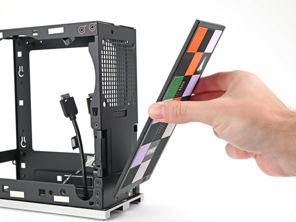

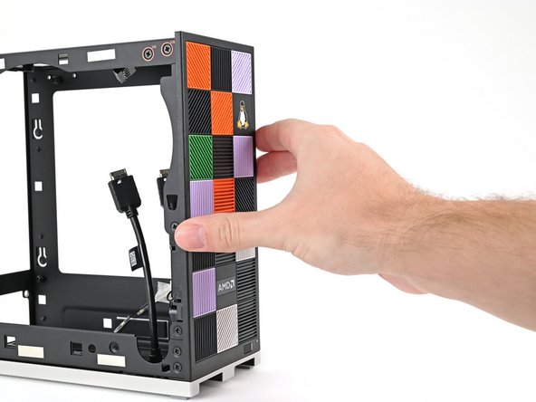

  42. Use your fingers to pull the Front Panel off the magnets securing it to the chassis. Follow this guide to transfer your Tiles to the new Front Panel or to install the old Front Panel. Follow this guide to transfer your Tiles to the new Front Panel or to install the old Front Panel.
    • Use your fingers to pull the Front Panel off the magnets securing it to the chassis.
    • Follow this guide to transfer your Tiles to the new Front Panel or to install the old Front Panel.

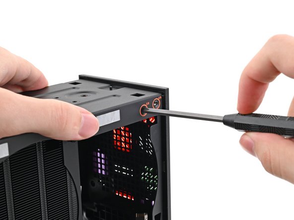

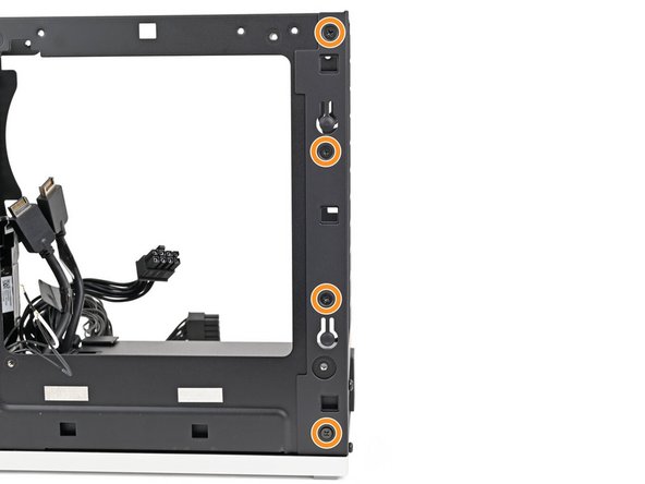

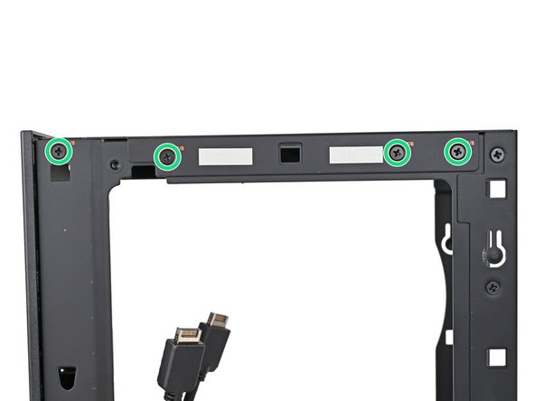

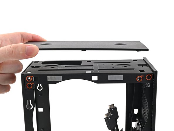

  43. While holding the Desktop steady, use your Framework Desktop Screwdriver to remove the eight 4.0 mm‑long Phillips screws securing the top plate. While holding the Desktop steady, use your Framework Desktop Screwdriver to remove the eight 4.0 mm‑long Phillips screws securing the top plate. While holding the Desktop steady, use your Framework Desktop Screwdriver to remove the eight 4.0 mm‑long Phillips screws securing the top plate.

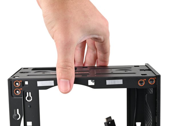

  44. Lift the top plate off the Desktop and remove it. Lift the top plate off the Desktop and remove it.

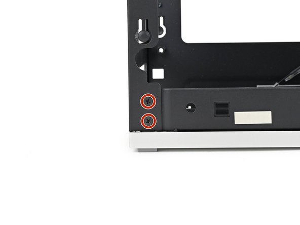

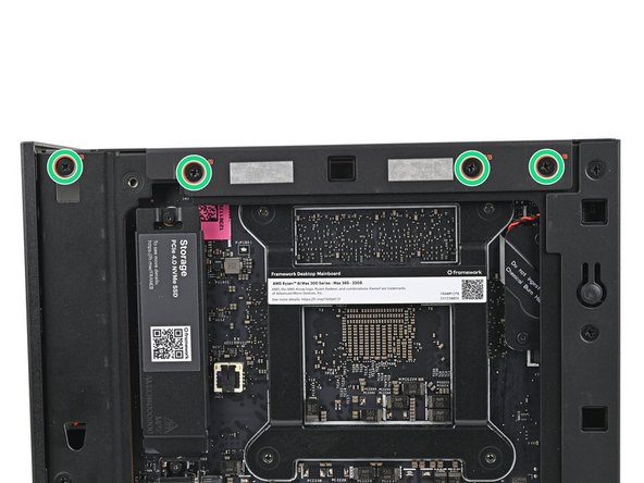

  45. Use your Framework Desktop Screwdriver to remove the four 8.2 mm‑long Phillips screws in the Mainboard screw posts. Use your Framework Desktop Screwdriver to remove the four 8.2 mm‑long Phillips screws in the Mainboard screw posts.
    • Use your Framework Desktop Screwdriver to remove the four 8.2 mm‑long Phillips screws in the Mainboard screw posts.

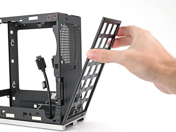

  47. Pull the rear plate off the back of the Desktop and remove it. Pull the rear plate off the back of the Desktop and remove it.

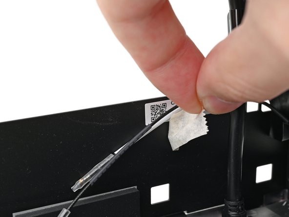

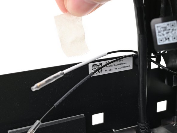

  48. Peel off the tape covering the antenna cables. Peel off the tape covering the antenna cables. Peel off the tape covering the antenna cables.
    • Peel off the tape covering the antenna cables.
  49. Thread the right Expansion card cable through the gap between the power supply and its duct. Thread the right Expansion card cable through the gap between the power supply and its duct. Thread the right Expansion card cable through the gap between the power supply and its duct.
    • Thread the right Expansion card cable through the gap between the power supply and its duct.
  50. Place the power supply into its slot in the bottom of the Desktop. Place the power supply into its slot in the bottom of the Desktop.
    • Place the power supply into its slot in the bottom of the Desktop.
  51. Use your Framework Desktop Screwdriver to install the 4.0 mm‑long Phillips screw securing the power supply. Use your Framework Desktop Screwdriver to install the 4.0 mm‑long Phillips screw securing the power supply.
    • Use your Framework Desktop Screwdriver to install the 4.0 mm‑long Phillips screw securing the power supply.

  53. Use your Framework Desktop Screwdriver to install the three 5.9 mm‑long Phillips screws securing the power supply. If you removed the rear plate, use your Framework Desktop Screwdriver to install the six 4.0 mm‑long screws securing the rear plate. If you removed the rear plate, use your Framework Desktop Screwdriver to install the six 4.0 mm‑long screws securing the rear plate.
    • Use your Framework Desktop Screwdriver to install the three 5.9 mm‑long Phillips screws securing the power supply.
    • If you removed the rear plate, use your Framework Desktop Screwdriver to install the six 4.0 mm‑long screws securing the rear plate.
  54. Grab the Mainboard by its heatsink and slide it into the chassis. When handling the Heatsink, grab from the left and right sides (sides facing Front Panel & Back IO) as shown in the image to prevent bent fins and possible damage to the Heatsink. Align the rear ports with its cutout and the screw posts with the screw holes on the Mainboard.
    • Grab the Mainboard by its heatsink and slide it into the chassis.
    • Align the rear ports with its cutout and the screw posts with the screw holes on the Mainboard.
    • You'll feel the Mainboard rest onto the screw posts when it's aligned properly.
    • Make sure no cables are trapped underneath the Mainboard before continuing.
  55. Use your Framework Desktop Screwdriver to install the four 8.2 mm‑long Phillips screws securing the Mainboard. Use your Framework Desktop Screwdriver to install the four 8.2 mm‑long Phillips screws securing the Mainboard.
    • Use your Framework Desktop Screwdriver to install the four 8.2 mm‑long Phillips screws securing the Mainboard.

  58. Hold the Wi-Fi module by its edges. Don't touch the gold contacts with your fingers. If you do, wipe the contacts with a clean, lint-free cloth to remove any finger oils. Align the Wi-Fi module's gold contacts and notch with the socket on the Mainboard.
  59. Hold the Wi-Fi module down with your fingers. Position the black antenna cable connector over the left Wi-Fi module's coaxial socket. Tweezers can help position the connector.
    • Hold the Wi-Fi module down with your fingers.
    • Position the black antenna cable connector over the left Wi-Fi module's coaxial socket.
    • Repeat the procedure with the white antenna cable.
  60. Hook the Wi-Fi bracket over the corner of the Wi-Fi module opposite the antenna cables. Rotate the bracket over the Wi-Fi module, making sure the screw hole isn't being obstructed by the antenna cables. Rotate the bracket over the Wi-Fi module, making sure the screw hole isn't being obstructed by the antenna cables.
    • Hook the Wi-Fi bracket over the corner of the Wi-Fi module opposite the antenna cables.
    • Rotate the bracket over the Wi-Fi module, making sure the screw hole isn't being obstructed by the antenna cables.
  61. Use your Framework Desktop Screwdriver to install the 7.0 mm‑long Phillips screw securing the Wi-Fi module. Use your Framework Desktop Screwdriver to install the 7.0 mm‑long Phillips screw securing the Wi-Fi module.
    • Use your Framework Desktop Screwdriver to install the 7.0 mm‑long Phillips screw securing the Wi-Fi module.
  62. Rotate the Desktop so it sits upright on your work surface. Rotate the Desktop so it sits upright on your work surface.
    • Rotate the Desktop so it sits upright on your work surface.
  63. Place the top plate on top of the Desktop, making sure it slots into the chassis so the orange circles are visible. Place the top plate on top of the Desktop, making sure it slots into the chassis so the orange circles are visible.
    • Place the top plate on top of the Desktop, making sure it slots into the chassis so the orange circles are visible.
  64. Make sure the matching screw hole on the top plate labeled "5/8" is slotted on the inside of the Chassis so that the orange circle is visible. Make sure the matching screw hole on the top plate labeled "5/8" is slotted on the inside of the Chassis so that the orange circle is visible.
    • Make sure the matching screw hole on the top plate labeled "5/8" is slotted on the inside of the Chassis so that the orange circle is visible.
  65. While holding the Desktop steady, use your Framework Desktop Screwdriver to install the eight 4.0 mm‑long Phillips screws securing the top plate. While holding the Desktop steady, use your Framework Desktop Screwdriver to install the eight 4.0 mm‑long Phillips screws securing the top plate. While holding the Desktop steady, use your Framework Desktop Screwdriver to install the eight 4.0 mm‑long Phillips screws securing the top plate.
    • While holding the Desktop steady, use your Framework Desktop Screwdriver to install the eight 4.0 mm‑long Phillips screws securing the top plate.

  68. Slide the bottom Expansion Card cable into its socket on the Mainboard. Slide the bottom Expansion Card cable into its socket on the Mainboard.
    • Slide the bottom Expansion Card cable into its socket on the Mainboard.
  69. Orient the CPU power supply cable so its clip is facing the heatsink. Slide the cable into its socket on the Mainboard until you feel it click into place.
    • Orient the CPU power supply cable so its clip is facing the heatsink.
    • Slide the cable into its socket on the Mainboard until you feel it click into place.
  70. Orient the main power supply cable so its clip is facing away from the heatsink. Slide the cable into its socket on the Mainboard until you feel it click into place.
    • Orient the main power supply cable so its clip is facing away from the heatsink.
  71. Slide the top Expansion Card cable into its socket on the Mainboard. Slide the top Expansion Card cable into its socket on the Mainboard.
    • Slide the top Expansion Card cable into its socket on the Mainboard.
  72. Orient the fan so its label is facing downward and the cable(s) is pointing towards the top of the computer. If your fan has an arrow indicating airflow direction, make sure it's pointed towards the heatsink.
    • Lay the fan on top of the heatsink, making sure the cables are routed so they poke out of the hole on the top of the computer.
  73. If the cables aren't routed properly, lift the fan up slightly and use your fingers to reposition the cables over the side of the heatsink. If you're installing an RGB fan, make sure the "male" end of the RGB cable is covered and set aside in the corner of the chassis. If you're installing an RGB fan, make sure the "male" end of the RGB cable is covered and set aside in the corner of the chassis.
    • If the cables aren't routed properly, lift the fan up slightly and use your fingers to reposition the cables over the side of the heatsink.
  74. Lay the fan duct on top of the fan with the lip facing upward. Align the screw holes on the fan duct with the ones on the fan.
  75. (if new) Remove the fan screws from their packaging and make sure there are four screws total. (if new) Remove the fan screws from their packaging and make sure there are four screws total.
    • (if new) Remove the fan screws from their packaging and make sure there are four screws total.
  76. Use your Framework Desktop Screwdriver to install the four 27.3 mm‑long Phillips screws securing the CPU fan and fan duct. Use your Framework Desktop Screwdriver to install the four 27.3 mm‑long Phillips screws securing the CPU fan and fan duct.
    • Use your Framework Desktop Screwdriver to install the four 27.3 mm‑long Phillips screws securing the CPU fan and fan duct.
  77. Orient the main fan cable so its two vertical lines are facing you. Slide the main fan cable over the four-pronged connector labeled "APU Fan," making sure the orange label slots between the vertical lines.
  78. If you aren't using an RGB fan, then skip this step. Orient the RGB cable so the arrow is facing you. Use your fingers to slide the RGB cable over the three pronged connector located to the right of the "APU Fan" connector.
    • Orient the RGB cable so the arrow is facing you.
  79. Slide the Left Panel onto the left edge of the chassis and press it flat to ensure its clips are slotted into place. There should be a small gap between the bottom of the Left Panel and the silver base. Push the Left Panel towards the base of the computer to close the gap and engage the clips.
  80. Orient the Top Panel so its arrow is pointing towards the rear of the computer. While holding the Top Panel at a slight downward angle, slide it across the top of the chassis (from rear to front) until you feel its clips catch. There should be a small gap between the Top Panel and the front of the Desktop.
  81. While securing the computer with one hand, use the other hand to slide the Top Panel towards the front of the computer to close the gap and engage the clips. While securing the computer with one hand, use the other hand to slide the Top Panel towards the front of the computer to close the gap and engage the clips.
  82. If you're installing the Handle on your Desktop, follow this step. Otherwise, skip it. Place the Handle over the Top Panel screw holes.
  83. Insert the top panel screw into its hole and twist clockwise until it feels snug. Insert the top panel screw into its hole and twist clockwise until it feels snug. Insert the top panel screw into its hole and twist clockwise until it feels snug.
  84. Repeat the same procedure for the other top panel screw. Repeat the same procedure for the other top panel screw. Repeat the same procedure for the other top panel screw.
  85. Use your finger to close the two D-rings on the top panel screws. Use your finger to close the two D-rings on the top panel screws. Use your finger to close the two D-rings on the top panel screws.
