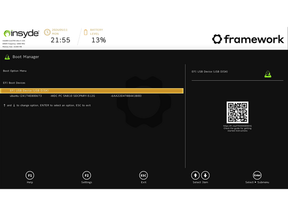

  4. Insert the USB drive into the powered off computer, and then power on. If an existing OS is installed on the Storage drive in the computer, immediately after the power light comes on begin tapping the F12 key before the Framework logo is visible. If no operating system is detected, the system will automatically boot from the Live USB.
    • Insert the USB drive into the powered off computer, and then power on. If an existing OS is installed on the Storage drive in the computer, immediately after the power light comes on begin tapping the F12 key before the Framework logo is visible.
    • If no operating system is detected, the system will automatically boot from the Live USB.
    • Select the USB drive. Press the enter key.
    • Next select CachyOS from the list (not the LTS version). Hit the enter key.

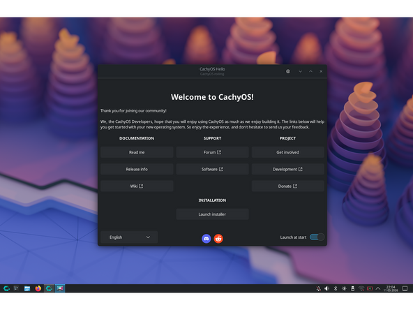

  5. In the bottom right corner of the screen, use the WiFi icon in the system tray to connect to a network. The installer will not work without it. The first thing to open on the live desktop is CachyOS Hello, a greeter window that provides links to a number of useful resources, an option to select language, and a button to open the installer. Click "Launch installer" in the CachyOS Hello window after connected to the internet. If the window was closed for any reason, it can be reopened using the Application Launcher on the left side of the task bar.
    • In the bottom right corner of the screen, use the WiFi icon in the system tray to connect to a network. The installer will not work without it.
    • The first thing to open on the live desktop is CachyOS Hello, a greeter window that provides links to a number of useful resources, an option to select language, and a button to open the installer.
    • Click "Launch installer" in the CachyOS Hello window after connected to the internet. If the window was closed for any reason, it can be reopened using the Application Launcher on the left side of the task bar.

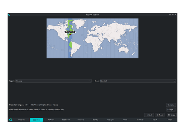

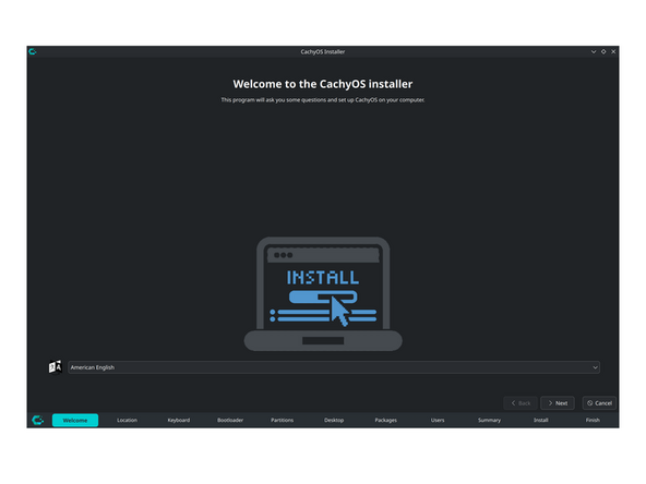

    • When the installer opens, select a language, region (locale), timezone, and keyboard layout, clicking "Next" to progress through each slide.

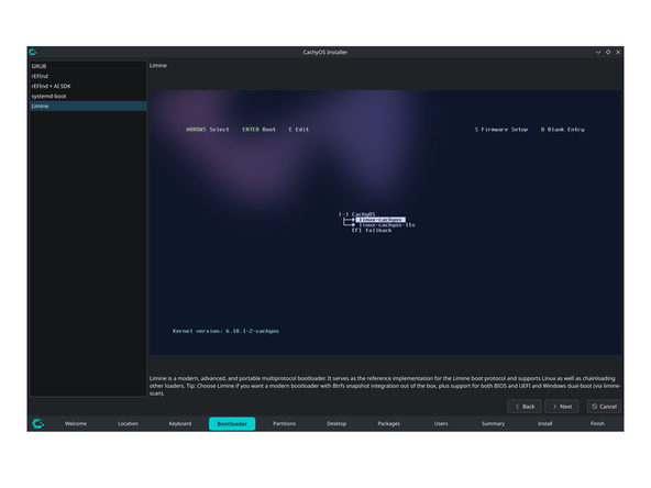

  6. Select a bootloader. The installer includes descriptions for each option. The installer defaults to Limine. GRUB is a very mature and well documented option that's also easy to get help with. The default option is the Limine, this is a newer option intended to work well with the snapshots feature of the default filesystem. GRUB is a traditional option that may be preferred by long-time Linux users.
    • Select a bootloader. The installer includes descriptions for each option. The installer defaults to Limine. GRUB is a very mature and well documented option that's also easy to get help with.
    • The default option is the Limine, this is a newer option intended to work well with the snapshots feature of the default filesystem.
    • GRUB is a traditional option that may be preferred by long-time Linux users.

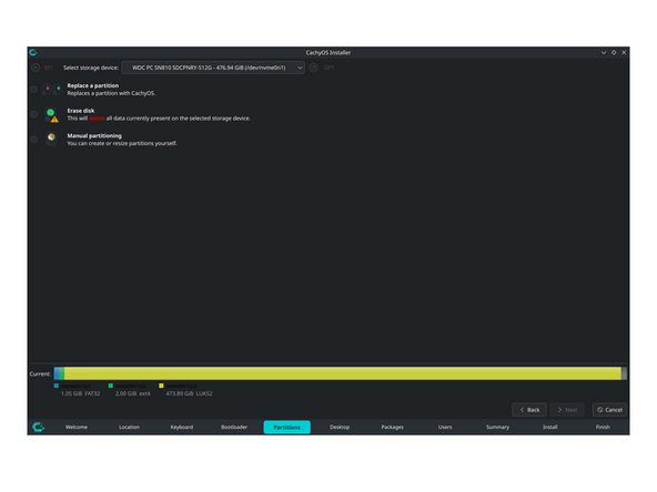

    • Select the drive for install and choose to Wipe the whole drive. A filesystem for the root partition can also be selected.
    • The default option is btrfs, a filesystem with features like snapshots that allow users to revert the system to a previous state if, for example, an update fails.

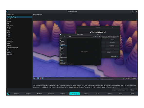

    • Select a desktop environment. Most of them are well described and have visual demonstrations to help selection.
    • The default option is KDE. This option will be familiar to Windows users. It can be heavily customized to the user's comfort.
    • Mac users may find Gnome or Cosmic Desktop more familiar or comfortable.

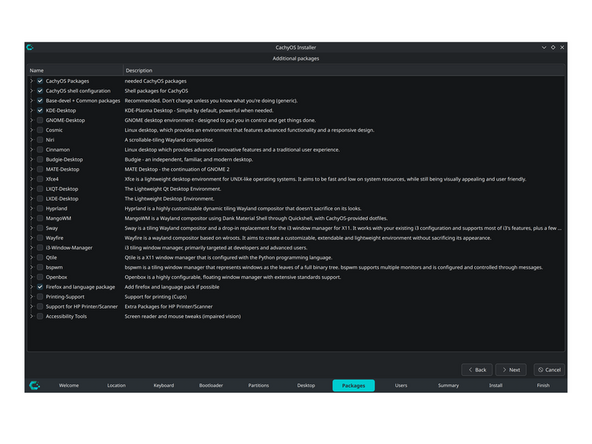

  7. There is an option selection for extra packages. While it isn't recommended to install multiple desktop environments or display managers, it is possible to do so. This is where support for Printers can be installed Set up the primary user by filling out the Name, Username, and Password fields with the relevant information.
    • There is an option selection for extra packages. While it isn't recommended to install multiple desktop environments or display managers, it is possible to do so.
    • This is where support for Printers can be installed

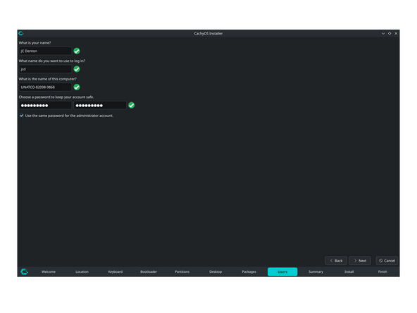

    • Set up the primary user by filling out the Name, Username, and Password fields with the relevant information.
    • Unchecking "Use the same password for Administrator account" allows a separate password to be set for the root account.

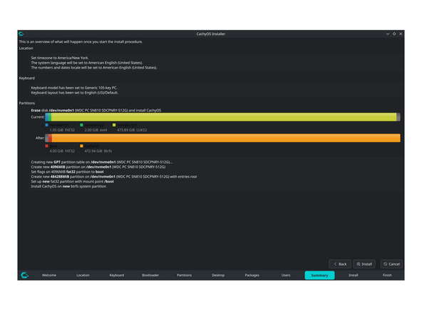

    • Review all the details on the Summary slide. This is the last chance to change install options and data is written to the drive.
    • After review, click Install then Install Now to finalize all selections and begin the install.
