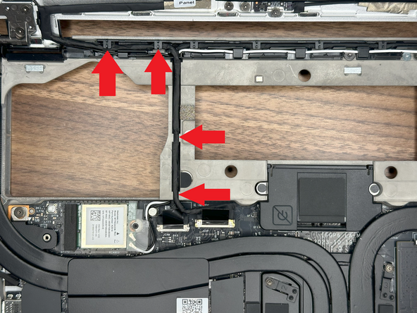

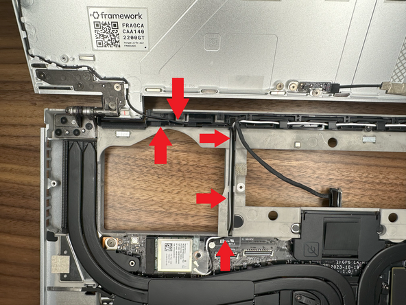

  1. Route the Black Antenna Cable through the left hinge; placing it in the front of the guided channel.
    • Route the Black Antenna Cable through the left hinge; placing it in the front of the guided channel.

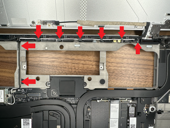

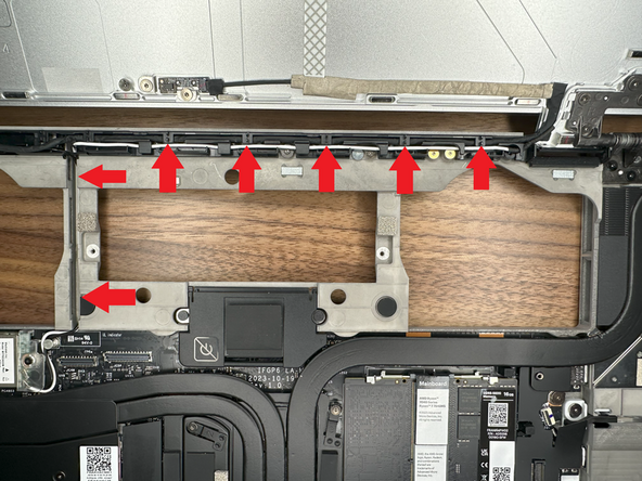

  2. Route the White Antenna Cable through the right hinge; placing it in the front guided channel.
    • Route the White Antenna Cable through the right hinge; placing it in the front guided channel.
  3. Route the Webcam Cable through the right hinge; placing it at the back of the guided channel.
    • Route the Webcam Cable through the right hinge; placing it at the back of the guided channel.
  4. Route the eDP Cable (Display) from the Display through the left hinge placing it in the rear guided channel.
    • Route the eDP Cable (Display) from the Display through the left hinge placing it in the rear guided channel.
