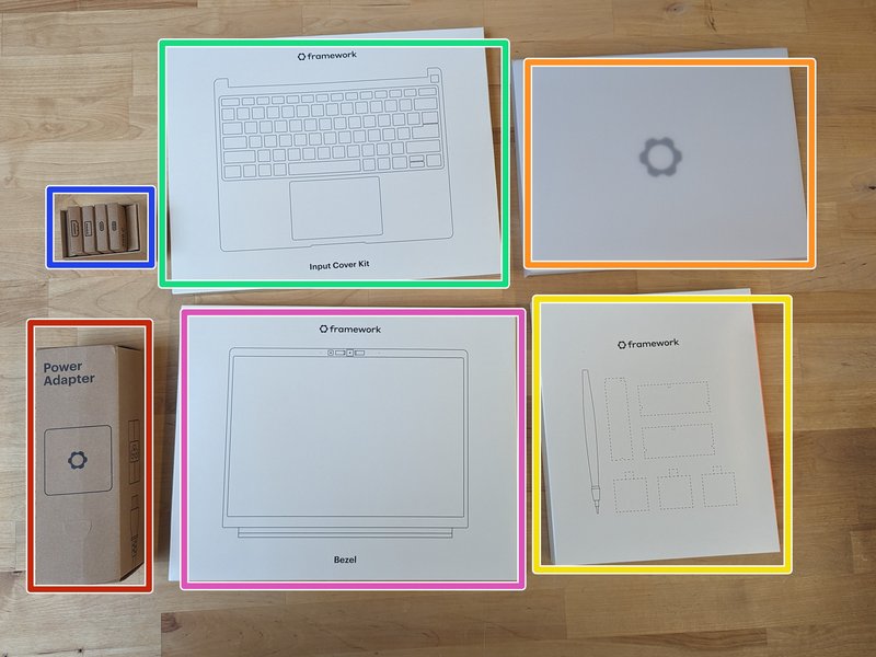

  • The first step is to open the box and identify the contents, the exact contents will vary depending on how you configured your Laptop, but inside the box you will find:
    • Bezel
    • Input Cover
    • Framework Laptop 13
    • Power Adapter
    • Expansion Cards
    • Storage, Memory, any additional Expansion Cards and importantly the Framework Screwdriver!
    • Note that depending on the retail packaging for Memory , this may be located underneath the Power Adapter instead.

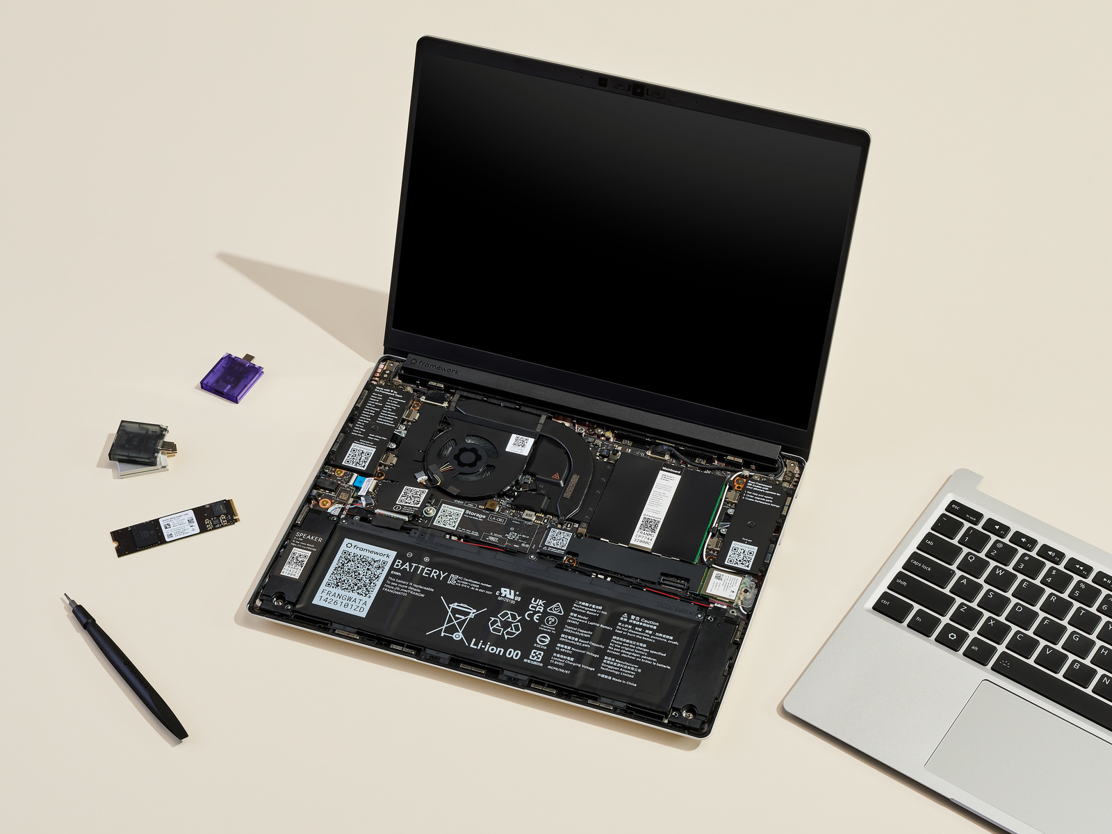

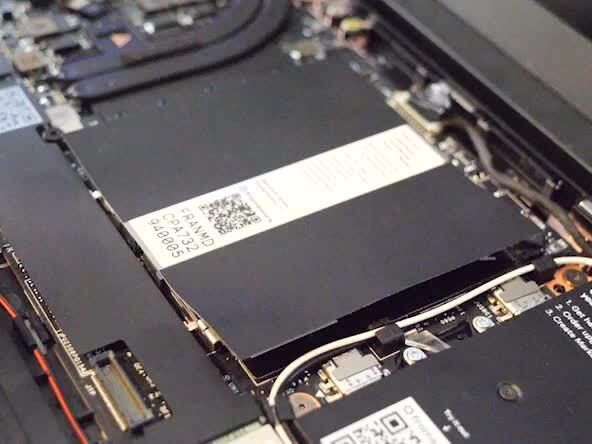

Step 4 — Insert the DDR5 Memory module
Guide image
  • Please make sure you are using DDR5 Memory as DDR4 Memory is not compatible with this Mainboard.
  • There are black mylar sheets covering the memory slots. These can be gently bent up to insert your memory modules.
    • Note: If you are using one Memory module, place it in the socket that is labelled “Channel 0."
  • Insert the Memory module into the Mainboard by aligning the notch on the Memory module with the notch on the socket. Note that for Channel 1 the notch is reversed so the Memory stick may need to be inserted "upside down" with the chips facing down depending on the brand used.
    • Make sure that the memory is fully inserted before proceeding.
  • Once the module is fully inserted, it will rise up at a 20-degree angle. Gently press it down towards the Mainboard until the clips located at the top and bottom of the receptacle snap into place.
  • The first boot after installing a new Memory module will take longer than normal, as the system prepares itself for the new module.

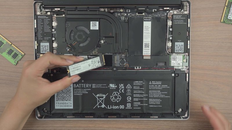

Step 5 — Install the SSD
Guide image
  • Using the T5 bit in the Framework Screwdriver, unscrew the fastener that is used to secure the Storage module.
  • Align the notch on the Storage module with the notch on the socket and slide the module into the Mainboard.
  • Once properly inserted the module will rise up at a 20-degree angle.
  • Using one finger gently hold the Storage module down to the Mainboard and use your other hand to screw in the fastener using the T5 bit in the Framework Screwdriver.

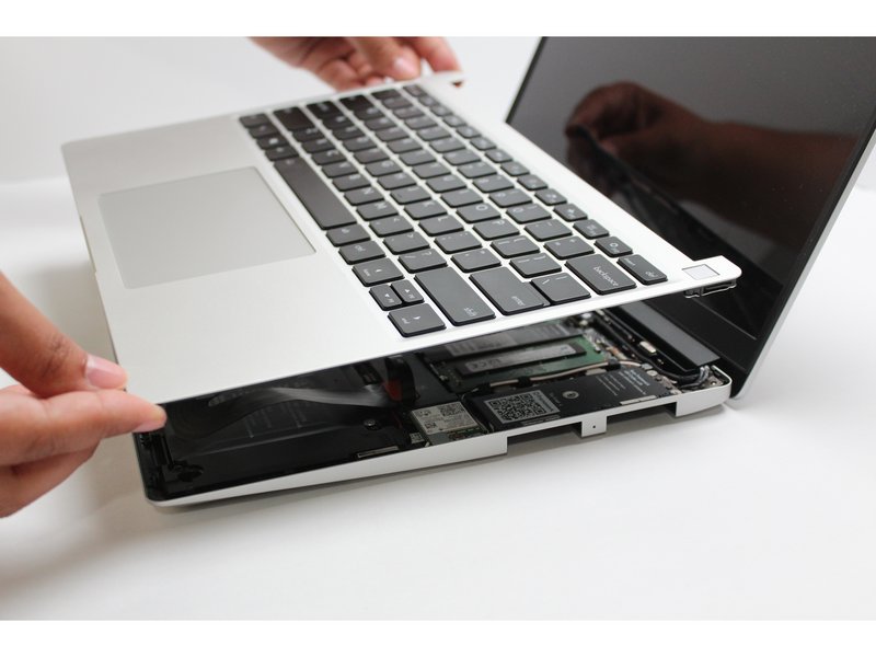

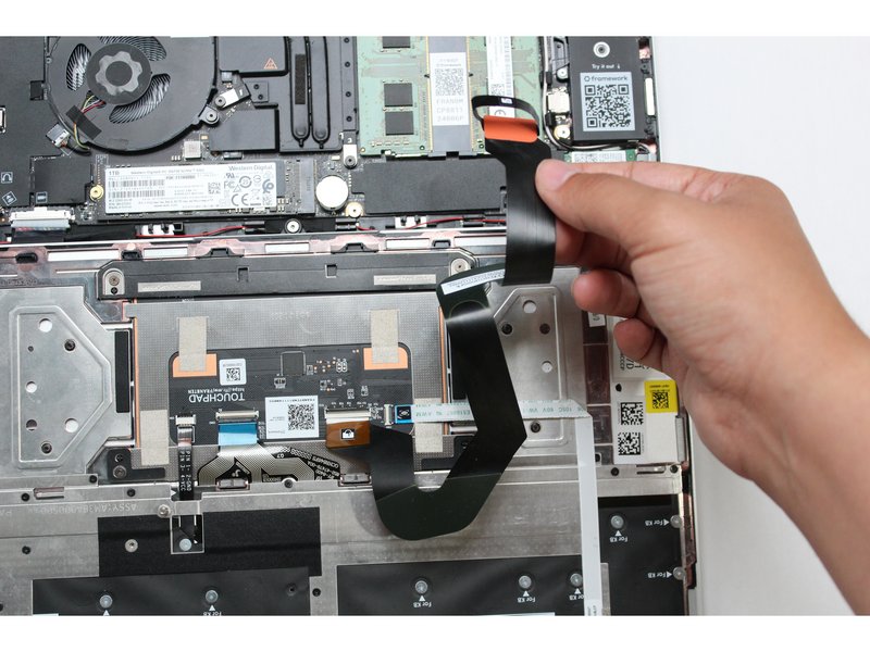

Step 6 — Install the new Input Cover
  • Guide image
  • Guide image
  • Guide image

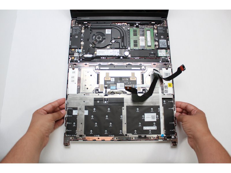

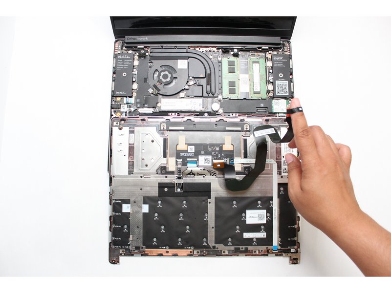

  • Gently place the Input Cover keyboard side down on the Bottom Cover as indicated on the image. The cover should be about an inch and a half away from the bottom of the Mainboard so that you can comfortably install the Touchpad Cable.
  • Note: The orientation of the Input Cover matters. Study the first image in this step to ensure you are properly attaching the cover.

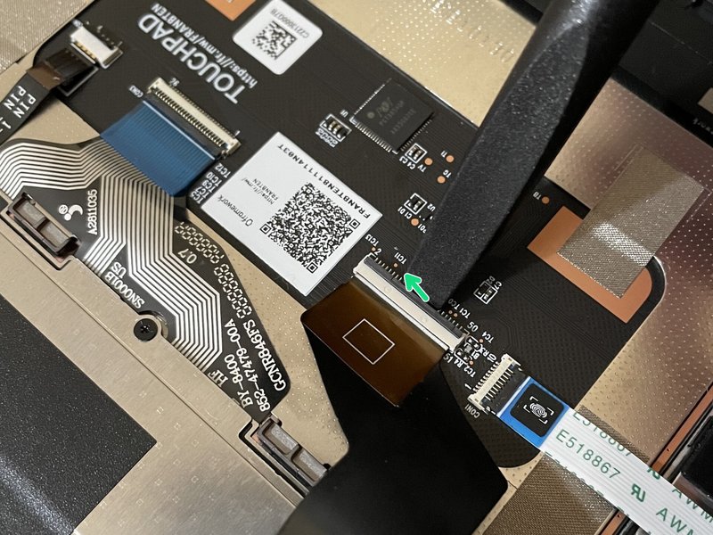

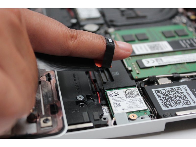

  • Locate the loop on the end of the Touchpad Cable and insert your finger into it.

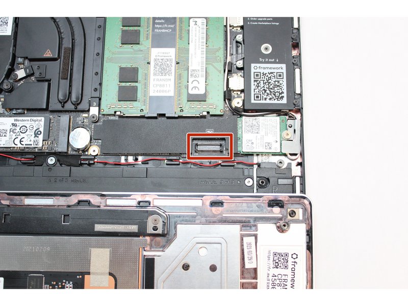

Step 7 — Connect the Touchpad Cable
  • Guide image
  • Guide image
  • Guide image

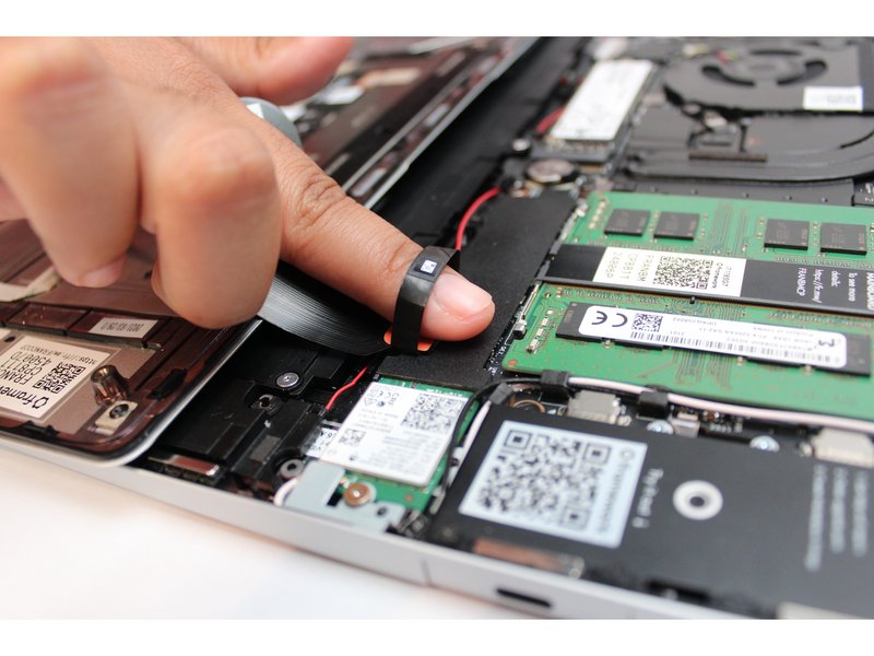

Step 8 — Make sure the Touchpad side of the Touchpad Cable is fully inserted
  • Guide image
  • Guide image

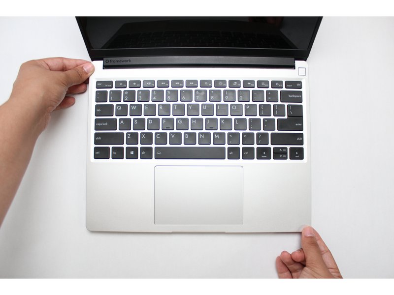

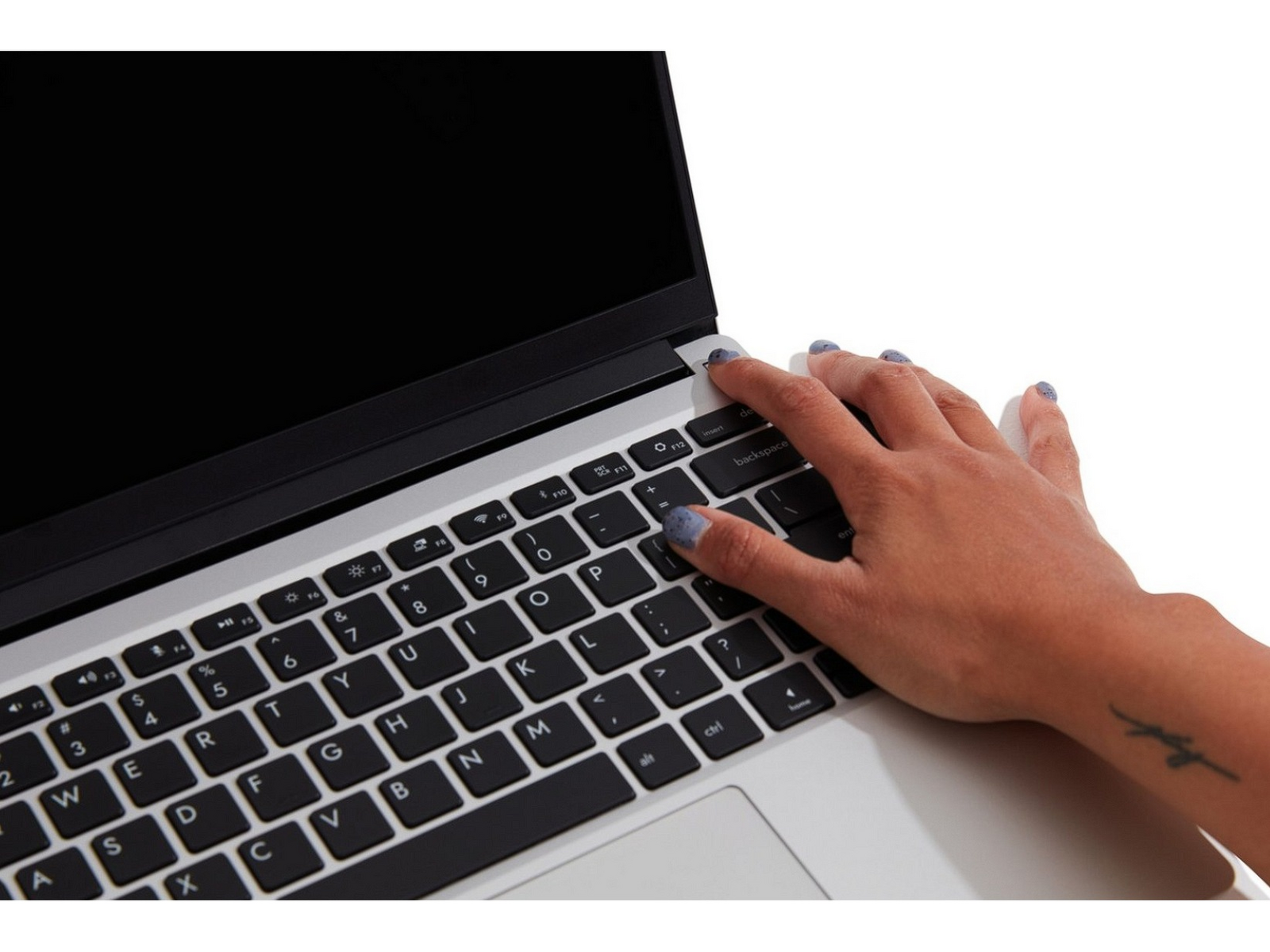

Step 9 — Flip the Input Cover into place
  • Guide image
  • Guide image
  • Guide image
  • Note that the Input Cover will not sit entirely flat until the bottom fasteners are tightened. The bottom right corner is slightly lifted to make it easy to remove the Input Cover.

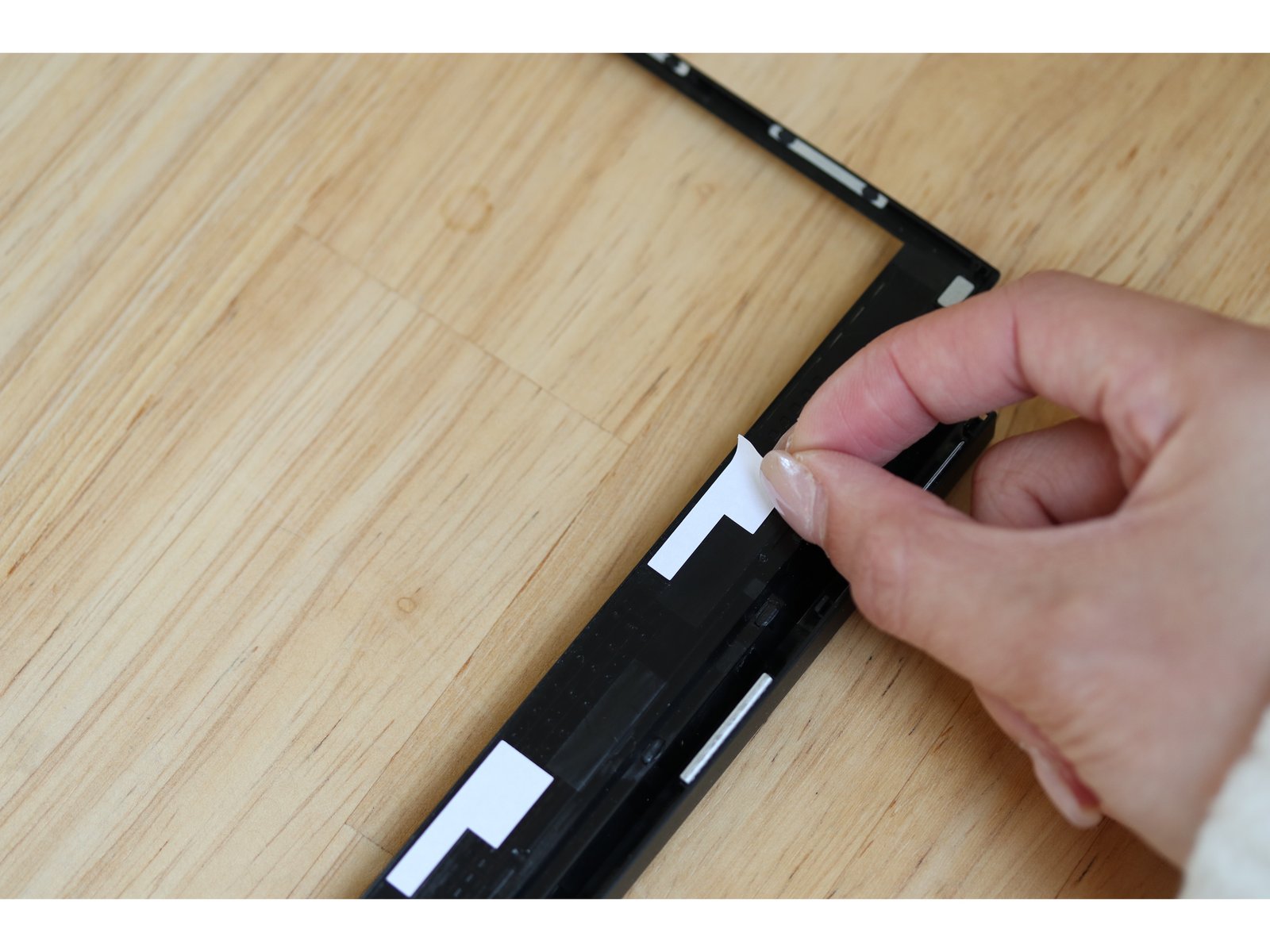

Step 10 — Remove the adhesive from the Bezel
Guide image
  • If installing a new Bezel, remove the liner pieces on the bottom of the Bezel to expose the adhesive (if present).

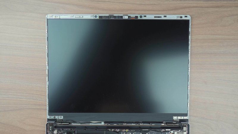

Step 11 — Install the Bezel
Guide image
  • Open the Framework Laptop 180 degrees to attach the Bezel.
  • Starting with the bottom of the Bezel which covers the hinges and cables, align the corners of the Bezel to the display and place it down. The Bezel is attached by magnets and should easily click into place.
  • We recommend feeling along each edge of the Bezel to make sure it is seated correctly before proceeding, if it doesn't seem to be sitting flush, lift it back up and try lowering it into place again.
  • Do not try to install the Bezel without first opening the Laptop fully, doing so could damage the Bezel and potentially the Display.
  • If the bottom of the Bezel doesn't seem to fit, lift it back off and check that the cables are seated correctly on both sides. If the Bezel doesn't seem to fit at all, please contact support and do not force it into place.

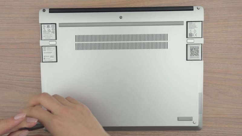

  • Close the Framework Laptop and place it upside down to reveal the fasteners on the Bottom Cover.

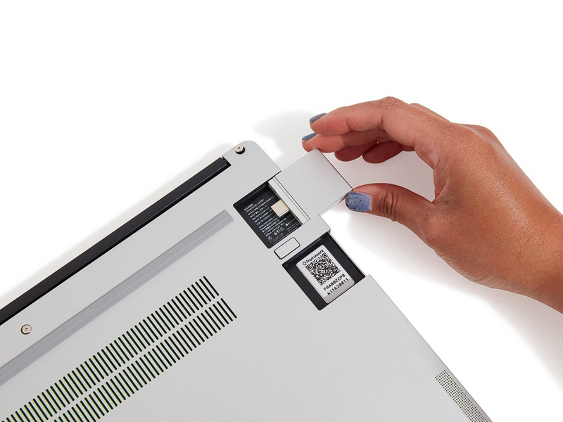

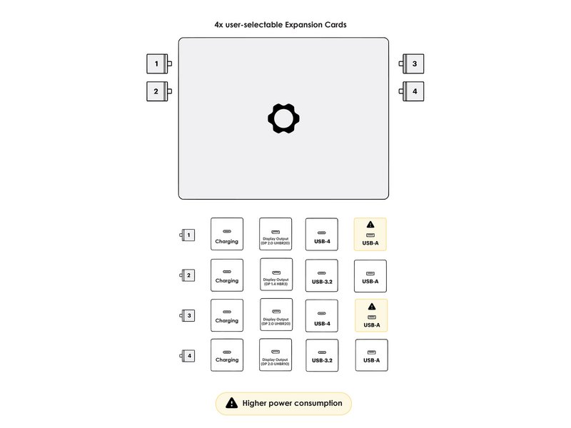

  • Insert the Expansion Cards of your choice. With keyboard face up, this configuration supports USB 4 and DP 2.0 UHBR20 on the upper left and right slots. The lower left slot supports USB 3.2 and DP 1.4 HBR3; lower right supports DP 2.0 UHBR10.
    • All ports can be used for charging via USB. A diagram of Expansion Card compatibility can be found here.
    • Note that USB-A Expansion Cards when placed in the back two slots will result in higher power consumption. Check the KB article for more detail on this.
  • The text, logo, and QR code on the Expansion Card must be facing down (facing the laptop). Slide the Expansion card into the bay. Using two or more fingers push the card until into the bay until it clicks.
    • You will have to use a slight amount of force to ensure proper installation of the Expansion Cards.

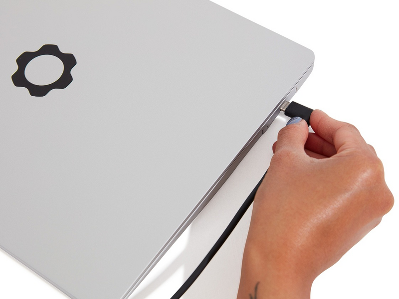

  • Plug your power cable into the USB-C Expansion Card.
