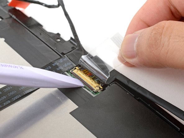

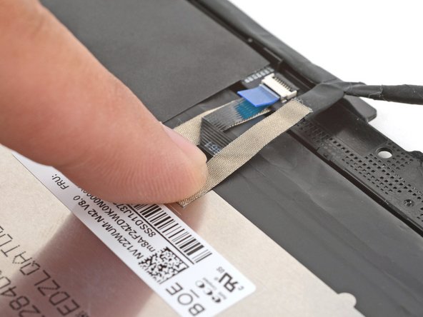

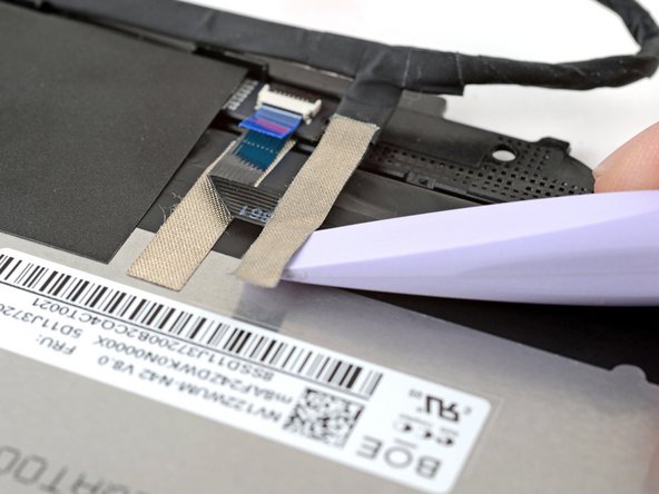

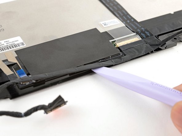

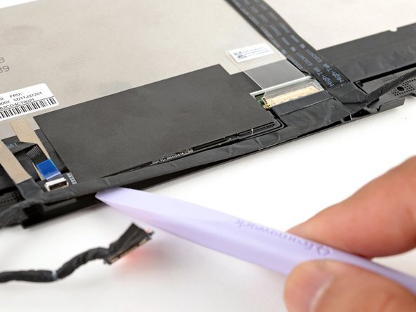

  41. Slide the flat end of your Framework Screwdriver under the grounding tape securing the display cable. Lift slowly to separate the tape from the display.
    • Slide the flat end of your Framework Screwdriver under the grounding tape securing the display cable.
    • Lift slowly to separate the tape from the display.

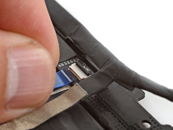

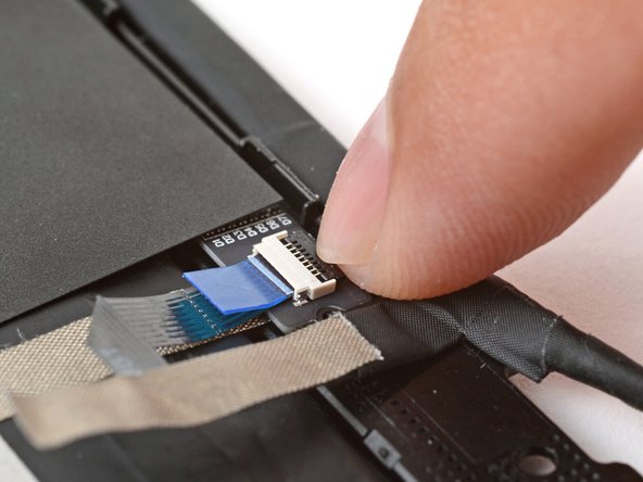

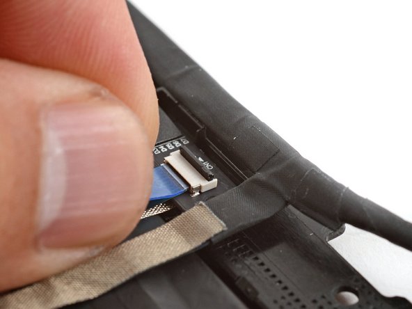

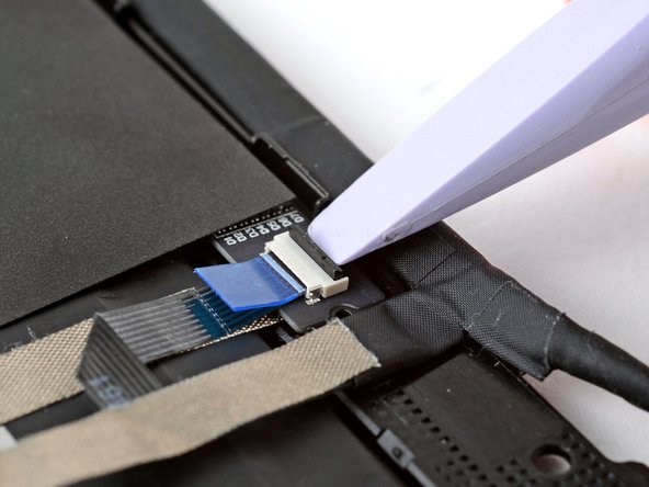

  42. Use the flat end of your Framework Screwdriver or a fingernail to gently pry up the locking tab on the touch control ZIF connector near the hinge edge of the display. Use your fingers to grab the touch control cable by the blue tab and slide the cable out of the connector. Use your fingers to grab the touch control cable by the blue tab and slide the cable out of the connector.
    • Use the flat end of your Framework Screwdriver or a fingernail to gently pry up the locking tab on the touch control ZIF connector near the hinge edge of the display.
    • Use your fingers to grab the touch control cable by the blue tab and slide the cable out of the connector.

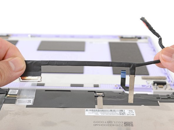

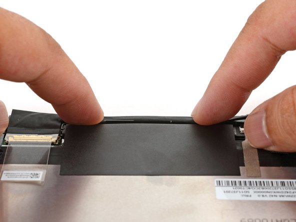

  43. Slide the flat edge of your Framework Screwdriver under the length of the display cable to separate it from the display. Slide the flat edge of your Framework Screwdriver under the length of the display cable to separate it from the display.
    • Slide the flat edge of your Framework Screwdriver under the length of the display cable to separate it from the display.

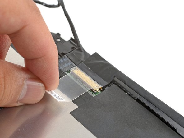

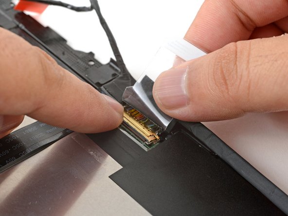

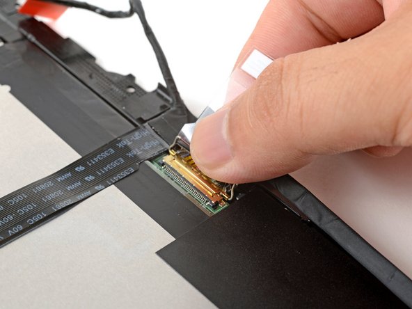

  44. Use your fingers to peel up the clear tab covering the display cable connector. Use your fingers to peel up the clear tab covering the display cable connector.
    • Use your fingers to peel up the clear tab covering the display cable connector.

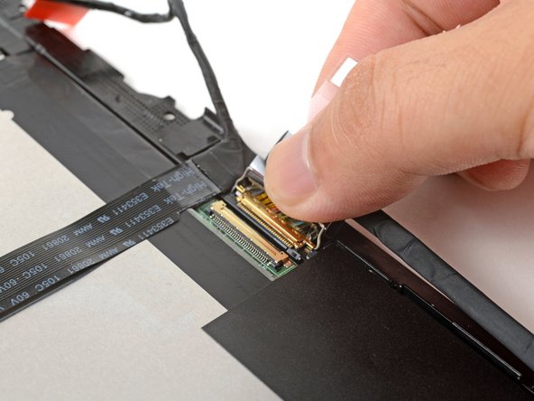

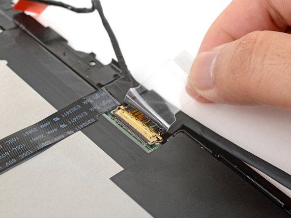

  45. Use the flat end of your Framework Screwdriver to flip up the locking bar around the display connector. Use the flat end of your Framework Screwdriver to flip up the locking bar around the display connector.
    • Use the flat end of your Framework Screwdriver to flip up the locking bar around the display connector.

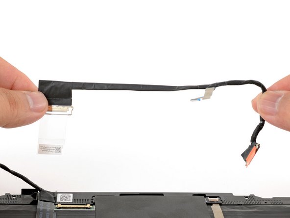

  46. Make sure the locking bar doesn't fall back in place while you disconnect the display cable. Grab the display cable near the connector and slide it out of the connector.
    • Make sure the locking bar doesn't fall back in place while you disconnect the display cable.
    • Grab the display cable near the connector and slide it out of the connector.
    • If you have trouble getting the cable to slide out, gently wiggle it to loosen the connection.
  47. Remove the display cable.
    • Remove the display cable.

    • Lay the clear tab over the connector and press it onto the display.
  51. Slide the touch control cable into the ZIF connector up to the printed line on the cable. Use your finger to flip down and gently press the locking tab in place. Use your finger to flip down and gently press the locking tab in place.
    • Slide the touch control cable into the ZIF connector up to the printed line on the cable.
    • Use your finger to flip down and gently press the locking tab in place.
  52. Use your finger to press the display cable grounding tape onto the display. Use your fingers to press the display cable onto the metal back of the display.
    • Use your finger to press the display cable grounding tape onto the display.
    • Use your fingers to press the display cable onto the metal back of the display.
  53. Lay the display in place in the Top Cover, such that the top edge of the display is slightly below the top edge of the Top Cover. Lay the display in place in the Top Cover, such that the top edge of the display is slightly below the top edge of the Top Cover. Lay the display in place in the Top Cover, such that the top edge of the display is slightly below the top edge of the Top Cover.
    • Lay the display in place in the Top Cover, such that the top edge of the display is slightly below the top edge of the Top Cover.
