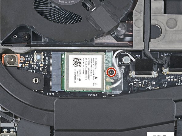

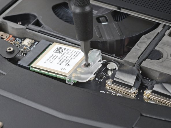

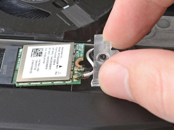

  11. Use your Framework Screwdriver to loosen the captive T5 Torx screw securing Wi-Fi module. The module might pop up at a shallow angle when you loosen the screw.
    • Use your Framework Screwdriver to loosen the captive T5 Torx screw securing Wi-Fi module.
    • The module might pop up at a shallow angle when you loosen the screw.

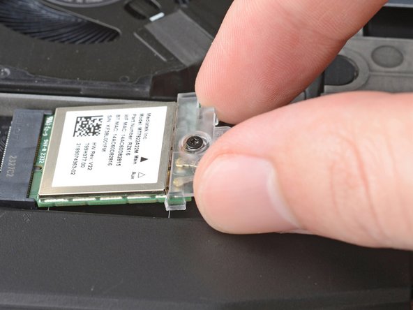

  12. Slide the clear plastic cover straight off the module and remove it. Slide the clear plastic cover straight off the module and remove it.
    • Slide the clear plastic cover straight off the module and remove it.

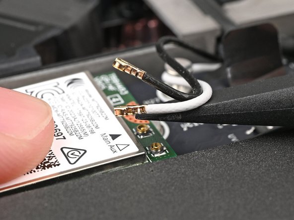

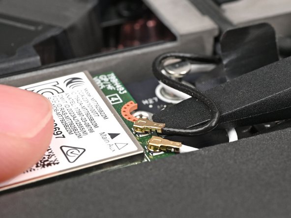

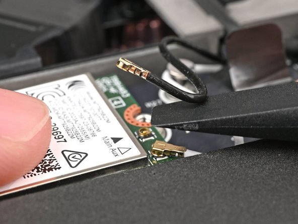

  13. While holding the Wi-Fi module down, insert the flat end of your Framework Screwdriver under one of the coaxial connectors, where the cable meets the metal head. Lift the screwdriver straight up to disconnect the coaxial cable. Repeat for the other coaxial cable.
    • While holding the Wi-Fi module down, insert the flat end of your Framework Screwdriver under one of the coaxial connectors, where the cable meets the metal head.
    • Lift the screwdriver straight up to disconnect the coaxial cable.
    • Repeat for the other coaxial cable.

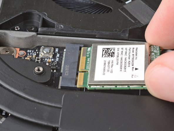

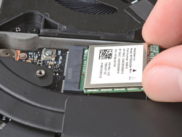

  14. Grip the end of the Wi-Fi Module with the screw hole and slide it out of its socket. Remove the Wi-Fi Module.
    • Grip the end of the Wi-Fi Module with the screw hole and slide it out of its socket.
    • Remove the Wi-Fi Module.

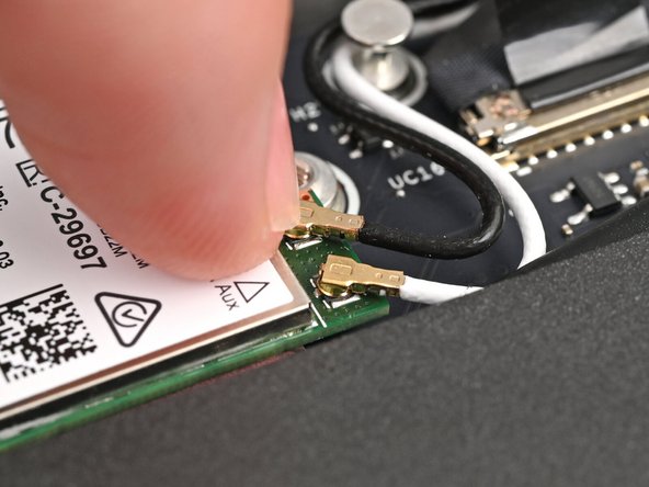

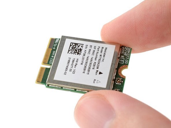

  16. Hold the Wi-Fi module by its edges. Don't touch the gold contacts with your fingers. If you do, wipe the contacts with a clean, lint-free cloth to remove any finger oils. Align the Wi-Fi module's gold contacts and notch with the socket on the Mainboard.

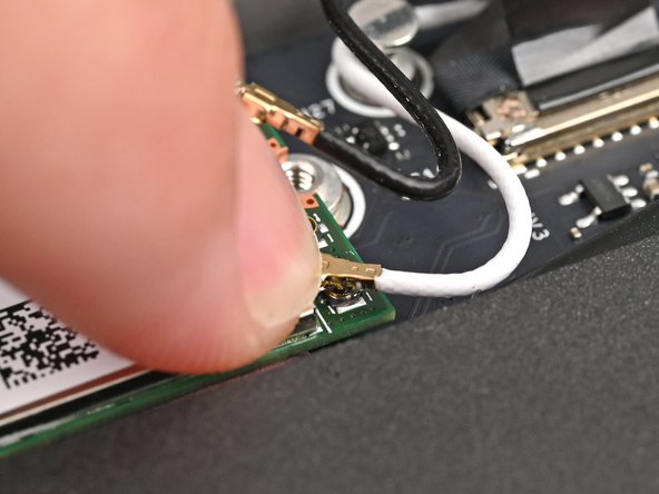

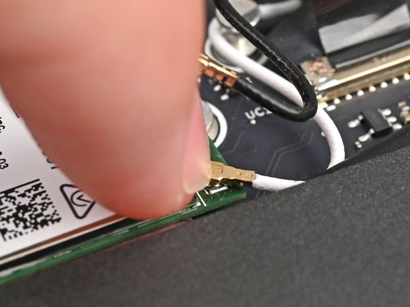

  17. Hold the Wi-Fi module down with your finger. Position the white antenna cable connector over the left Wi-Fi module's coaxial socket. If you're unsure which cable goes where, refer to the arrows on the Wi-Fi module for which color cable matches with its connector.
    • Hold the Wi-Fi module down with your finger.
    • Position the white antenna cable connector over the left Wi-Fi module's coaxial socket.
    • If you're unsure which cable goes where, refer to the arrows on the Wi-Fi module for which color cable matches with its connector.
    • Repeat the procedure with the black antenna cable.
  18. Slide the clear plastic cover on the module and align its screw with the screw hole cutout. Slide the clear plastic cover on the module and align its screw with the screw hole cutout.
    • Slide the clear plastic cover on the module and align its screw with the screw hole cutout.
  19. Use your Framework Screwdriver to tighten the captive T5 Torx screw securing Wi-Fi module. Use your Framework Screwdriver to tighten the captive T5 Torx screw securing Wi-Fi module.
    • Use your Framework Screwdriver to tighten the captive T5 Torx screw securing Wi-Fi module.
