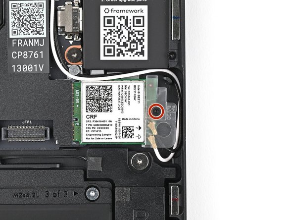

  7. Use your Framework Screwdriver to loosen the captive T5 Torx screw securing the Wi-Fi module. The module might pop up at a shallow angle when you loosen the screw.
    • Use your Framework Screwdriver to loosen the captive T5 Torx screw securing the Wi-Fi module.
    • The module might pop up at a shallow angle when you loosen the screw.

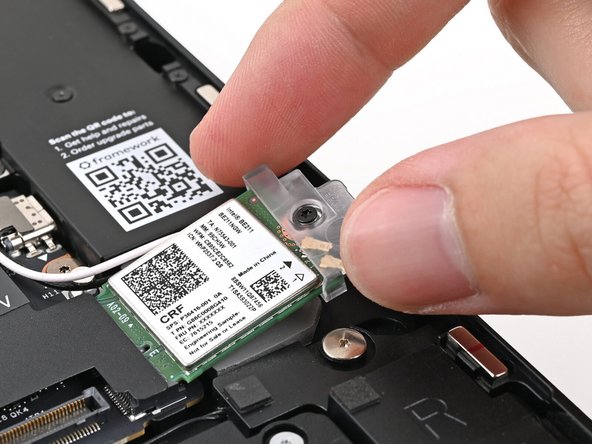

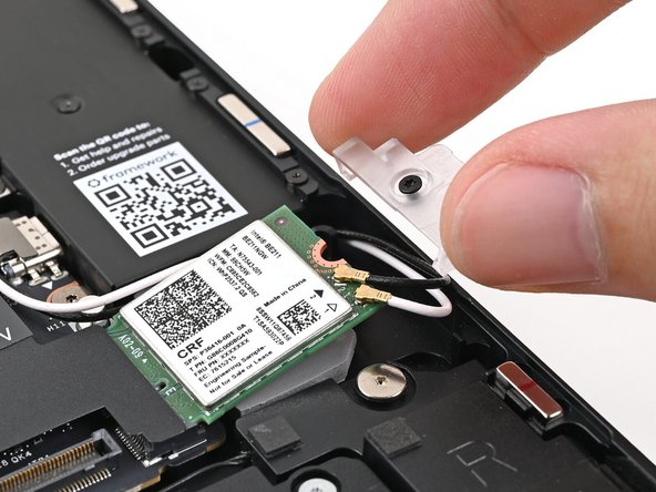

  8. Slide the clear plastic cover straight off the module and remove it. Slide the clear plastic cover straight off the module and remove it.
    • Slide the clear plastic cover straight off the module and remove it.

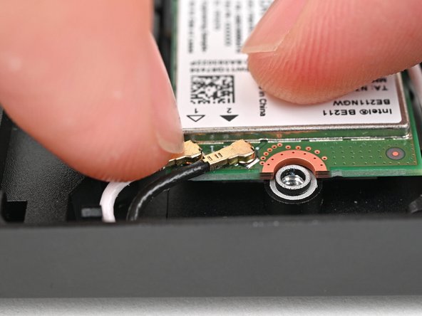

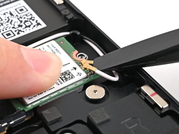

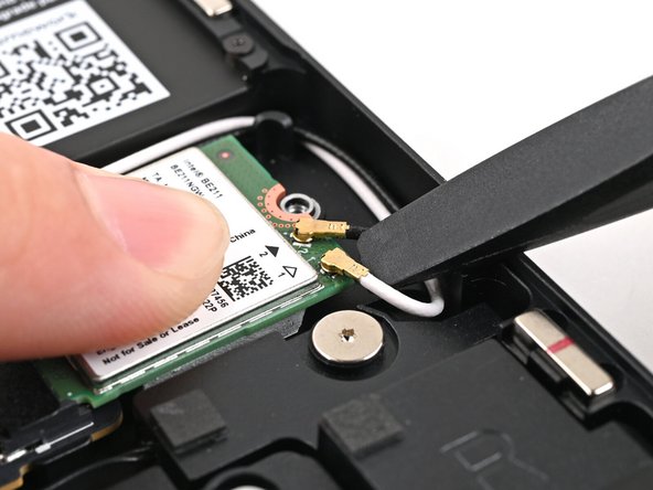

  9. While holding the Wi-Fi module down, insert the flat end of your Framework Screwdriver under one of the coaxial connectors, where the cable meets the metal head. Lift the screwdriver straight up to disconnect the coaxial cable. Repeat for the other coaxial cable.
    • While holding the Wi-Fi module down, insert the flat end of your Framework Screwdriver under one of the coaxial connectors, where the cable meets the metal head.
    • Lift the screwdriver straight up to disconnect the coaxial cable.
    • Repeat for the other coaxial cable.

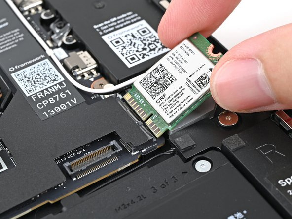

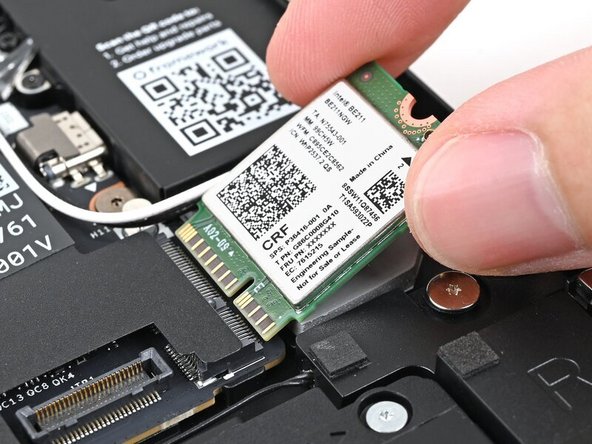

  10. Grip the end of the Wi-Fi module with the screw hole and slide it out of its socket. Grip the end of the Wi-Fi module with the screw hole and slide it out of its socket.
    • Grip the end of the Wi-Fi module with the screw hole and slide it out of its socket.

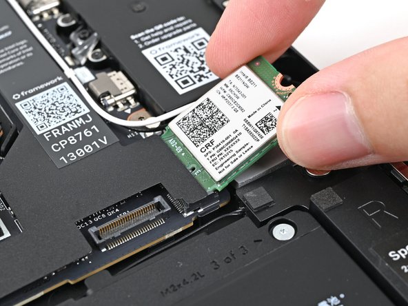

  12. Grip the end of the Wi-Fi module with the screw hole and slide it straight into its socket. Grip the end of the Wi-Fi module with the screw hole and slide it straight into its socket.
    • Grip the end of the Wi-Fi module with the screw hole and slide it straight into its socket.

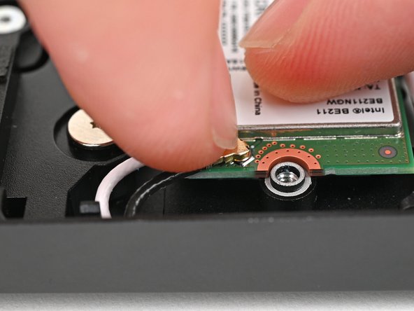

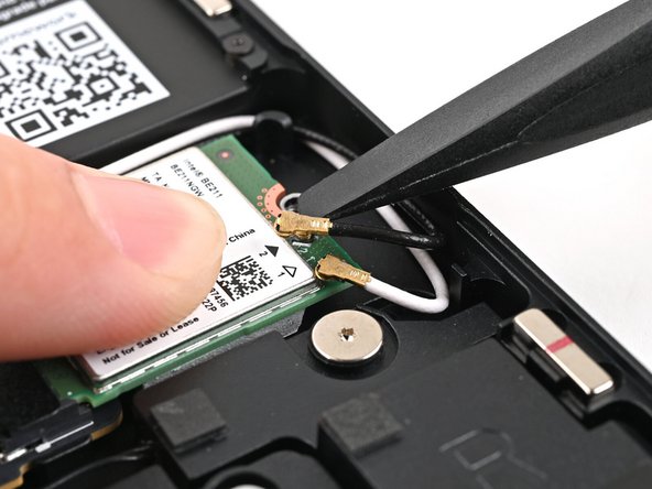

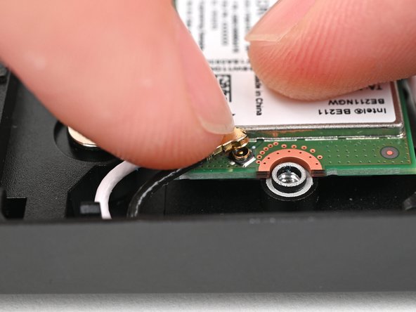

  13. Hold the Wi-Fi module down with your finger. Position the black antenna cable connector over the Wi-Fi module's coaxial socket labeled by the black arrow. If you're unsure which cable goes where, refer to the arrows on the Wi-Fi module for which color cable matches with its connector.
    • Hold the Wi-Fi module down with your finger.
    • Position the black antenna cable connector over the Wi-Fi module's coaxial socket labeled by the black arrow.
    • If you're unsure which cable goes where, refer to the arrows on the Wi-Fi module for which color cable matches with its connector.
    • These connectors are delicate! If the connector doesn't feel like it's clicking in place, reposition the connector and try again.
    • Repeat the procedure with the white antenna cable.
  14. Slide the clear plastic cover onto the module and align its screw with the screw hole cutout. Slide the clear plastic cover onto the module and align its screw with the screw hole cutout.
    • Slide the clear plastic cover onto the module and align its screw with the screw hole cutout.
