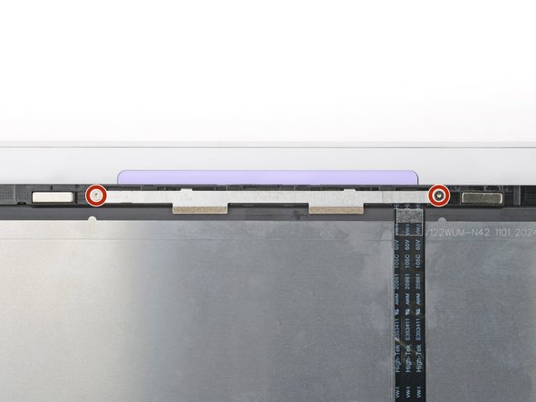

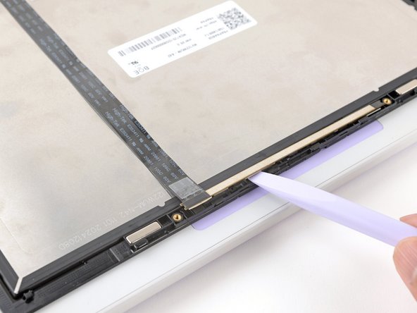

  10. Use your Framework Screwdriver to remove the two 3.3 mm‑long T5 Torx screws securing the webcam bracket on the top edge behind the display.
    • Use your Framework Screwdriver to remove the two 3.3 mm‑long T5 Torx screws securing the webcam bracket on the top edge behind the display.
    • These screws are not captive. Store them in a safe location for reassembly.

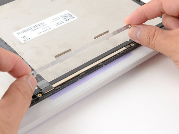

  11. Lift and remove the webcam bracket. Lift and remove the webcam bracket.
    • Lift and remove the webcam bracket.

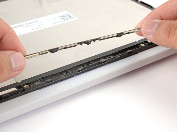

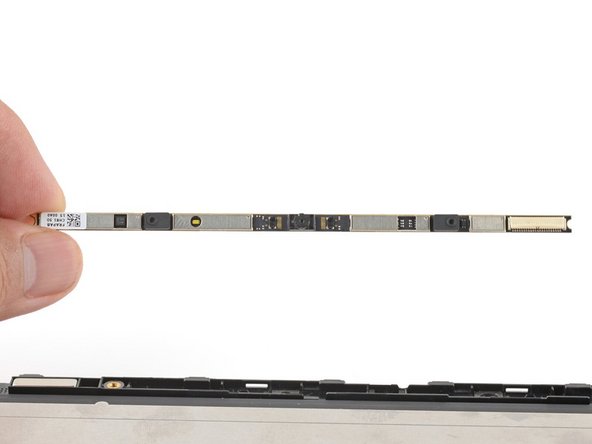

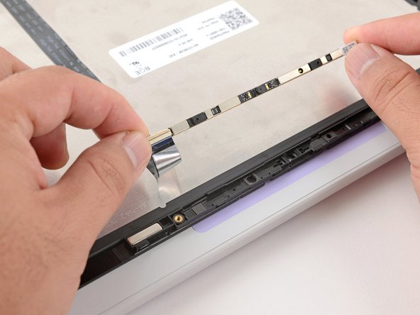

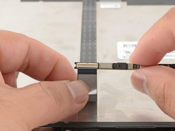

  12. Use the flat end of your Framework Screwdriver to lift the webcam out of its recess. Avoid touching the black camera module near the center of the webcam. Flip the webcam over and gently hold it down with your fingers.
    • Use the flat end of your Framework Screwdriver to lift the webcam out of its recess.
    • Avoid touching the black camera module near the center of the webcam.
    • Flip the webcam over and gently hold it down with your fingers.

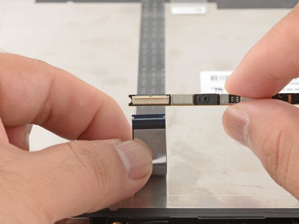

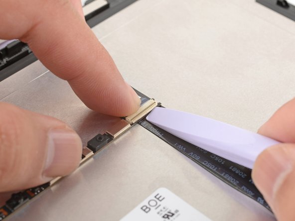

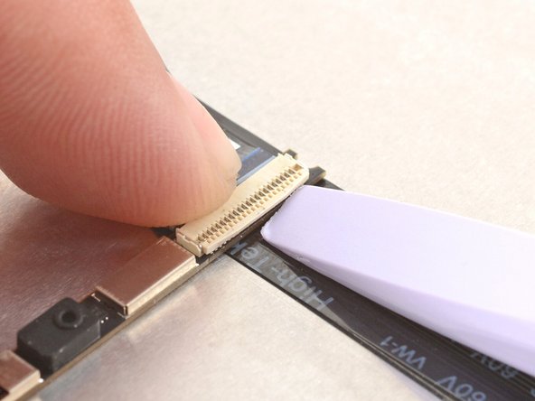

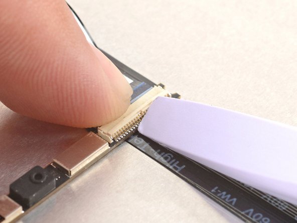

  13. Use the flat end of your Framework Screwdriver or a fingernail to gently pry up the locking tab on the webcam cable ZIF connector. Use the flat end of your Framework Screwdriver or a fingernail to gently pry up the locking tab on the webcam cable ZIF connector. Use the flat end of your Framework Screwdriver or a fingernail to gently pry up the locking tab on the webcam cable ZIF connector.
    • Use the flat end of your Framework Screwdriver or a fingernail to gently pry up the locking tab on the webcam cable ZIF connector.
  14. Slide the webcam cable out of its connector. Remove the webcam. Remove the webcam.
    • Slide the webcam cable out of its connector.
    • Remove the webcam.

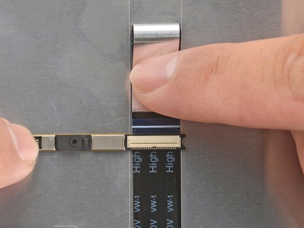

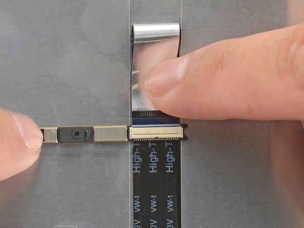

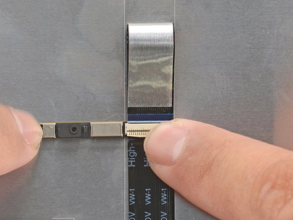

  17. Bend an inch (2.5 cm) of the webcam cable over so that the shiny side is facing you. Slide the webcam cable into the ZIF connector up to the printed line on the cable. Use your finger to flip down and gently press the locking tab in place.
    • Bend an inch (2.5 cm) of the webcam cable over so that the shiny side is facing you.
    • Slide the webcam cable into the ZIF connector up to the printed line on the cable.
    • Use your finger to flip down and gently press the locking tab in place.

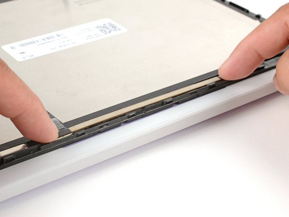

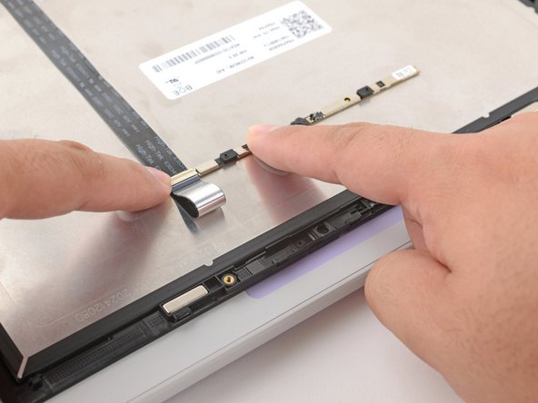

  18. Use your fingers to flip the webcam back into its recess in the Top Cover. Use your fingers to flip the webcam back into its recess in the Top Cover.
    • Use your fingers to flip the webcam back into its recess in the Top Cover.

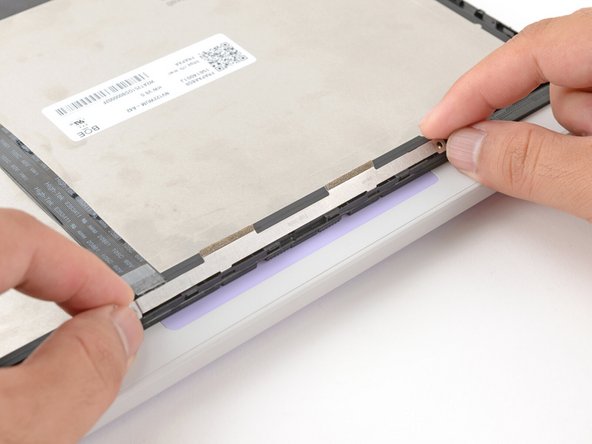

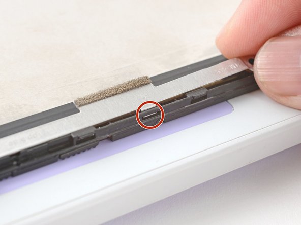

  19. Align the webcam bracket to the Top Cover and lay it in place. Make sure the tabs on the top edge of the webcam bracket sit in their slots on the top edge of the display. Make sure the tabs on the top edge of the webcam bracket sit in their slots on the top edge of the display.
    • Align the webcam bracket to the Top Cover and lay it in place.
    • Make sure the tabs on the top edge of the webcam bracket sit in their slots on the top edge of the display.
