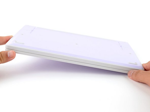

  5. Use your Framework Screwdriver to fully loosen the eight captive T5 Torx screws on the bottom of your laptop. Most screws in your Framework Laptop (including these) are captive—they're designed to stay in place after you loosen them.
  6. Flip your laptop face-up on your work surface.

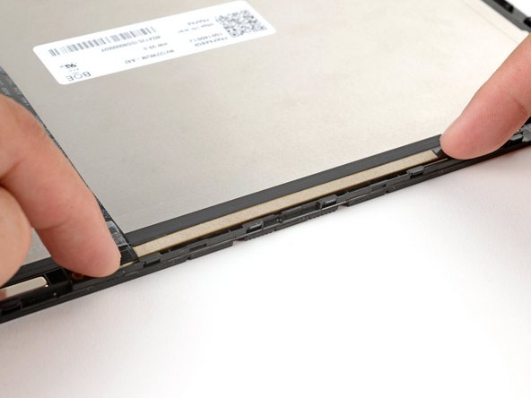

  38. Use your fingers to hold the bottom edge of the Top Cover in place. Insert the bit end of your Framework Screwdriver into the small hole on the display, below the Framework logo.
    • Use your fingers to hold the bottom edge of the Top Cover in place.
    • Insert the bit end of your Framework Screwdriver into the small hole on the display, below the Framework logo.
    • Slide the display down towards the hinge edge to release the tabs holding the top edge of the display in place.
  39. Use your fingers to lift the top edge of the display from the Top Cover. Use your fingers to lift the top edge of the display from the Top Cover.
    • Use your fingers to lift the top edge of the display from the Top Cover.
  40. Lift and remove the display from the Top Cover. Lift and remove the display from the Top Cover.
    • Lift and remove the display from the Top Cover.

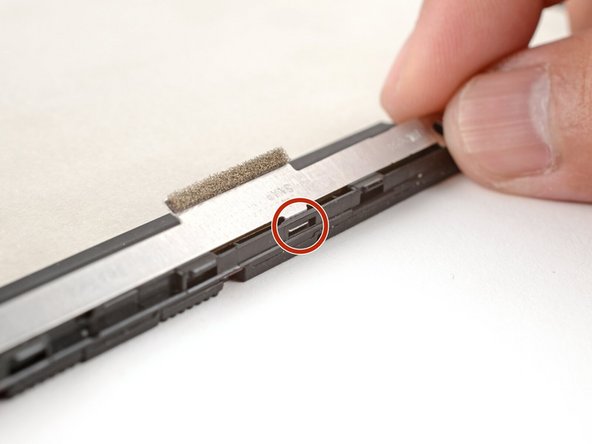

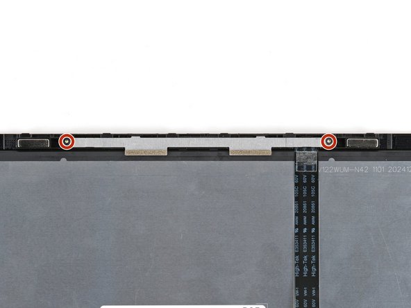

  41. Use your Framework Screwdriver to remove the two 3.3 mm‑long T5 Torx screws securing the webcam bracket on the top edge behind the display.
    • Use your Framework Screwdriver to remove the two 3.3 mm‑long T5 Torx screws securing the webcam bracket on the top edge behind the display.
    • These screws are not captive. Store them in a safe location for reassembly.
  42. Lift and remove the webcam bracket. Lift and remove the webcam bracket.
    • Lift and remove the webcam bracket.

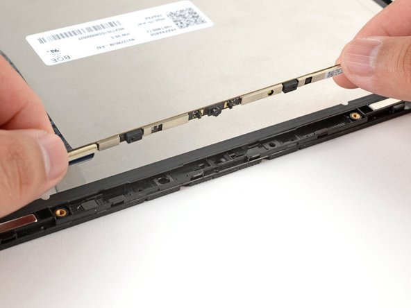

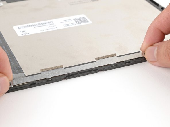

  43. Use the flat end of your Framework Screwdriver to lift the webcam out of its recess. Avoid touching the black camera module near the center of the webcam. Flip the webcam over and gently hold it down with your fingers.
    • Use the flat end of your Framework Screwdriver to lift the webcam out of its recess.
    • Avoid touching the black camera module near the center of the webcam.
    • Flip the webcam over and gently hold it down with your fingers.

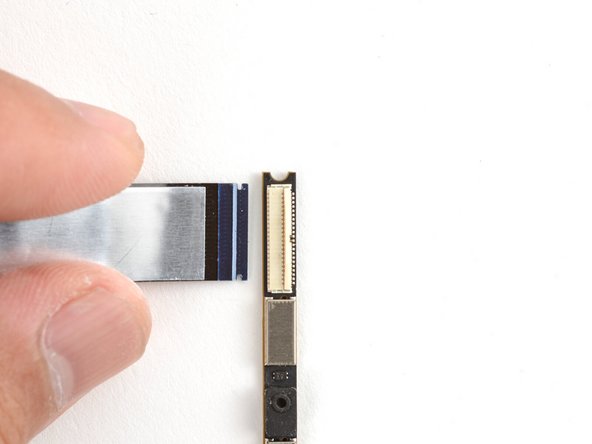

  44. Use the flat end of your Framework Screwdriver or a fingernail to gently pry up the locking tab on the webcam cable ZIF connector. Use the flat end of your Framework Screwdriver or a fingernail to gently pry up the locking tab on the webcam cable ZIF connector. Use the flat end of your Framework Screwdriver or a fingernail to gently pry up the locking tab on the webcam cable ZIF connector.
    • Use the flat end of your Framework Screwdriver or a fingernail to gently pry up the locking tab on the webcam cable ZIF connector.
  45. Slide the webcam cable out of its connector. Remove the webcam. Remove the webcam.
    • Slide the webcam cable out of its connector.
    • Remove the webcam.

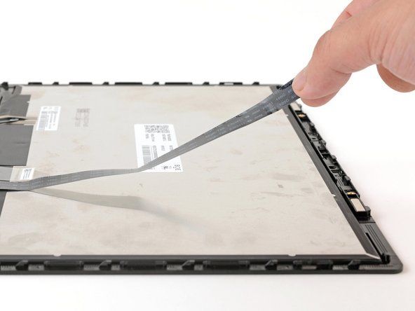

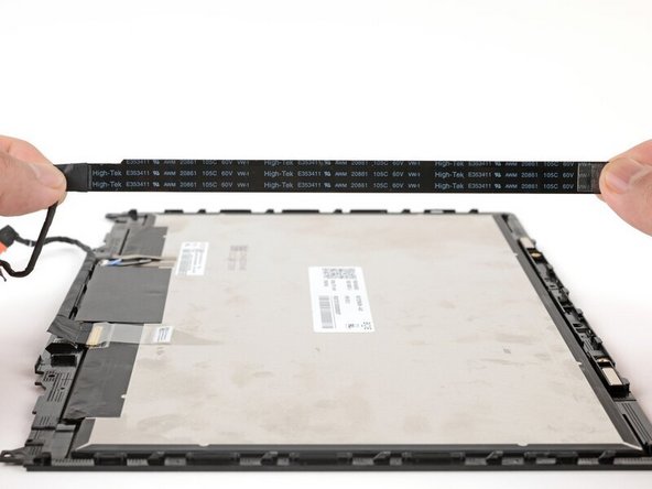

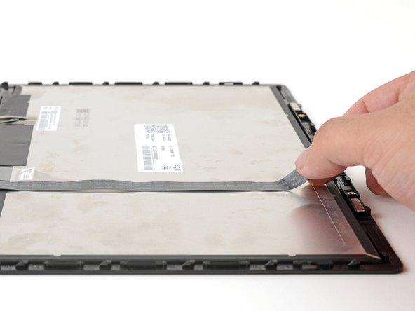

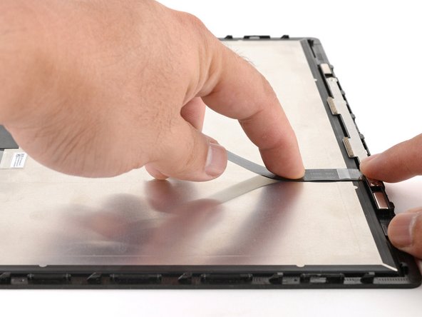

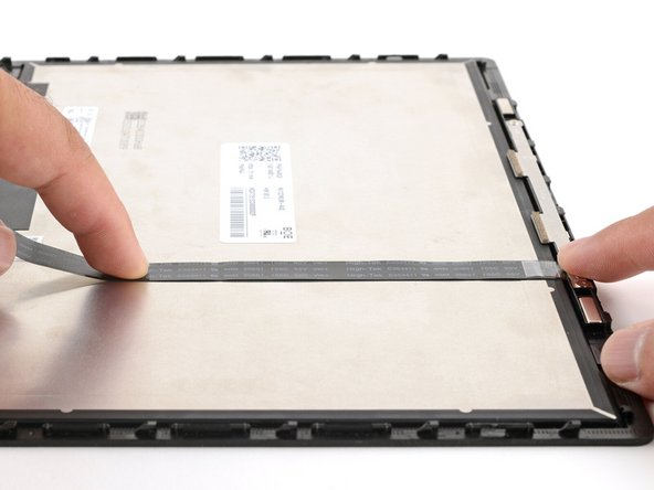

  46. The webcam cable is lightly adhered to the display. Grab the webcam cable with your fingers and slowly peel it away from the display.
    • The webcam cable is lightly adhered to the display.
    • Grab the webcam cable with your fingers and slowly peel it away from the display.
    • Carefully move the cable off of the display.

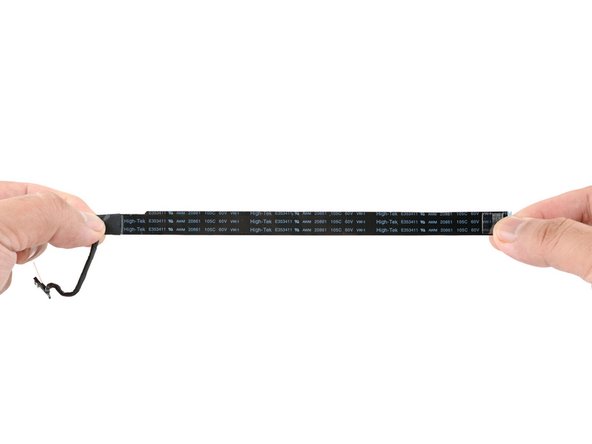

  47. Remove the webcam cable.
    • Remove the webcam cable.

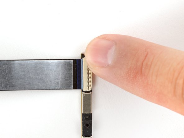

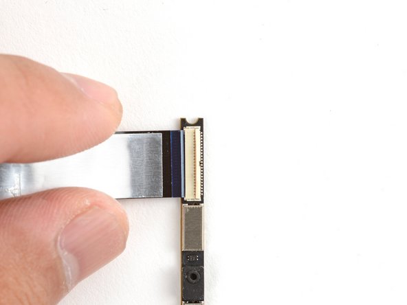

  49. To properly align the replacement webcam cable, you'll install the cable onto the webcam first, install the webcam, then attach the cable onto the display. Hold the webcam cable with the shiny side facing up. Slide the cable into the webcam module's ZIF connector, up to the printed line on the cable.
    • To properly align the replacement webcam cable, you'll install the cable onto the webcam first, install the webcam, then attach the cable onto the display.
    • Hold the webcam cable with the shiny side facing up.
    • Slide the cable into the webcam module's ZIF connector, up to the printed line on the cable.
    • Use your finger to flip down and gently press the locking tab in place.

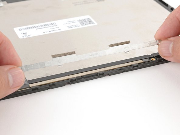

  50. Insert the webcam back into its display recess. Insert the webcam back into its display recess.
    • Insert the webcam back into its display recess.
  51. Use your fingers to align and lay the webcam bracket in place. Make sure the tabs on the top edge of the webcam bracket sit in their slots on the top edge of the display. Make sure the tabs on the top edge of the webcam bracket sit in their slots on the top edge of the display.
    • Use your fingers to align and lay the webcam bracket in place.
    • Make sure the tabs on the top edge of the webcam bracket sit in their slots on the top edge of the display.
  52. Use your Framework Screwdriver to install the two 3.3 mm‑long T5 Torx screws to secure the webcam bracket. Use your Framework Screwdriver to install the two 3.3 mm‑long T5 Torx screws to secure the webcam bracket.
    • Use your Framework Screwdriver to install the two 3.3 mm‑long T5 Torx screws to secure the webcam bracket.
  53. If the webcam cable has any plastic liners covering adhesives, peel them off to expose the adhesives. These liners should peel easily from the cable. Use your fingers to press the cable onto the display. Guide the cable bend into its channel on the display.
    • If the webcam cable has any plastic liners covering adhesives, peel them off to expose the adhesives. These liners should peel easily from the cable.
    • Use your fingers to press the cable onto the display.
    • Guide the cable bend into its channel on the display.
  54. Lay the display in place in the Top Cover, such that the top edge of the display is slightly below the top edge of the Top Cover. Lay the display in place in the Top Cover, such that the top edge of the display is slightly below the top edge of the Top Cover. Lay the display in place in the Top Cover, such that the top edge of the display is slightly below the top edge of the Top Cover.
    • Lay the display in place in the Top Cover, such that the top edge of the display is slightly below the top edge of the Top Cover.
  55. Use your fingers to slide the display upwards to latch the tabs on the top edge of the display. The top edge shouldn't have any gaps when the display's in place. The top edge shouldn't have any gaps when the display's in place.
    • Use your fingers to slide the display upwards to latch the tabs on the top edge of the display.
    • The top edge shouldn't have any gaps when the display's in place.

  84. Close the laptop lid. Flip your laptop face-down on a clean work surface.
    • Close the laptop lid.
    • Flip your laptop face-down on a clean work surface.
