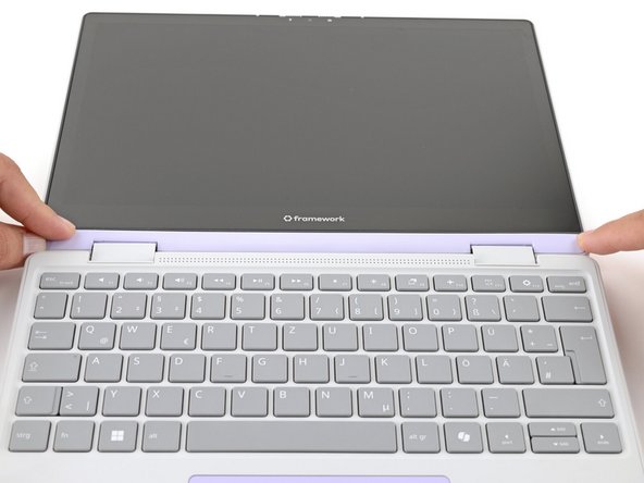

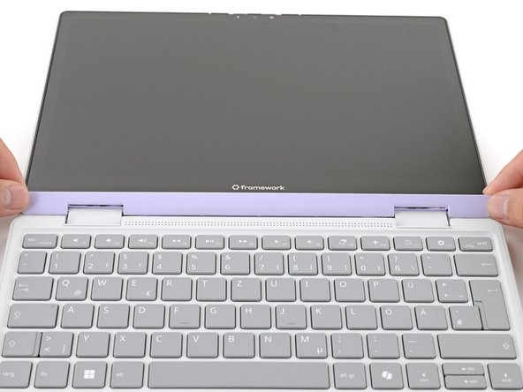

  2. Open the laptop lid so that both the screen and the base lie flat on your work surface. Open the laptop lid so that both the screen and the base lie flat on your work surface.

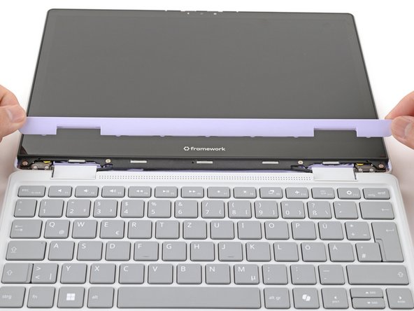

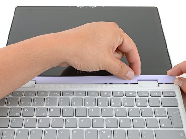

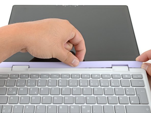

  3. The Display Cover is held in place with magnets along the top edge and clips along the remaining edges. Use the flat end of your Framework Screwdriver to pry up the right edge of the Display Cover.
    • The Display Cover is held in place with magnets along the top edge and clips along the remaining edges.
    • Use the flat end of your Framework Screwdriver to pry up the right edge of the Display Cover.
  4. Slide your fingers under the top edge of the Display Cover to release it from the laptop. Slide your fingers under the top edge of the Display Cover to release it from the laptop. Slide your fingers under the top edge of the Display Cover to release it from the laptop.
    • Slide your fingers under the top edge of the Display Cover to release it from the laptop.
  5. Remove the Display Cover. Remove the Display Cover.
    • Remove the Display Cover.

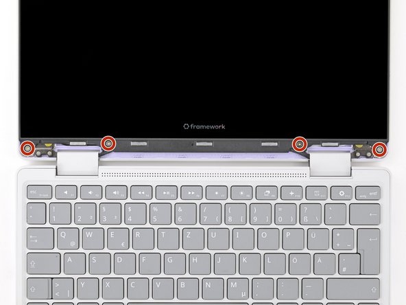

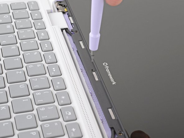

  6. Use your Framework Screwdriver to remove the four 3.3 mm‑long T5 Torx screws securing the display to the Top Cover. These screws are not captive. Store them in a safe location for reassembly.
    • Use your Framework Screwdriver to remove the four 3.3 mm‑long T5 Torx screws securing the display to the Top Cover.
    • These screws are not captive. Store them in a safe location for reassembly.

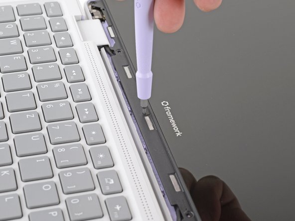

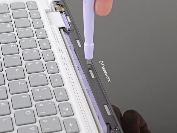

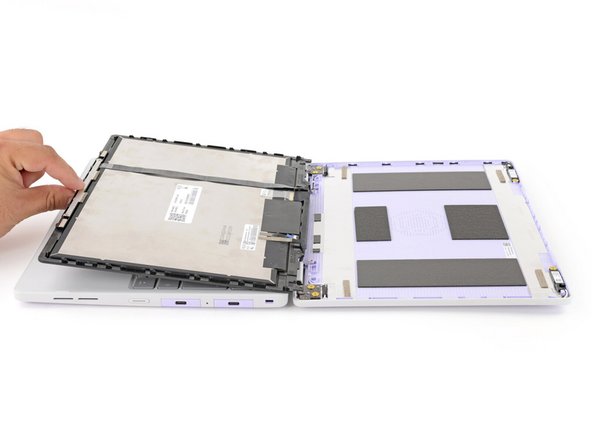

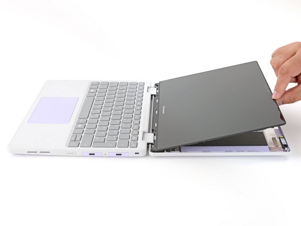

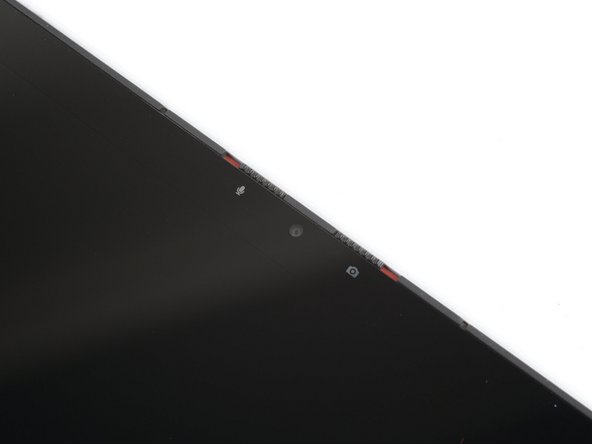

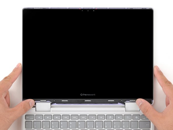

  7. Insert the bit end of your Framework Screwdriver into the small hole on the display, below the Framework logo. Slide the display down towards the hinge edge to release the tabs holding the top edge of the display in place. Slide the display down towards the hinge edge to release the tabs holding the top edge of the display in place.
    • Insert the bit end of your Framework Screwdriver into the small hole on the display, below the Framework logo.
    • Slide the display down towards the hinge edge to release the tabs holding the top edge of the display in place.

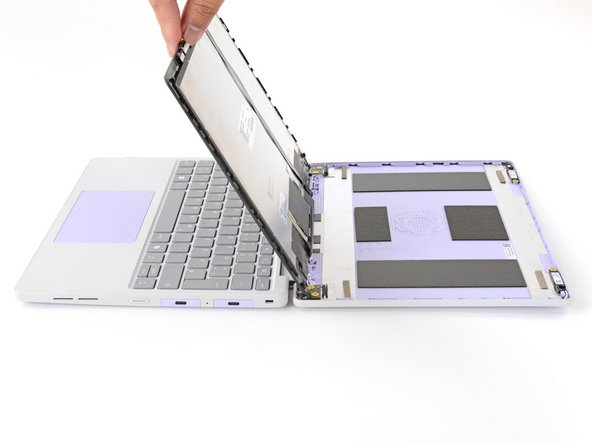

  8. Use your fingers to lift the top edge of the display from the Top Cover. Use your fingers to lift the top edge of the display from the Top Cover.
    • Use your fingers to lift the top edge of the display from the Top Cover.
  9. Use your fingers to carefully swing the display over so it lies on top of the keyboard. Use your fingers to carefully swing the display over so it lies on top of the keyboard. Use your fingers to carefully swing the display over so it lies on top of the keyboard.
    • Use your fingers to carefully swing the display over so it lies on top of the keyboard.

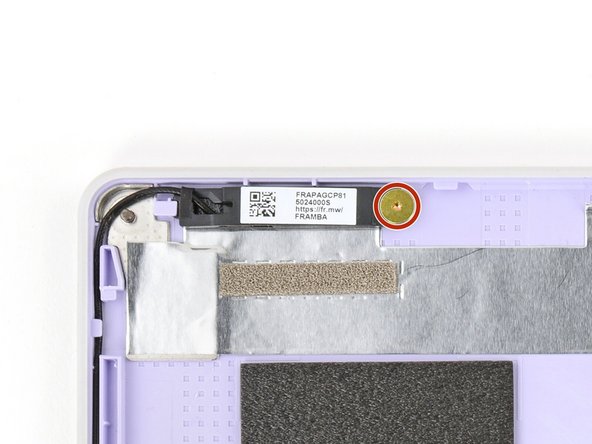

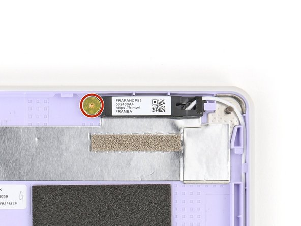

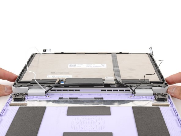

  10. Use your Framework Screwdriver to remove the two 2.4 mm‑long T5 Torx screws securing the two antennas to the Top Cover. Use your Framework Screwdriver to remove the two 2.4 mm‑long T5 Torx screws securing the two antennas to the Top Cover.
    • Use your Framework Screwdriver to remove the two 2.4 mm‑long T5 Torx screws securing the two antennas to the Top Cover.

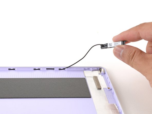

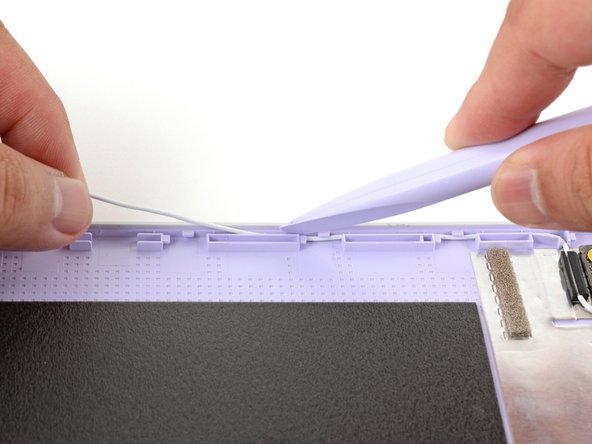

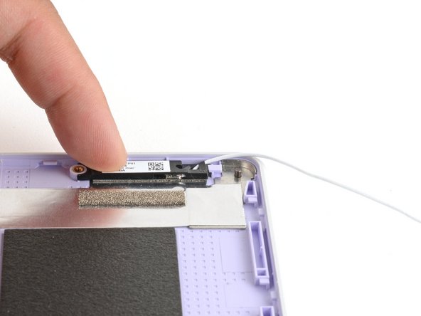

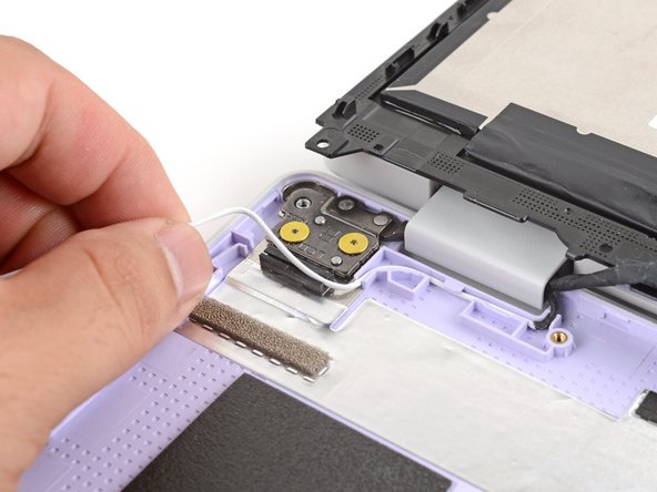

  11. Use your fingers to lift the right antenna away from the Top Cover. Carefully guide the white antenna cable out of its channel until you reach the hinge. Carefully guide the white antenna cable out of its channel until you reach the hinge.
    • Use your fingers to lift the right antenna away from the Top Cover.
    • Carefully guide the white antenna cable out of its channel until you reach the hinge.
  12. Repeat the previous step to guide the black antenna cable out of its channel. Repeat the previous step to guide the black antenna cable out of its channel.
    • Repeat the previous step to guide the black antenna cable out of its channel.

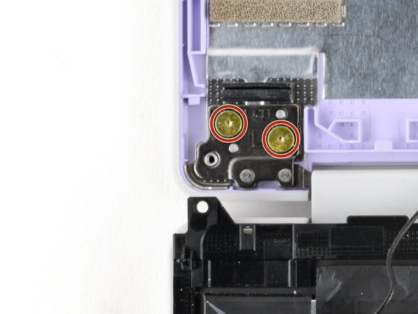

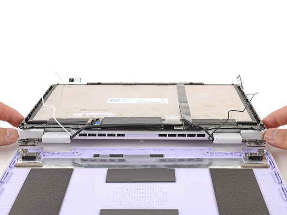

  13. Use your Framework Screwdriver to remove the four (two per hinge) 2.4 mm‑long T5 Torx screws securing the two hinges to the Top Cover. These screws are not captive. Store them in a safe location for reassembly.
    • Use your Framework Screwdriver to remove the four (two per hinge) 2.4 mm‑long T5 Torx screws securing the two hinges to the Top Cover.

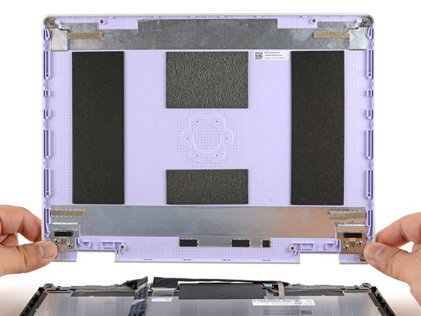

  14. Use your fingers to lift the hinges over the Top Cover lip. Separate the Top Cover from the rest of the laptop. Separate the Top Cover from the rest of the laptop.
    • Use your fingers to lift the hinges over the Top Cover lip.
    • Separate the Top Cover from the rest of the laptop.

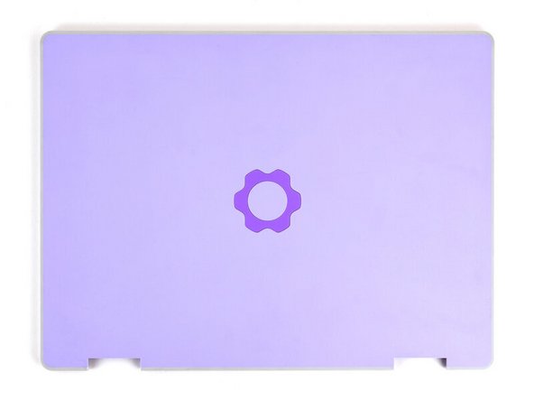

  15. Remove the Top Cover.
    • Remove the Top Cover.

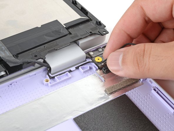

  21. Use your fingers and your Framework Screwdriver to guide and press both antenna cables back into their channels. Zoom in on the third image to see how the cables sit in their channels. Zoom in on the third image to see how the cables sit in their channels.
    • Use your fingers and your Framework Screwdriver to guide and press both antenna cables back into their channels.
    • Zoom in on the third image to see how the cables sit in their channels.

  24. Use your Framework Screwdriver to install the four 3.3 mm‑long T5 Torx screws to secure the display to the Top Cover. Tighten the screws until they're snug. Don't over-tighten them, or you may damage the screw tabs.
    • Use your Framework Screwdriver to install the four 3.3 mm‑long T5 Torx screws to secure the display to the Top Cover.
    • Tighten the screws until they're snug. Don't over-tighten them, or you may damage the screw tabs.

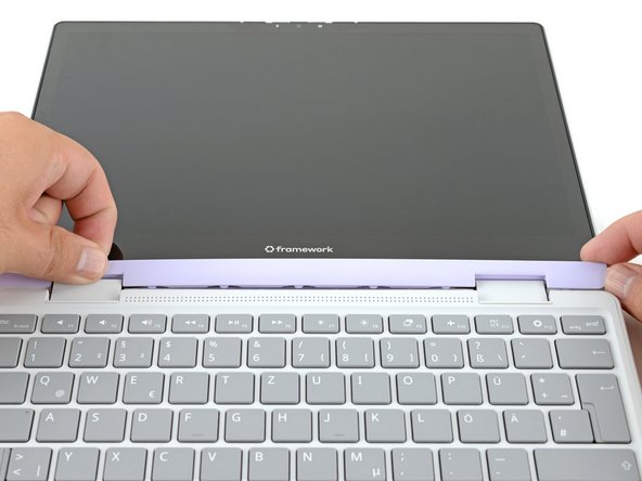

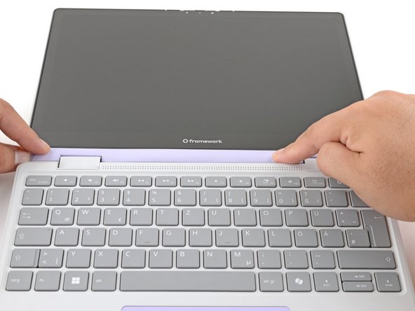

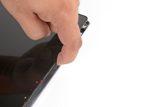

  25. Align the Display Cover to the bottom of the display. Align the Display Cover to the bottom of the display.
    • Align the Display Cover to the bottom of the display.

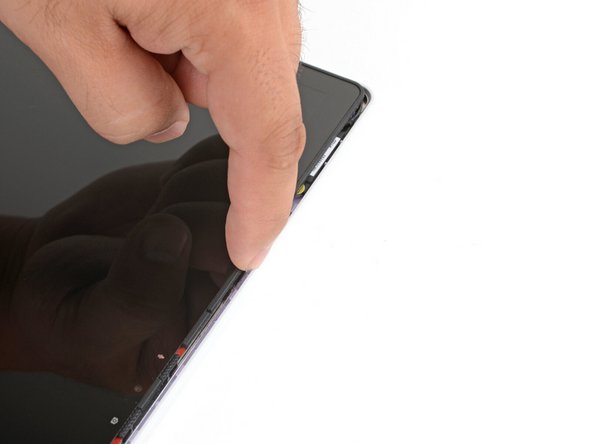

  26. Use your finger to press along the length of the Display Cover to snap it onto the laptop. Make sure all the clips along the left, top, and right edges are fully seated.
    • Use your finger to press along the length of the Display Cover to snap it onto the laptop.
    • Make sure all the clips along the left, top, and right edges are fully seated.
