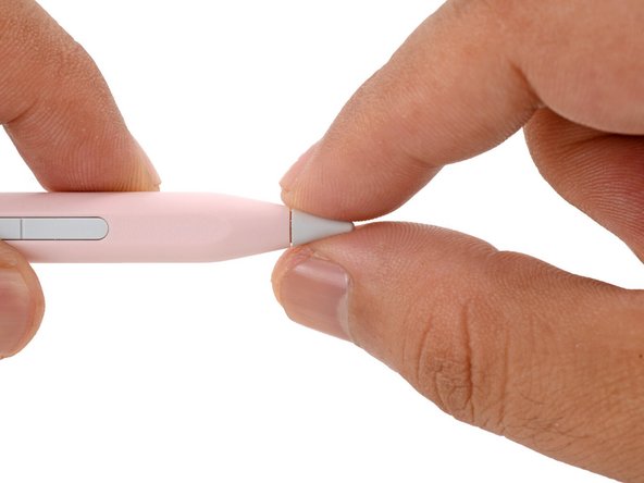

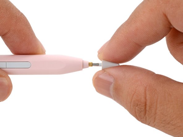

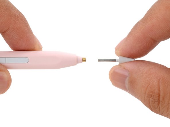

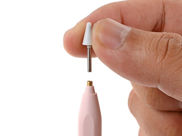

  1. Use your fingers to grab the Stylus tip and pull it straight out of the Stylus. If you're having trouble pulling the tip out: Wrap some tape around the tip to give you more grip.

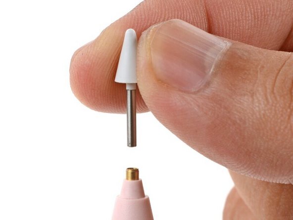

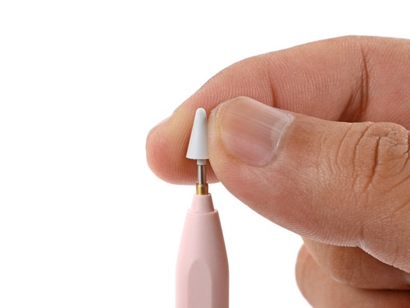

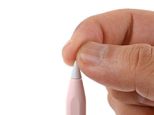

  2. Use your fingers to slide the new tip into the Stylus. Push the tip in until it bottoms out. It should be able to spin but not fall out. Push the tip in until it bottoms out. It should be able to spin but not fall out.
    • Use your fingers to slide the new tip into the Stylus.
    • Push the tip in until it bottoms out. It should be able to spin but not fall out.
