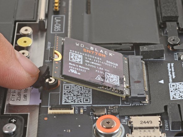

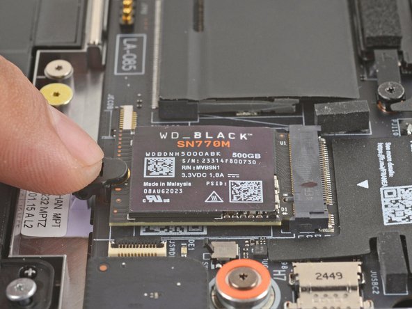

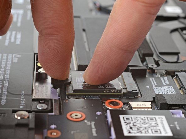

  7. Use your finger to press down on the black SSD latch to unlatch the SSD. The SSD will pop up to an angle when it's unlatched.
    • Use your finger to press down on the black SSD latch to unlatch the SSD.
    • The SSD will pop up to an angle when it's unlatched.

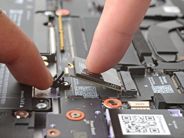

  8. Grab the SSD by its edges and pull it out of its socket. Remove the SSD. Remove the SSD.
    • Grab the SSD by its edges and pull it out of its socket.
    • Remove the SSD.

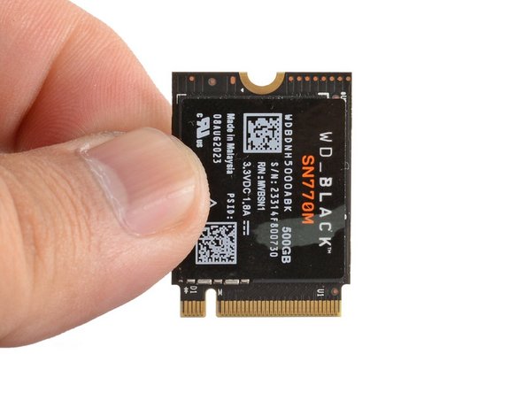

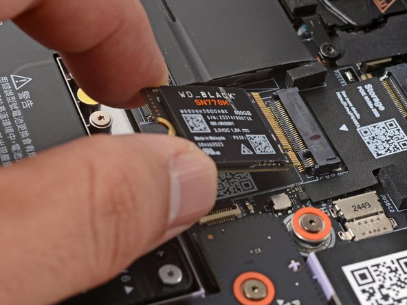

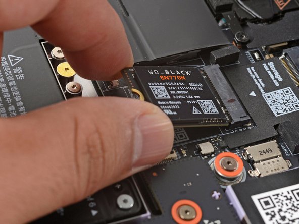

  10. Hold the SSD by its edges. Don't touch the gold contacts with your fingers. If you do, wipe the contacts with a clean, lint-free cloth to remove any finger oils. Align the SSD's gold contacts with its socket.
    • Align the SSD's gold contacts with its socket.

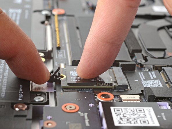

  11. Use your finger to press down on the black SSD latch to keep it open. Use another finger to press the SSD down until it lays flat. If the SSD doesn't fit in the latch, you may need to insert the SSD further into its socket.
    • Use your finger to press down on the black SSD latch to keep it open.
    • Use another finger to press the SSD down until it lays flat.
    • If the SSD doesn't fit in the latch, you may need to insert the SSD further into its socket.
    • Use your finger to close the latch to secure the SSD.
    • You should hear a click, and the SSD should no longer pop up.
