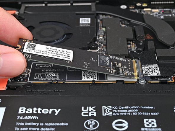

  7. Use your Framework Screwdriver to remove the 3.0 mm‑long T5 Torx screw securing the SSD. The SSD might pop up at a shallow angle when you remove the screw.
    • Use your Framework Screwdriver to remove the 3.0 mm‑long T5 Torx screw securing the SSD.
    • The SSD might pop up at a shallow angle when you remove the screw.
  8. Grip the end of the SSD with the screw hole and slide it out of its socket. Remove the SSD.
    • Grip the end of the SSD with the screw hole and slide it out of its socket.
    • Remove the SSD.
