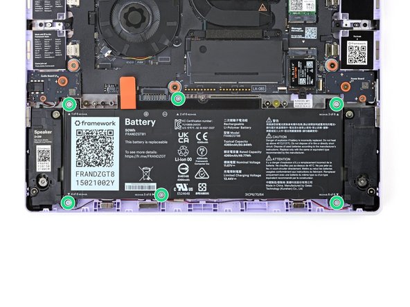

  7. Use your Framework Screwdriver to loosen the six captive T5 Torx screws securing the battery.
    • Use your Framework Screwdriver to loosen the six captive T5 Torx screws securing the battery.

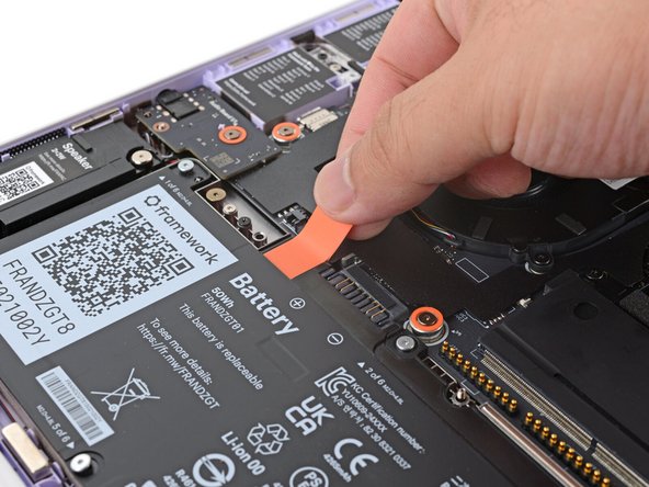

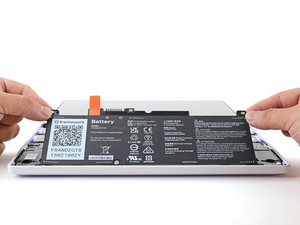

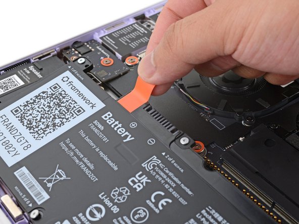

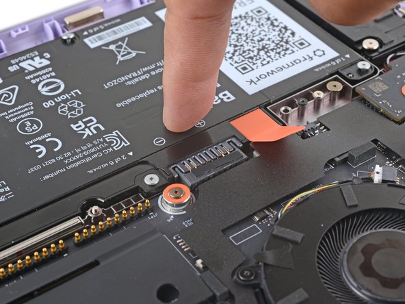

  8. Grab the orange battery tab with your fingers and lift straight up to disconnect the battery. The battery connector can be tight, requiring some force. If it feels like part of the battery won't come up, check that the battery screws are fully loosened.
    • Grab the orange battery tab with your fingers and lift straight up to disconnect the battery.
    • The battery connector can be tight, requiring some force. If it feels like part of the battery won't come up, check that the battery screws are fully loosened.

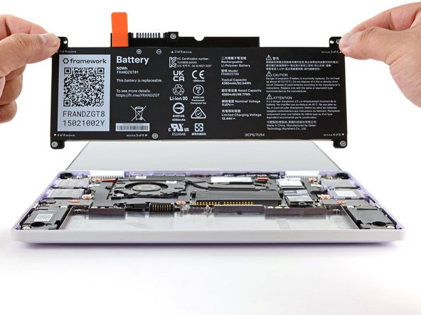

  9. Lift and remove the battery from the laptop. Lift and remove the battery from the laptop.
    • Lift and remove the battery from the laptop.

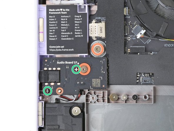

  10. Use your Framework Screwdriver to loosen the captive T5 Torx screw securing the Audio Board, located near the left edge of the laptop.
    • Use your Framework Screwdriver to loosen the captive T5 Torx screw securing the Audio Board, located near the left edge of the laptop.

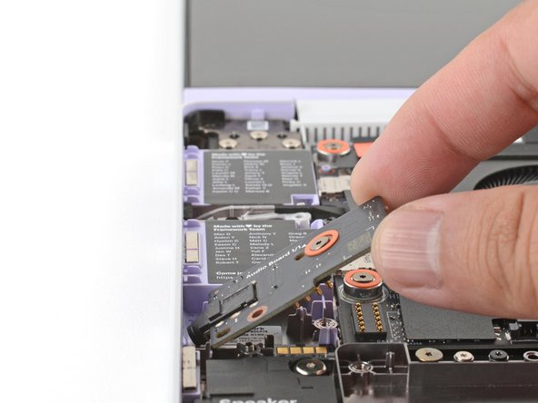

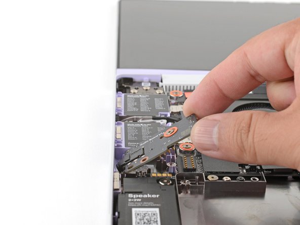

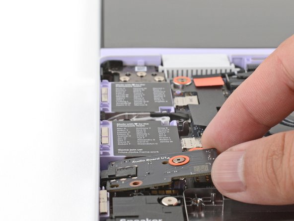

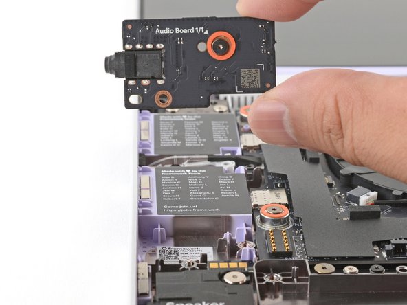

  11. Use your fingers to lift the right edge of the Audio Board and pull it out of its recess. Remove the Audio Board. Remove the Audio Board.
    • Use your fingers to lift the right edge of the Audio Board and pull it out of its recess.
    • Remove the Audio Board.

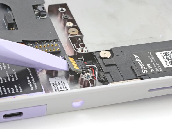

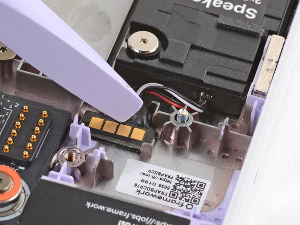

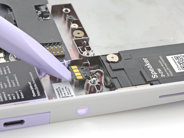

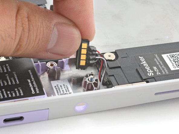

  12. Use the flat end of your Framework Screwdriver to pry up the speaker connector from its recess near the top of the left speaker. Use the flat end of your Framework Screwdriver to pry up the speaker connector from its recess near the top of the left speaker. Use the flat end of your Framework Screwdriver to pry up the speaker connector from its recess near the top of the left speaker.
    • Use the flat end of your Framework Screwdriver to pry up the speaker connector from its recess near the top of the left speaker.

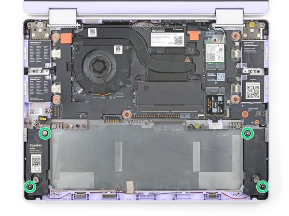

  13. Use your Framework Screwdriver to loosen the four captive T5 Torx screws (two per speaker) securing the speakers.
    • Use your Framework Screwdriver to loosen the four captive T5 Torx screws (two per speaker) securing the speakers.

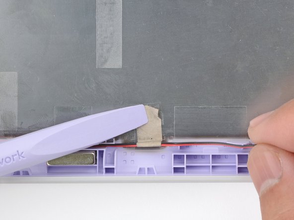

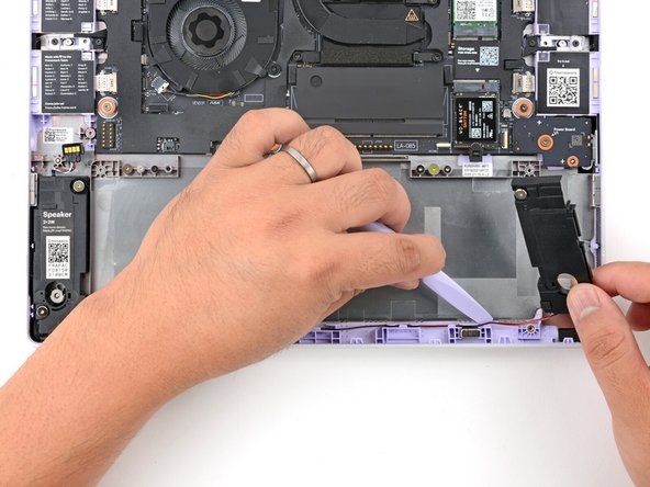

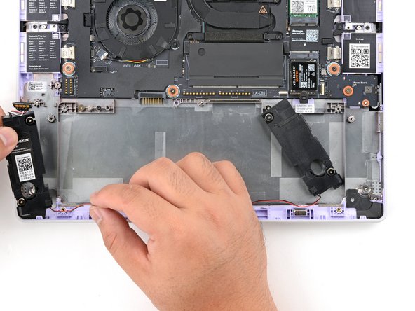

  14. Use your Framework Screwdriver to lift and guide the wire connecting the two speakers out of the frame channel. Use your Framework Screwdriver to lift the silver tape securing the center of the speaker wire to the frame. If you're reusing the speakers, try to keep the silver tape intact.
    • Use your Framework Screwdriver to lift and guide the wire connecting the two speakers out of the frame channel.
    • Use your Framework Screwdriver to lift the silver tape securing the center of the speaker wire to the frame.
    • If you're reusing the speakers, try to keep the silver tape intact.

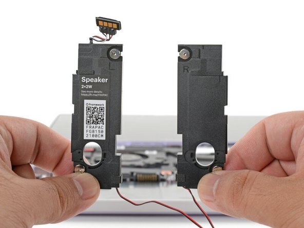

  15. Remove the speakers.
    • Remove the speakers.

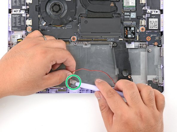

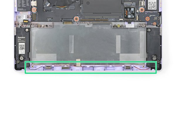

  17. Use your Framework Screwdriver to loosely screw the left speaker in place. Starting near the left speaker, use your fingers and your Framework Screwdriver to carefully press and guide the speaker wire back into its channel. Zoom in on the second image to see how the wire sits in its channel.
    • Use your Framework Screwdriver to loosely screw the left speaker in place.
    • Starting near the left speaker, use your fingers and your Framework Screwdriver to carefully press and guide the speaker wire back into its channel.
    • Zoom in on the second image to see how the wire sits in its channel.
    • Press the silver tape to adhere the center of the wire to the frame.

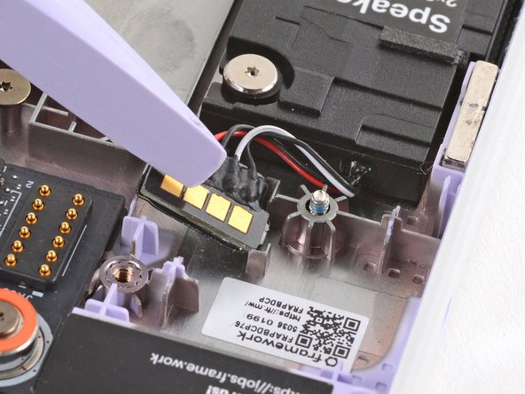

  19. Use the flat end of your Framework Screwdriver to press the speaker connector into its recess. Make sure the gold contacts are facing up.
    • Use the flat end of your Framework Screwdriver to press the speaker connector into its recess.
    • Make sure the gold contacts are facing up.

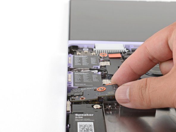

  20. Insert the Audio Board into the laptop at an angle to help align the headphone jack. Use the two plastic alignment pins on the laptop to help with final alignment. Use the two plastic alignment pins on the laptop to help with final alignment.
    • Insert the Audio Board into the laptop at an angle to help align the headphone jack.
    • Use the two plastic alignment pins on the laptop to help with final alignment.

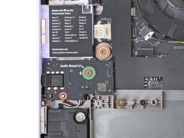

  21. Use your Framework Screwdriver to tighten the captive T5 Torx screw to secure the Audio Board.
    • Use your Framework Screwdriver to tighten the captive T5 Torx screw to secure the Audio Board.

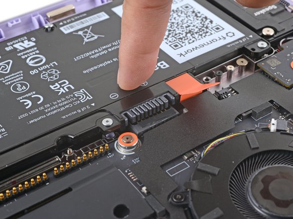

  23. Use your finger to push the battery down near its connector to reconnect it. Use your finger to push the battery down near its connector to reconnect it.
    • Use your finger to push the battery down near its connector to reconnect it.

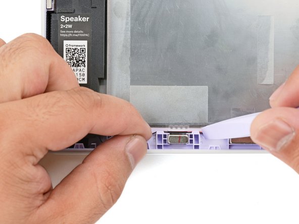

  25. Angle the bottom edge of the Input Cover towards the base of the Laptop. Align and insert the bottom edge of the Input Cover into the base of the Laptop. Make sure the slots along the bottom edge of the Input Cover slide into the tabs in the base.
    • Angle the bottom edge of the Input Cover towards the base of the Laptop.
    • Align and insert the bottom edge of the Input Cover into the base of the Laptop.
