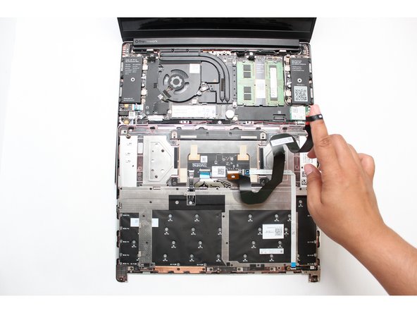

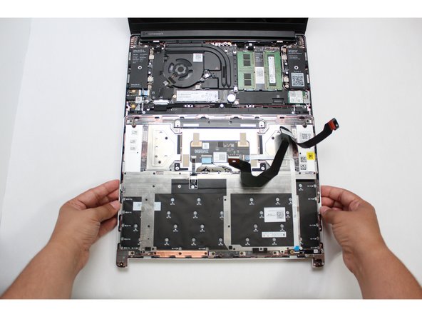

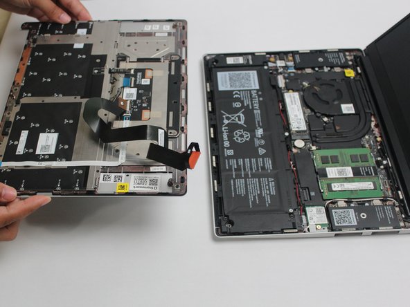

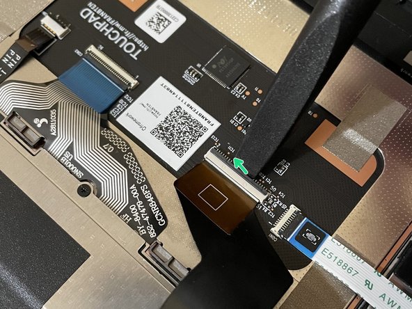

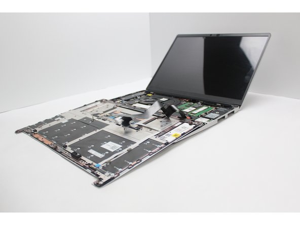

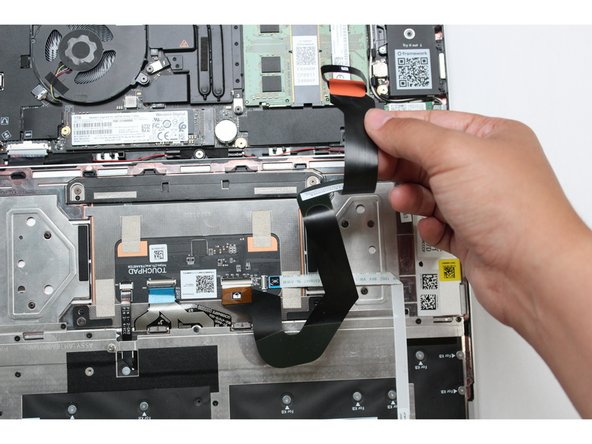

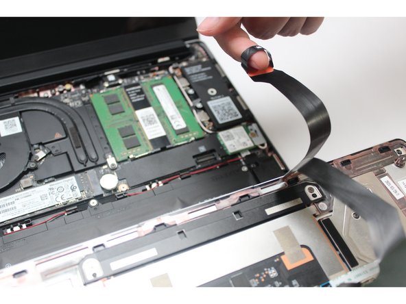

  2. Disconnect the Touchpad Cable from the Mainboard by inserting your finger into the loop and pull directly upward using a slight amount of force. Once the Touchpad Cable is disconnected, remove the Input Cover away from the Mainboard. Once the Touchpad Cable is disconnected, remove the Input Cover away from the Mainboard.
    • Disconnect the Touchpad Cable from the Mainboard by inserting your finger into the loop and pull directly upward using a slight amount of force.
    • Once the Touchpad Cable is disconnected, remove the Input Cover away from the Mainboard.

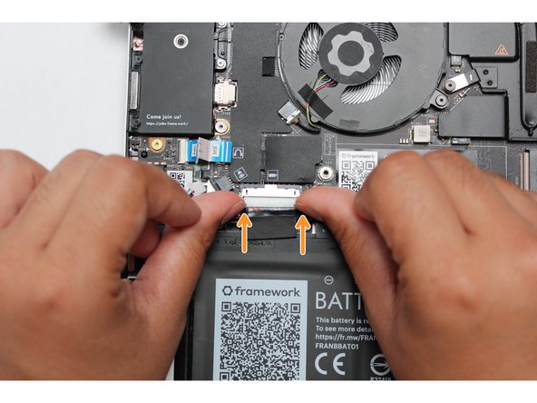

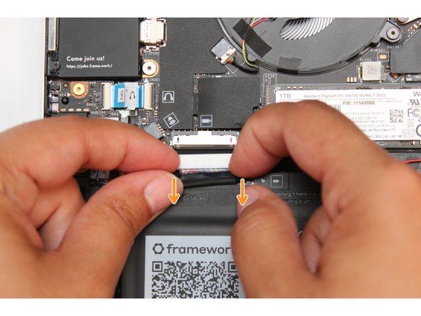

  3. Be extremely careful when sliding the Battery connector out, as it is very easy to accidently bend the pins.  Make sure to slide straight down, and avoid letting the connector twist or bend. Gently disconnect the Battery by gripping the connector edges with both fingers and slide the connector straight down from the socket.
    • Be extremely careful when sliding the Battery connector out, as it is very easy to accidently bend the pins. Make sure to slide straight down, and avoid letting the connector twist or bend.
    • Gently disconnect the Battery by gripping the connector edges with both fingers and slide the connector straight down from the socket.

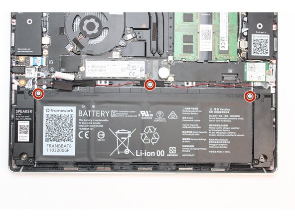

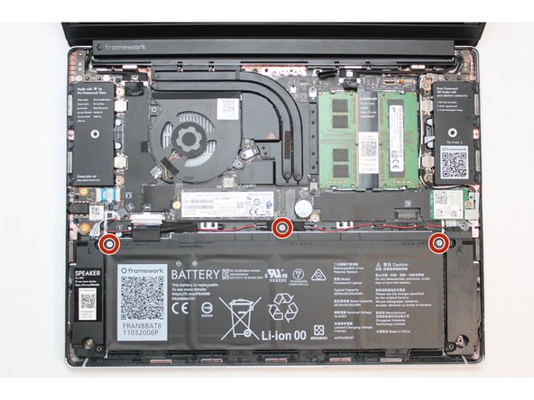

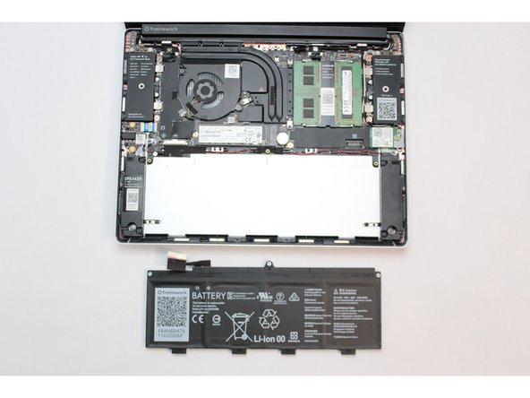

  4. Using the T5 bit in the Framework Screwdriver, unscrew the three fasteners on the battery.
    • Using the T5 bit in the Framework Screwdriver, unscrew the three fasteners on the battery.
    • Note: The screws will come loose after a few revolutions however they will remain attached to the battery.

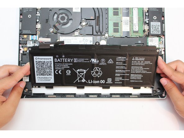

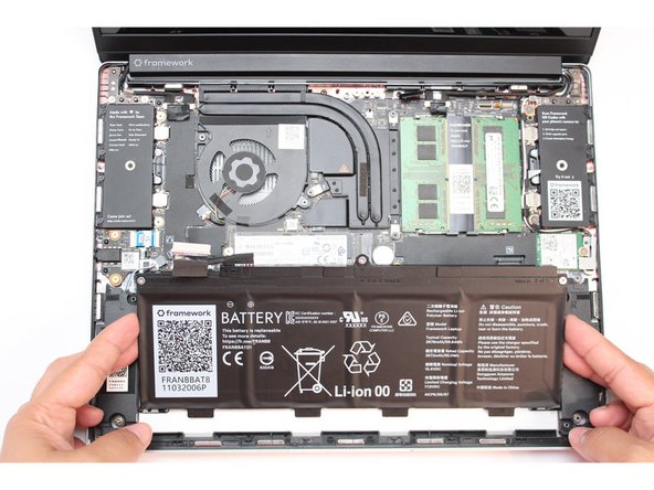

  5. Use your fingernail to gently Lift the battery up and away from the bottom cover. Carefully lift it out and keep it in a safe place. Warning: Handle the battery by the plastic frame, make sure not to bend, scratch, cut, or puncture it, and keep it away from heat sources
    • Use your fingernail to gently Lift the battery up and away from the bottom cover. Carefully lift it out and keep it in a safe place.
    • Warning: Handle the battery by the plastic frame, make sure not to bend, scratch, cut, or puncture it, and keep it away from heat sources

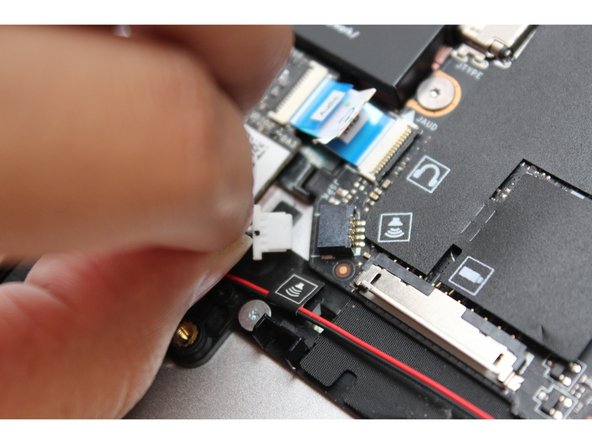

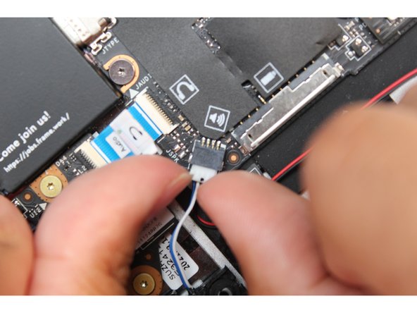

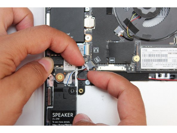

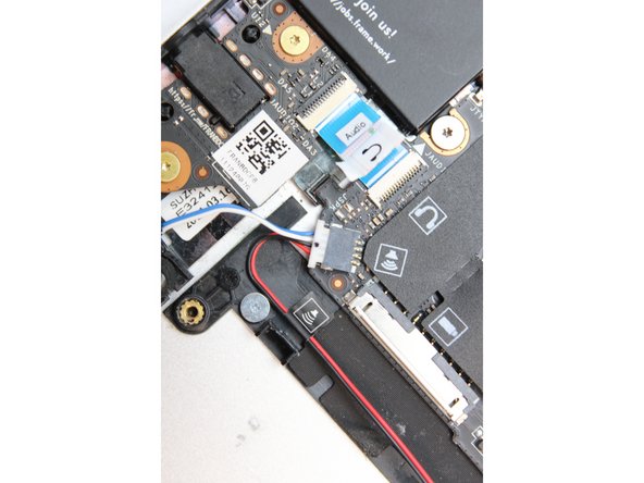

  6. Using your fingernails disconnect the speaker connector from the Mainboard by gripping the edges of the connector and pulling straight out. Using your fingernails disconnect the speaker connector from the Mainboard by gripping the edges of the connector and pulling straight out.
    • Using your fingernails disconnect the speaker connector from the Mainboard by gripping the edges of the connector and pulling straight out.

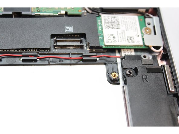

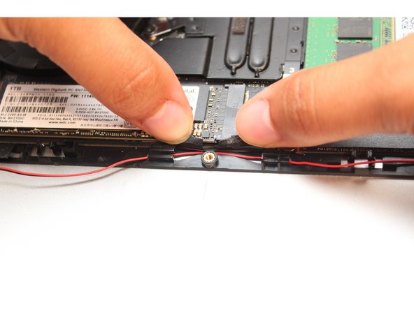

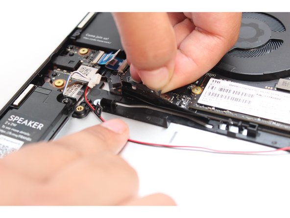

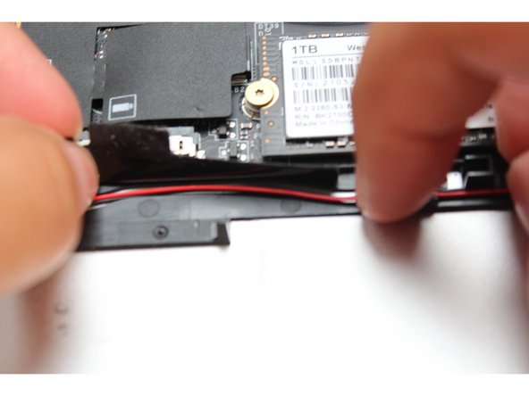

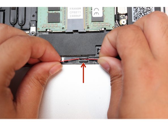

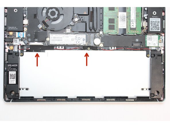

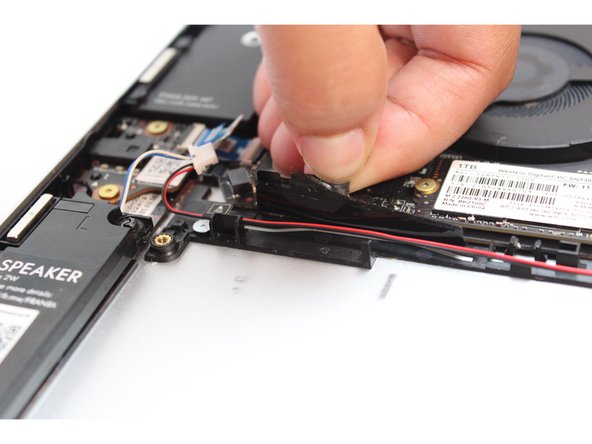

  7. Locate one of two pieces of black tape and carefully peel it back to reveal the black and red speaker wires. Do not completely remove the tape from the Bottom Cover, peel it back just enough to reveal the wires. Do not completely remove the tape from the Bottom Cover, peel it back just enough to reveal the wires.
    • Locate one of two pieces of black tape and carefully peel it back to reveal the black and red speaker wires.
    • Do not completely remove the tape from the Bottom Cover, peel it back just enough to reveal the wires.

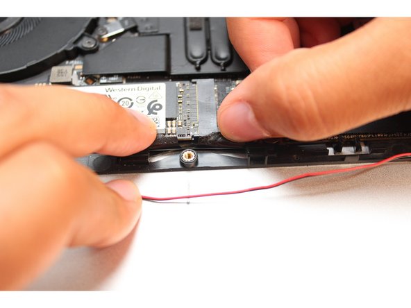

  8. Locate the other piece of black tape and carefully peel it back to reveal the black and red speaker wires. Do not completely remove the tape from the Bottom Cover, peel it back just enough to reveal the wires. Do not completely remove the tape from the Bottom Cover, peel it back just enough to reveal the wires.
    • Locate the other piece of black tape and carefully peel it back to reveal the black and red speaker wires.

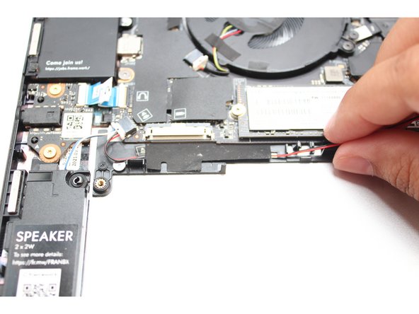

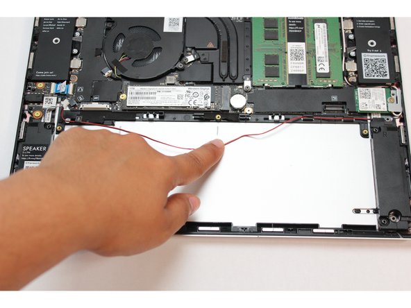

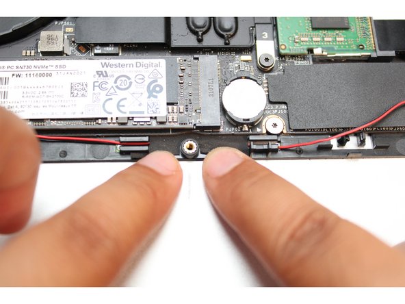

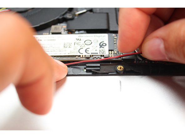

  9. Carefully lift the wires out of the wire routers and very gently pull the wires down so that they are free. Carefully lift the wires out of the wire routers and very gently pull the wires down so that they are free.
    • Carefully lift the wires out of the wire routers and very gently pull the wires down so that they are free.

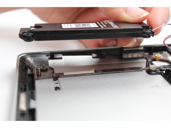

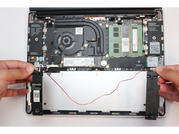

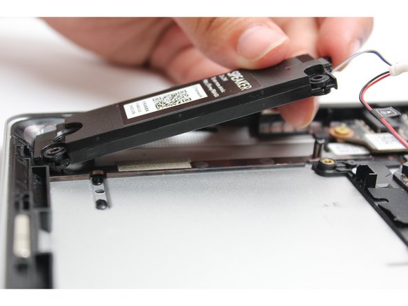

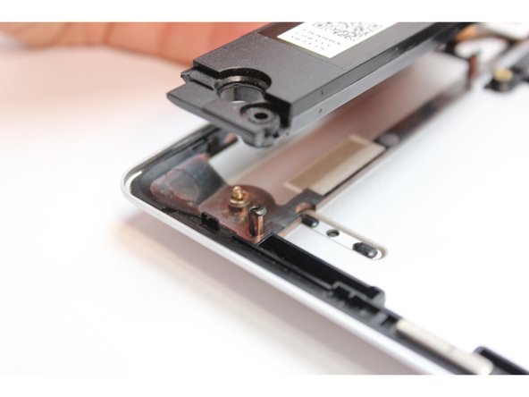

  10. The speakers are now disconnected.  You can lift both the left and right speaker out of the Bottom Cover. The speakers are now disconnected.  You can lift both the left and right speaker out of the Bottom Cover.
    • The speakers are now disconnected. You can lift both the left and right speaker out of the Bottom Cover.
  11. Place both the Left and Right speakers in their respective spaces on the Bottom Cover by aligning the pegs with the rubber gaskets. Note: You'll notice an L and R on both speakers to help you figure out the proper placement. Note: You'll notice an L and R on both speakers to help you figure out the proper placement.
    • Place both the Left and Right speakers in their respective spaces on the Bottom Cover by aligning the pegs with the rubber gaskets.
    • Note: You'll notice an L and R on both speakers to help you figure out the proper placement.
  12. Using your fingers and a slight amount of force, insert the speaker connector straight into the Mainboard. Using your fingers and a slight amount of force, insert the speaker connector straight into the Mainboard. Using your fingers and a slight amount of force, insert the speaker connector straight into the Mainboard.
    • Using your fingers and a slight amount of force, insert the speaker connector straight into the Mainboard.
  13. Peel the black tape back and place the wires under it. Cover the wires with same tape. Peel the black tape back and place the wires under it. Cover the wires with same tape. Peel the black tape back and place the wires under it. Cover the wires with same tape.
    • Peel the black tape back and place the wires under it. Cover the wires with same tape.
  14. Place the wires into the wire router next to the other piece of black tape.  Peel the tape back and place the wires under it. Cover the wires with same tape. Place the wires into the wire router next to the other piece of black tape.  Peel the tape back and place the wires under it. Cover the wires with same tape. Place the wires into the wire router next to the other piece of black tape.  Peel the tape back and place the wires under it. Cover the wires with same tape.
    • Place the wires into the wire router next to the other piece of black tape. Peel the tape back and place the wires under it. Cover the wires with same tape.
  15. Route the wires through each of the wire routers. You can use your fingernail to secure the wires in place.
    • Route the wires through each of the wire routers. You can use your fingernail to secure the wires in place.

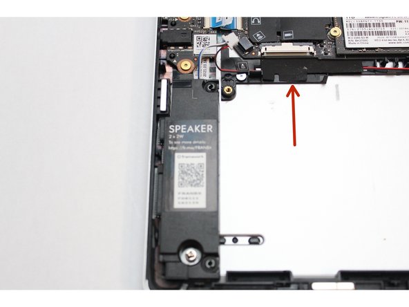

    • The Speakers are now fully installed.
    • Make sure the Speaker is not touching the white or black antenna from the WiFi Module.

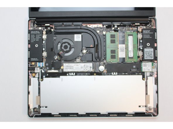

  16. Using your fingertips, gently handle the Framework battery with the plastic frame, slide it into the Bottom Cover.  Use the first image as a reference.
    • Using your fingertips, gently handle the Framework battery with the plastic frame, slide it into the Bottom Cover. Use the first image as a reference.
    • Warning: Handle the battery by the plastic frame, make sure not to bend, scratch, cut, or puncture it, and keep it away from heat sources.

  18. Using the T5 bit in the Framework Screwdriver, screw the three fasteners into place.
    • Using the T5 bit in the Framework Screwdriver, screw the three fasteners into place.
  19. Gently place the Input Cover keyboard side down on the Bottom Cover as indicated on the image. The cover should be about an inch and a half away from the bottom of the Mainboard so that you can comfortably install the Touchpad Cable. Note: The orientation of the Input Cover matters. Study the first image in this step to ensure you are properly attaching the cover. Locate the loop on the end of the Touchpad Cable and insert your finger into it.
    • Gently place the Input Cover keyboard side down on the Bottom Cover as indicated on the image. The cover should be about an inch and a half away from the bottom of the Mainboard so that you can comfortably install the Touchpad Cable.
    • Note: The orientation of the Input Cover matters. Study the first image in this step to ensure you are properly attaching the cover.

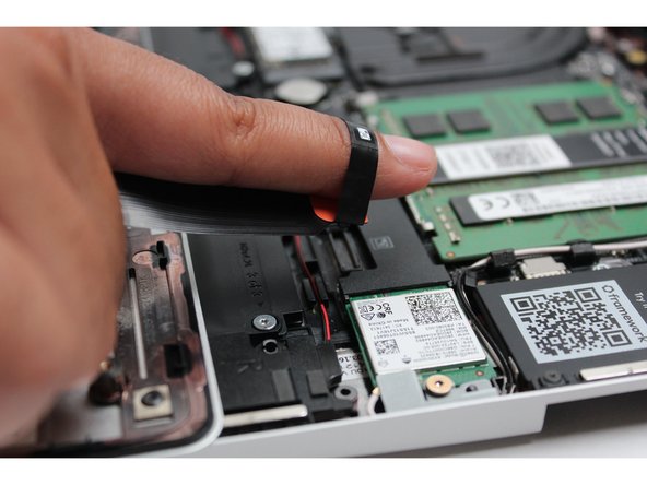

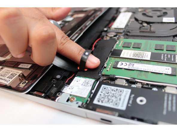

    • Locate the loop on the end of the Touchpad Cable and insert your finger into it.

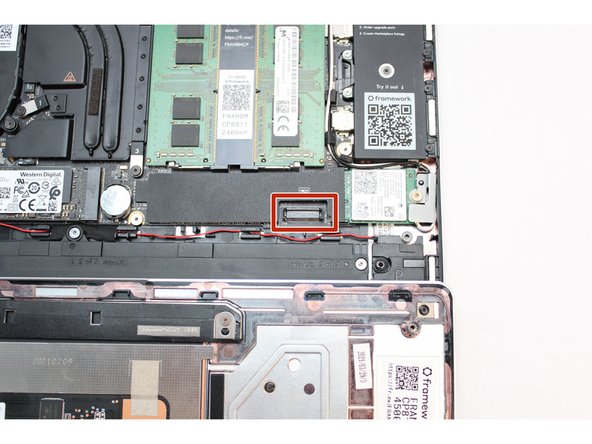

  20. Using slight force, connect the Touchpad Cable by aligning it to the socket on Mainboard. You should hear it click into place once properly connected. Using slight force, connect the Touchpad Cable by aligning it to the socket on Mainboard. You should hear it click into place once properly connected. Using slight force, connect the Touchpad Cable by aligning it to the socket on Mainboard. You should hear it click into place once properly connected.

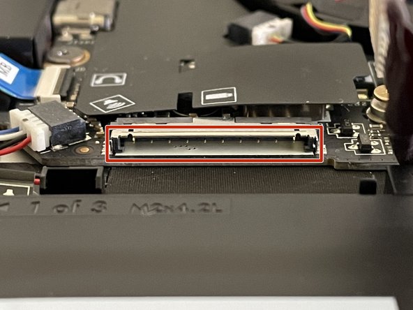

  21. Before closing up the laptop, make sure that the Touchpad end of the Touchpad Cable is fully seated in the receptacle. The cable should be inserted far enough that the white line almost touches the receptacle.

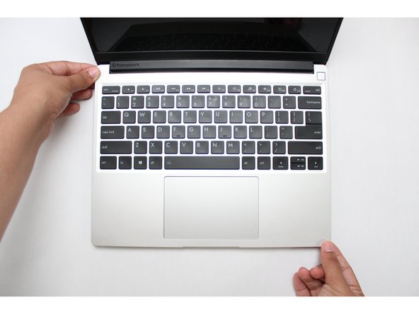

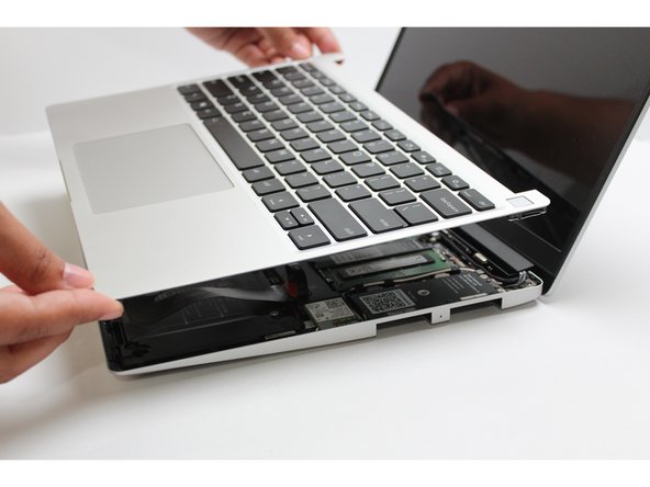

  22. Once the Touchpad cable is secured to the Mainboard, flip the Input Cover over the Bottom Cover so that the keyboard is facing up and attach it to the Bottom Cover by aligning the top and bottom edges of both covers. Tip: The covers are magnetic and should fit into one another easily. If you feel any resistance simply lift the Input Cover up and try again. Tip: The covers are magnetic and should fit into one another easily. If you feel any resistance simply lift the Input Cover up and try again.
