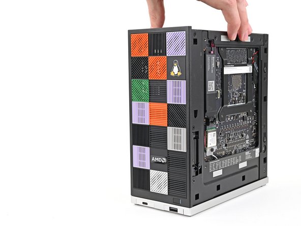

  8. Lay the left side of the Desktop on your work surface so the bottom of the Mainboard is facing upward. Lay the left side of the Desktop on your work surface so the bottom of the Mainboard is facing upward.
    • Lay the left side of the Desktop on your work surface so the bottom of the Mainboard is facing upward.

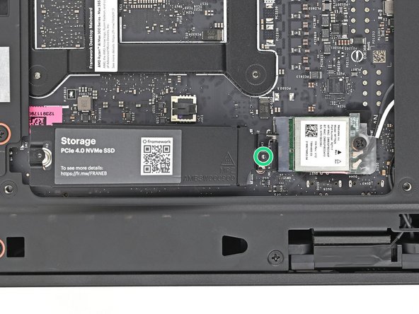

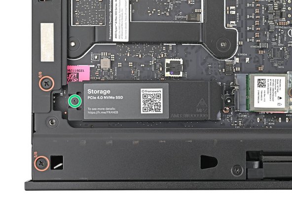

  9. Use your Framework Desktop Screwdriver to loosen the captive T5 Torx screw securing the SSD. The SSD and its heat spreader will pop up to an angle when its screw is fully loosened.
    • Use your Framework Desktop Screwdriver to loosen the captive T5 Torx screw securing the SSD.
    • The SSD and its heat spreader will pop up to an angle when its screw is fully loosened.

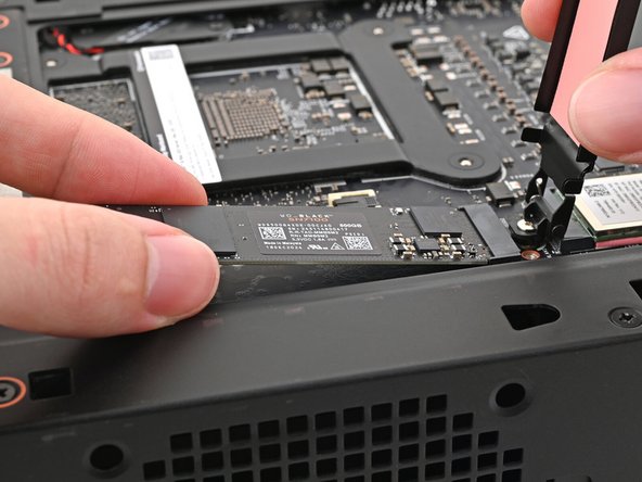

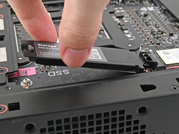

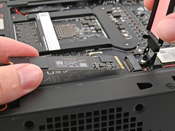

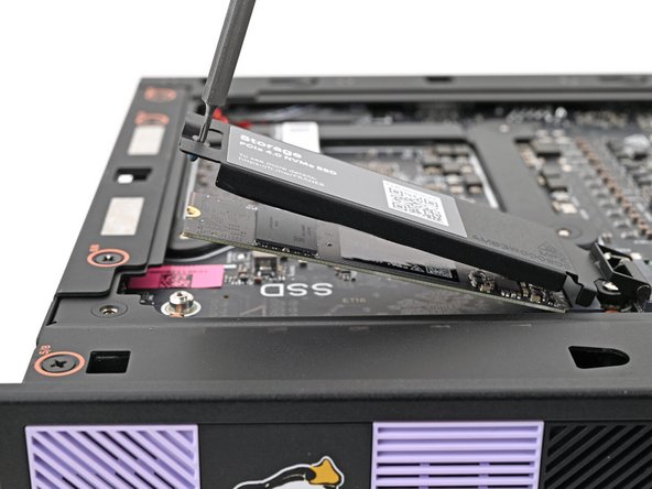

  10. While holding the heat spreader upright, grab the SSD by its edges and pull it out of its socket. Remove the SSD.
    • While holding the heat spreader upright, grab the SSD by its edges and pull it out of its socket.
    • Remove the SSD.

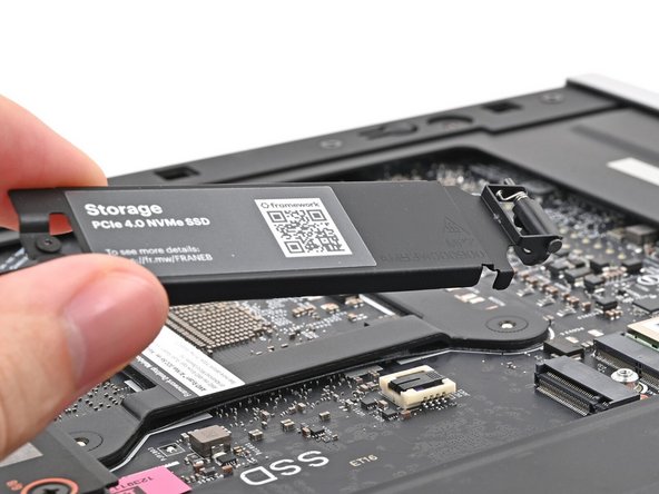

  11. If your SSD comes with a pre-installed heat spreader, follow the next two steps. Otherwise this and the following step. While securing the secondary storage heat spreader with one hand, use your Framework Desktop Screwdriver to remove the 4.5 mm‑long T5 Torx screw securing it. While securing the secondary storage heat spreader with one hand, use your Framework Desktop Screwdriver to remove the 4.5 mm‑long T5 Torx screw securing it.
    • If your SSD comes with a pre-installed heat spreader, follow the next two steps. Otherwise this and the following step.
    • While securing the secondary storage heat spreader with one hand, use your Framework Desktop Screwdriver to remove the 4.5 mm‑long T5 Torx screw securing it.
  12. Lift the secondary storage heat spreader out of the Desktop and remove it.
    • Lift the secondary storage heat spreader out of the Desktop and remove it.
    • Follow the guide normally, making sure to ignore instructions that involve the secondary storage heat spreader.

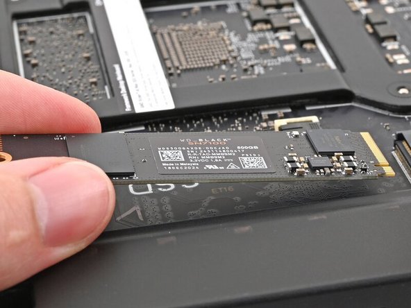

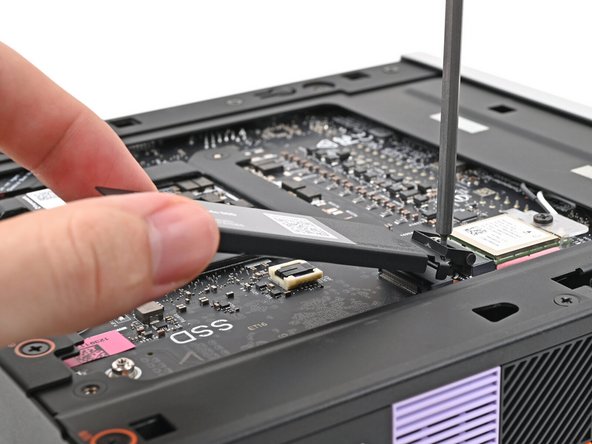

  14. Hold the SSD by its edges. Don't touch the gold contacts with your fingers. If you do, wipe the contacts with a clean, lint-free cloth to remove any finger oils. While holding the SSD heat spreader upright, align the SSD's gold contacts with its socket. Insert the SSD into the socket at a shallow angle. The gold contacts should mostly be covered by the socket.
    • While holding the SSD heat spreader upright, align the SSD's gold contacts with its socket.
    • Lay the heat spreader back onto the SSD.

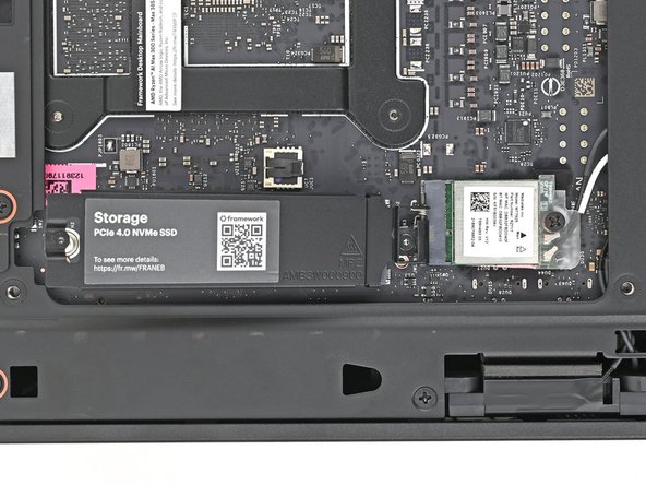

  15. Use your Framework Desktop Screwdriver to tighten the captive T5 Torx screw securing the SSD.
    • Use your Framework Desktop Screwdriver to tighten the captive T5 Torx screw securing the SSD.
