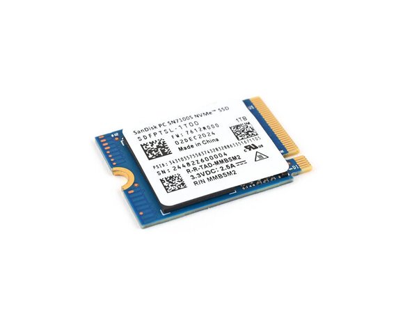

Follow this guide to replace the secondary SSD in your Framework Laptop 16.
Your Framework Laptop uses SSDs (Solid State Drive) for storage. The secondary storage supports an M.2 2230 NVMe SSD.

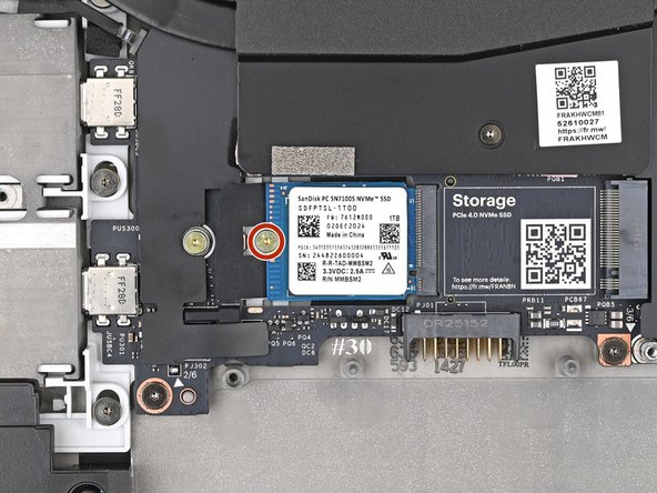

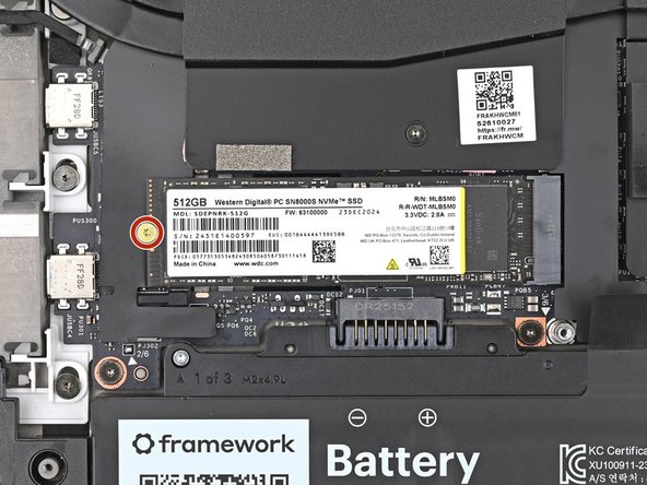

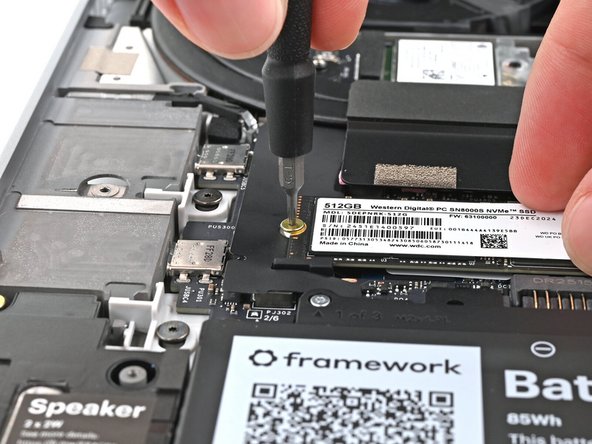

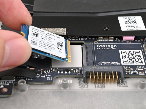

  11. Use your Framework Screwdriver to remove the 2 mm‑long T5 Torx screw securing the SSD. The SSD might pop up at a shallow angle when you remove the screw.
    • Use your Framework Screwdriver to remove the 2 mm‑long T5 Torx screw securing the SSD.
    • The SSD might pop up at a shallow angle when you remove the screw.

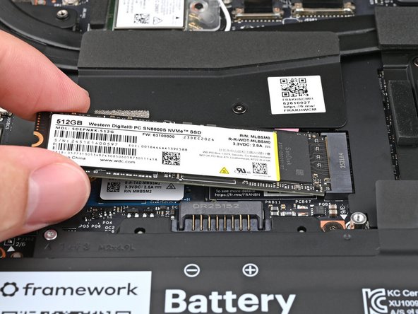

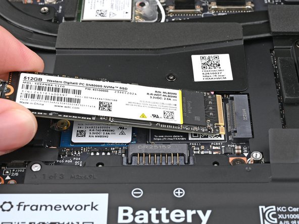

  12. Grip the end of the SSD with the screw hole and slide it out of its socket. Remove the SSD.
    • Grip the end of the SSD with the screw hole and slide it out of its socket.
    • Remove the SSD.

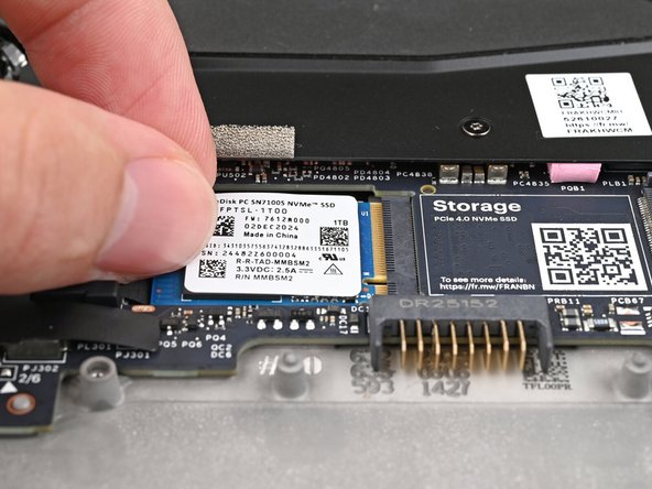

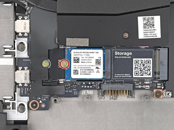

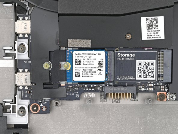

  13. If you have a secondary SSD installed, follow the next two steps. Use your Framework Screwdriver to remove the 2 mm‑long T5 Torx screw securing the secondary SSD.
    • If you have a secondary SSD installed, follow the next two steps.
    • Use your Framework Screwdriver to remove the 2 mm‑long T5 Torx screw securing the secondary SSD.

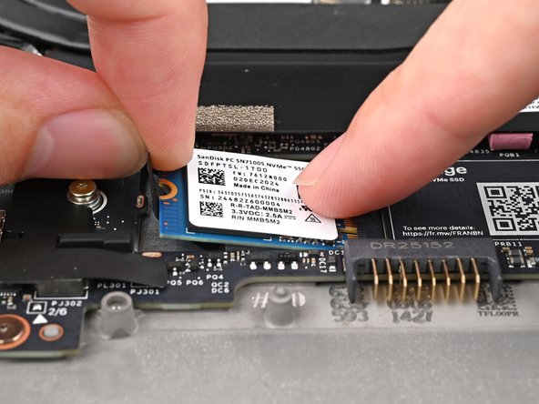

  14. While pulling up on the black tab underneath the SSD, use your finger to slide the SSD out of its socket. Avoid touching the gold contacts. Only press on the top label or the edges of the SSD. Avoid touching the gold contacts. Only press on the top label or the edges of the SSD.
    • While pulling up on the black tab underneath the SSD, use your finger to slide the SSD out of its socket.
    • Avoid touching the gold contacts. Only press on the top label or the edges of the SSD.

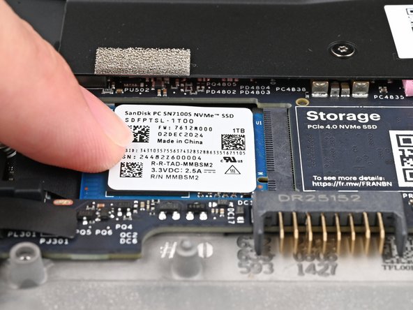

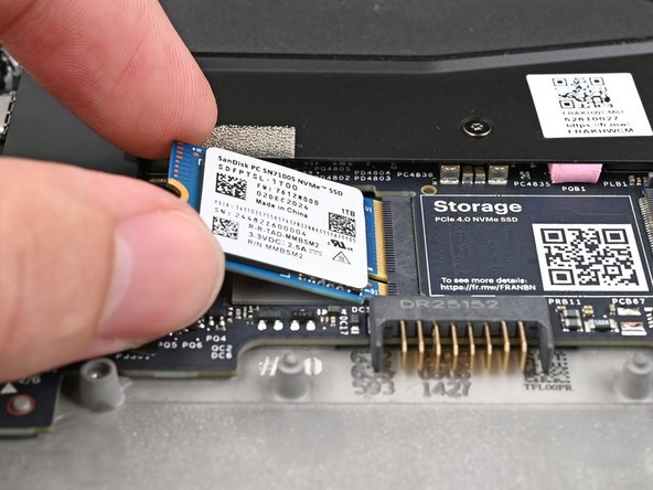

  16. Hold the SSD by its edges. Don't touch the gold contacts with your fingers. If you do, wipe the contacts with a clean, lint-free cloth to remove any finger oils. Align the SSD's gold contacts with its socket. Insert the SSD partially into the socket at a shallow angle. You should still be able to see most of the gold contacts.
    • Align the SSD's gold contacts with its socket.
    • Insert the SSD partially into the socket at a shallow angle. You should still be able to see most of the gold contacts.
    • Press the SSD flat to the Mainboard.

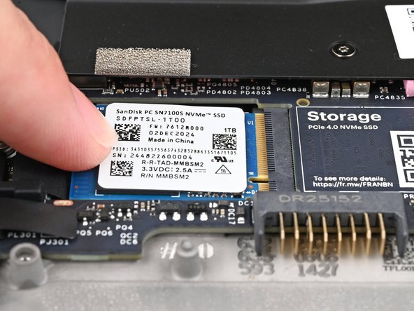

  17. While keeping the SSD flat to the Mainboard, push it into its socket until its golden contacts are completely covered. While keeping the SSD flat to the Mainboard, push it into its socket until its golden contacts are completely covered.
    • While keeping the SSD flat to the Mainboard, push it into its socket until its golden contacts are completely covered.
  18. Use your Framework Screwdriver to install the 2 mm‑long T5 Torx screw securing the SSD. Use your Framework Screwdriver to install the 2 mm‑long T5 Torx screw securing the SSD.
    • Use your Framework Screwdriver to install the 2 mm‑long T5 Torx screw securing the SSD.

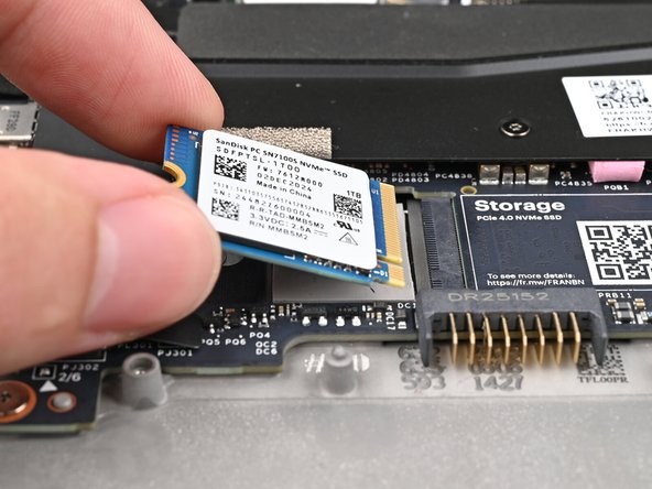

  19. Hold the SSD by its edges. Don't touch the gold contacts with your fingers. If you do, wipe the contacts with a clean, lint-free cloth to remove any finger oils. Insert the SSD into the socket at a shallow angle. The gold contacts should mostly be covered by the socket.
  20. While holding the SSD flat to the Mainboard, use your Framework Screwdriver to install the 2 mm‑long T5 Torx screw securing the SSD. While holding the SSD flat to the Mainboard, use your Framework Screwdriver to install the 2 mm‑long T5 Torx screw securing the SSD. While holding the SSD flat to the Mainboard, use your Framework Screwdriver to install the 2 mm‑long T5 Torx screw securing the SSD.
    • While holding the SSD flat to the Mainboard, use your Framework Screwdriver to install the 2 mm‑long T5 Torx screw securing the SSD.
