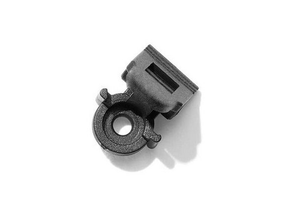

Follow this guide to remove and replace the SSD clip in your Framework Laptop 12.
The SSD clip is a black plastic piece that holds the SSD in place. If you can't get the SSD to stay latched, you'll need to replace this clip.

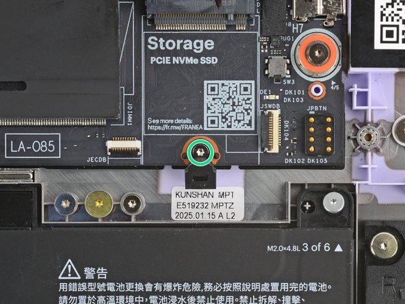

  9. Use your Framework Screwdriver to remove the 3.5 mm‑long T5 Torx screw securing the SSD clip.
    • Use your Framework Screwdriver to remove the 3.5 mm‑long T5 Torx screw securing the SSD clip.
    • This screw is not captive. Store it in a safe location for reassembly.

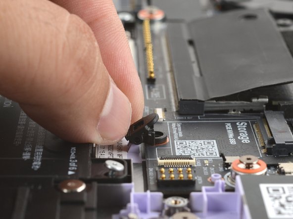

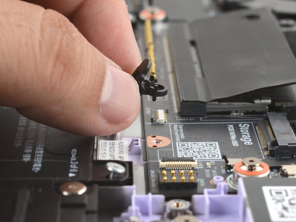

  10. Use your fingers to lift and remove the SSD clip. Use your fingers to lift and remove the SSD clip.
    • Use your fingers to lift and remove the SSD clip.
