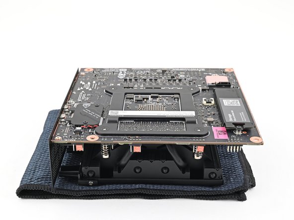

  31. Place the Mainboard on your work surface with its heatsink resting on a soft, clean cloth. Place the Mainboard on your work surface with its heatsink resting on a soft, clean cloth.
    • Place the Mainboard on your work surface with its heatsink resting on a soft, clean cloth.

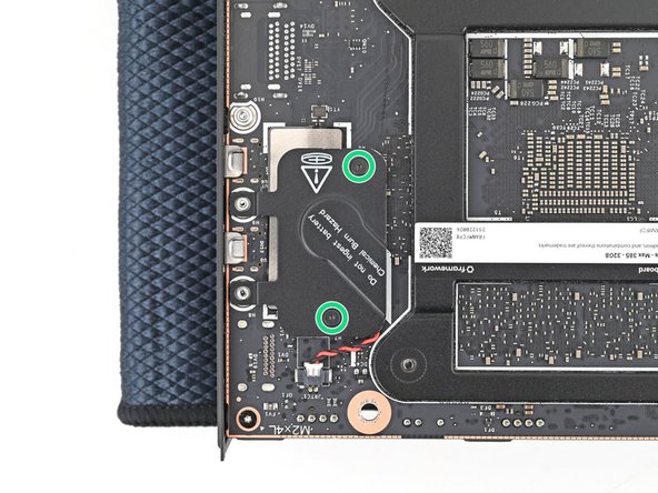

  32. Use your Framework Desktop Screwdriver to loosen the two captive T5 Torx screws securing the RTC battery cover. Use your Framework Desktop Screwdriver to loosen the two captive T5 Torx screws securing the RTC battery cover.
    • Use your Framework Desktop Screwdriver to loosen the two captive T5 Torx screws securing the RTC battery cover.

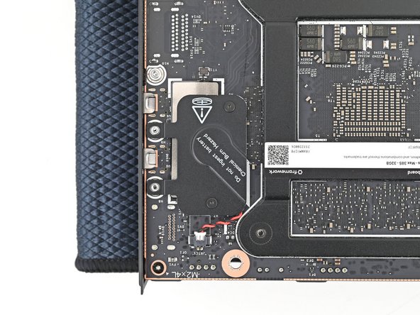

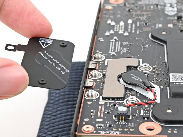

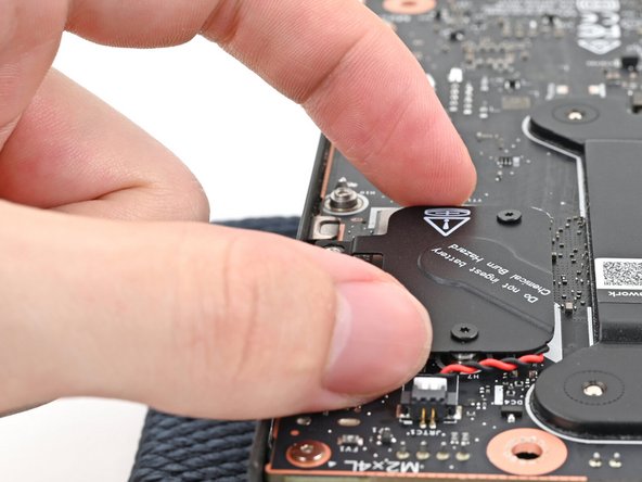

  33. Lift the RTC battery cover off the Mainboard and remove it. Lift the RTC battery cover off the Mainboard and remove it.
    • Lift the RTC battery cover off the Mainboard and remove it.

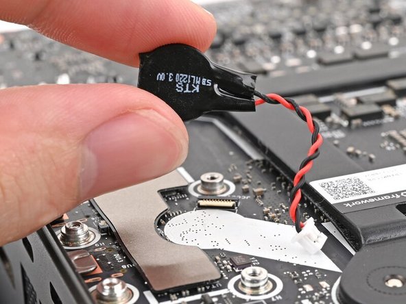

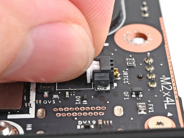

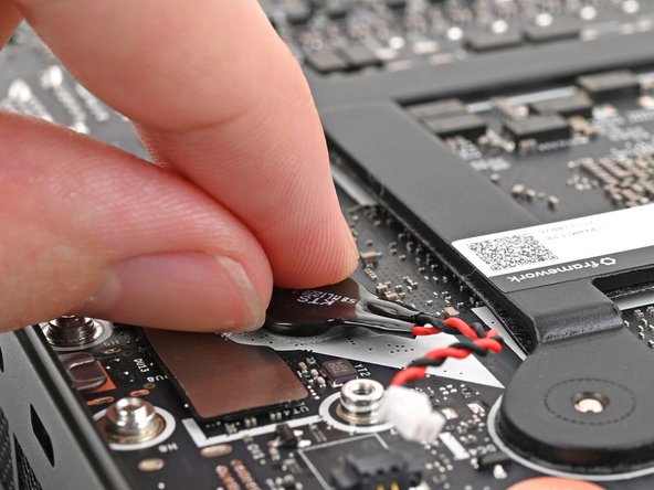

  34. Grip the RTC battery connector and pull it straight out of its socket to disconnect it. Grip the RTC battery connector and pull it straight out of its socket to disconnect it.
    • Grip the RTC battery connector and pull it straight out of its socket to disconnect it.

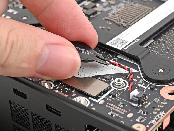

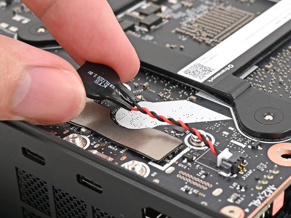

  35. The RTC battery is lightly adhered to the Mainboard. Use your fingers to peel the RTC battery off the Mainboard and remove it. Use your fingers to peel the RTC battery off the Mainboard and remove it.
    • The RTC battery is lightly adhered to the Mainboard.
    • Use your fingers to peel the RTC battery off the Mainboard and remove it.

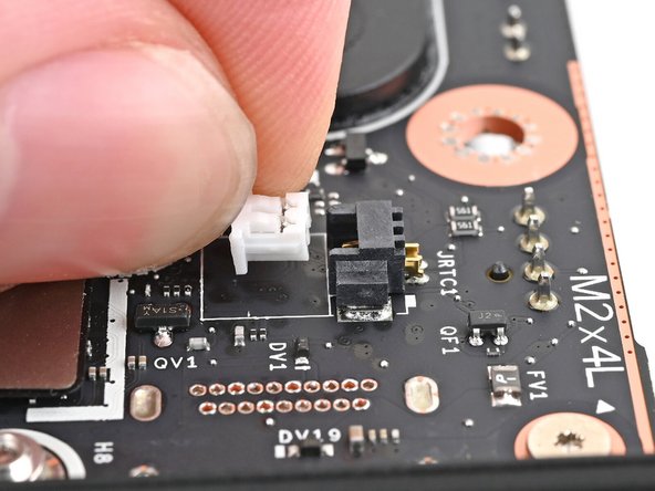

  37. Insert the RTC battery connector into its socket and push on the edges until it's fully seated. Insert the RTC battery connector into its socket and push on the edges until it's fully seated.
    • Insert the RTC battery connector into its socket and push on the edges until it's fully seated.

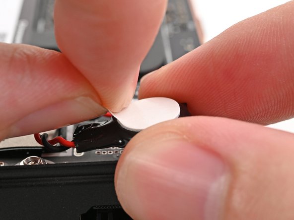

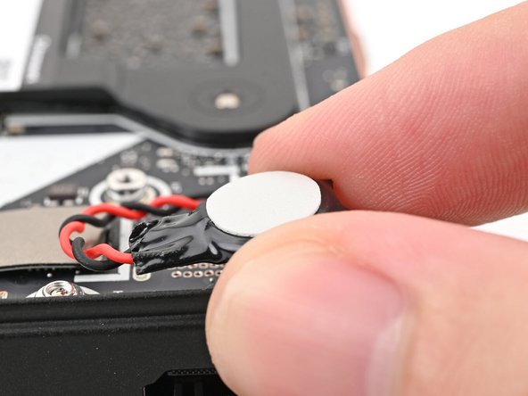

  38. Peel the white liner off the back of the RTC battery to expose the adhesive. Peel the white liner off the back of the RTC battery to expose the adhesive. Peel the white liner off the back of the RTC battery to expose the adhesive.
    • Peel the white liner off the back of the RTC battery to expose the adhesive.

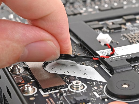

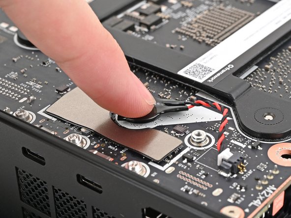

  39. Orient the RTC battery so it's aligned with the white circular marking on the Mainboard. Press the RTC battery onto the Mainboard to secure the adhesive. Press the RTC battery onto the Mainboard to secure the adhesive.
    • Orient the RTC battery so it's aligned with the white circular marking on the Mainboard.
    • Press the RTC battery onto the Mainboard to secure the adhesive.
  40. Place the cover over the RTC battery and align its screws. Place the cover over the RTC battery and align its screws.
    • Place the cover over the RTC battery and align its screws.
  41. Use your Framework Desktop Screwdriver to install the two captive T5 Torx screws securing the RTC battery cover. Use your Framework Desktop Screwdriver to install the two captive T5 Torx screws securing the RTC battery cover.
    • Use your Framework Desktop Screwdriver to install the two captive T5 Torx screws securing the RTC battery cover.

  63. Use your Framework Desktop Screwdriver to install the four 27.3 mm‑long Phillips screws securing the CPU fan and fan duct. Use your Framework Desktop Screwdriver to install the four 27.3 mm‑long Phillips screws securing the CPU fan and fan duct.
    • Use your Framework Desktop Screwdriver to install the four 27.3 mm‑long Phillips screws securing the CPU fan and fan duct.
  64. Orient the main fan cable so its two vertical lines are facing you. Slide the main fan cable over the four-pronged connector labeled "APU Fan," making sure the orange label slots between the vertical lines.
  65. If you aren't using an RGB fan, then skip this step. Orient the RGB cable so the arrow is facing you. Use your fingers to slide the RGB cable over the three pronged connector located to the right of the "APU Fan" connector.
    • Orient the RGB cable so the arrow is facing you.
  66. Slide the Left Panel onto the left edge of the chassis and press it flat to ensure its clips are slotted into place. There should be a small gap between the bottom of the Left Panel and the silver base. Push the Left Panel towards the base of the computer to close the gap and engage the clips.
  67. Orient the Top Panel so its arrow is pointing towards the rear of the computer. While holding the Top Panel at a slight downward angle, slide it across the top of the chassis (from rear to front) until you feel its clips catch. There should be a small gap between the Top Panel and the front of the Desktop.
  68. While securing the computer with one hand, use the other hand to slide the Top Panel towards the front of the computer to close the gap and engage the clips. While securing the computer with one hand, use the other hand to slide the Top Panel towards the front of the computer to close the gap and engage the clips.
  69. If you're installing the Handle on your Desktop, follow this step. Otherwise, skip it. Place the Handle over the Top Panel screw holes.
  70. Insert the top panel screw into its hole and twist clockwise until it feels snug. Insert the top panel screw into its hole and twist clockwise until it feels snug. Insert the top panel screw into its hole and twist clockwise until it feels snug.
  71. Repeat the same procedure for the other top panel screw. Repeat the same procedure for the other top panel screw. Repeat the same procedure for the other top panel screw.
  72. Use your finger to close the two D-rings on the top panel screws. Use your finger to close the two D-rings on the top panel screws. Use your finger to close the two D-rings on the top panel screws.
You finished fixing your Framework Desktop!
