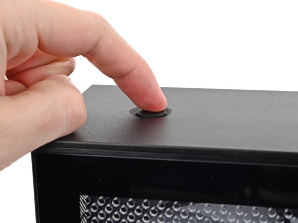

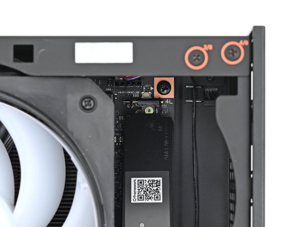

    • Remove the Handle.
    • Remove the Top Panel screw.
  7. Use your fingers to grip the top of the Left Panel and slide it upward to release its clips. Remove the Left Panel. Remove the Left Panel.
    • Remove the Left Panel.

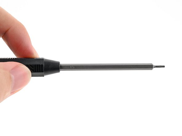

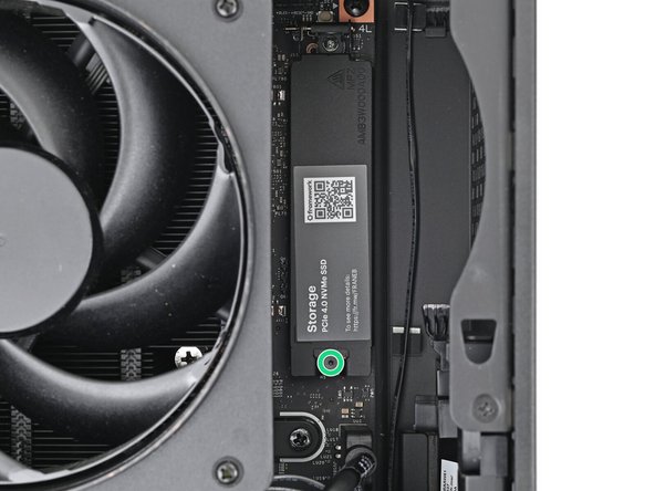

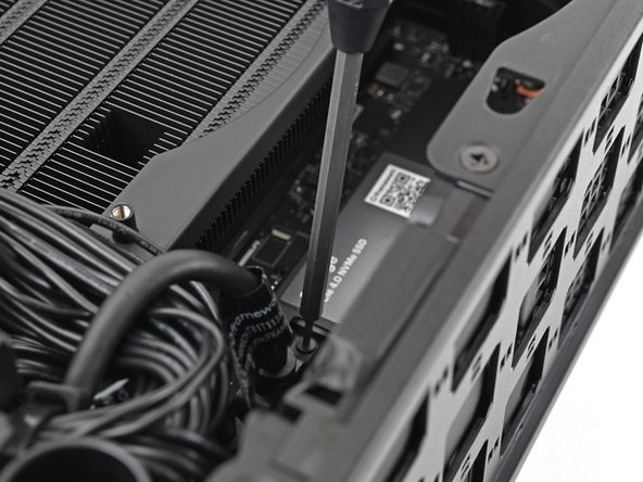

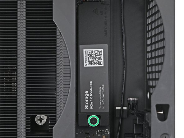

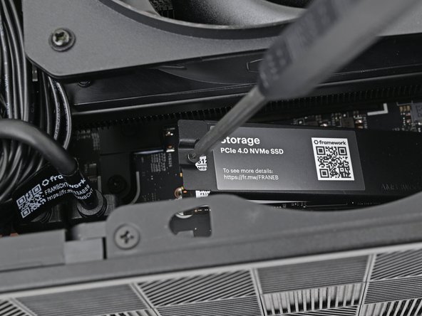

  8. Use your Framework Desktop Screwdriver to loosen the captive T5 Torx screw securing the SSD. The SSD and its heat spreader will pop up to an angle when its screw is fully loosened.
    • Use your Framework Desktop Screwdriver to loosen the captive T5 Torx screw securing the SSD.
    • The SSD and its heat spreader will pop up to an angle when its screw is fully loosened.

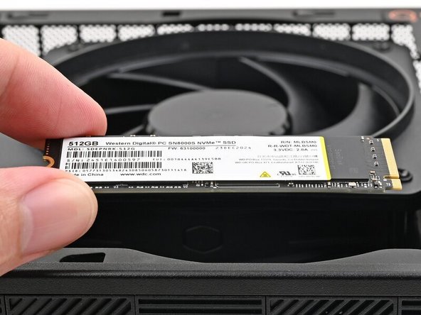

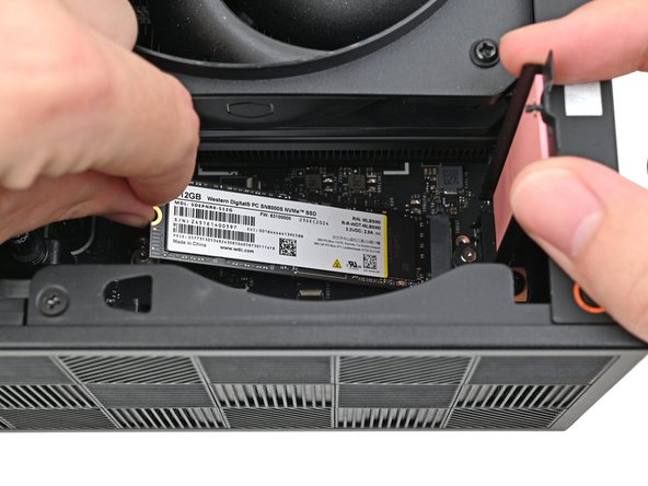

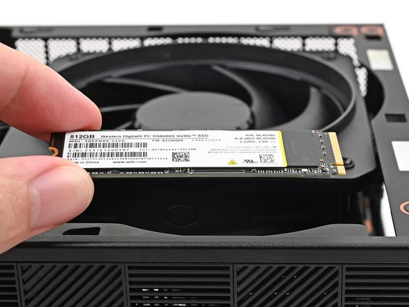

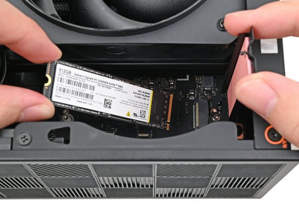

  9. While holding the heat spreader upright, grab the SSD by its edges and pull it out of its socket. Remove the SSD. Remove the SSD.
    • While holding the heat spreader upright, grab the SSD by its edges and pull it out of its socket.
    • Remove the SSD.

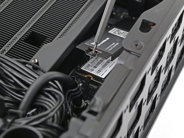

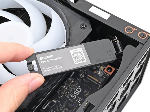

  10. If your replacement SSD comes with a pre-installed heat spreader, follow the next two steps. Otherwise skip this and the following step. While securing the primary storage heat spreader with one hand, use your Framework Desktop Screwdriver to remove the 4.5 mm‑long T5 Torx screw securing it. While securing the primary storage heat spreader with one hand, use your Framework Desktop Screwdriver to remove the 4.5 mm‑long T5 Torx screw securing it.
    • If your replacement SSD comes with a pre-installed heat spreader, follow the next two steps. Otherwise skip this and the following step.
    • While securing the primary storage heat spreader with one hand, use your Framework Desktop Screwdriver to remove the 4.5 mm‑long T5 Torx screw securing it.
  11. Lift the primary storage heat spreader out of the Desktop and remove it.
    • Lift the primary storage heat spreader out of the Desktop and remove it.
    • Follow the guide normally, making sure to ignore instructions that involve the primary storage heat spreader.

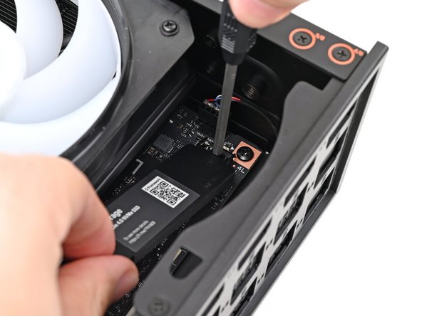

  13. Use your Framework Desktop Screwdriver to loosen the captive T5 Torx screw securing the SSD.
  14. Hold the SSD by its edges. Don't touch the gold contacts with your fingers. If you do, wipe the contacts with a clean, lint-free cloth to remove any finger oils. While holding the heat spreader upright, align the SSD's gold contacts with its socket.

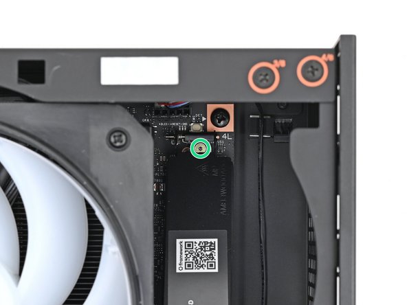

  15. Insert your Framework Desktop Screwdriver into the captive screw on the primary storage heat spreader and press it flat to the Mainboard. Tighten the screw securing the SSD. Tighten the screw securing the SSD.
    • Insert your Framework Desktop Screwdriver into the captive screw on the primary storage heat spreader and press it flat to the Mainboard.
    • Tighten the screw securing the SSD.

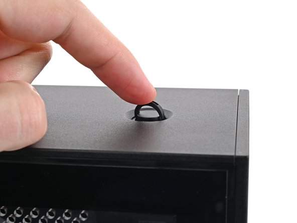

  22. Use your finger to close the two D-rings on the top panel screws. Use your finger to close the two D-rings on the top panel screws. Use your finger to close the two D-rings on the top panel screws.
