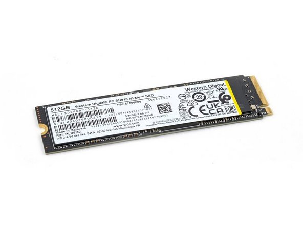

Follow this guide to replace or upgrade the primary SSD in your Framework Laptop 16.
Your Framework Laptop uses SSDs (Solid State Drive) for storage. The primary storage supports an M.2 2280 NVMe SSD.

  11. Use your Framework Screwdriver to remove the 2 mm‑long T5 Torx screw securing the SSD. The SSD might pop up at a shallow angle when you remove the screw.
    • Use your Framework Screwdriver to remove the 2 mm‑long T5 Torx screw securing the SSD.
    • The SSD might pop up at a shallow angle when you remove the screw.
  12. Grip the end of the SSD with the screw hole and slide it out of its socket. Remove the SSD.
    • Grip the end of the SSD with the screw hole and slide it out of its socket.
    • Remove the SSD.
  13. Congratulations on completing disassembly! The remaining steps will show how to reassemble your Framework Laptop.
  14. Hold the SSD by its edges. Don't touch the gold contacts with your fingers. If you do, wipe the contacts with a clean, lint-free cloth to remove any finger oils. Insert the SSD into the socket at a shallow angle. The gold contacts should mostly be covered by the socket.
  15. While holding the SSD flat to the Mainboard, use your Framework Screwdriver to install the 2 mm‑long T5 Torx screw securing the SSD. While holding the SSD flat to the Mainboard, use your Framework Screwdriver to install the 2 mm‑long T5 Torx screw securing the SSD. While holding the SSD flat to the Mainboard, use your Framework Screwdriver to install the 2 mm‑long T5 Torx screw securing the SSD.
