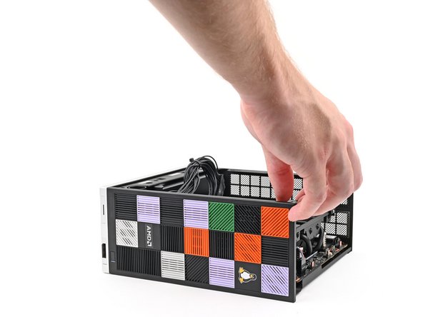

    • Remove the Handle.
    • Remove the Top Panel screw.

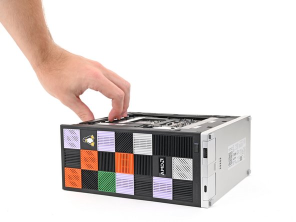

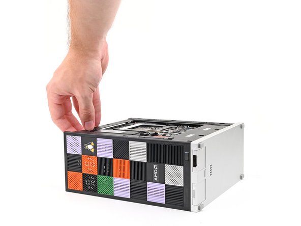

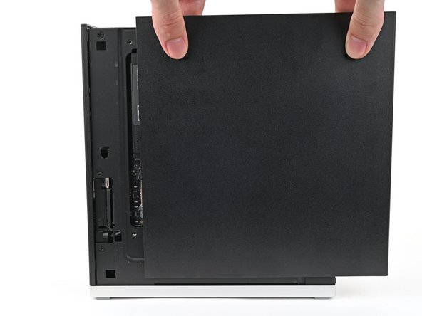

  7. Use your fingers to grip the top of the Left Panel and slide it upward to release its clips. Remove the Left Panel. Remove the Left Panel.

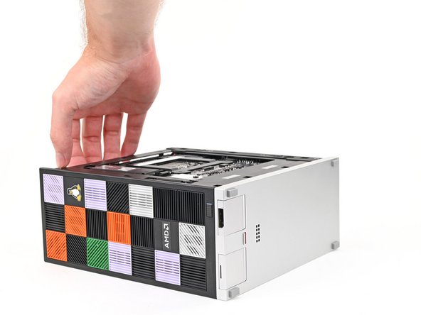

    • Remove the Left Panel.

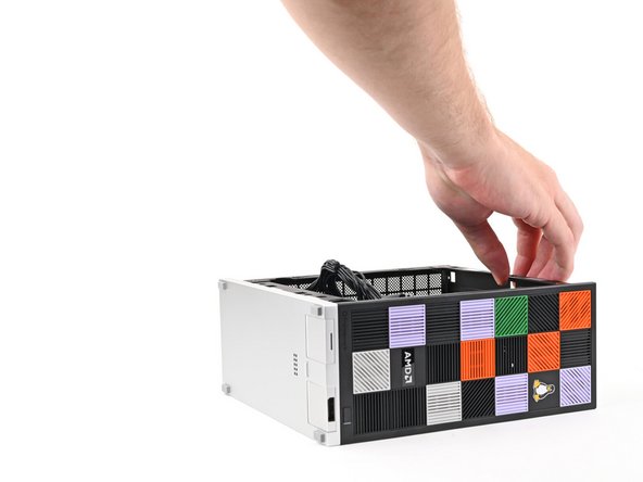

  8. Lay down the Desktop on its side so the fan is facing upward. Lay down the Desktop on its side so the fan is facing upward.
    • Lay down the Desktop on its side so the fan is facing upward.

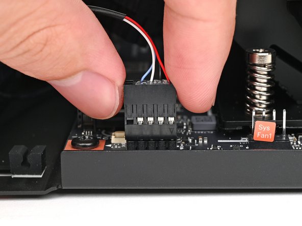

  9. Use your fingers to lift the APU fan cable connector off its four‑pronged socket on the Mainboard. Use your fingers to lift the APU fan cable connector off its four‑pronged socket on the Mainboard.
    • Use your fingers to lift the APU fan cable connector off its four‑pronged socket on the Mainboard.

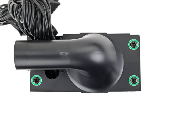

  11. Use your Framework Desktop Screwdriver to remove the four 27.3 mm‑long Phillips screws securing the CPU fan and fan duct. Use your Framework Desktop Screwdriver to remove the four 27.3 mm‑long Phillips screws securing the CPU fan and fan duct.
    • Use your Framework Desktop Screwdriver to remove the four 27.3 mm‑long Phillips screws securing the CPU fan and fan duct.

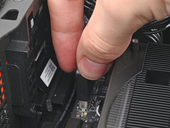

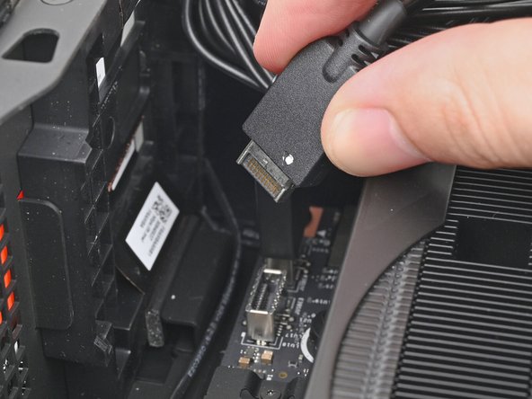

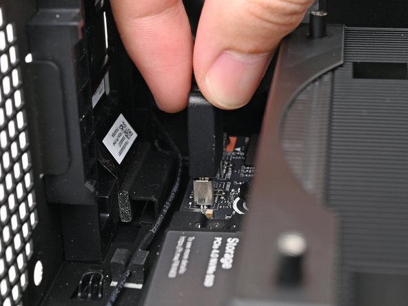

  14. Pull the top Expansion Card connector straight out of its socket in the Mainboard to disconnect it. Pull the top Expansion Card connector straight out of its socket in the Mainboard to disconnect it.
    • Pull the top Expansion Card connector straight out of its socket in the Mainboard to disconnect it.

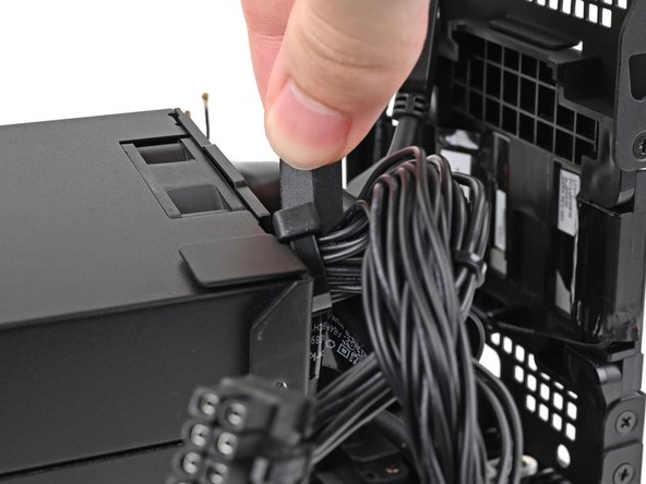

  15. While squeezing the clip on the main power cable, pull it straight up and out of its socket to disconnect it. While squeezing the clip on the main power cable, pull it straight up and out of its socket to disconnect it.
    • While squeezing the clip on the main power cable, pull it straight up and out of its socket to disconnect it.

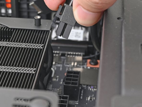

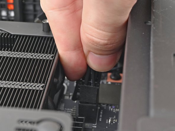

  16. While squeezing the clip on the CPU power cable, pull it straight up and out of its socket to disconnect it. While squeezing the clip on the CPU power cable, pull it straight up and out of its socket to disconnect it.
    • While squeezing the clip on the CPU power cable, pull it straight up and out of its socket to disconnect it.

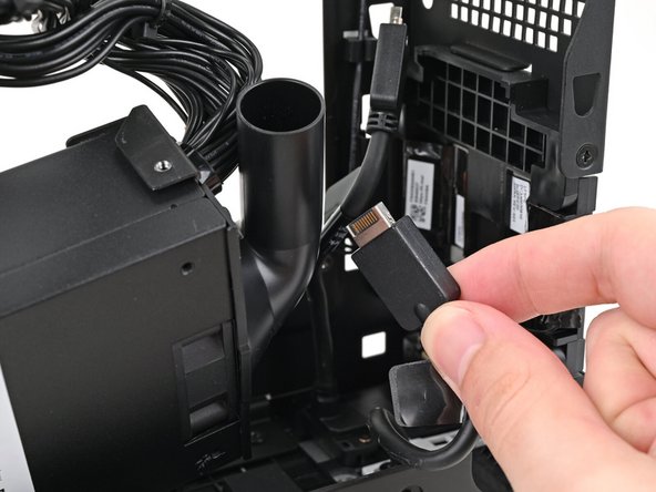

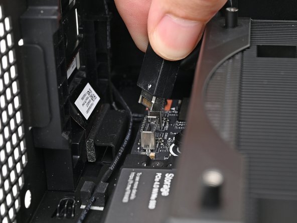

  17. Pull the bottom Expansion Card connector straight out of its socket in the Mainboard to disconnect it. Pull the bottom Expansion Card connector straight out of its socket in the Mainboard to disconnect it.
    • Pull the bottom Expansion Card connector straight out of its socket in the Mainboard to disconnect it.

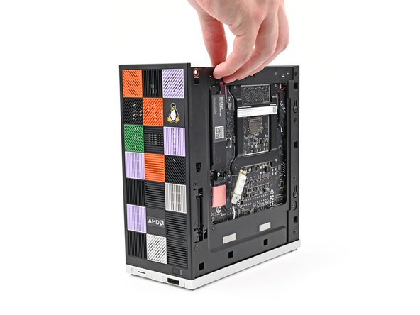

  18. Lift the Desktop so it stands upright on your work surface. Lift the Desktop so it stands upright on your work surface.
    • Lift the Desktop so it stands upright on your work surface.

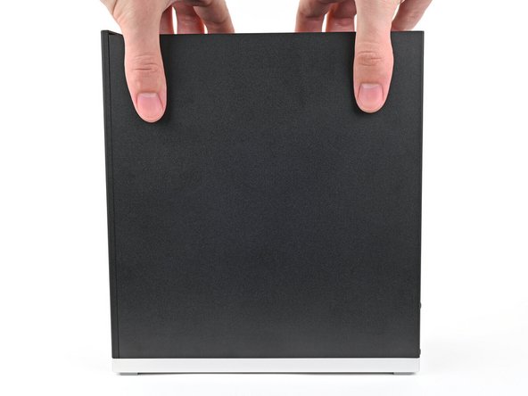

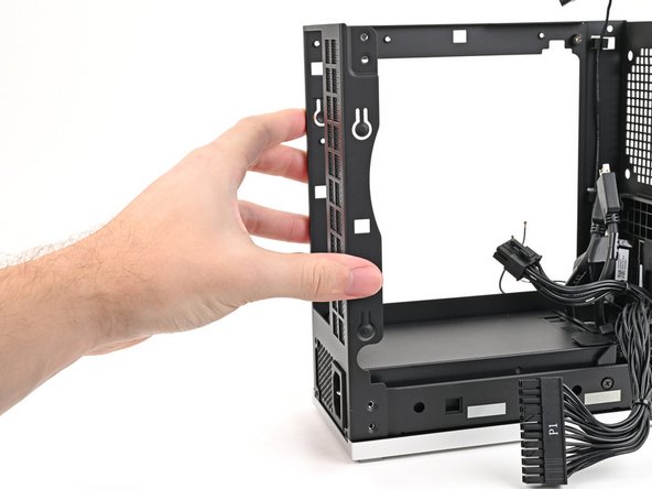

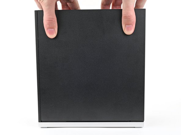

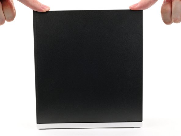

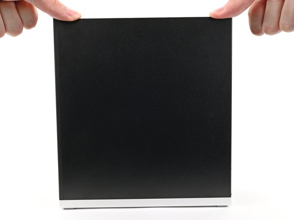

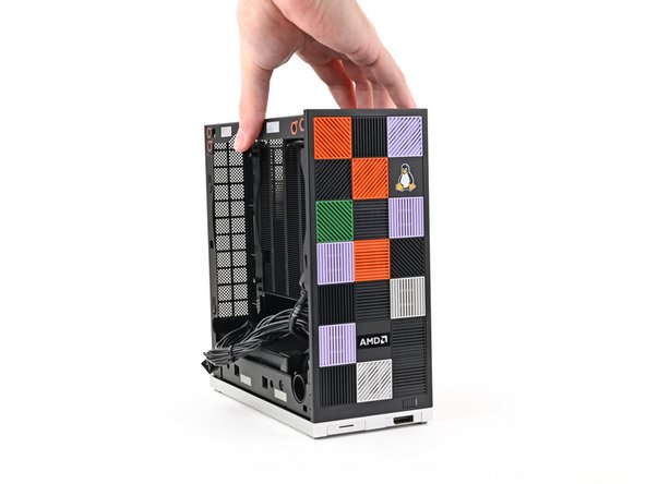

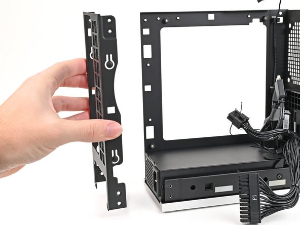

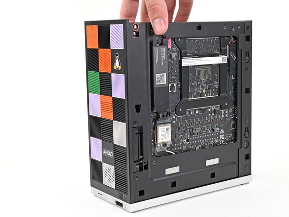

  19. Use your fingers to grip the top of the Right Panel and slide it upward to release its clips. Remove the Right Panel. Remove the Right Panel.
    • Remove the Right Panel.

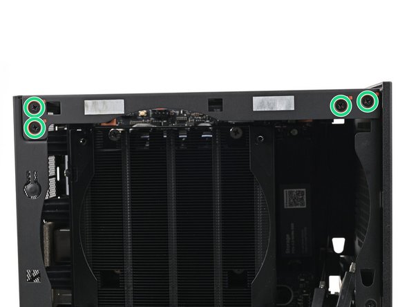

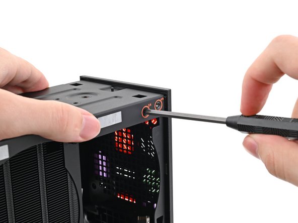

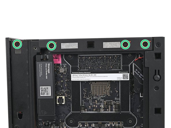

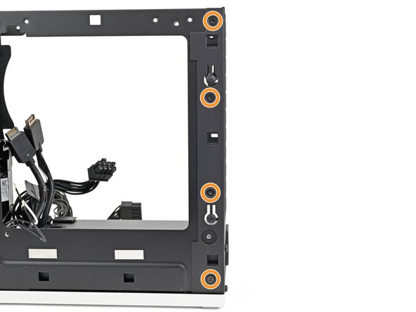

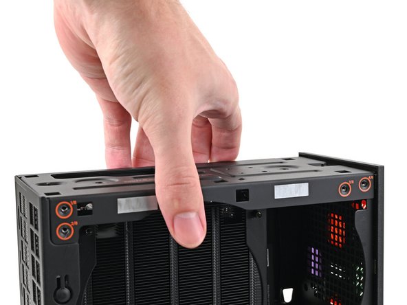

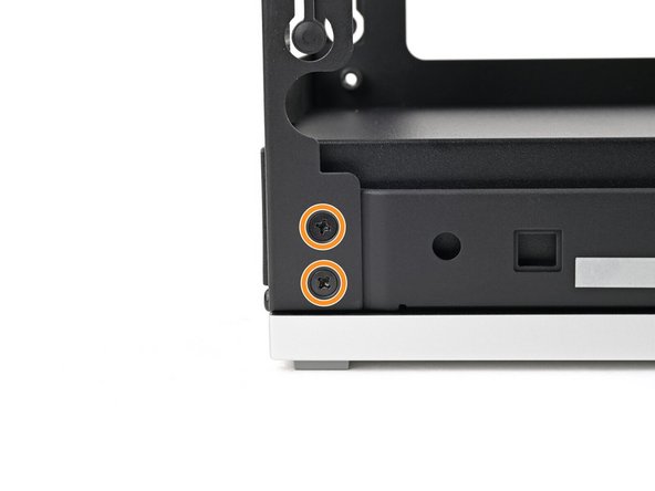

  20. While holding the Desktop steady, use your Framework Desktop Screwdriver to remove the eight 4.0 mm‑long Phillips screws securing the top plate. While holding the Desktop steady, use your Framework Desktop Screwdriver to remove the eight 4.0 mm‑long Phillips screws securing the top plate. While holding the Desktop steady, use your Framework Desktop Screwdriver to remove the eight 4.0 mm‑long Phillips screws securing the top plate.
    • While holding the Desktop steady, use your Framework Desktop Screwdriver to remove the eight 4.0 mm‑long Phillips screws securing the top plate.

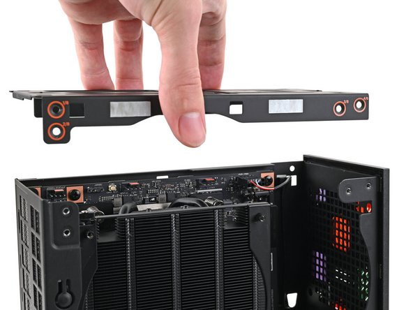

  21. Lift the top plate off the Desktop and remove it. Lift the top plate off the Desktop and remove it.
    • Lift the top plate off the Desktop and remove it.

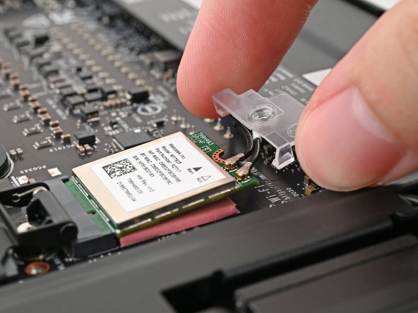

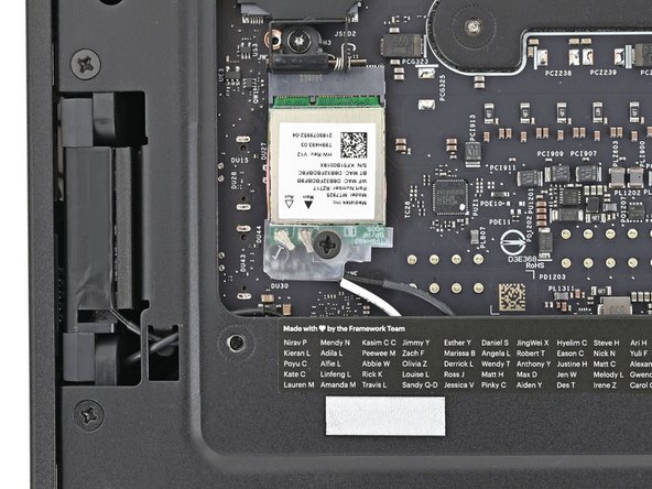

  24. Use your fingers to slide the Wi-Fi module cover straight off the bottom of the module. Remove the cover.
    • Use your fingers to slide the Wi-Fi module cover straight off the bottom of the module.
    • Remove the cover.

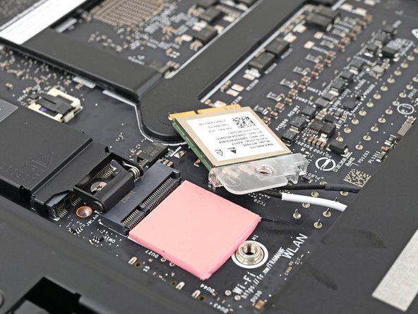

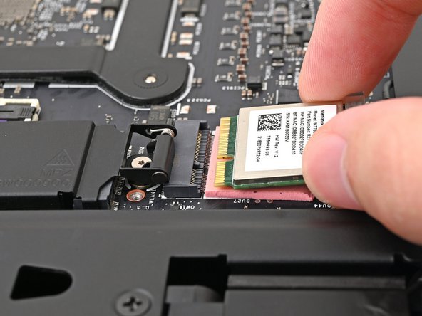

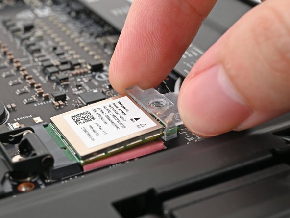

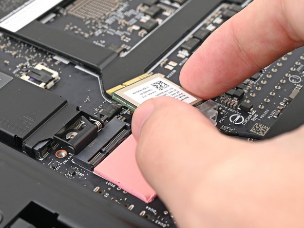

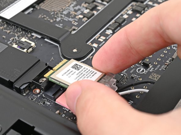

  25. Grip the Wi-Fi module by its edges and pull it straight out of its socket. Grip the Wi-Fi module by its edges and pull it straight out of its socket.
    • Grip the Wi-Fi module by its edges and pull it straight out of its socket.
  26. Move the Wi-Fi module towards the center of the Mainboard to keep it out of the way. Move the Wi-Fi module towards the center of the Mainboard to keep it out of the way. Move the Wi-Fi module towards the center of the Mainboard to keep it out of the way.
    • Move the Wi-Fi module towards the center of the Mainboard to keep it out of the way.

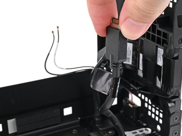

  28. Use your fingers to lift the power button cable connector off its nine‑pronged socket on the Mainboard. Use your fingers to lift the power button cable connector off its nine‑pronged socket on the Mainboard.
    • Use your fingers to lift the power button cable connector off its nine‑pronged socket on the Mainboard.

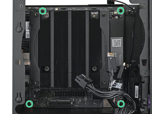

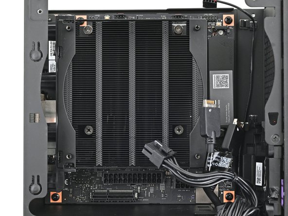

  29. Use your Framework Desktop Screwdriver to remove the four 8.2 mm‑long Phillips screws securing the Mainboard. Use your Framework Desktop Screwdriver to remove the four 8.2 mm‑long Phillips screws securing the Mainboard.
    • Use your Framework Desktop Screwdriver to remove the four 8.2 mm‑long Phillips screws securing the Mainboard.

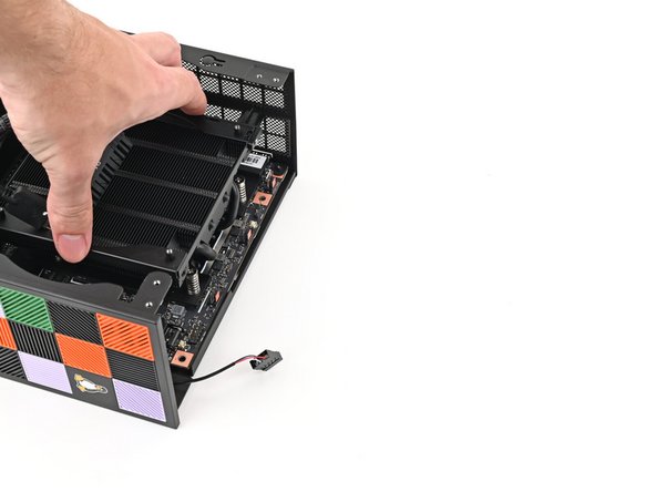

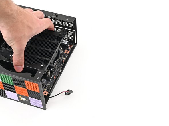

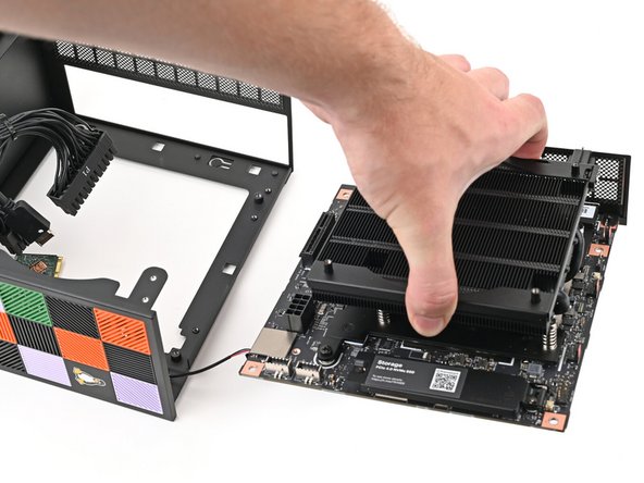

  30. Grab the Mainboard by its heatsink and pull it towards the front of the Desktop to slide it out of the rear port cutout. When handling the Heatsink, grab from the left and right sides (sides facing Front Panel & Back IO) as shown in the image to prevent bent fins and possible damage to the Heatsink. Slide the Mainboard towards the top of the Desktop to remove it from the chassis.
    • Grab the Mainboard by its heatsink and pull it towards the front of the Desktop to slide it out of the rear port cutout.
    • When handling the Heatsink, grab from the left and right sides (sides facing Front Panel & Back IO) as shown in the image to prevent bent fins and possible damage to the Heatsink.
    • Slide the Mainboard towards the top of the Desktop to remove it from the chassis.

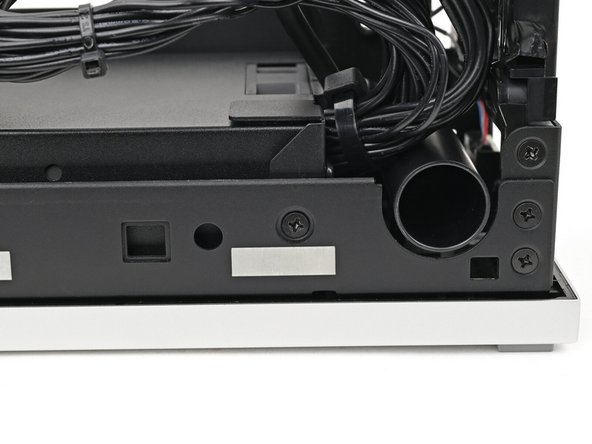

  31. Use your Framework Desktop Screwdriver to remove the three 5.9 mm‑long Phillips screws securing the power supply. Optionally, you can remove the six 4.0 mm‑long screws securing the rear plate to make removing the power supply easier. If you don't remove the rear plate screws, skip the next step.
    • Use your Framework Desktop Screwdriver to remove the three 5.9 mm‑long Phillips screws securing the power supply.
    • Optionally, you can remove the six 4.0 mm‑long screws securing the rear plate to make removing the power supply easier.
    • If you don't remove the rear plate screws, skip the next step.
  32. Pull the rear plate off the back of the Desktop and remove it. Pull the rear plate off the back of the Desktop and remove it.
    • Pull the rear plate off the back of the Desktop and remove it.

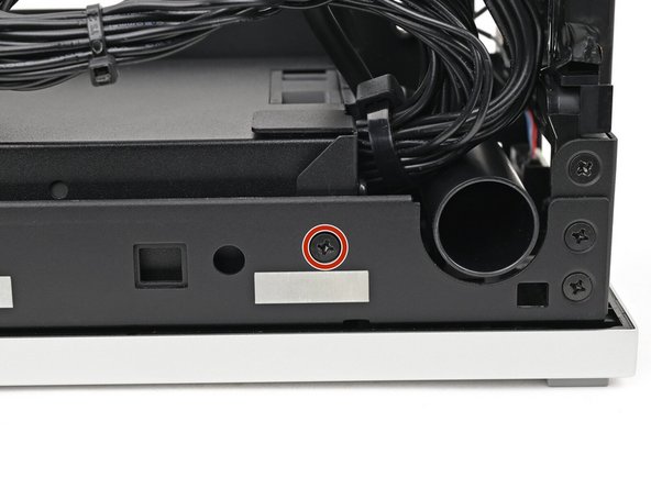

  33. Use your Framework Desktop Screwdriver to remove the 4.0 mm‑long Phillips screw securing the power supply. Use your Framework Desktop Screwdriver to remove the 4.0 mm‑long Phillips screw securing the power supply.
    • Use your Framework Desktop Screwdriver to remove the 4.0 mm‑long Phillips screw securing the power supply.

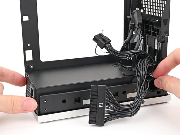

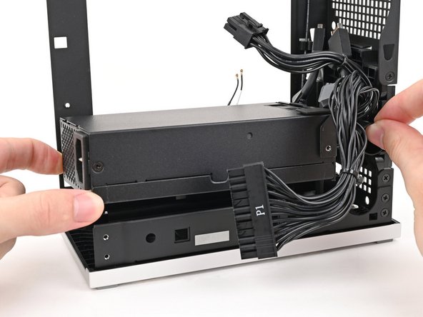

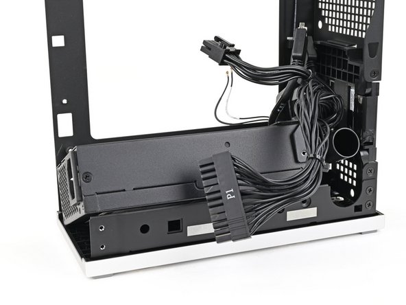

  34. Lift the power supply out of its slot and let it rest on the left side of the Desktop. Lift the power supply out of its slot and let it rest on the left side of the Desktop. Lift the power supply out of its slot and let it rest on the left side of the Desktop.
    • Lift the power supply out of its slot and let it rest on the left side of the Desktop.

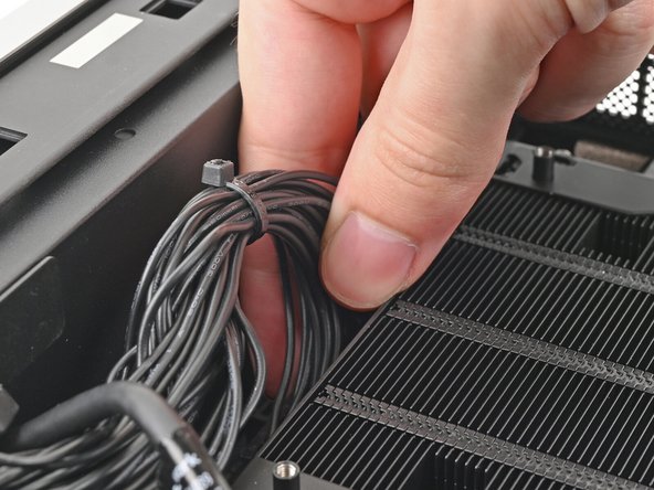

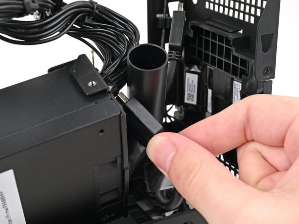

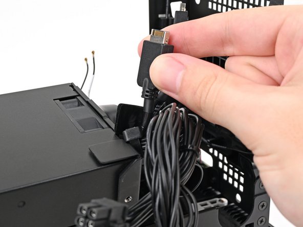

  35. Push the right Expansion Card cable through the gap between the power supply and its duct. The gap is very small and might require some force to thread the cable through. Remove the power supply.
    • Push the right Expansion Card cable through the gap between the power supply and its duct.
    • The gap is very small and might require some force to thread the cable through.
    • Remove the power supply.

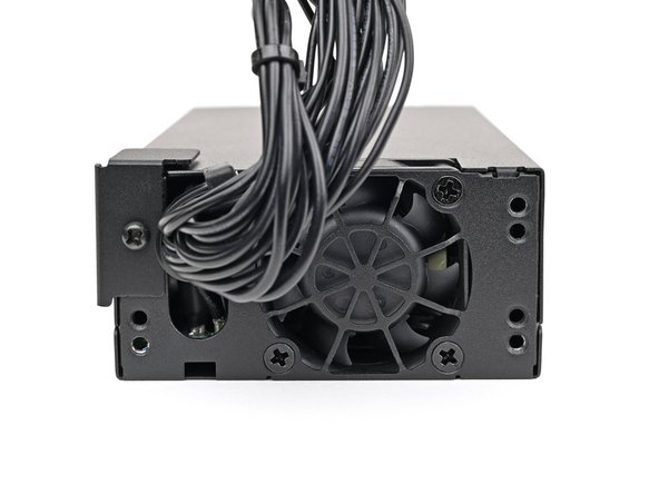

  36. Congratulations on completing disassembly! The remaining steps will show how to reassemble your Framework Desktop.

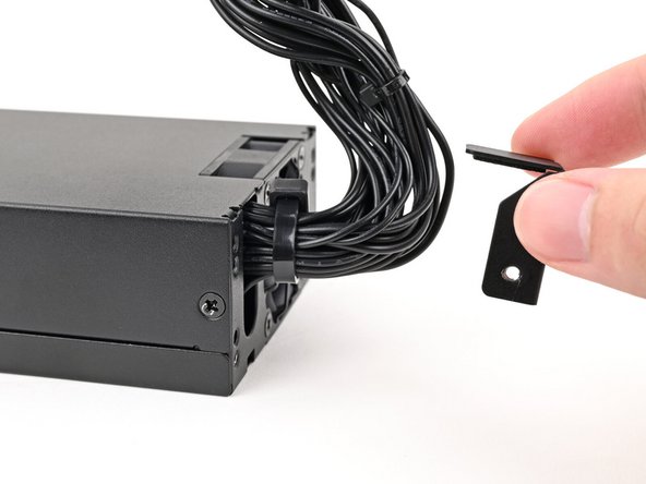

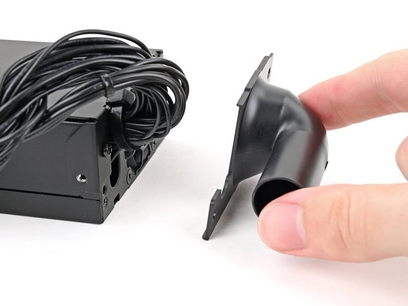

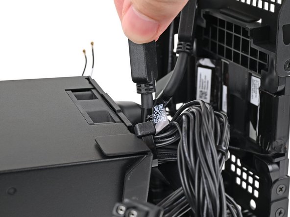

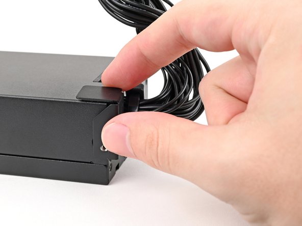

  37. If your power supply doesn't come with its mounting bracket and Power Supply Duct pre-installed, follow the next four steps. Otherwise, skip ahead four steps. Place the mounting bracket on the corner of the power supply closest to the wire bundle.
    • If your power supply doesn't come with its mounting bracket and Power Supply Duct pre-installed, follow the next four steps. Otherwise, skip ahead four steps.
    • Place the mounting bracket on the corner of the power supply closest to the wire bundle.
  38. Use your Framework Desktop Screwdriver to Install the 5.8 mm‑long Phillips screw securing the mounting bracket. Use your Framework Desktop Screwdriver to Install the 5.8 mm‑long Phillips screw securing the mounting bracket.
    • Use your Framework Desktop Screwdriver to Install the 5.8 mm‑long Phillips screw securing the mounting bracket.

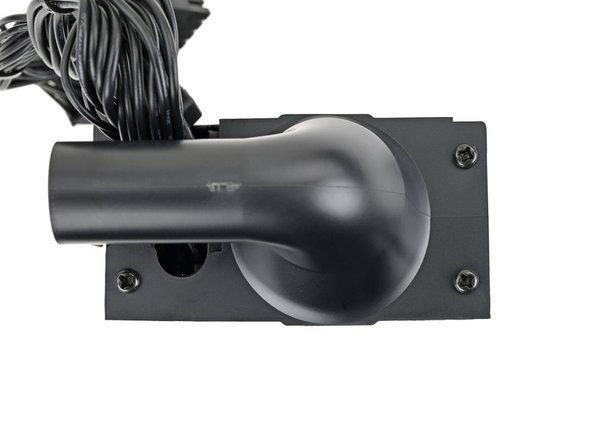

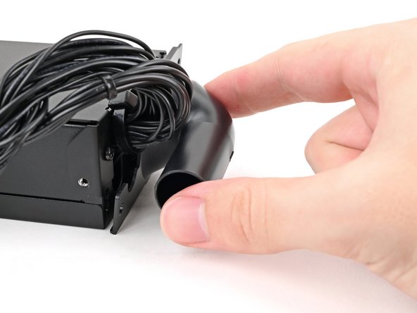

  39. Place the Power Supply Duct on the power supply and align its screw holes. Place the Power Supply Duct on the power supply and align its screw holes.
    • Place the Power Supply Duct on the power supply and align its screw holes.
  40. Use your Framework Desktop Screwdriver to Install the three 5.8 mm‑long Phillips screws securing the Power Supply Duct. Use your Framework Desktop Screwdriver to Install the three 5.8 mm‑long Phillips screws securing the Power Supply Duct.
    • Use your Framework Desktop Screwdriver to Install the three 5.8 mm‑long Phillips screws securing the Power Supply Duct.

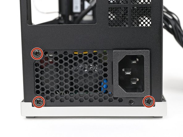

  43. Use your Framework Desktop Screwdriver to install the 4.0 mm‑long Phillips screw securing the power supply. Use your Framework Desktop Screwdriver to install the 4.0 mm‑long Phillips screw securing the power supply.
    • Use your Framework Desktop Screwdriver to install the 4.0 mm‑long Phillips screw securing the power supply.

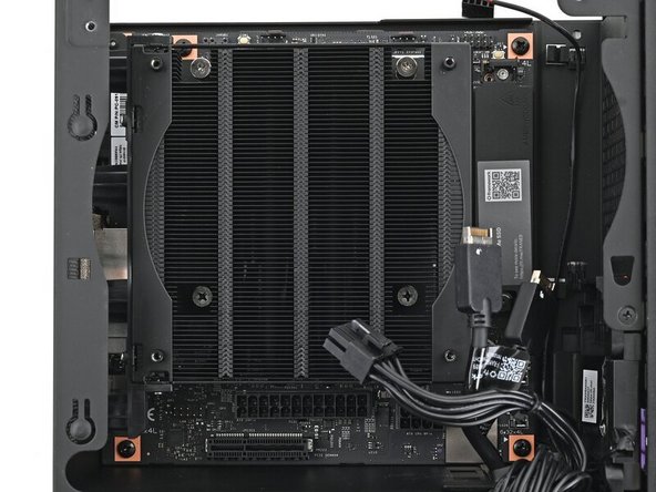

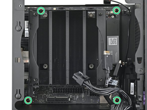

  47. Use your Framework Desktop Screwdriver to install the four 8.2 mm‑long Phillips screws securing the Mainboard. Use your Framework Desktop Screwdriver to install the four 8.2 mm‑long Phillips screws securing the Mainboard.
    • Use your Framework Desktop Screwdriver to install the four 8.2 mm‑long Phillips screws securing the Mainboard.

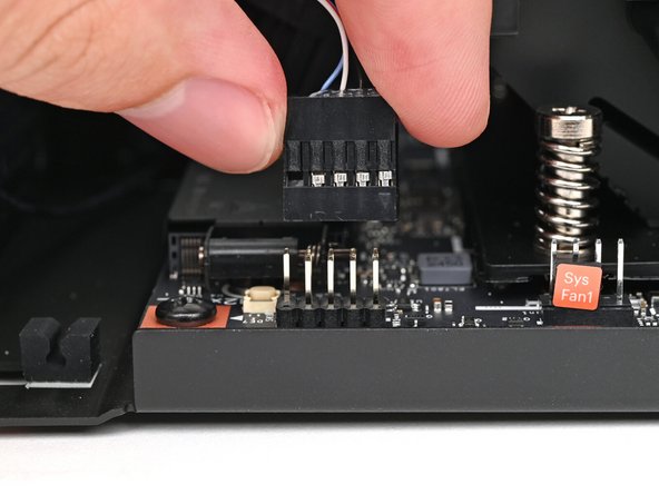

  48. Slide the power button cable over the nine-pronged connector on the Mainboard. Slide the power button cable over the nine-pronged connector on the Mainboard.
    • Slide the power button cable over the nine-pronged connector on the Mainboard.

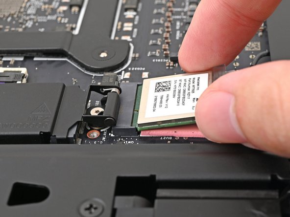

  50. Hold the Wi-Fi module by its edges. Don't touch the gold contacts with your fingers. If you do, wipe the contacts with a clean, lint-free cloth to remove any finger oils. Align the Wi-Fi module's gold contacts and notch with the socket on the Mainboard.
  51. Use your fingers to slide the Wi-Fi module cover straight on the bottom of the module. Install the cover.
    • Use your fingers to slide the Wi-Fi module cover straight on the bottom of the module.
    • Install the cover.

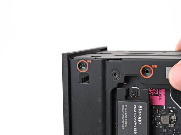

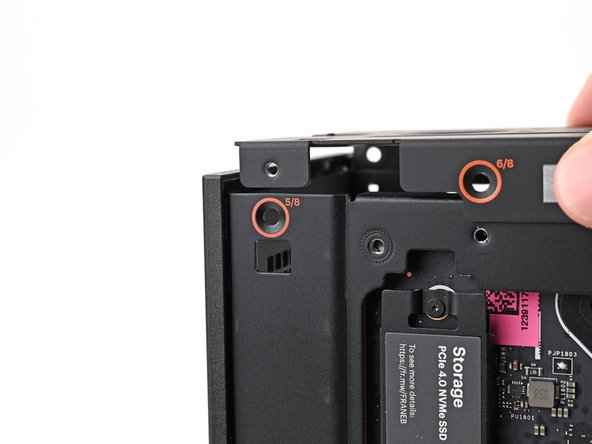

  54. Place the top plate on top of the Desktop, making sure it slots into the chassis so the orange circles are visible. Place the top plate on top of the Desktop, making sure it slots into the chassis so the orange circles are visible.
    • Place the top plate on top of the Desktop, making sure it slots into the chassis so the orange circles are visible.
  55. Make sure the matching screw hole on the top plate labeled "5/8" is slotted on the inside of the Chassis so that the orange circle is visible. Make sure the matching screw hole on the top plate labeled "5/8" is slotted on the inside of the Chassis so that the orange circle is visible.
    • Make sure the matching screw hole on the top plate labeled "5/8" is slotted on the inside of the Chassis so that the orange circle is visible.
  56. While holding the Desktop steady, use your Framework Desktop Screwdriver to install the eight 4.0 mm‑long Phillips screws securing the top plate. While holding the Desktop steady, use your Framework Desktop Screwdriver to install the eight 4.0 mm‑long Phillips screws securing the top plate. While holding the Desktop steady, use your Framework Desktop Screwdriver to install the eight 4.0 mm‑long Phillips screws securing the top plate.
    • While holding the Desktop steady, use your Framework Desktop Screwdriver to install the eight 4.0 mm‑long Phillips screws securing the top plate.

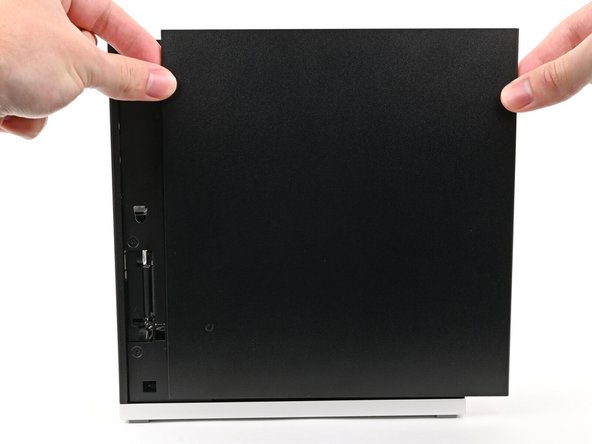

  57. Slide the Right Panel onto the right edge of the chassis, from top to bottom, and press it flat to ensure its clips are slotted into place. There should be a small gap between the bottom of the Right Panel and the silver base. Push the Right Panel towards the base of the computer to engage the clips.
    • Slide the Right Panel onto the right edge of the chassis, from top to bottom, and press it flat to ensure its clips are slotted into place.

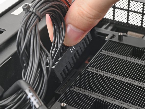

  59. Slide the bottom Expansion Card cable into its socket on the Mainboard. Slide the bottom Expansion Card cable into its socket on the Mainboard.
    • Slide the bottom Expansion Card cable into its socket on the Mainboard.
  60. Orient the CPU power supply cable so its clip is facing the heatsink. Slide the cable into its socket on the Mainboard until you feel it click into place.
    • Orient the CPU power supply cable so its clip is facing the heatsink.
    • Slide the cable into its socket on the Mainboard until you feel it click into place.
  61. Orient the main power supply cable so its clip is facing away from the heatsink. Slide the cable into its socket on the Mainboard until you feel it click into place.
    • Orient the main power supply cable so its clip is facing away from the heatsink.
  62. Slide the top Expansion Card cable into its socket on the Mainboard. Slide the top Expansion Card cable into its socket on the Mainboard.
    • Slide the top Expansion Card cable into its socket on the Mainboard.
  63. Orient the fan so its label is facing downward and the cable(s) is pointing towards the top of the computer. If your fan has an arrow indicating airflow direction, make sure it's pointed towards the heatsink.
    • Lay the fan on top of the heatsink, making sure the cables are routed so they poke out of the hole on the top of the computer.
  64. If the cables aren't routed properly, lift the fan up slightly and use your fingers to reposition the cables over the side of the heatsink. If you're installing an RGB fan, make sure the "male" end of the RGB cable is covered and set aside in the corner of the chassis. If you're installing an RGB fan, make sure the "male" end of the RGB cable is covered and set aside in the corner of the chassis.
    • If the cables aren't routed properly, lift the fan up slightly and use your fingers to reposition the cables over the side of the heatsink.
  65. Lay the fan duct on top of the fan with the lip facing upward. Align the screw holes on the fan duct with the ones on the fan.
  66. (if new) Remove the fan screws from their packaging and make sure there are four screws total. (if new) Remove the fan screws from their packaging and make sure there are four screws total.
    • (if new) Remove the fan screws from their packaging and make sure there are four screws total.
  67. Use your Framework Desktop Screwdriver to install the four 27.3 mm‑long Phillips screws securing the CPU fan and fan duct. Use your Framework Desktop Screwdriver to install the four 27.3 mm‑long Phillips screws securing the CPU fan and fan duct.
    • Use your Framework Desktop Screwdriver to install the four 27.3 mm‑long Phillips screws securing the CPU fan and fan duct.
  68. Orient the main fan cable so its two vertical lines are facing you. Slide the main fan cable over the four-pronged connector labeled "APU Fan," making sure the orange label slots between the vertical lines.
  69. If you aren't using an RGB fan, then skip this step. Orient the RGB cable so the arrow is facing you. Use your fingers to slide the RGB cable over the three pronged connector located to the right of the "APU Fan" connector.
    • Orient the RGB cable so the arrow is facing you.
  70. Slide the Left Panel onto the left edge of the chassis and press it flat to ensure its clips are slotted into place. There should be a small gap between the bottom of the Left Panel and the silver base. Push the Left Panel towards the base of the computer to close the gap and engage the clips.
  71. Orient the Top Panel so its arrow is pointing towards the rear of the computer. While holding the Top Panel at a slight downward angle, slide it across the top of the chassis (from rear to front) until you feel its clips catch. There should be a small gap between the Top Panel and the front of the Desktop.
  72. While securing the computer with one hand, use the other hand to slide the Top Panel towards the front of the computer to close the gap and engage the clips. While securing the computer with one hand, use the other hand to slide the Top Panel towards the front of the computer to close the gap and engage the clips.
  73. If you're installing the Handle on your Desktop, follow this step. Otherwise, skip it. Place the Handle over the Top Panel screw holes.
  74. Insert the top panel screw into its hole and twist clockwise until it feels snug. Insert the top panel screw into its hole and twist clockwise until it feels snug. Insert the top panel screw into its hole and twist clockwise until it feels snug.
  75. Repeat the same procedure for the other top panel screw. Repeat the same procedure for the other top panel screw. Repeat the same procedure for the other top panel screw.
  76. Use your finger to close the two D-rings on the top panel screws. Use your finger to close the two D-rings on the top panel screws. Use your finger to close the two D-rings on the top panel screws.
You finished fixing your Framework Desktop!
