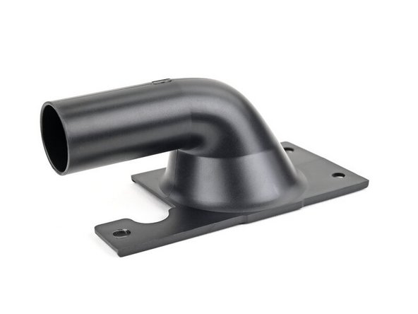

Follow this guide to remove and replace the power supply duct in your Framework Desktop.

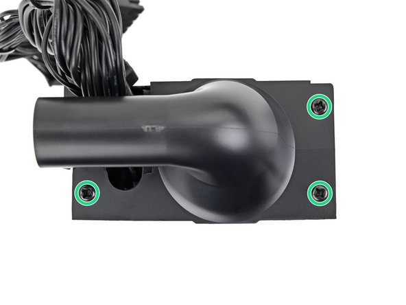

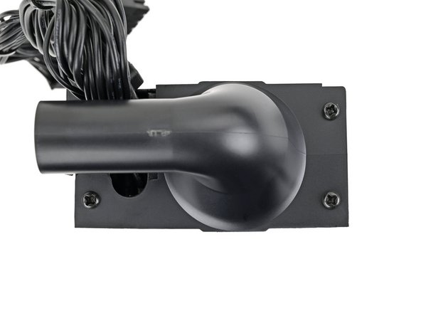

  36. Use your Framework Desktop Screwdriver to remove the three 5.8 mm‑long Phillips screws securing the Power Supply Duct. Use your Framework Desktop Screwdriver to remove the three 5.8 mm‑long Phillips screws securing the Power Supply Duct.
    • Use your Framework Desktop Screwdriver to remove the three 5.8 mm‑long Phillips screws securing the Power Supply Duct.

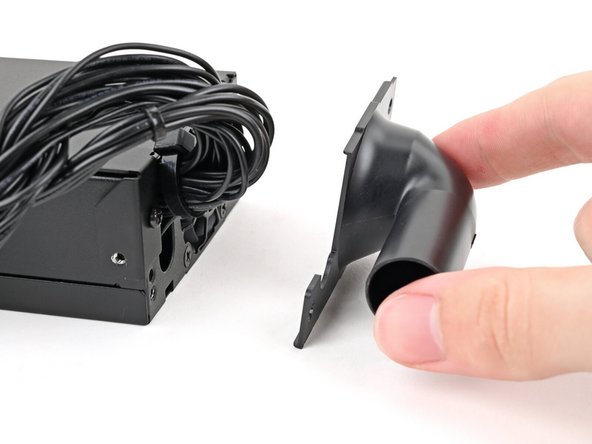

  37. Pull the Power Supply Duct off the power supply and remove it. Pull the Power Supply Duct off the power supply and remove it.
    • Pull the Power Supply Duct off the power supply and remove it.

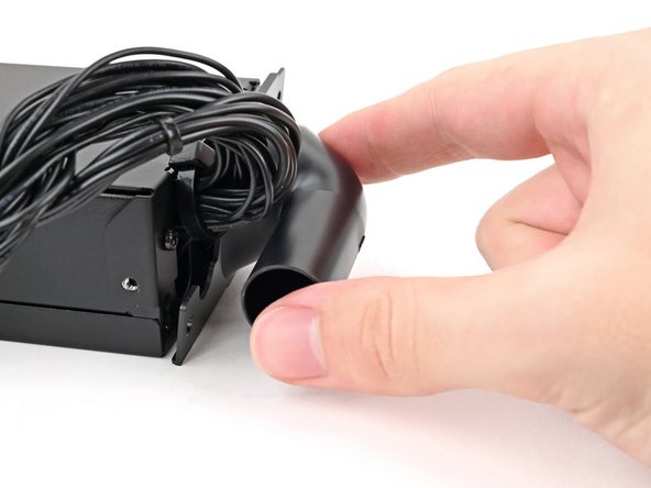

  39. Place the Power Supply Duct on the power supply. Place the Power Supply Duct on the power supply.
    • Place the Power Supply Duct on the power supply.
