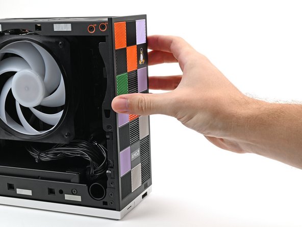

  9. Use your fingers to pull the Front Panel off the magnets securing it to the chassis. Use your fingers to pull the Front Panel off the magnets securing it to the chassis. Use your fingers to pull the Front Panel off the magnets securing it to the chassis.
    • Use your fingers to pull the Front Panel off the magnets securing it to the chassis.

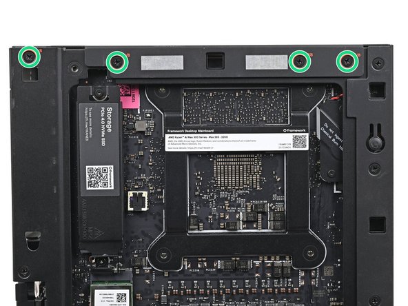

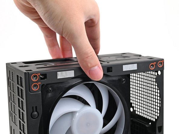

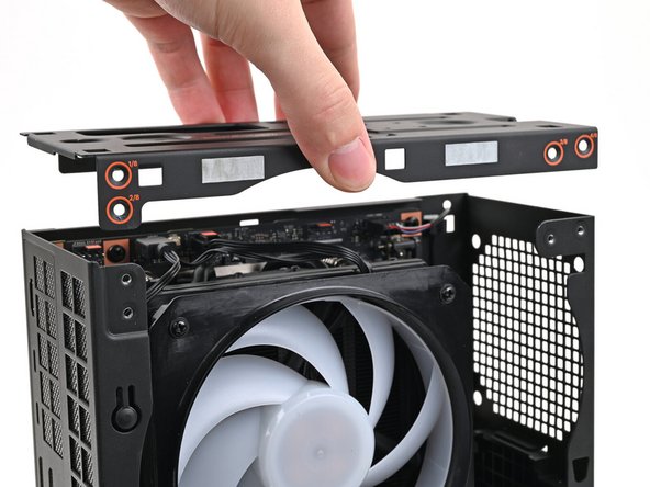

  10. While holding the Desktop steady, use your Framework Desktop Screwdriver to remove the eight 4.0 mm‑long Phillips screws securing the top plate. While holding the Desktop steady, use your Framework Desktop Screwdriver to remove the eight 4.0 mm‑long Phillips screws securing the top plate.
    • While holding the Desktop steady, use your Framework Desktop Screwdriver to remove the eight 4.0 mm‑long Phillips screws securing the top plate.
  11. Lift the top plate off the Desktop and remove it. Lift the top plate off the Desktop and remove it.
    • Lift the top plate off the Desktop and remove it.

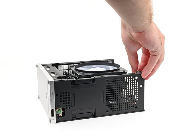

  12. Rotate the Desktop onto its right side so the Mainboard is facing upward. Rotate the Desktop onto its right side so the Mainboard is facing upward.
    • Rotate the Desktop onto its right side so the Mainboard is facing upward.

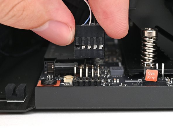

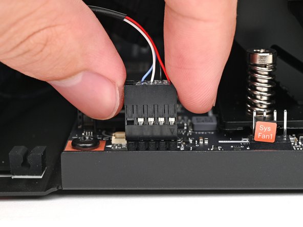

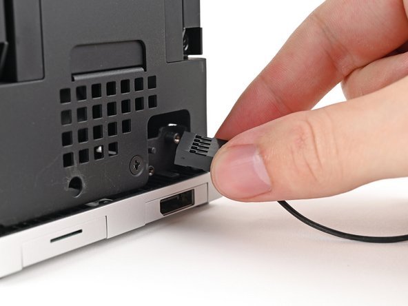

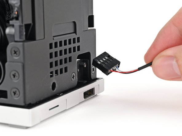

  13. Use your fingers to lift the power button cable connector off its nine‑pronged socket on the Mainboard. Use your fingers to lift the power button cable connector off its nine‑pronged socket on the Mainboard.
    • Use your fingers to lift the power button cable connector off its nine‑pronged socket on the Mainboard.

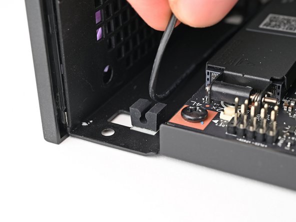

  14. Pull the power button cable out of its rubber clips in the chassis. Pull the power button cable out of its rubber clips in the chassis.
    • Pull the power button cable out of its rubber clips in the chassis.
  15. Rotate the Desktop so it sits upright. Rotate the Desktop so it sits upright.
    • Rotate the Desktop so it sits upright.

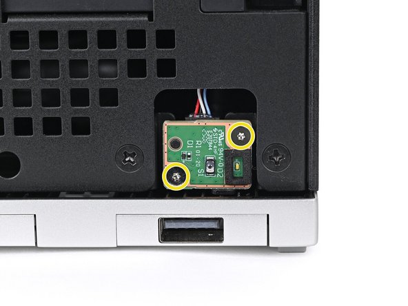

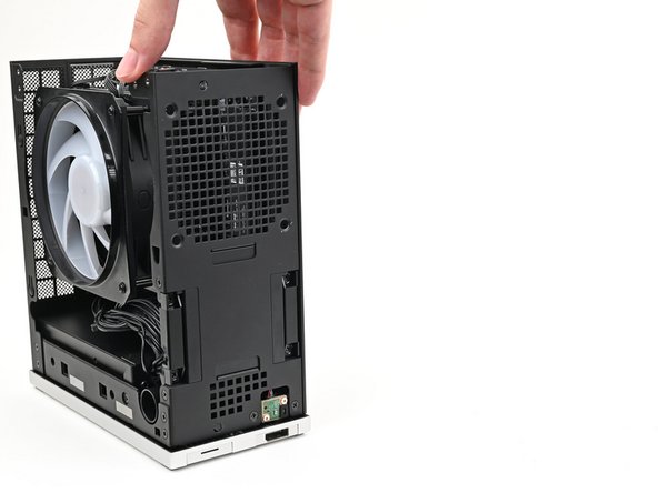

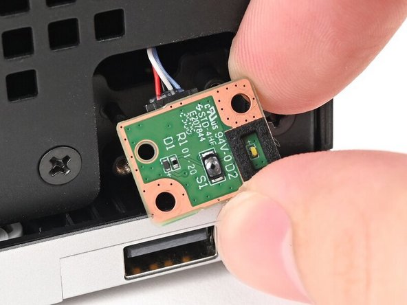

  16. Use your Framework Desktop Screwdriver to remove the two 4.5 mm‑long screws securing the Power Button Board. Use your Framework Desktop Screwdriver to remove the two 4.5 mm‑long screws securing the Power Button Board.
    • Use your Framework Desktop Screwdriver to remove the two 4.5 mm‑long screws securing the Power Button Board.

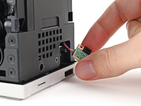

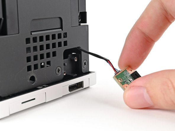

  17. Use your finger to pull the Power Button Board off its alignment peg. Use your finger to pull the Power Button Board off its alignment peg.
    • Use your finger to pull the Power Button Board off its alignment peg.

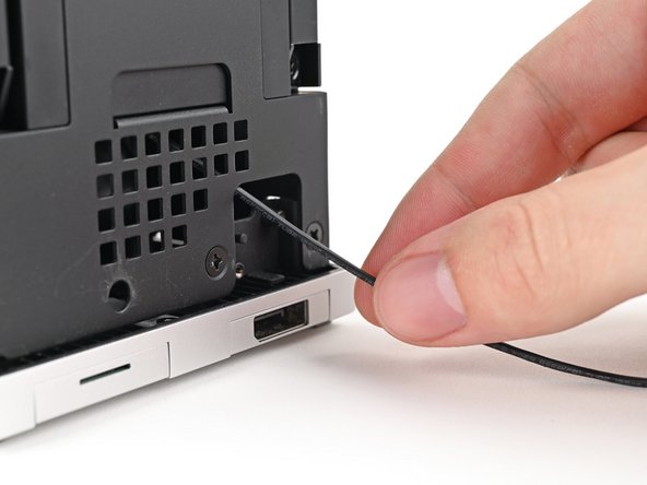

  18. Pull the Power Button Board away from the Desktop, threading its cable through the chassis. Pull the Power Button Board away from the Desktop, threading its cable through the chassis. Pull the Power Button Board away from the Desktop, threading its cable through the chassis.
    • Pull the Power Button Board away from the Desktop, threading its cable through the chassis.

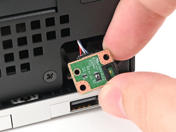

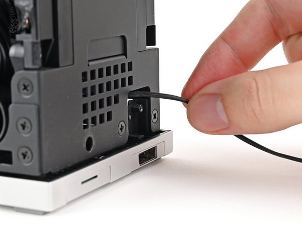

  20. Insert the Power Button Board cable into the slot in the Desktop. Grip the cable from the top of the Desktop and thread it through the chassis. Grip the cable from the top of the Desktop and thread it through the chassis.
    • Insert the Power Button Board cable into the slot in the Desktop.
    • Grip the cable from the top of the Desktop and thread it through the chassis.

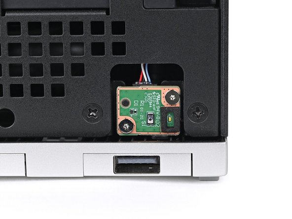

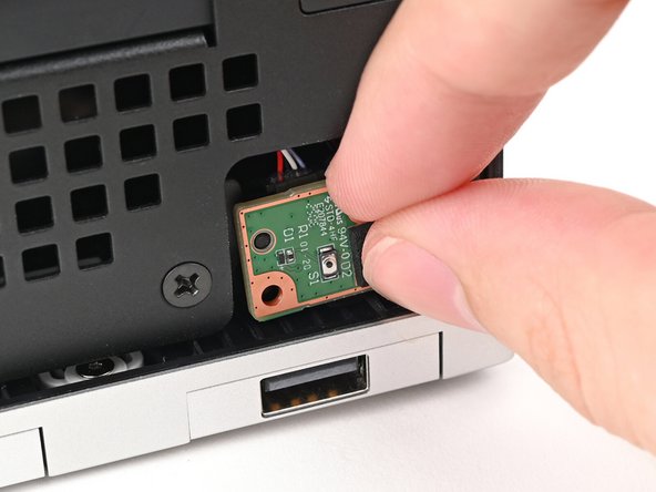

  21. Place the board into its slot in the Desktop so the alignment peg is threaded through its hole in the board. Place the board into its slot in the Desktop so the alignment peg is threaded through its hole in the board.
    • Place the board into its slot in the Desktop so the alignment peg is threaded through its hole in the board.
  22. Use your Framework Desktop Screwdriver to install the two 4.5 mm‑long screws securing the Power Button Board. Use your Framework Desktop Screwdriver to install the two 4.5 mm‑long screws securing the Power Button Board.
    • Use your Framework Desktop Screwdriver to install the two 4.5 mm‑long screws securing the Power Button Board.

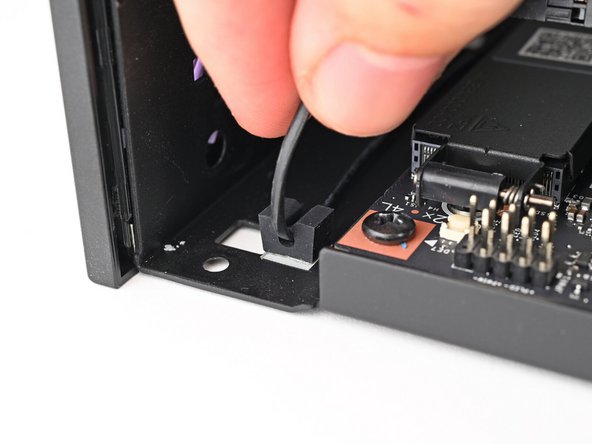

  24. Press the power button cable into its rubber clips in the chassis. Press the power button cable into its rubber clips in the chassis.
    • Press the power button cable into its rubber clips in the chassis.
  25. Slide the power button cable over the nine-pronged connector on the Mainboard. Slide the power button cable over the nine-pronged connector on the Mainboard.
    • Slide the power button cable over the nine-pronged connector on the Mainboard.

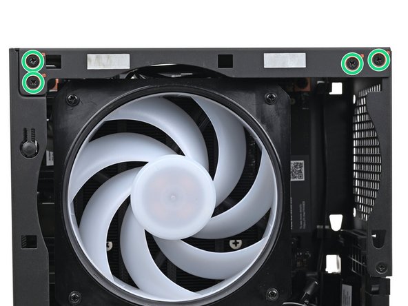

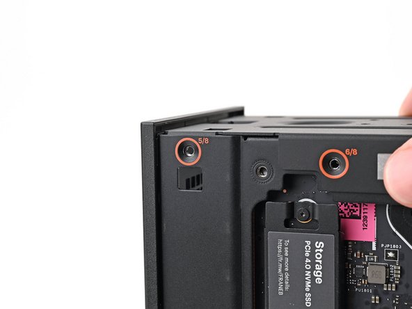

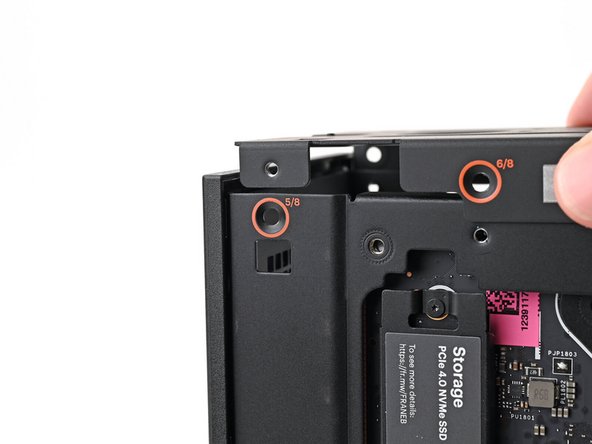

  27. Place the top plate on top of the Desktop, making sure it slots into the chassis so the orange circles are visible. Place the top plate on top of the Desktop, making sure it slots into the chassis so the orange circles are visible.
    • Place the top plate on top of the Desktop, making sure it slots into the chassis so the orange circles are visible.
  28. Make sure the matching screw hole on the top plate labeled "5/8" is slotted on the inside of the Chassis so that the orange circle is visible. Make sure the matching screw hole on the top plate labeled "5/8" is slotted on the inside of the Chassis so that the orange circle is visible.
    • Make sure the matching screw hole on the top plate labeled "5/8" is slotted on the inside of the Chassis so that the orange circle is visible.
  29. While holding the Desktop steady, use your Framework Desktop Screwdriver to install the eight 4.0 mm‑long Phillips screws securing the top plate. While holding the Desktop steady, use your Framework Desktop Screwdriver to install the eight 4.0 mm‑long Phillips screws securing the top plate.
    • While holding the Desktop steady, use your Framework Desktop Screwdriver to install the eight 4.0 mm‑long Phillips screws securing the top plate.

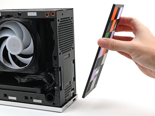

  30. Lay the bottom of the Front Panel on the small, protruding lip in the silver base to align its tabs. Press the Front Panel flat to the chassis and let it align to the magnets. Press the Front Panel flat to the chassis and let it align to the magnets.
    • Lay the bottom of the Front Panel on the small, protruding lip in the silver base to align its tabs.
    • Press the Front Panel flat to the chassis and let it align to the magnets.

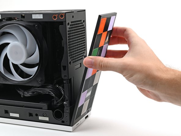

  31. Slide the Right Panel onto the right edge of the chassis, from top to bottom, and press it flat to ensure its clips are slotted into place. There should be a small gap between the bottom of the Right Panel and the silver base. Push the Right Panel towards the base of the computer to engage the clips.
    • Slide the Right Panel onto the right edge of the chassis, from top to bottom, and press it flat to ensure its clips are slotted into place.
  32. Slide the Left Panel onto the left edge of the chassis and press it flat to ensure its clips are slotted into place. There should be a small gap between the bottom of the Left Panel and the silver base. Push the Left Panel towards the base of the computer to close the gap and engage the clips.
