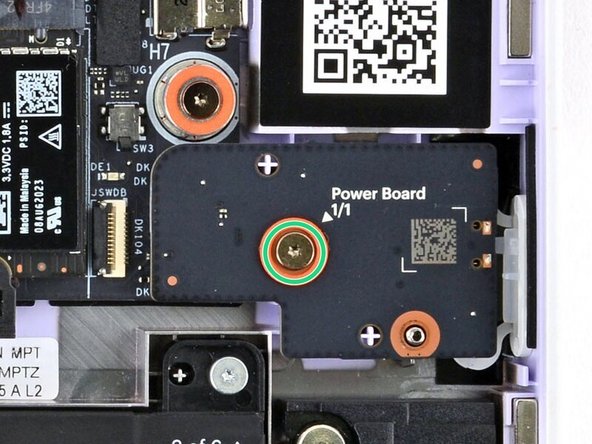

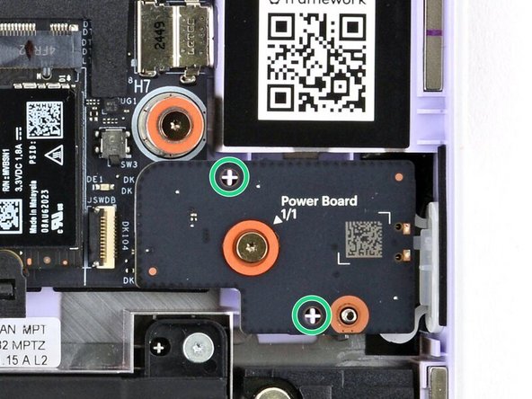

  7. Use your Framework Screwdriver to loosen the captive T5 Torx screw securing the Power Button Board (labeled "Power Board").
    • Use your Framework Screwdriver to loosen the captive T5 Torx screw securing the Power Button Board (labeled "Power Board").

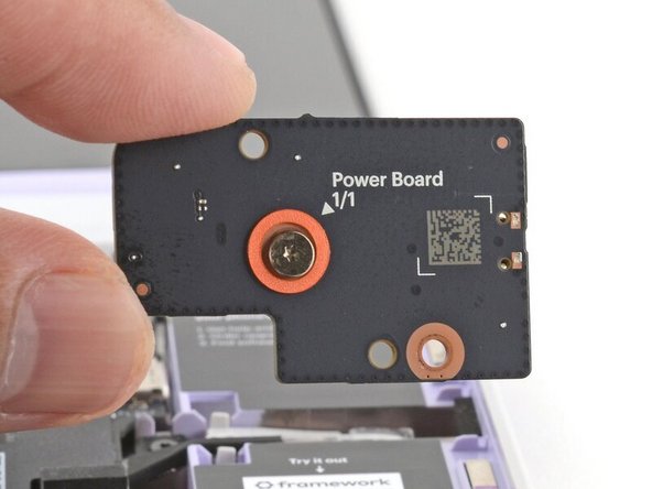

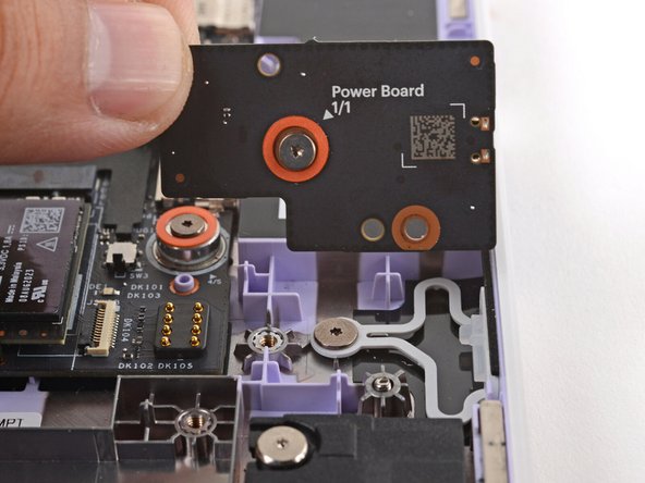

  8. Use your fingers to lift and remove the Power Button Board. Use your fingers to lift and remove the Power Button Board.
    • Use your fingers to lift and remove the Power Button Board.

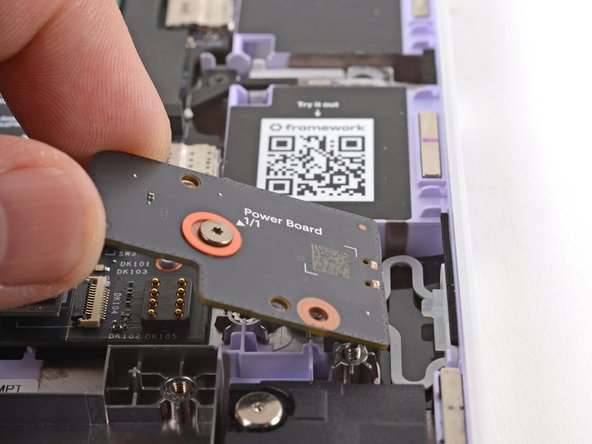

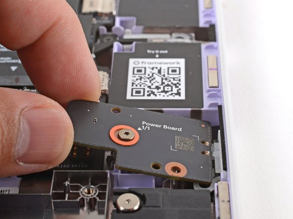

  10. Use your fingers to lay the Power Button Board in place. Use the two plastic pins on the laptop to align the Power Button Board. Use the two plastic pins on the laptop to align the Power Button Board.
    • Use your fingers to lay the Power Button Board in place.
    • Use the two plastic pins on the laptop to align the Power Button Board.

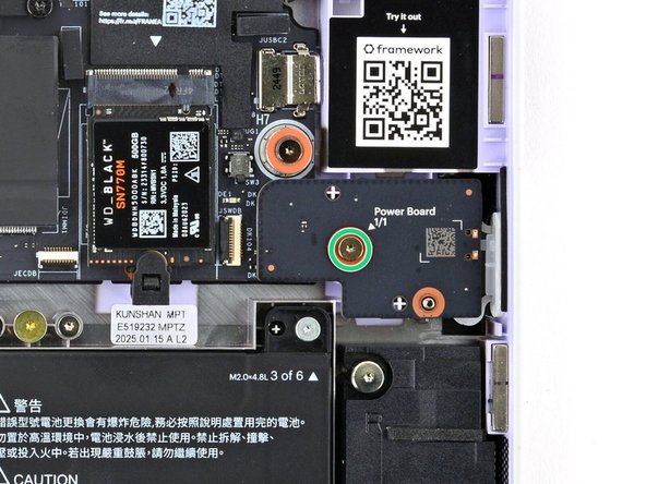

  11. Use your Framework Screwdriver to tighten the captive T5 Torx screw to secure the Power Button Board.
    • Use your Framework Screwdriver to tighten the captive T5 Torx screw to secure the Power Button Board.
    • Tighten the screw until it's snug. Don't over-tighten it, or you may strip the screw.
