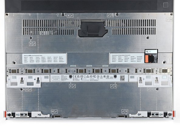

  13. Place the Mid Plate on the laptop, making sure it sits evenly on its alignment pegs. Place the Mid Plate on the laptop, making sure it sits evenly on its alignment pegs. Place the Mid Plate on the laptop, making sure it sits evenly on its alignment pegs.

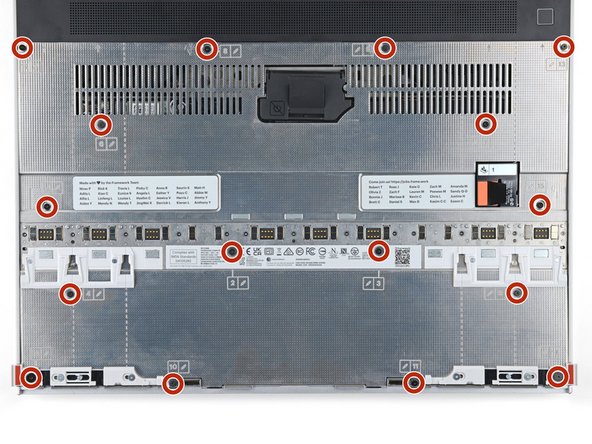

  14. Use your Framework Screwdriver to tighten the 16 T5 Torx captive screws in order (starting with 2) to secure the Mid Plate evenly. Use your Framework Screwdriver to tighten the 16 T5 Torx captive screws in order (starting with 2) to secure the Mid Plate evenly.
    • Use your Framework Screwdriver to tighten the 16 T5 Torx captive screws in order (starting with 2) to secure the Mid Plate evenly.
