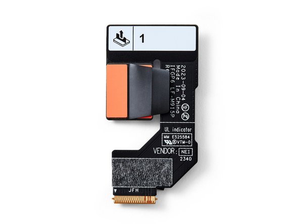

Use this guide to remove and replace the Mid Plate Cable in the Framework Laptop 16.

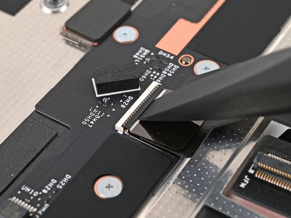

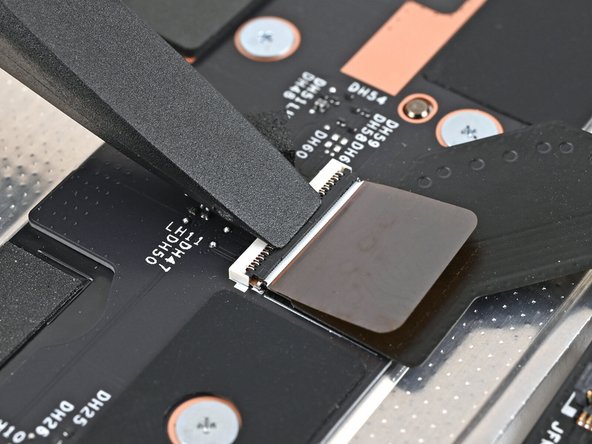

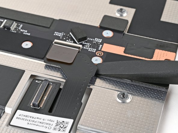

  11. Slide the flat end of the Framework Screwdriver under the Mid Plate Cable, near the ZIF connector, to separate the adhesive. Slide the flat end of the Framework Screwdriver under the Mid Plate Cable, near the ZIF connector, to separate the adhesive.
    • Slide the flat end of the Framework Screwdriver under the Mid Plate Cable, near the ZIF connector, to separate the adhesive.

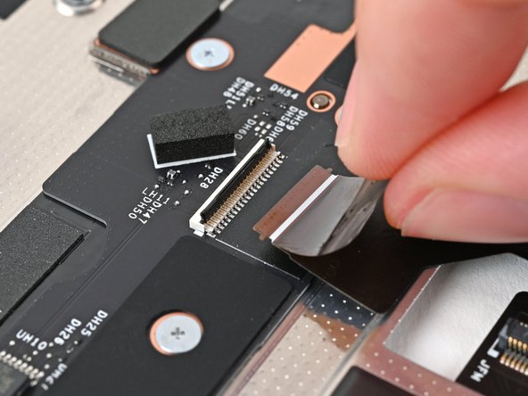

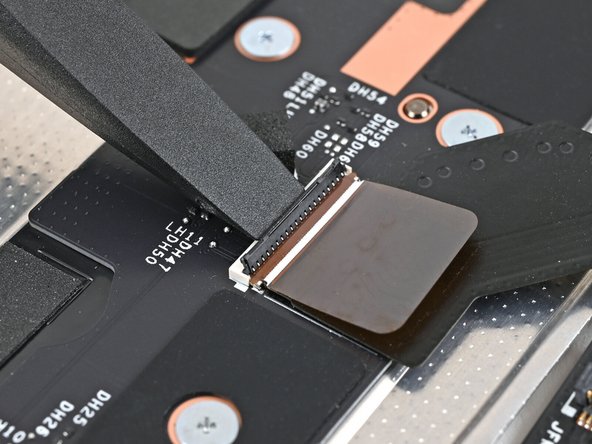

  12. Use the flat end of the Framework Screwdriver, or a clean fingernail, to lift up the locking tab on the Mid Plate Cable ZIF connector. Use the flat end of the Framework Screwdriver, or a clean fingernail, to lift up the locking tab on the Mid Plate Cable ZIF connector.
    • Use the flat end of the Framework Screwdriver, or a clean fingernail, to lift up the locking tab on the Mid Plate Cable ZIF connector.

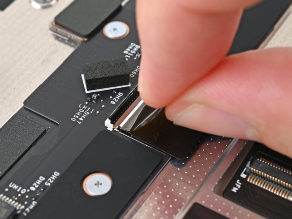

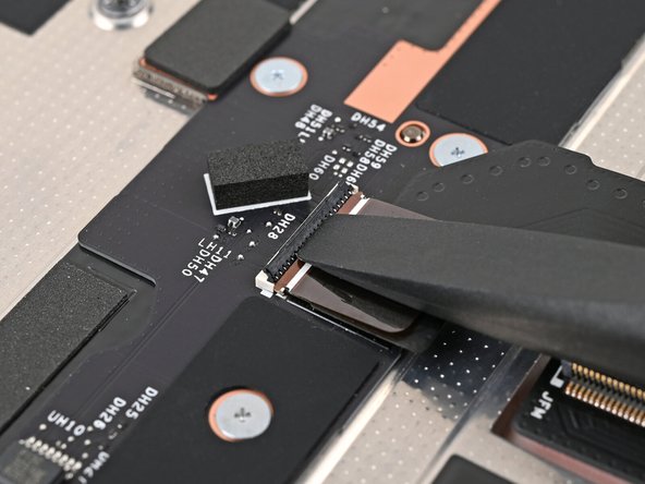

  13. Use your fingers to grip the black pull tab and slide the Mid Plate Cable straight out of its socket. Use your fingers to grip the black pull tab and slide the Mid Plate Cable straight out of its socket.
    • Use your fingers to grip the black pull tab and slide the Mid Plate Cable straight out of its socket.

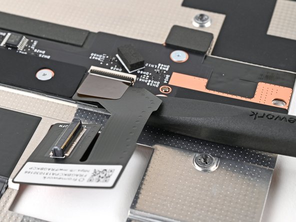

  15. Use your fingers to grip the black pull tab and slide the Mid Plate Cable straight into its socket. Use your fingers to grip the black pull tab and slide the Mid Plate Cable straight into its socket.
    • Use your fingers to grip the black pull tab and slide the Mid Plate Cable straight into its socket.

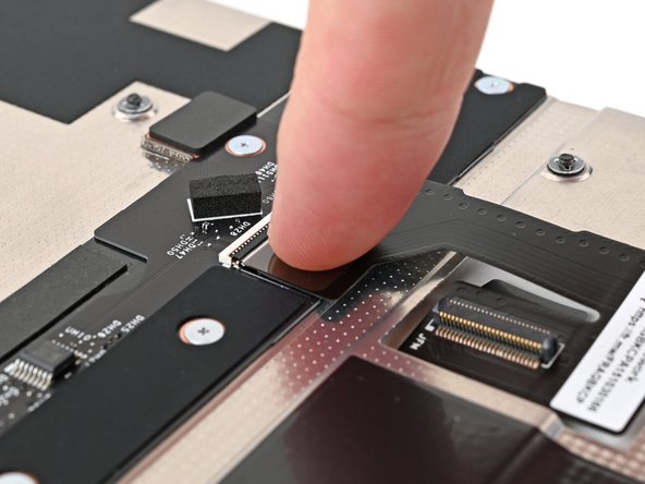

  16. Use the flat end of your Framework Screwdriver, or a clean fingernail, to press down the locking tab on the Mid Plate Cable ZIF connector. Press the cable to the Mid Plate to re-adhere it. Press the cable to the Mid Plate to re-adhere it.
    • Use the flat end of your Framework Screwdriver, or a clean fingernail, to press down the locking tab on the Mid Plate Cable ZIF connector.
    • Press the cable to the Mid Plate to re-adhere it.
