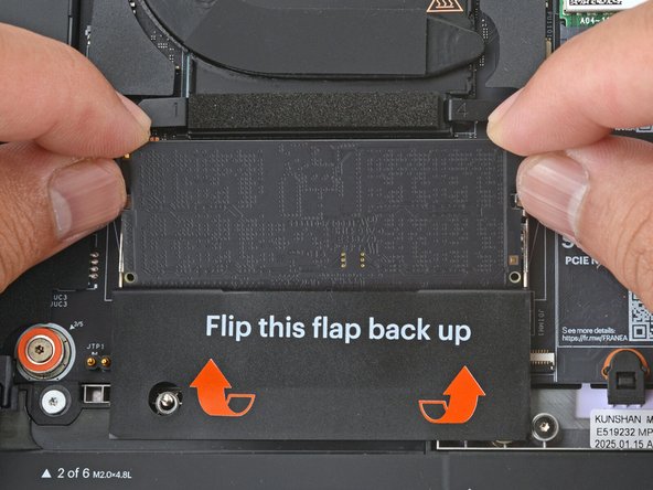

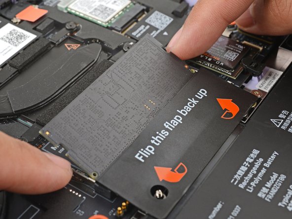

  7. Use your fingers to flip open the memory flap. Use your fingers to flip open the memory flap.
    • Use your fingers to flip open the memory flap.

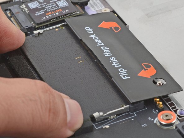

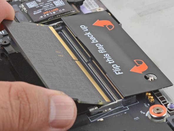

  8. Use your fingers to spread the clips on both sides of the memory module apart to unclip the memory. The memory module will pop up to an angle when it's unclipped.
    • Use your fingers to spread the clips on both sides of the memory module apart to unclip the memory.
    • The memory module will pop up to an angle when it's unclipped.

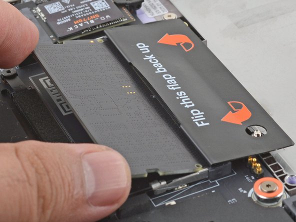

  9. Use your fingers to grab the memory module by its edges. Slide the memory module out of its socket and remove it.
    • Use your fingers to grab the memory module by its edges.
    • Slide the memory module out of its socket and remove it.

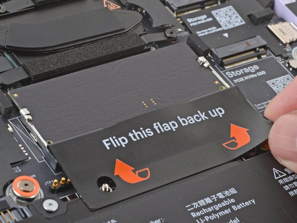

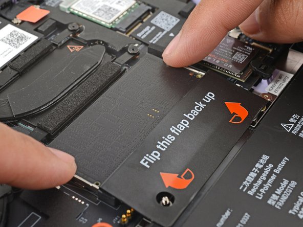

  11. Hold the memory module by its edges. Don't touch the gold contacts with your fingers. If you do, wipe the contacts with a clean, lint-free cloth to remove any finger oils. Orient the module with the label facing down and align the gold contacts with the socket. Insert the contact edge into the socket at a shallow angle. The gold contacts should mostly be covered by the socket.
    • Orient the module with the label facing down and align the gold contacts with the socket.
    • Intel Core Series 3 Mainboards have the RAM flipped compared to these images. The shorter side of connectors will be on the left.
    • Press the edges of the memory module down until the side clips lock it in place.

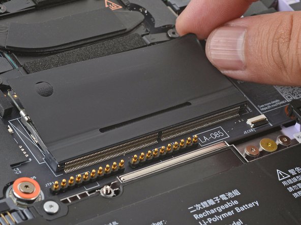

  12. Flip the memory flap back over the memory module. Flip the memory flap back over the memory module.
    • Flip the memory flap back over the memory module.
