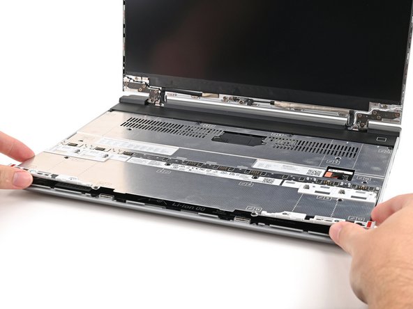

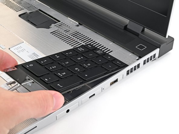

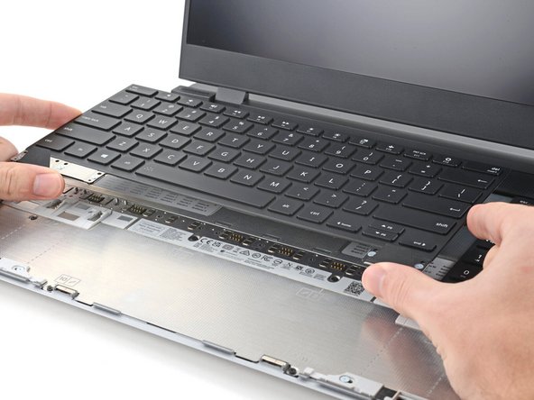

    • Remove the keyboard.
    • Remove the Input Module.

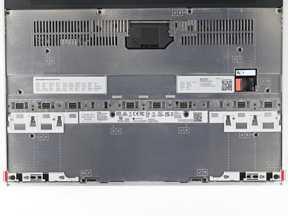

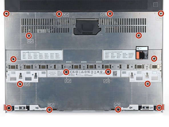

    Also here (like in the comment of step 9): ONLY LIFT UP, don't try to remove it.
    RoxJan - Open Reply

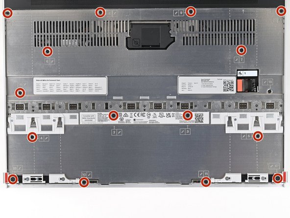

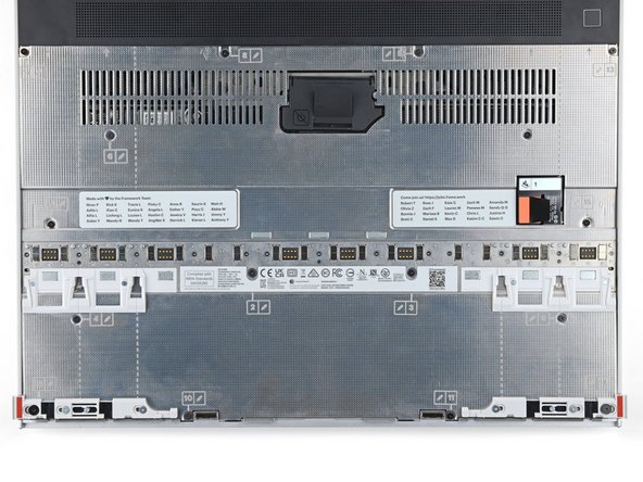

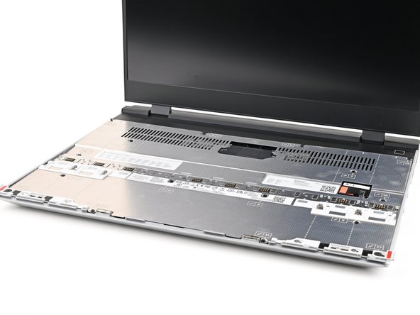

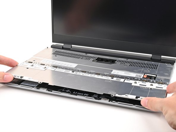

    Maybe you should also mention that we are NOT supposed to REMOVE the screws, just make them loose.
    For somebody that did some (albeit crappy) DIY laptop disassembly in the past, that fact is VERY easy to glance over. Usually, when told to loosen the screws, it is somewhat implicitly expected to remove them as well.
    I was wondering why the first screw I tried to remove just wouldn't come off even when loose (some of them do, some of them don't), and I hope that I didn't damage something by attempting to remove the loose screw by force (after rechecking multiple times that it is indeed loose).
    I even had a place prepared to put the screws into... 👀
    Templayer - Open Reply
    There's 16 captive screws to remove to loosen the mid plate. However screw 15 on the right is not highlighted on the image.
    Acre - Open Reply

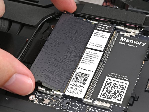

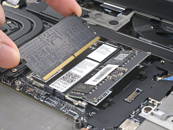

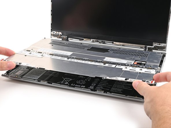

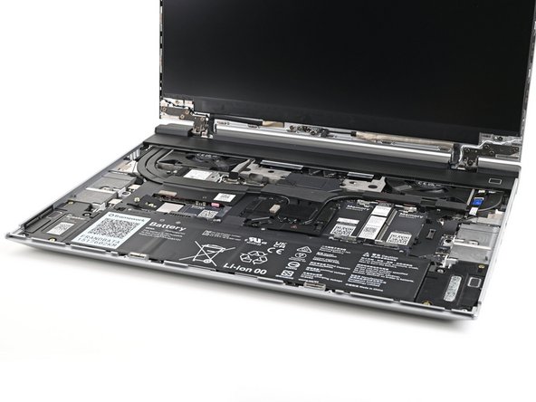

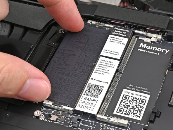

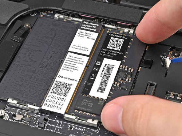

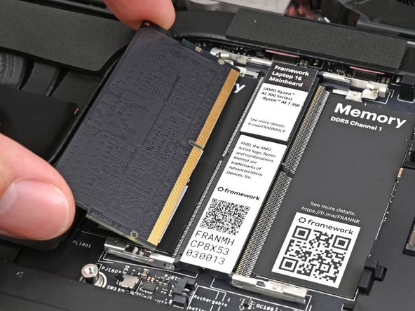

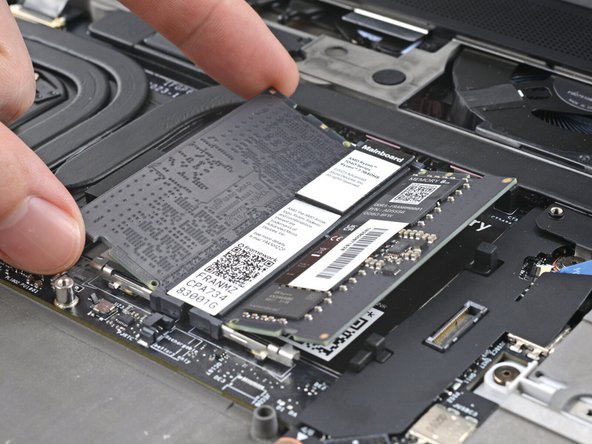

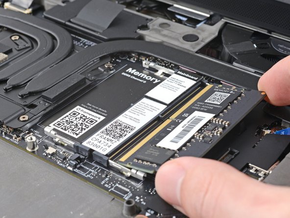

  11. Push the two metal arms on each side of the RAM stick outward until they disengage and the stick pops up at a shallow angle. Repeat for the other RAM stick. Repeat for the other RAM stick.
    • Push the two metal arms on each side of the RAM stick outward until they disengage and the stick pops up at a shallow angle.
    • Repeat for the other RAM stick.
  12. Slide the RAM stick out of its socket and remove it. Repeat for the other RAM stick. Repeat for the other RAM stick.
    • Slide the RAM stick out of its socket and remove it.
  13. Congratulations on completing disassembly! The remaining steps will show how to reassemble your Framework Laptop.

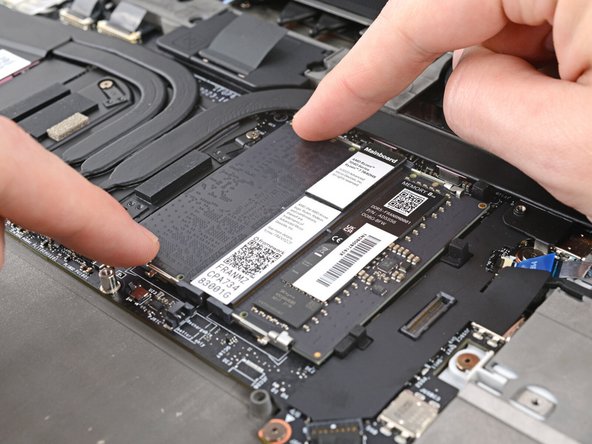

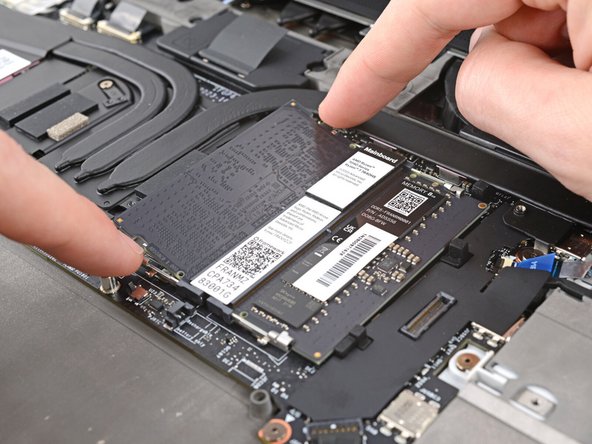

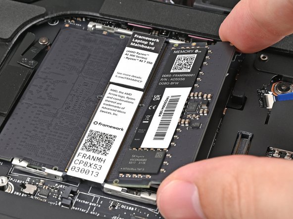

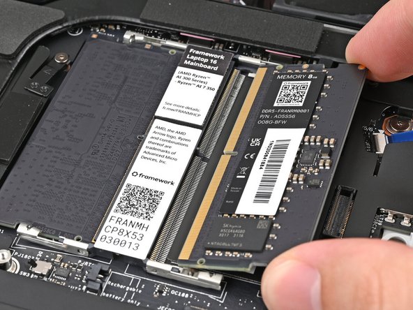

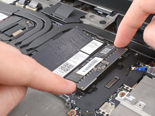

  14. Hold the memory module by its edges. Don't touch the gold contacts with your fingers. If you do, wipe the contacts with a clean, lint-free cloth to remove any finger oils. Orient the module with its label facing down and align the gold contacts with the left socket labeled DDR5 Channel 0. Insert the contact edge into the socket at a shallow angle. The gold contacts should mostly be covered by the socket.
    • Orient the module with its label facing down and align the gold contacts with the left socket labeled DDR5 Channel 0.
    • Press the edges of the memory module down until the side clips lock it in place.
  15. If you're using two memory modules, orient the other module so its label is facing upward and repeat the previous step for the other socket labeled DDR5 Channel 1. If you're using two memory modules, orient the other module so its label is facing upward and repeat the previous step for the other socket labeled DDR5 Channel 1. If you're using two memory modules, orient the other module so its label is facing upward and repeat the previous step for the other socket labeled DDR5 Channel 1.
    • If you're using two memory modules, orient the other module so its label is facing upward and repeat the previous step for the other socket labeled DDR5 Channel 1.

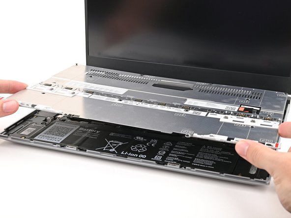

  16. Place the Mid Plate on the laptop, making sure it sits evenly on its alignment pegs. Place the Mid Plate on the laptop, making sure it sits evenly on its alignment pegs. Place the Mid Plate on the laptop, making sure it sits evenly on its alignment pegs.
  17. Use your Framework Screwdriver to tighten the 16 captive T5 Torx screws in order (starting with 2) to secure the Mid Plate evenly. Use your Framework Screwdriver to tighten the 16 captive T5 Torx screws in order (starting with 2) to secure the Mid Plate evenly.

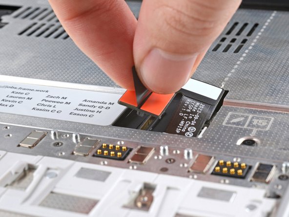

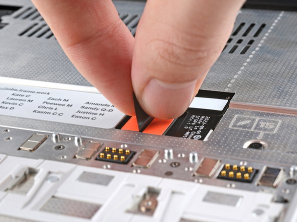

  18. Align the Mid Plate cable press connector over its socket and press down to connect it. Align the Mid Plate cable press connector over its socket and press down to connect it.

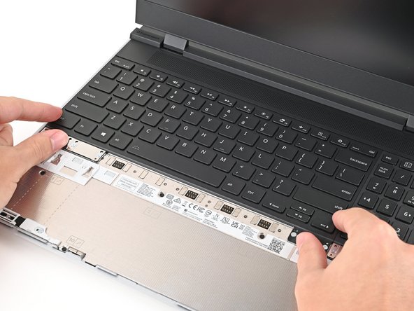

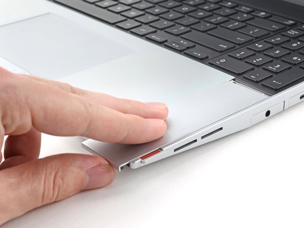

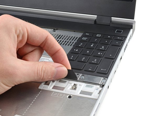

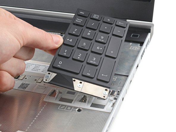

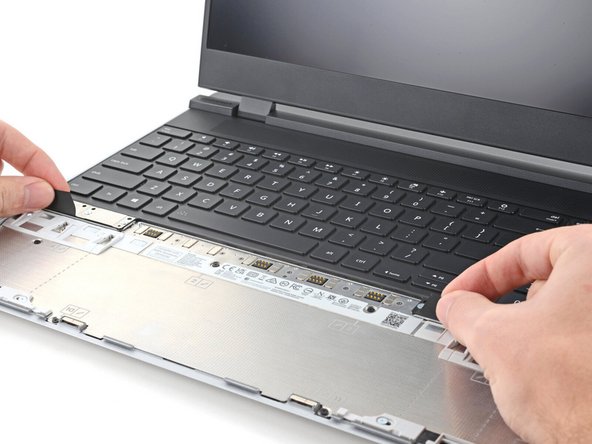

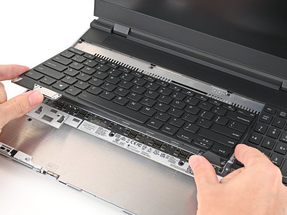

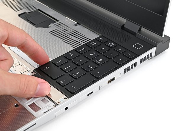

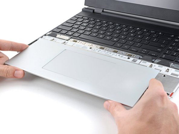

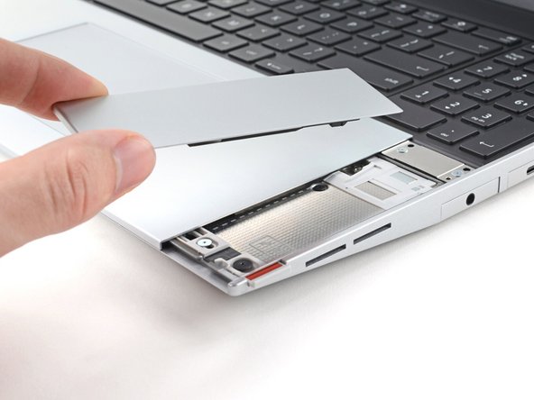

  19. Your Input Module(s) might be different, but the procedure to remove them is the same. Align the top edge of the Input Module with the top edge of the laptop. Lay the Input Module on the laptop and let the magnets pull the keyboard into place

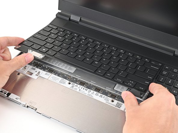

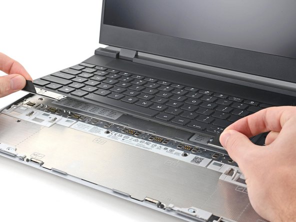

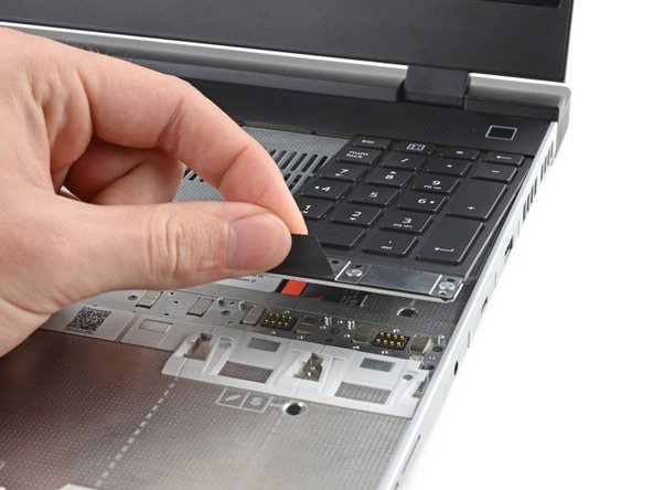

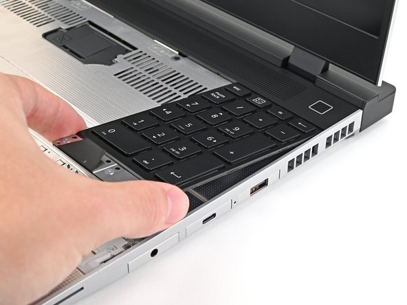

  20. Align the top edge of the keyboard with the top edge of the laptop. Lay the keyboard on the laptop and let the magnets pull the keyboard into place Make sure the keyboard is seated properly on its alignment pegs and sits flush with the edges of the laptop.

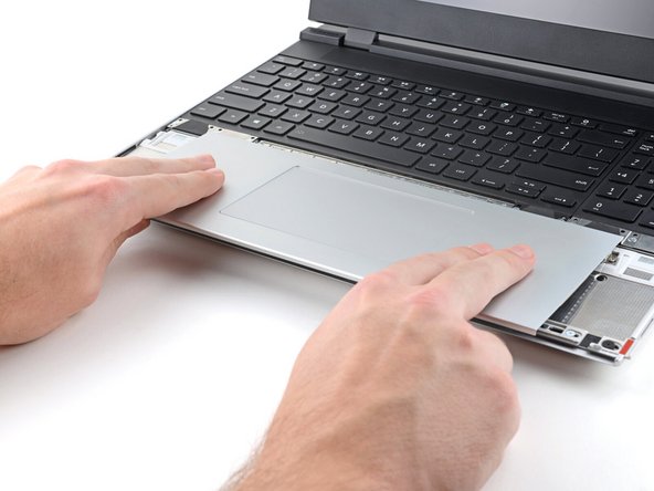

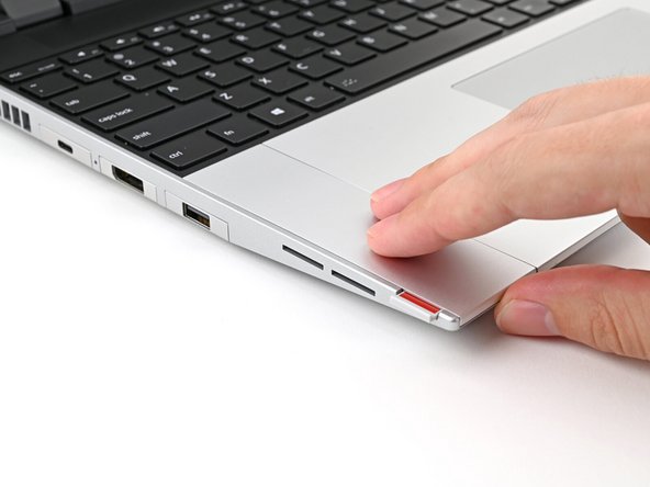

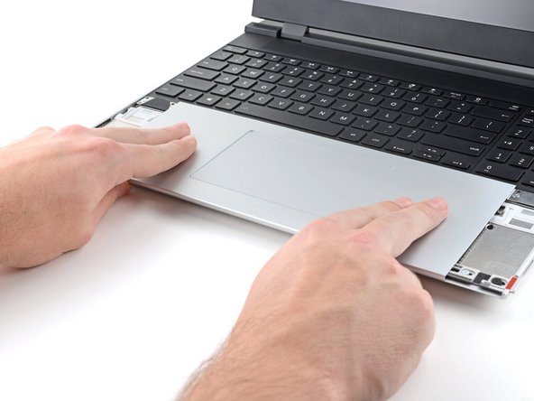

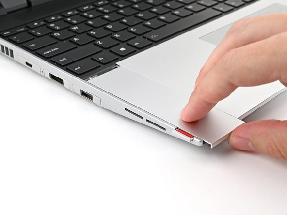

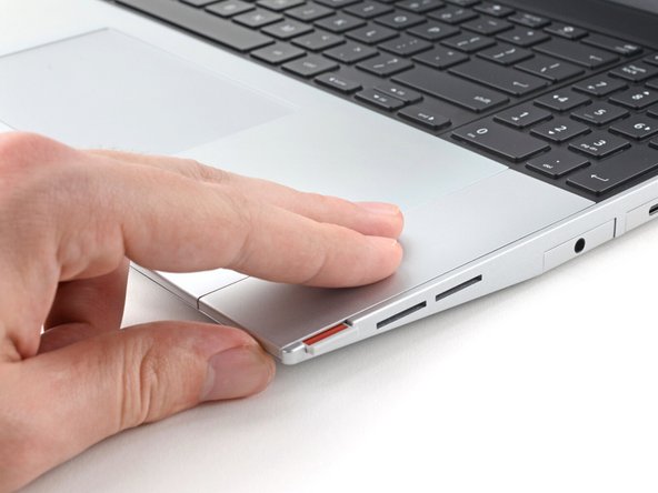

  21. Place the Touchpad Module flat on its cutout so its clips are properly aligned. Press the Touchpad Module down and slide it into place so it lines up evenly with the bottom edge of the laptop.

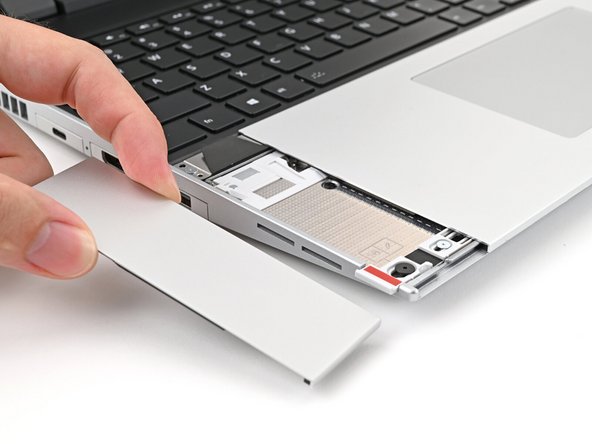

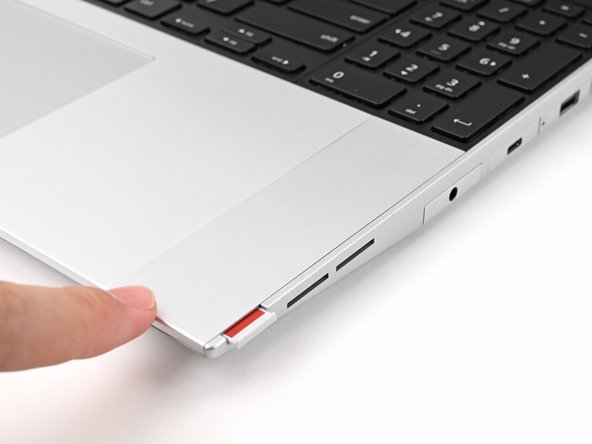

  22. Place the Touchpad Spacer over its spot on the laptop with the bottom edge overhanging slightly. Slide the Touchpad Spacer towards the top of the laptop to secure it. Repeat the same procedure for the other Touchpad Spacer.

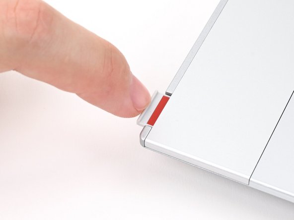

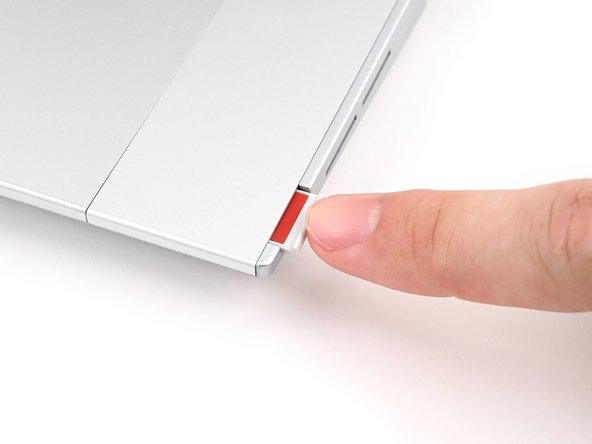

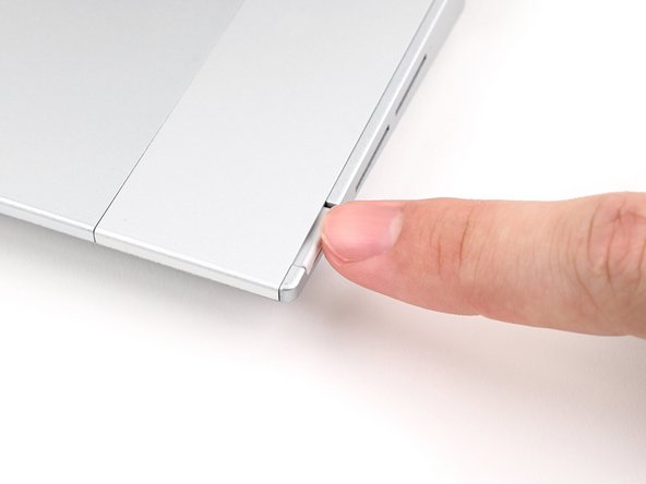

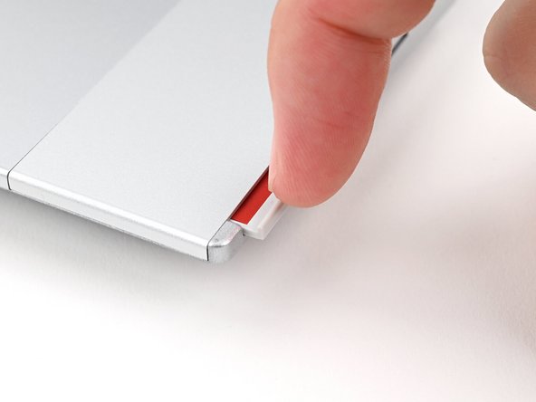

  23. Push the Input Module latches back into place to lock them. Push the Input Module latches back into place to lock them. Push the Input Module latches back into place to lock them.
