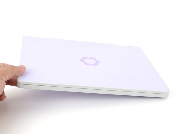

  2. Before you begin repairs, unplug your laptop and shut it down from the operating system. This ensures that the laptop isn't in standby/suspend mode. The indicator LEDs along the edges should be unlit. The laptop should be silent. If you accidentally turn on the laptop during repair, hold the power button down for 10 seconds to shut it down.

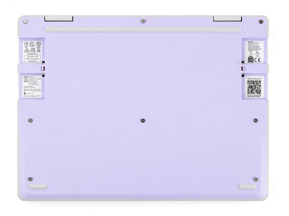

  3. Set your Framework Laptop face-down on a clean work surface.

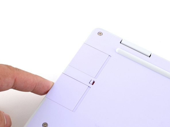

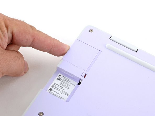

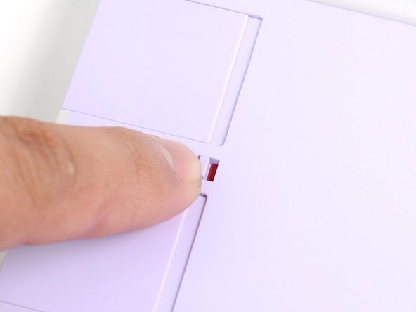

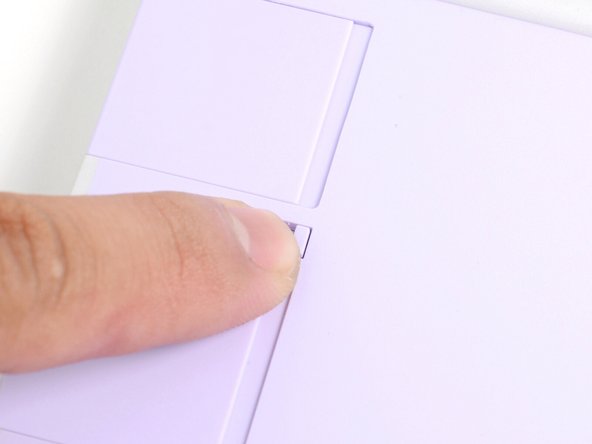

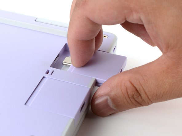

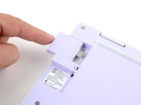

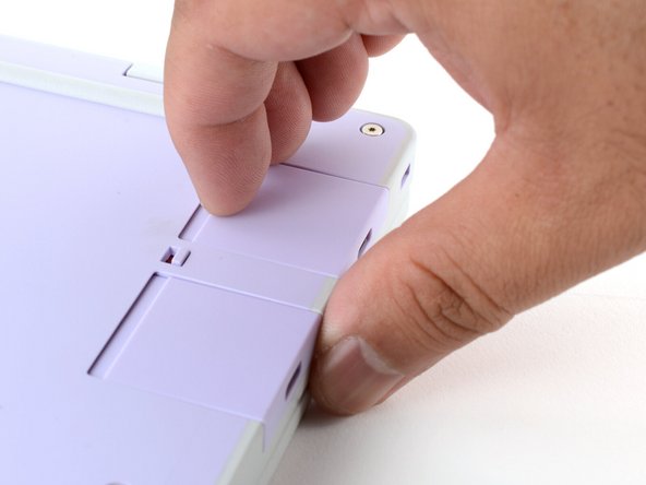

  4. Use your fingers to flip the two Expansion Card latches (one for each side) into the unlocked position. The latches display a red bar when they're unlocked.
    • Use your fingers to flip the two Expansion Card latches (one for each side) into the unlocked position.
    • The latches display a red bar when they're unlocked.
  5. Grip the lip of an Expansion Card with your fingers. Pull the Expansion Card out of its slot and remove it. If you have trouble pulling the Expansion Card out, you can also use the flat end of your Framework Screwdriver to push against the lip.
    • Grip the lip of an Expansion Card with your fingers.
    • If you have trouble pulling the Expansion Card out, you can also use the flat end of your Framework Screwdriver to push against the lip.

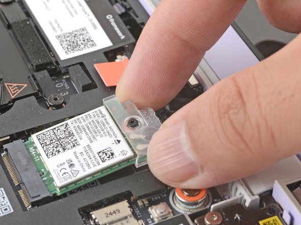

    • Repeat this procedure to remove all remaining Expansion Cards.

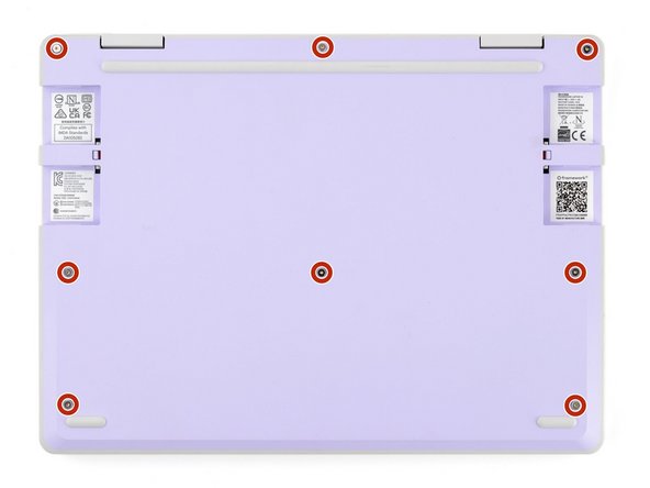

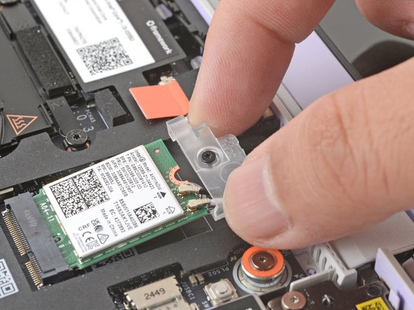

  6. Use your Framework Screwdriver to fully loosen the eight captive T5 Torx screws on the bottom of your laptop. Most screws in your Framework Laptop (including these) are captive—they're designed to stay in place after you loosen them.
  7. Flip your laptop face-up on your work surface.

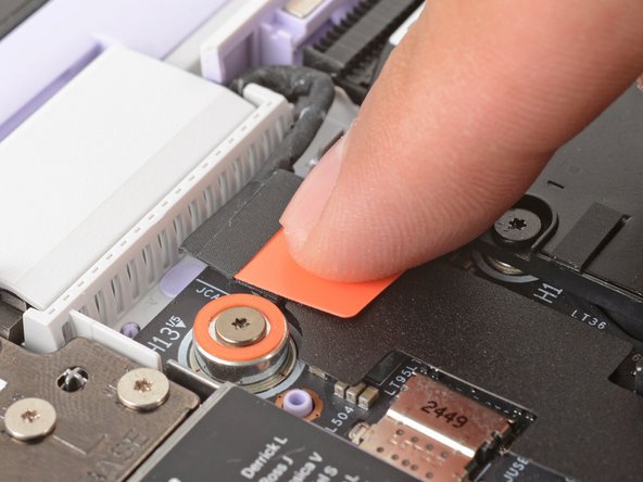

    • Flip your laptop face-up on your work surface.

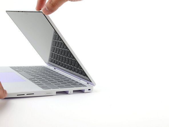

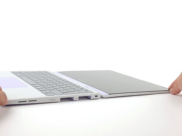

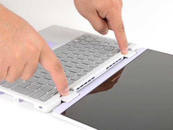

  8. Open the laptop lid so that both the screen and the base lie flat on your work surface. Open the laptop lid so that both the screen and the base lie flat on your work surface.

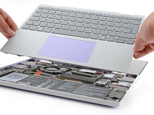

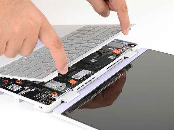

  9. Use your fingers to grip the Input Cover in the hinge cutouts. Lift upwards to swing the Input Cover up from the base of the laptop. You may feel resistance from the magnets. If the cover feels like it's snagged, check that you've fully loosened the screws on the bottom of your laptop.
    • You may feel resistance from the magnets. If the cover feels like it's snagged, check that you've fully loosened the screws on the bottom of your laptop.
    • Remove the Input Cover.

  12. Lift and remove the battery from the laptop. Lift and remove the battery from the laptop.
    • Lift and remove the battery from the laptop.
  13. Use your fingers to flip open the memory flap. Use your fingers to flip open the memory flap.
    • Use your fingers to flip open the memory flap.

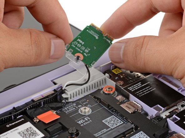

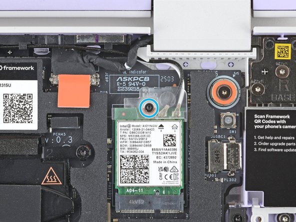

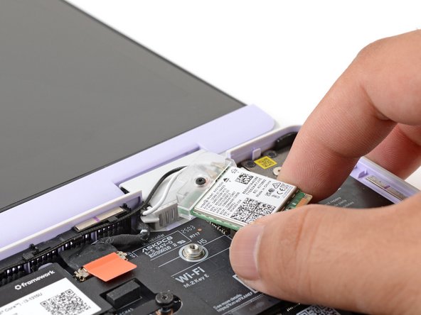

  22. Use your Framework Screwdriver to loosen the captive T5 Torx screw securing the Wi-Fi card bracket.
    • Use your Framework Screwdriver to loosen the captive T5 Torx screw securing the Wi-Fi card bracket.
    • The Wi-Fi card will pop up slightly when you unfasten the bracket.

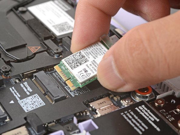

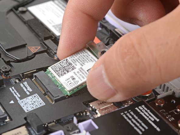

  23. Be careful not to strain the two delicate antenna cables attached to the Wi-Fi card. Grab the Wi-Fi card by its edges and slide it out of its socket.
    • Be careful not to strain the two delicate antenna cables attached to the Wi-Fi card.
    • Grab the Wi-Fi card by its edges and slide it out of its socket.
  24. Carefully reposition the Wi-Fi card away from the Mainboard. If the clear bracket or an antenna cable detaches from the Wi-Fi card, don't worry! You can reattach it during reassembly.
    • Carefully reposition the Wi-Fi card away from the Mainboard.
    • If the clear bracket or an antenna cable detaches from the Wi-Fi card, don't worry! You can reattach it during reassembly.

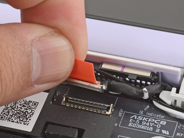

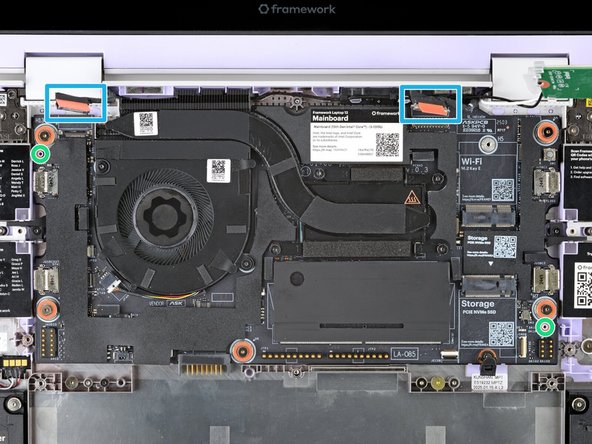

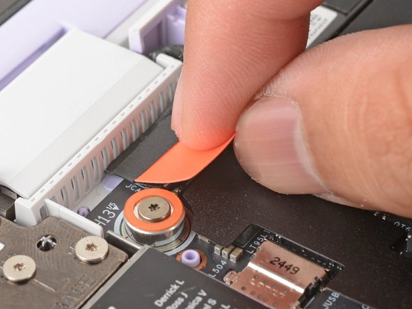

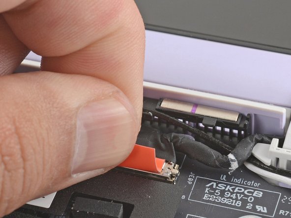

  25. Use your fingers to grab the orange tab on the webcam cable, located near the left hinge. Lift straight up to disconnect the cable.
    • Use your fingers to grab the orange tab on the webcam cable, located near the left hinge.
    • Lift straight up to disconnect the cable.

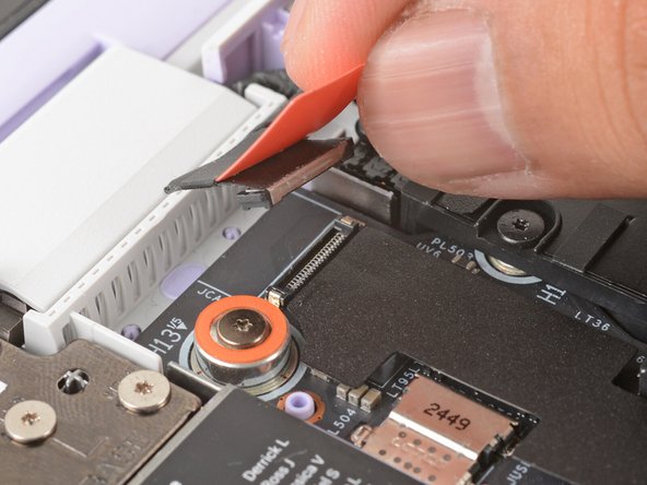

  26. Use your fingers to grab the orange tab on the display cable, located near the right hinge. Lift straight up to disconnect the cable.
    • Use your fingers to grab the orange tab on the display cable, located near the right hinge.

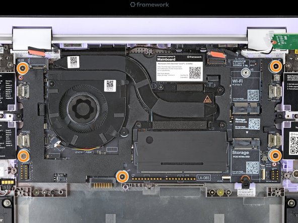

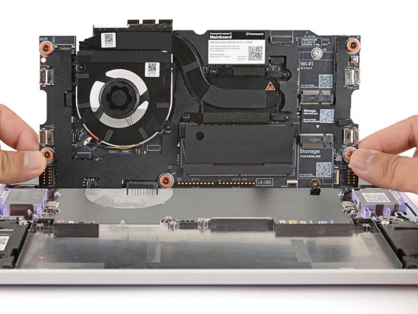

  27. Use your Framework Screwdriver to loosen the five captive T5 Torx screws securing the Mainboard.
    • Use your Framework Screwdriver to loosen the five captive T5 Torx screws securing the Mainboard.
    • These screws are also physically marked with an orange ring on the Mainboard.

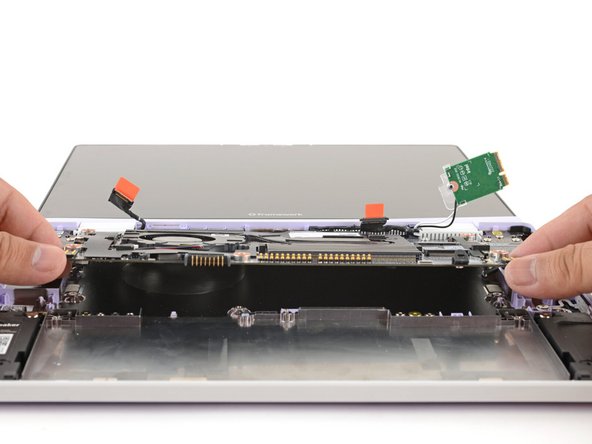

  28. Make sure you've removed all Expansion Cards. Installed cards will hold the Mainboard in place. Use your fingers to grab the Mainboard by its edges.
    • Make sure you've removed all Expansion Cards. Installed cards will hold the Mainboard in place.
    • Use your fingers to grab the Mainboard by its edges.
    • Lift and remove the Mainboard.

  30. Carefully lay the Mainboard in the laptop. Use the two alignment pins to help align the Mainboard to the laptop.
    • Carefully lay the Mainboard in the laptop.
    • Use the two alignment pins to help align the Mainboard to the laptop.
    • Be careful not to trap the webcam or display cables under the Mainboard as you set it in place.
  31. Use your Framework Screwdriver to tighten the five captive T5 Torx screws to secure the Mainboard.
    • Use your Framework Screwdriver to tighten the five captive T5 Torx screws to secure the Mainboard.
  32. Use your fingers to grab the display cable by its orange tab. Align and press the display cable straight down onto its connector.
    • Use your fingers to grab the display cable by its orange tab.
    • Align and press the display cable straight down onto its connector.
  33. Use your fingers to grab the webcam cable by its orange tab. Align and press the webcam cable straight down onto its connector.
    • Use your fingers to grab the webcam cable by its orange tab.
    • Align and press the webcam cable straight down onto its connector.
  34. Use your fingers to carefully move the Wi-Fi card over the Mainboard. Use your fingers to carefully move the Wi-Fi card over the Mainboard.
    • Use your fingers to carefully move the Wi-Fi card over the Mainboard.
  35. Hold the Wi-Fi card by its edges. Don't touch the gold contacts with your fingers. If you do, wipe the contacts with a clean, lint-free cloth to remove any finger oils. Align the Wi-Fi card's gold contacts and notch with the socket on the Mainboard.
    • Hold the Wi-Fi card by its edges. Don't touch the gold contacts with your fingers. If you do, wipe the contacts with a clean, lint-free cloth to remove any finger oils.
    • Align the Wi-Fi card's gold contacts and notch with the socket on the Mainboard.
    • Insert the Wi-Fi card into the socket at a shallow angle. The gold contacts should mostly be covered by the socket.
    • If the clear Wi-Fi card bracket or antenna cables got disconnected during the repair, go to the next step. If they're still attached, skip down three steps.

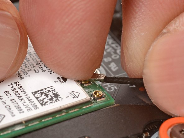

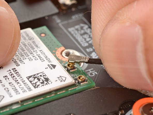

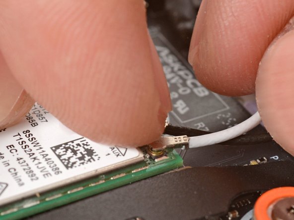

  36. Follow the next two steps if an antenna cable disconnected from the Wi-Fi card. Hold the Wi-Fi card down with your finger. Position the black antenna cable connector over the left Wi-Fi card's coaxial socket.
    • Follow the next two steps if an antenna cable disconnected from the Wi-Fi card.
    • Hold the Wi-Fi card down with your finger.
    • Position the black antenna cable connector over the left Wi-Fi card's coaxial socket.
    • Repeat the procedure with the white antenna cable.
  37. Slide the Wi-Fi bracket over the top edge of the Wi-Fi card. Slide the Wi-Fi bracket over the top edge of the Wi-Fi card.
    • Slide the Wi-Fi bracket over the top edge of the Wi-Fi card.
  38. Use your Framework Screwdriver to tighten the captive T5 Torx screw to secure the Wi-Fi card.
    • Use your Framework Screwdriver to tighten the captive T5 Torx screw to secure the Wi-Fi card.

    • Use your finger to push the battery down near its connector to reconnect it.
  49. Use your Framework Screwdriver to tighten the six captive T5 Torx screws to secure the battery.
    • Use your Framework Screwdriver to tighten the six captive T5 Torx screws to secure the battery.
  50. Angle the bottom edge of the Input Cover towards the base of the laptop. Align and insert the bottom edge of the Input Cover into the base of the laptop. Make sure the slots along the bottom edge of the Input Cover slide into the tabs in the base.
    • Angle the bottom edge of the Input Cover towards the base of the laptop.
    • Align and insert the bottom edge of the Input Cover into the base of the laptop.
  51. Close the laptop lid. Flip your laptop face-down on a clean work surface.
    • Close the laptop lid.
    • Flip your laptop face-down on a clean work surface.
  52. Use your Framework Screwdriver to tighten the eight captive T5 Torx screws on the bottom of your laptop. Tighten the screws until they're snug. Don't over-tighten them, or you may strip the screws.
  53. Slide each Expansion Card into its Expansion Card slot. Slide each Expansion Card into its Expansion Card slot. Slide each Expansion Card into its Expansion Card slot.
    • Slide each Expansion Card into its Expansion Card slot.
  54. If there's a red bar showing under either Expansion Card latch, use your finger to flip the latch and lock the Expansion Card into its slot. Locking the Expansion Card slots helps keep the cards in place when you unplug cables from them.
    • If there's a red bar showing under either Expansion Card latch, use your finger to flip the latch and lock the Expansion Card into its slot.
    • Locking the Expansion Card slots helps keep the cards in place when you unplug cables from them.
