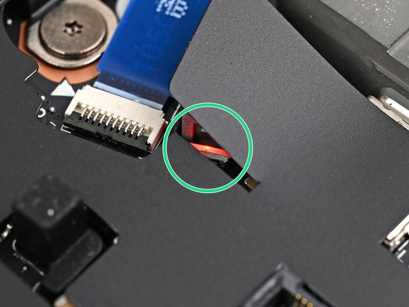

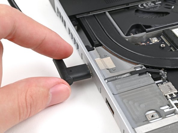

  11. Plug the laptop into a power source. The red status LED near the right Expansion Card slots should blink continuously. If this LED isn't blinking, the laptop isn't receiving power correctly—try another USB-C port.
    • Plug the laptop into a power source.
    • The red status LED near the right Expansion Card slots should blink continuously. If this LED isn't blinking, the laptop isn't receiving power correctly—try another USB-C port.
    • Don't proceed unless the LED is blinking.

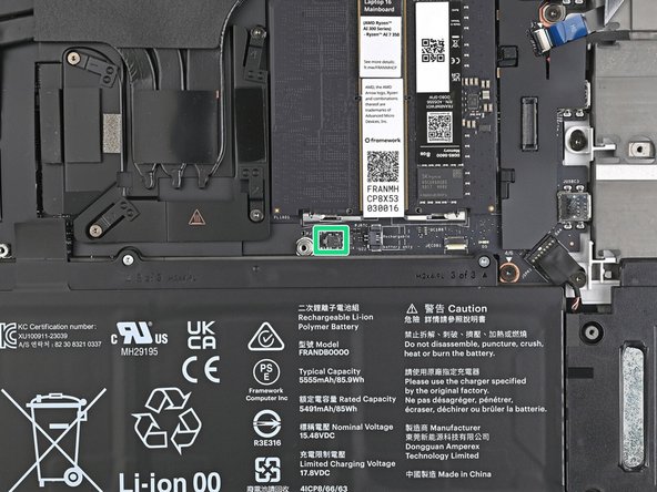

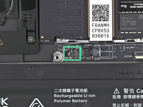

  12. Locate the chassis open switch below the memory. This switch is a sensor that detects if the Mid Plate has been removed. It's a small silver block with a black toggle tab.
    • Locate the chassis open switch below the memory.
    • This switch is a sensor that detects if the Mid Plate has been removed. It's a small silver block with a black toggle tab.

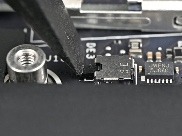

  13. Use your finger or the flat end of a Framework Screwdriver to press the chassis open switch 10 times: Press and hold the switch down for two seconds. Release the switch and wait for the indicator LED to resume blinking.
    • Use your finger or the flat end of a Framework Screwdriver to press the chassis open switch 10 times:
    • Press and hold the switch down for two seconds.
    • Release the switch and wait for the indicator LED to resume blinking.
    • Repeat the process 10 times total.
