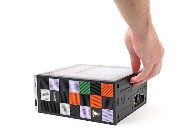

  7. Lay down the Desktop on its right side. Lay down the Desktop on its right side.
    • Lay down the Desktop on its right side.

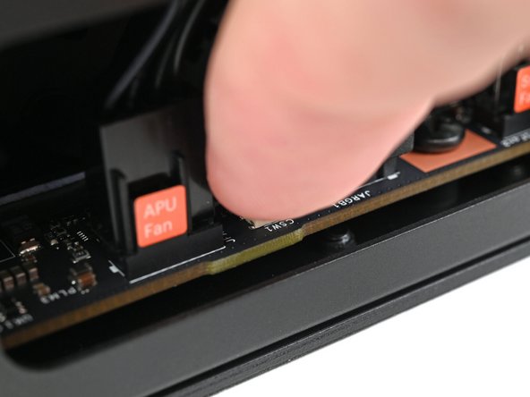

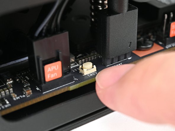

  8. Press the white button labeled "CMOS RESET" next to the APU Fan connector and hold for 10 seconds. Press the white button labeled "CMOS RESET" next to the APU Fan connector and hold for 10 seconds.
    • Press the white button labeled "CMOS RESET" next to the APU Fan connector and hold for 10 seconds.

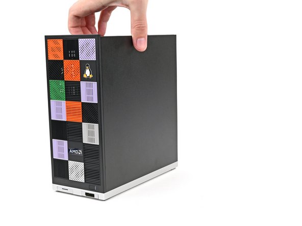

  9. Lift the Desktop so it stands upright on your work surface. Lift the Desktop so it stands upright on your work surface.
    • Lift the Desktop so it stands upright on your work surface.

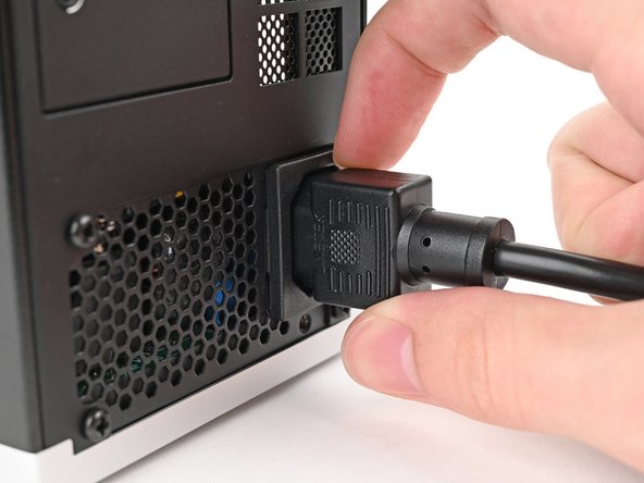

  16. Plug the Desktop back in. Turn on your Desktop—it should boot up normally. If your BIOS settings haven't changed, or if you're still experiencing issues, repeat the Mainboard reset procedure.
    • Plug the Desktop back in.
    • Turn on your Desktop—it should boot up normally. If your BIOS settings haven't changed, or if you're still experiencing issues, repeat the Mainboard reset procedure.
