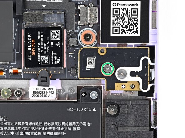

  24. Use your Framework Screwdriver to loosen the captive T5 Torx screw securing the Wi-Fi card bracket.
    • Use your Framework Screwdriver to loosen the captive T5 Torx screw securing the Wi-Fi card bracket.
    • The Wi-Fi card will pop up slightly when you unfasten the bracket.

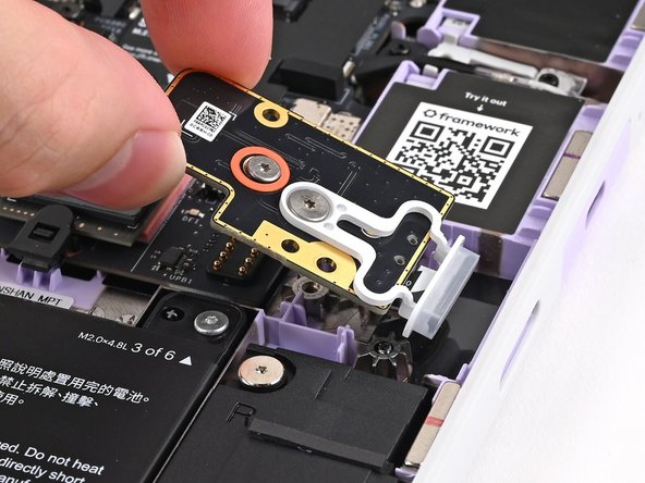

  25. Be careful not to strain the two delicate antenna cables attached to the Wi-Fi card. Grab the Wi-Fi card by its edges and slide it out of its socket.
    • Be careful not to strain the two delicate antenna cables attached to the Wi-Fi card.
    • Grab the Wi-Fi card by its edges and slide it out of its socket.
  26. Carefully reposition the Wi-Fi card away from the Mainboard. If the clear bracket or an antenna cable detaches from the Wi-Fi card, don't worry! You can reattach it during reassembly.
    • Carefully reposition the Wi-Fi card away from the Mainboard.
    • If the clear bracket or an antenna cable detaches from the Wi-Fi card, don't worry! You can reattach it during reassembly.

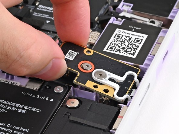

  36. Use your fingers to carefully move the Wi-Fi card over the Mainboard. Use your fingers to carefully move the Wi-Fi card over the Mainboard.
    • Use your fingers to carefully move the Wi-Fi card over the Mainboard.
  37. Hold the Wi-Fi card by its edges. Don't touch the gold contacts with your fingers. If you do, wipe the contacts with a clean, lint-free cloth to remove any finger oils. Align the Wi-Fi card's gold contacts and notch with the socket on the Mainboard.
    • Hold the Wi-Fi card by its edges. Don't touch the gold contacts with your fingers. If you do, wipe the contacts with a clean, lint-free cloth to remove any finger oils.
    • Align the Wi-Fi card's gold contacts and notch with the socket on the Mainboard.
    • Insert the Wi-Fi card into the socket at a shallow angle. The gold contacts should mostly be covered by the socket.
    • If the clear Wi-Fi card bracket or antenna cables got disconnected during the repair, go to the next step. If they're still attached, skip down three steps.

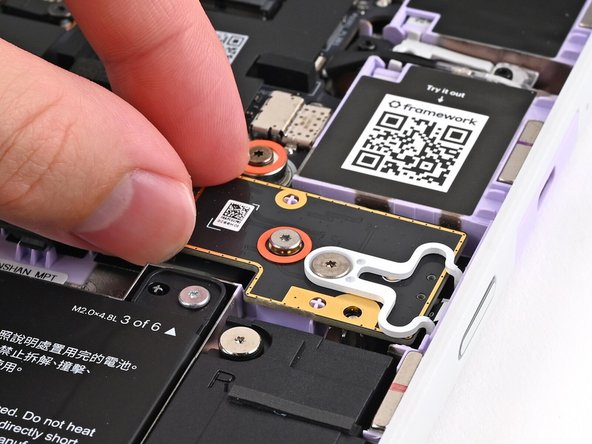

  39. Slide the Wi-Fi bracket over the top edge of the Wi-Fi card. Slide the Wi-Fi bracket over the top edge of the Wi-Fi card.
    • Slide the Wi-Fi bracket over the top edge of the Wi-Fi card.
  40. Use your Framework Screwdriver to tighten the captive T5 Torx screw to secure the Wi-Fi card.
    • Use your Framework Screwdriver to tighten the captive T5 Torx screw to secure the Wi-Fi card.
