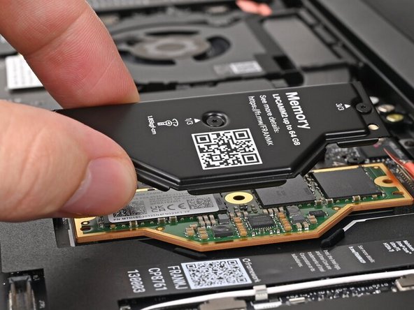

  7. Use your Framework Screwdriver to loosen the captive T5 Torx screws securing the LPCAMM2 Memory Cover in reverse order from 3–1. Use your Framework Screwdriver to loosen the captive T5 Torx screws securing the LPCAMM2 Memory Cover in reverse order from 3–1.
    • Use your Framework Screwdriver to loosen the captive T5 Torx screws securing the LPCAMM2 Memory Cover in reverse order from 3–1.
  8. Lift the LPCAMM2 Memory Cover straight off the memory and remove it. Lift the LPCAMM2 Memory Cover straight off the memory and remove it.
    • Lift the LPCAMM2 Memory Cover straight off the memory and remove it.

  10. Place the LPCAMM2 Memory Cover on top of the memory, making sure its screws align with the screw holes. The cover should lay flat when aligned properly.
    • Place the LPCAMM2 Memory Cover on top of the memory, making sure its screws align with the screw holes.
    • The cover should lay flat when aligned properly.
  11. Use your Framework Screwdriver to tighten the captive T5 Torx screws securing the LPCAMM2 Memory Cover in order from 1–3. Make sure the screws are snug enough to create proper contact between the memory and the Mainboard.
    • Use your Framework Screwdriver to tighten the captive T5 Torx screws securing the LPCAMM2 Memory Cover in order from 1–3.
    • Make sure the screws are snug enough to create proper contact between the memory and the Mainboard.
