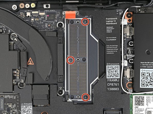

  7. Use your Framework Screwdriver to loosen the captive T5 Torx screws securing the LPCAMM2 Memory Cover in reverse order from 3–1. Use your Framework Screwdriver to loosen the captive T5 Torx screws securing the LPCAMM2 Memory Cover in reverse order from 3–1.
    • Use your Framework Screwdriver to loosen the captive T5 Torx screws securing the LPCAMM2 Memory Cover in reverse order from 3–1.

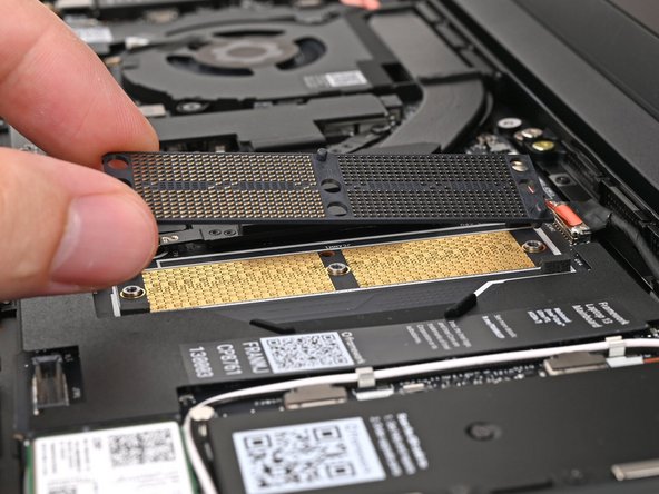

  9. Grip the LPCAMM2 module by its edges and lift it straight off its alignment pegs to remove it. Avoid touching the Interposer below the module. If the Interposer accidentally shifts, grab it by its edges to place it back into its alignment pegs.
    • Grip the LPCAMM2 module by its edges and lift it straight off its alignment pegs to remove it.
    • Avoid touching the Interposer below the module. If the Interposer accidentally shifts, grab it by its edges to place it back into its alignment pegs.
    • Make sure there's no dust or debris on top of the Interposer before continuing.

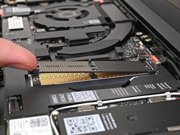

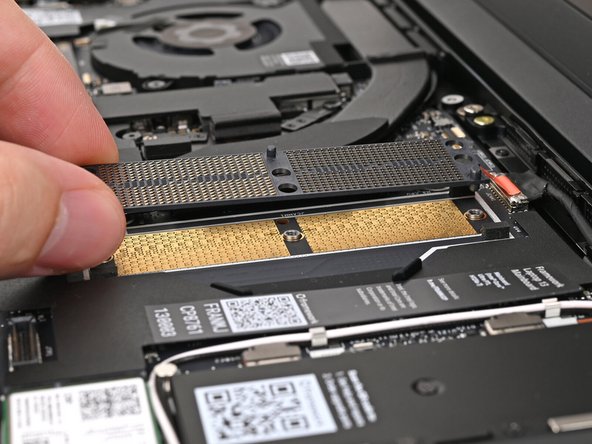

  10. Be extremely careful when handling the Interposer, as its pins can break easily. Only grip its edges to avoid touching its pins. Use a fingernail to lift up the bottom edge of the Interposer until you can grip its edges with your fingers. Lift the Interposer straight off its alignment pegs and remove it.
    • Be extremely careful when handling the Interposer, as its pins can break easily. Only grip its edges to avoid touching its pins.
    • Use a fingernail to lift up the bottom edge of the Interposer until you can grip its edges with your fingers.
    • Lift the Interposer straight off its alignment pegs and remove it.
    • Avoid pressing or bending the pins against the Mainboard as you lift.

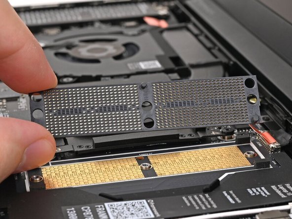

  12. The Interposer only slots in the Mainboard one way. Use the holes in the Mainboard and the pegs in the Interposer to help orient it. The notch in the Interposer should be at the bottom left corner. Place the Interposer onto the Mainboard, making sure it slots in properly and that it sits flat surrounded by four sponges. You may have to lightly bend the orange Webcam Cable connector tab to keep it out of the way.
    • The Interposer only slots in the Mainboard one way. Use the holes in the Mainboard and the pegs in the Interposer to help orient it. The notch in the Interposer should be at the bottom left corner.
    • Place the Interposer onto the Mainboard, making sure it slots in properly and that it sits flat surrounded by four sponges.
    • You may have to lightly bend the orange Webcam Cable connector tab to keep it out of the way.

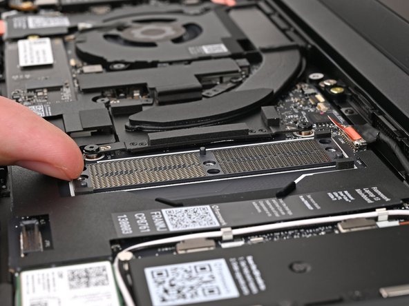

  13. Place the LPCAMM2 module on top of the Interposer, making sure it slots into its alignment pegs. Place the LPCAMM2 module on top of the Interposer, making sure it slots into its alignment pegs. Place the LPCAMM2 module on top of the Interposer, making sure it slots into its alignment pegs.
    • Place the LPCAMM2 module on top of the Interposer, making sure it slots into its alignment pegs.

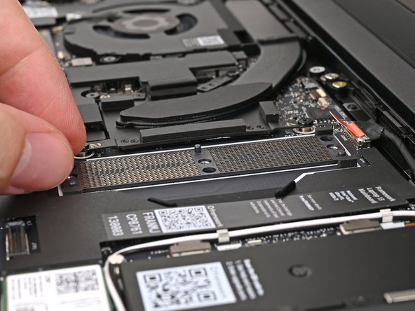

  14. Place the LPCAMM2 Memory Cover on top of the memory, making sure its screws align with the screw holes. The cover should lay flat when aligned properly.
    • Place the LPCAMM2 Memory Cover on top of the memory, making sure its screws align with the screw holes.
    • The cover should lay flat when aligned properly.
  15. Use your Framework Screwdriver to tighten the captive T5 Torx screws securing the LPCAMM2 Memory Cover in order from 1–3. Make sure the screws are snug enough to create proper contact between the memory and the Mainboard.
    • Use your Framework Screwdriver to tighten the captive T5 Torx screws securing the LPCAMM2 Memory Cover in order from 1–3.
    • Make sure the screws are snug enough to create proper contact between the memory and the Mainboard.
