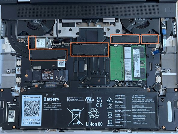

  1. There are 5 total sponges. Arrange your sponges like this from Left to Right. This is the same order we will be applying them.
    • There are 5 total sponges. Arrange your sponges like this from Left to Right. This is the same order we will be applying them.
    • Here is an image of where they will sit once their backing is removed.
    • First sponge to apply is the one for the WLAN module, the sponge is roughly (5.25mm x 21.5mm) in size and goes on top of the plastic WLAN connector.
    • Remove the clear paper backing of the sponge to reveal the sticky side.
    • Now place the sticky side against the top of the plastic WLAN connector.
    • This as at the base where the Wi-Fi card is plugged in.
    • Second sponge will go above the M.2 slot and align with the copper plate shape. The sponge for this is roughly (16.75mm x 66.5mm) in size and matches the shape you are placing it onto.
    • Remove the white paper backing of the sponge to reveal the sticky side.
    • Now place the sticky side against the plate matching the shape.
    • This the copper plate between the Wi-Fi card and the M.2 slot.
    • Third sponge will go on top of the copper pipes above the CPU. The size of this sponge at its widest points is roughly (19.1mm x 67.65mm) and matches the shape you are placing it onto.
    • Now place the sticky side against the pipes matching the shape.
    • This is directly below the below the interposer door.
    • Fourth sponge will go on top of the copper pipe above the RAM. The sponge for this is roughly (11.75mm x 48.25mm).
    • Now place the sticky side against the pipe making sure the right edge of the sponge meets the edge of the black standoff.
    • Fifth and final sponge will go to the right of the sponge you just put down. The sponge for this is roughly (11.75mm x 24.50mm).
    • Now place the sticky side against the pipe making sure the left edge aligns with the edge of the plate below.
    • Important Note: When placing this one down, make sure you do not accidentally stick it to the ribbon cable on the right of it.

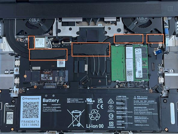

  2. With all five of the sponges applied, it should look like this!
    • With all five of the sponges applied, it should look like this!
