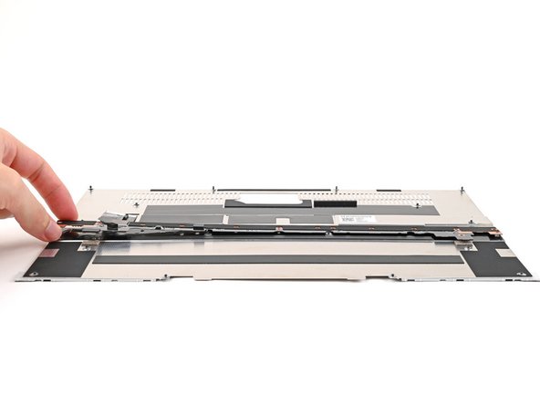

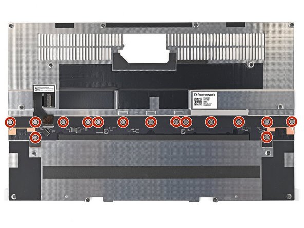

  11. Use your Framework Screwdriver to remove the fifteen 1.4 mm‑long Phillips screws securing the Input Module Connector Board. Use your Framework Screwdriver to remove the fifteen 1.4 mm‑long Phillips screws securing the Input Module Connector Board.
    • Use your Framework Screwdriver to remove the fifteen 1.4 mm‑long Phillips screws securing the Input Module Connector Board.

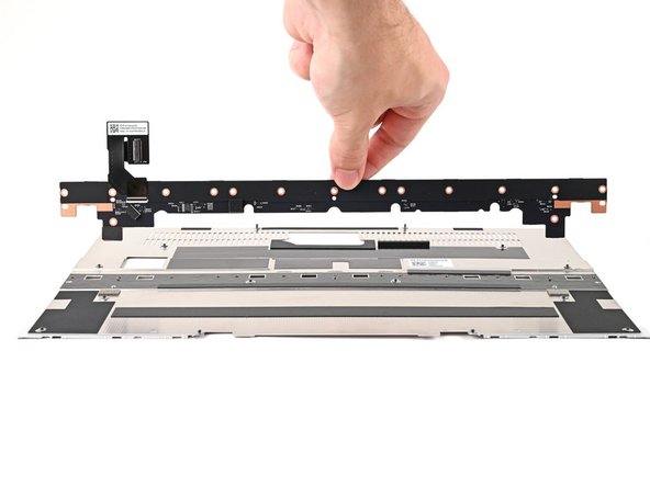

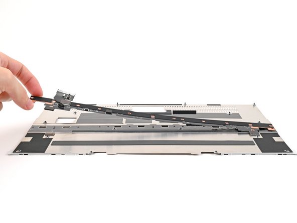

  12. Lift the Input Module Connector Board off the Mid Plate and remove it. Lift the Input Module Connector Board off the Mid Plate and remove it. Lift the Input Module Connector Board off the Mid Plate and remove it.
    • Lift the Input Module Connector Board off the Mid Plate and remove it.
