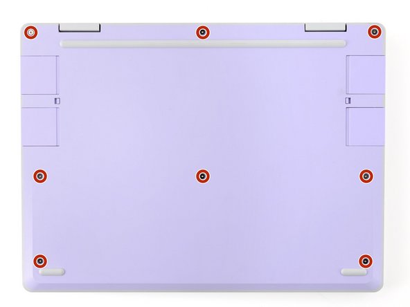

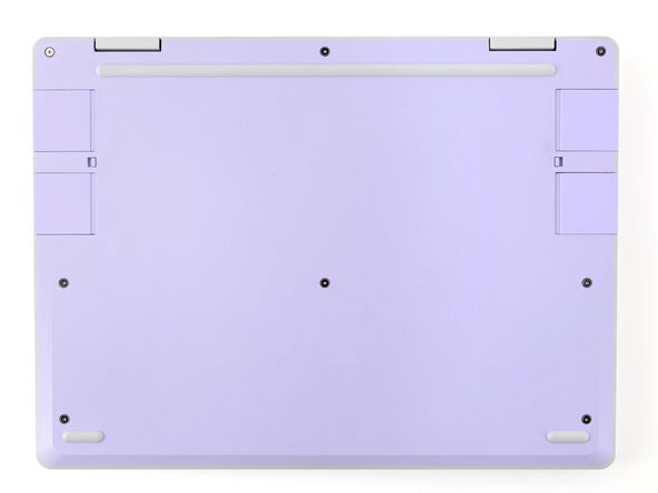

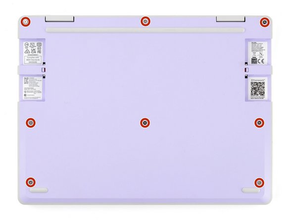

  3. Use your Framework Screwdriver to fully loosen the eight captive T5 Torx screws on the bottom of your Laptop. Most screws in your Framework Laptop (including these) are captive—they're designed to stay in place after you loosen them.
    • Use your Framework Screwdriver to fully loosen the eight captive T5 Torx screws on the bottom of your Laptop.
    • Your Laptop comes with a spare set of screws in the frame above the battery. Be careful—the replacement screws aren't captive.

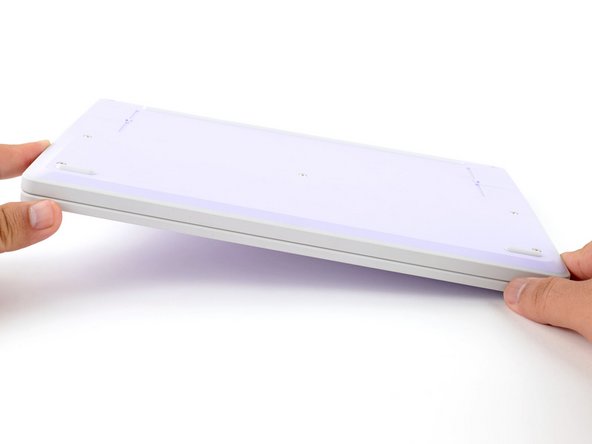

  4. Flip your Laptop over so it's face-up on your work surface.
    • Flip your Laptop over so it's face-up on your work surface.

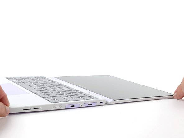

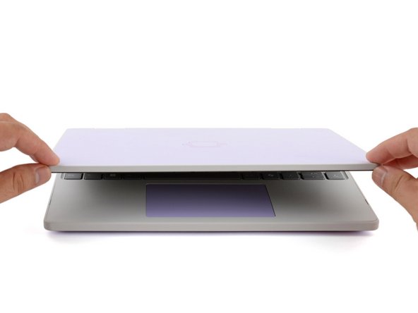

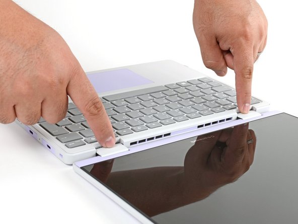

  5. Open the Laptop lid so that both the screen and the base lie flat on your work surface. Open the Laptop lid so that both the screen and the base lie flat on your work surface.
    • Open the Laptop lid so that both the screen and the base lie flat on your work surface.

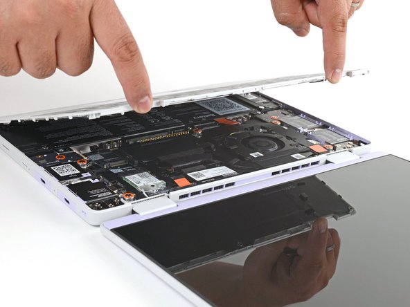

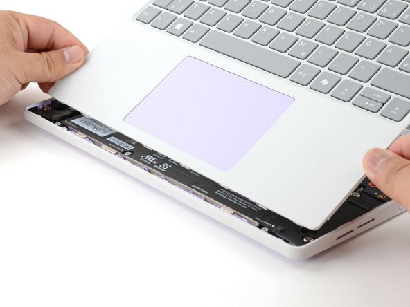

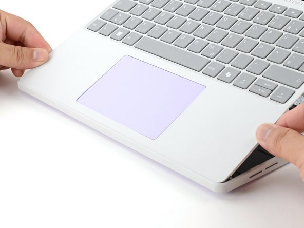

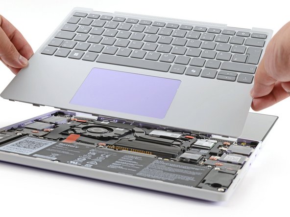

  6. Use your fingers to grip the Input Cover in the hinge cutouts. Lift upwards to swing the Input Cover up from the base of the Laptop. There are magnets holding the Input Cover down, so you'll feel some resistance. If it feels like a lot of force is required, check that you've fully loosened all the screws on the bottom of your Laptop.
    • Lift upwards to swing the Input Cover up from the base of the Laptop.
    • There are magnets holding the Input Cover down, so you'll feel some resistance. If it feels like a lot of force is required, check that you've fully loosened all the screws on the bottom of your Laptop.
    • Remove the Input Cover.

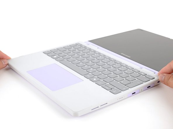

  8. Angle the bottom edge of the Input Cover towards the base of the Laptop. Align and insert the bottom edge of the Input Cover into the base of the Laptop. Make sure the slots along the bottom edge of the Input Cover slide into the tabs in the base.
    • Angle the bottom edge of the Input Cover towards the base of the Laptop.
    • Align and insert the bottom edge of the Input Cover into the base of the Laptop.

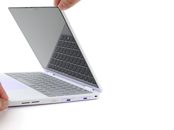

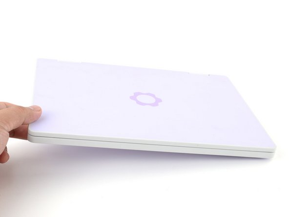

  9. Close the Laptop lid. Flip your Laptop face-down on a clean work surface.
    • Close the Laptop lid.
    • Flip your Laptop face-down on a clean work surface.
