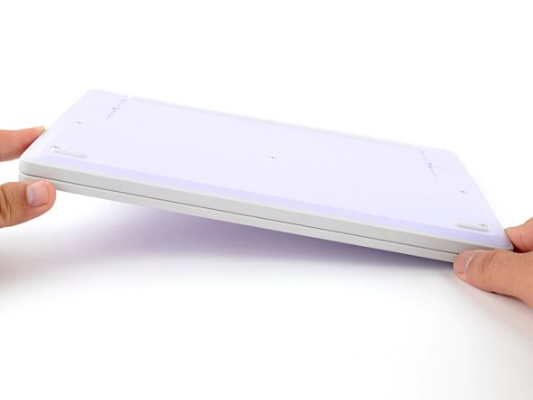

  1. Set your Framework Laptop face-down on a clean work surface.

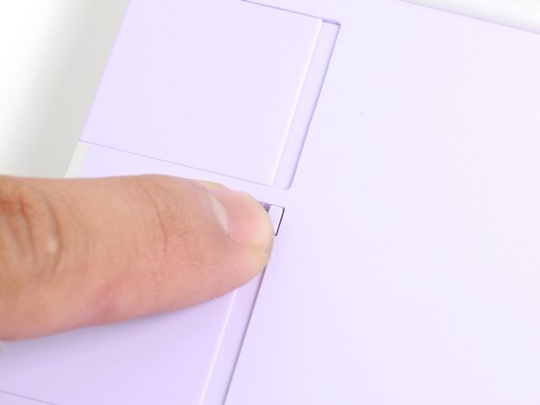

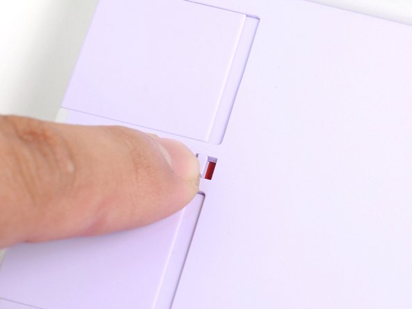

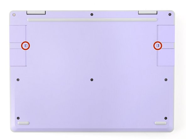

  2. Use your fingers to flip both Expansion Card latches to the lock position. The red bar shouldn't show on the latches. Use your fingers to flip both Expansion Card latches to the lock position. The red bar shouldn't show on the latches. Use your fingers to flip both Expansion Card latches to the lock position. The red bar shouldn't show on the latches.
    • Use your fingers to flip both Expansion Card latches to the lock position. The red bar shouldn't show on the latches.

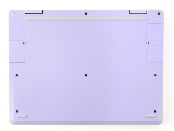

  3. Use your Framework Screwdriver to fully loosen the eight captive T5 Torx screws on the bottom of your laptop. Most screws in your Framework Laptop (including these) are captive—they're designed to stay in place after you loosen them.

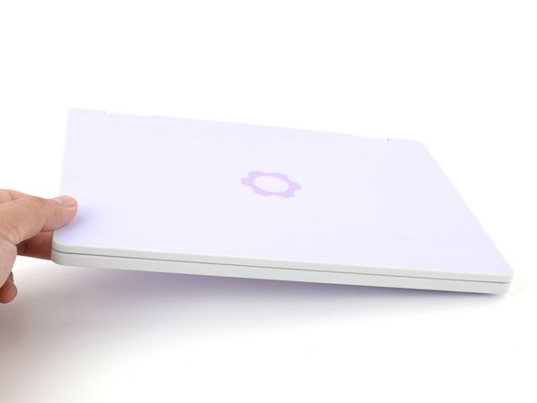

  4. Flip your laptop over so it's face-up on your work surface.
    • Flip your laptop over so it's face-up on your work surface.

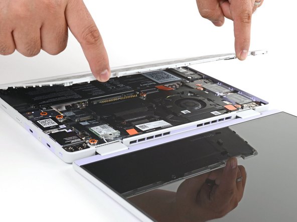

  5. Open the laptop lid so that both the screen and the base lie flat on your work surface. Open the laptop lid so that both the screen and the base lie flat on your work surface.

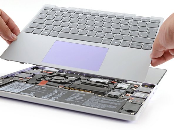

  6. Use your fingers to grip the Input Cover in the hinge cutouts. Lift upwards to swing the Input Cover up from the base of the laptop. There are magnets holding the Input Cover down, so you'll feel some resistance. If it feels like a lot of force is required, check that you've fully loosened all the screws on the bottom of your laptop.
    • There are magnets holding the Input Cover down, so you'll feel some resistance. If it feels like a lot of force is required, check that you've fully loosened all the screws on the bottom of your laptop.
    • Remove the Input Cover.

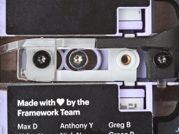

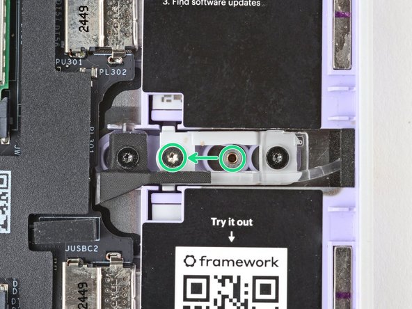

  7. For the left side, use your Framework Screwdriver to remove the silver lock screw from its holding post between the Expansion Card slots. This is a 2.9 mm‑long T5 Torx screw. Install the screw into the screw hole to the right of the post.
    • For the left side, use your Framework Screwdriver to remove the silver lock screw from its holding post between the Expansion Card slots.
    • This is a 2.9 mm‑long T5 Torx screw.
    • Install the screw into the screw hole to the right of the post.
    • This holds the left Expansion Card latch in place, preventing external unlock.
    • Repeat the procedure on the right side to lock the right Expansion Cards.

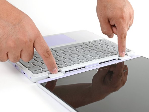

  9. Angle the bottom edge of the Input Cover towards the base of the Laptop. Align and insert the bottom edge of the Input Cover into the base of the Laptop. Make sure the slots along the bottom edge of the Input Cover slide into the tabs in the base.
    • Angle the bottom edge of the Input Cover towards the base of the Laptop.
    • Align and insert the bottom edge of the Input Cover into the base of the Laptop.
