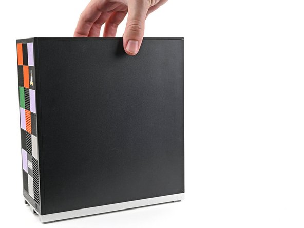

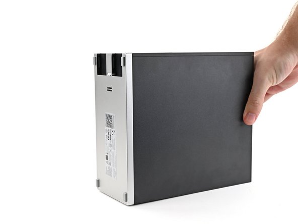

  1. Rotate the Desktop so its rear rests on your work surface. If your Desktop is plugged in, consider powering down and unplugging it so the rear sits flat. Otherwise, you'll need to support it with one hand at an angle while you work.
    • Rotate the Desktop so its rear rests on your work surface.
    • If your Desktop is plugged in, consider powering down and unplugging it so the rear sits flat. Otherwise, you'll need to support it with one hand at an angle while you work.

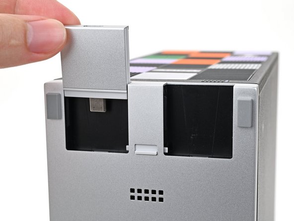

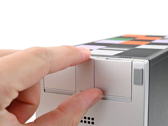

  2. The next two steps show how to install an Expansion Card. Slide an Expansion Card into an Expansion Card slot. You don't need to unlock the latch to install the Expansion Cards—only when you want to remove them.
    • The next two steps show how to install an Expansion Card.
    • The Expansion Cards should click into place, and the front edge should be flush with the silver base.

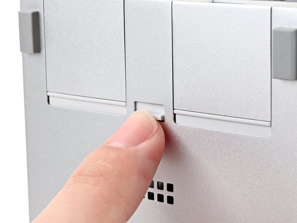

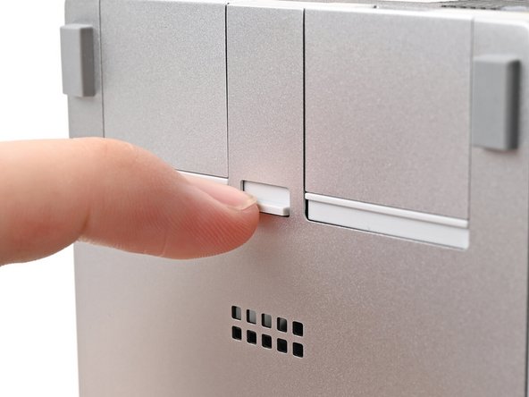

  3. If there's a red bar showing under the Expansion Card latch, use your finger to flip the latch and lock the Expansion Card into its slot. Locking the Expansion Card slots helps keep the cards in place when you unplug cables from them.
    • If there's a red bar showing under the Expansion Card latch, use your finger to flip the latch and lock the Expansion Card into its slot.
    • Locking the Expansion Card slots helps keep the cards in place when you unplug cables from them.

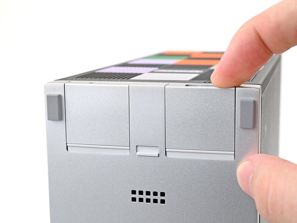

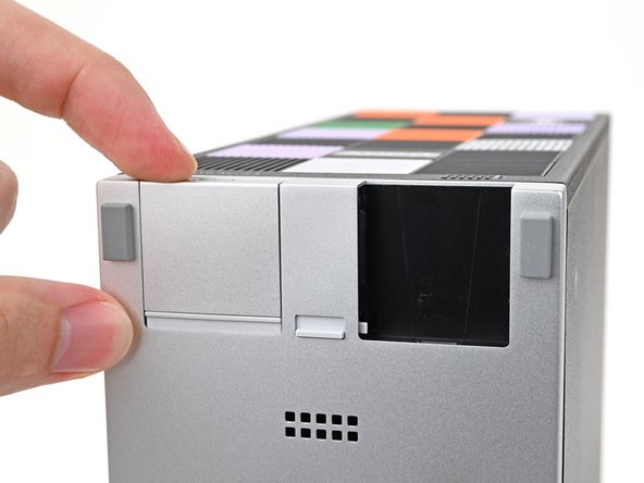

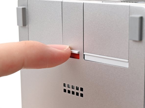

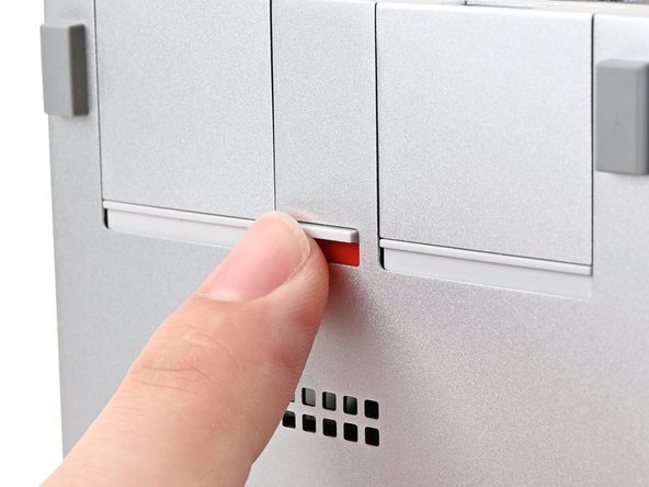

  4. The next two steps show how to remove an Expansion Card. Use your finger to flip the Expansion Card latch into the unlocked position.
    • The next two steps show how to remove an Expansion Card.
    • Use your finger to flip the Expansion Card latch into the unlocked position.
    • The latch displays a red bar when it's unlocked.

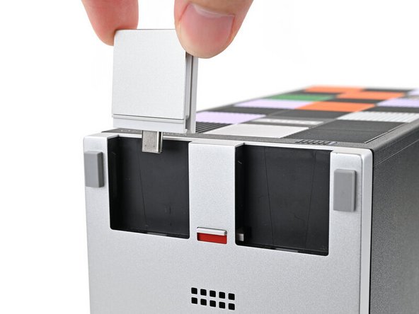

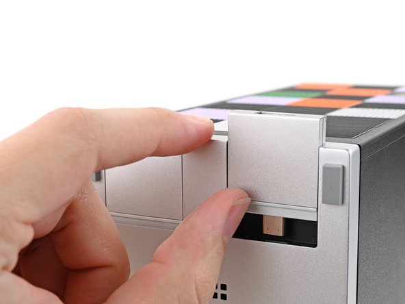

  5. Push up on the lip of the Expansion Card with your fingers. Pull the Expansion Card out of its slot and remove it. Pull the Expansion Card out of its slot and remove it.
    • Push up on the lip of the Expansion Card with your fingers.
