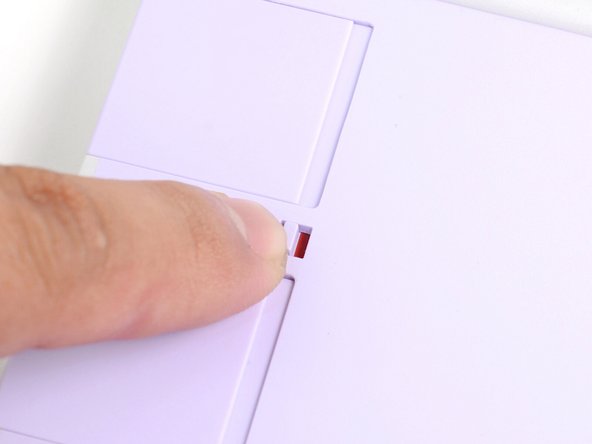

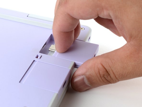

  3. Use your fingers to flip the two Expansion Card latches (one for each side) into the unlocked position. The latches display a red bar when they're unlocked.
    • Use your fingers to flip the two Expansion Card latches (one for each side) into the unlocked position.
    • The latches display a red bar when they're unlocked.

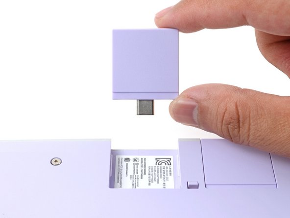

  4. Grip the lip of an Expansion Card with your fingers. Pull the Expansion Card out of its slot and remove it. If you have trouble pulling the Expansion Card out, you can also use the flat end of your Framework Screwdriver to push against the lip.
    • Grip the lip of an Expansion Card with your fingers.
    • If you have trouble pulling the Expansion Card out, you can also use the flat end of your Framework Screwdriver to push against the lip.
    • Repeat this procedure to remove all remaining Expansion Cards.

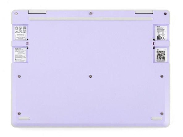

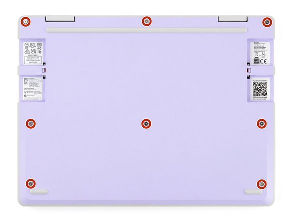

  5. Use your Framework Screwdriver to fully loosen the eight captive T5 Torx screws on the bottom of your laptop. Most screws in your Framework Laptop (including these) are captive—they're designed to stay in place after you loosen them.

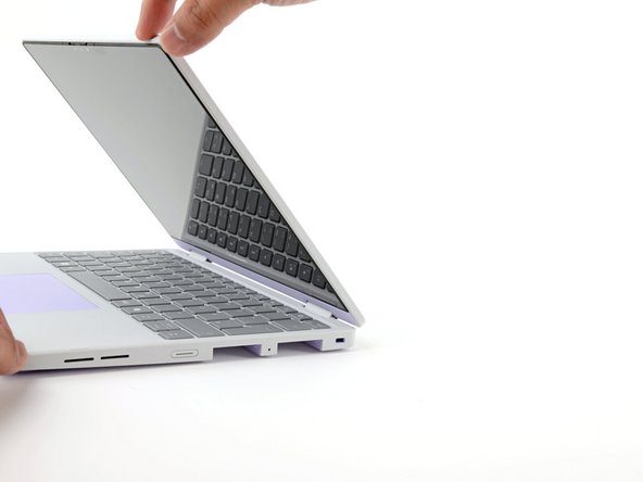

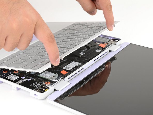

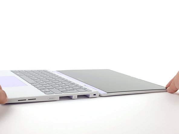

  7. Open the laptop lid so that both the screen and the base lie flat on your work surface. Open the laptop lid so that both the screen and the base lie flat on your work surface.

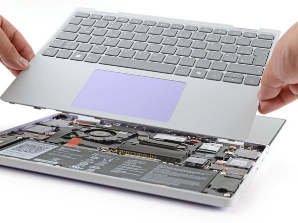

  8. Use your fingers to grip the Input Cover in the hinge cutouts. Lift upwards to swing the Input Cover up from the base of the laptop. You may feel resistance from the magnets. If the cover feels like it's snagged, check that you've fully loosened the screws on the bottom of your laptop.
    • You may feel resistance from the magnets. If the cover feels like it's snagged, check that you've fully loosened the screws on the bottom of your laptop.
    • Remove the Input Cover.

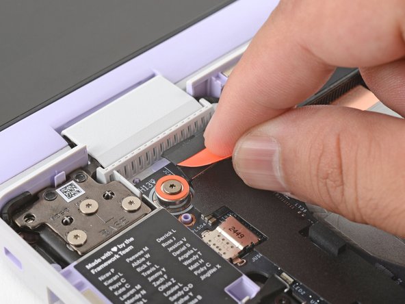

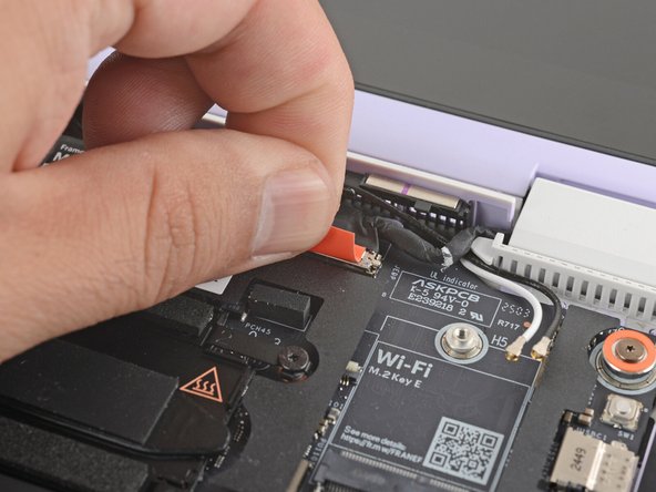

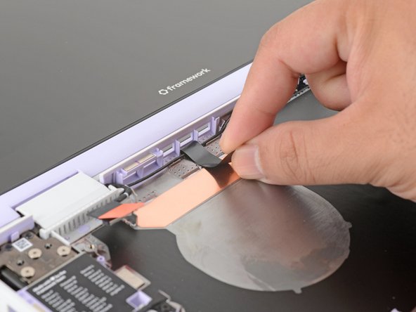

  20. Use your fingers to grab the orange tab on the webcam cable, located near the left hinge. Lift straight up to disconnect the cable.
    • Use your fingers to grab the orange tab on the webcam cable, located near the left hinge.
    • Lift straight up to disconnect the cable.

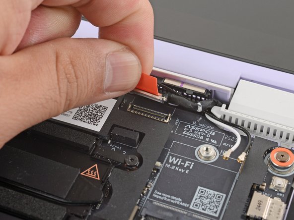

  21. Use your fingers to grab the orange tab on the display cable, located near the right hinge. Lift straight up to disconnect the cable.
    • Use your fingers to grab the orange tab on the display cable, located near the right hinge.

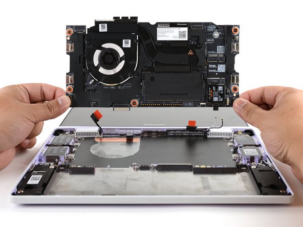

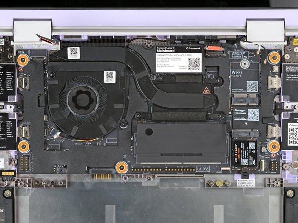

  22. Use your Framework Screwdriver to loosen the five captive T5 Torx screws securing the Mainboard.
    • Use your Framework Screwdriver to loosen the five captive T5 Torx screws securing the Mainboard.
    • These screws are also physically marked with an orange ring on the Mainboard.

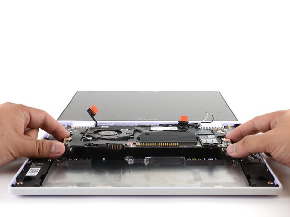

  23. Make sure you've removed all Expansion Cards. Installed cards will hold the Mainboard in place. Use your fingers to grab the Mainboard by its edges.
    • Make sure you've removed all Expansion Cards. Installed cards will hold the Mainboard in place.
    • Use your fingers to grab the Mainboard by its edges.
    • Lift and remove the Mainboard.

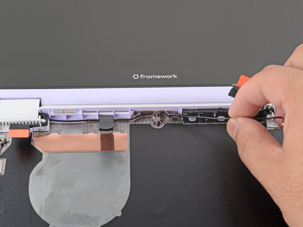

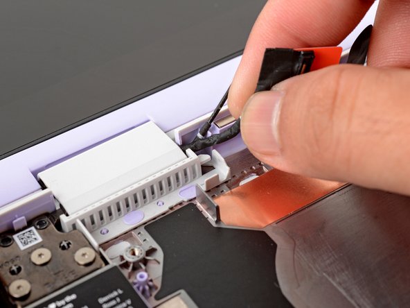

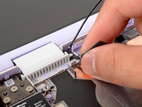

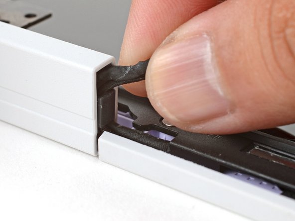

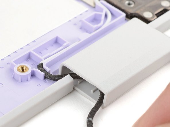

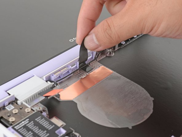

  24. Use your fingers to lift the black plastic loop securing the antenna cable, near the heat vents by the left hinge. Use your fingers to lift the black plastic loop securing the antenna cable, near the heat vents by the left hinge.
    • Use your fingers to lift the black plastic loop securing the antenna cable, near the heat vents by the left hinge.
  25. Use your fingers to lift and guide the antenna cable out of the frame channel. Use your fingers to lift and guide the antenna cable out of the frame channel.
    • Use your fingers to lift and guide the antenna cable out of the frame channel.
  26. Use your fingers to gently lift the webcam cable out of its plastic channel. Use your fingers to gently lift the webcam cable out of its plastic channel.
    • Use your fingers to gently lift the webcam cable out of its plastic channel.

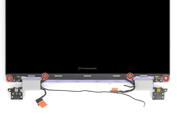

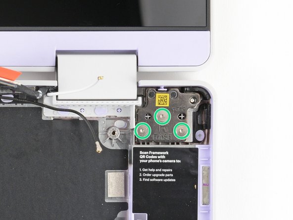

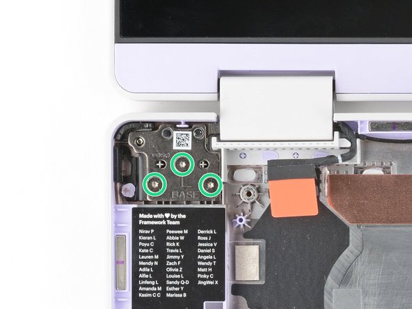

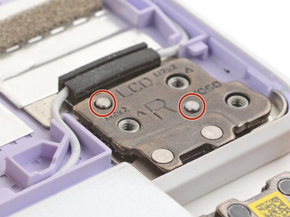

  27. Use your Framework Screwdriver to remove the six (three per hinge) 4.5 mm‑long T5 Torx screws securing the two hinges. These screws are not captive. Store them in a safe location for reassembly.
    • Use your Framework Screwdriver to remove the six (three per hinge) 4.5 mm‑long T5 Torx screws securing the two hinges.
    • These screws are not captive. Store them in a safe location for reassembly.

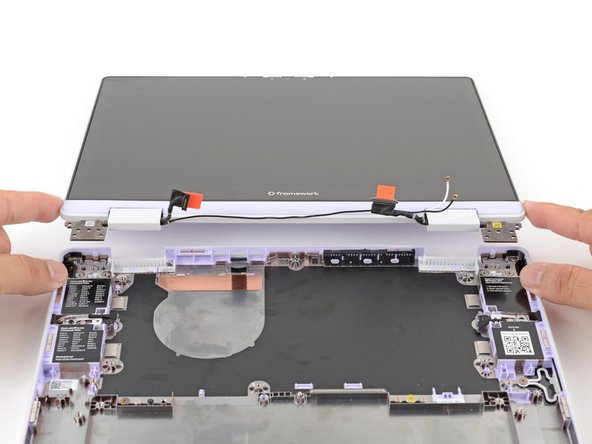

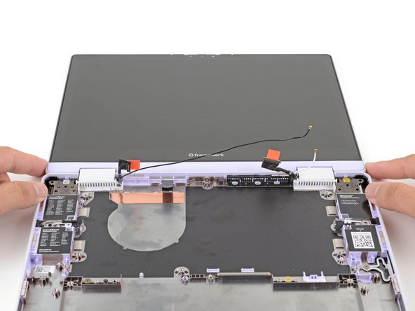

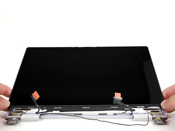

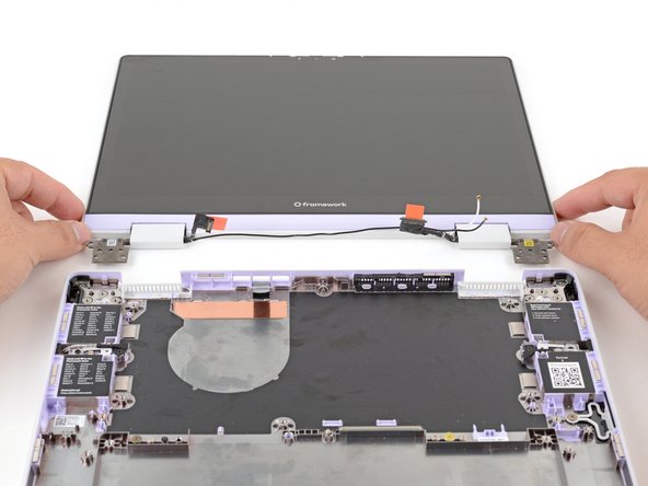

  28. Use your fingers to lift the hinges over the Bottom Cover lip. Separate the Top Cover from the Bottom Cover. Separate the Top Cover from the Bottom Cover.
    • Use your fingers to lift the hinges over the Bottom Cover lip.
    • Separate the Top Cover from the Bottom Cover.

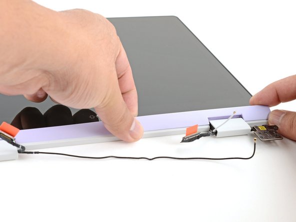

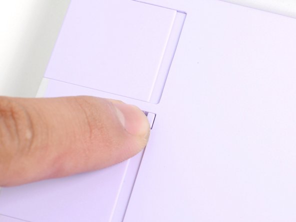

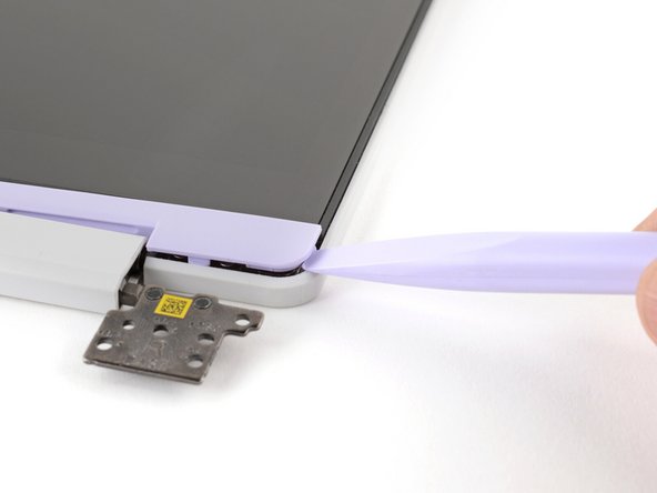

  29. The Display Cover is held in place with magnets along its top edge and clips along its remaining edges. Use the flat end of your Framework Screwdriver to pry up the right edge of the Display Cover.
    • The Display Cover is held in place with magnets along its top edge and clips along its remaining edges.
    • Use the flat end of your Framework Screwdriver to pry up the right edge of the Display Cover.
  30. Slide your fingers under the top edge of the Display Cover to release it from the laptop. Slide your fingers under the top edge of the Display Cover to release it from the laptop.
    • Slide your fingers under the top edge of the Display Cover to release it from the laptop.
  31. Remove the Display Cover.
    • Remove the Display Cover.

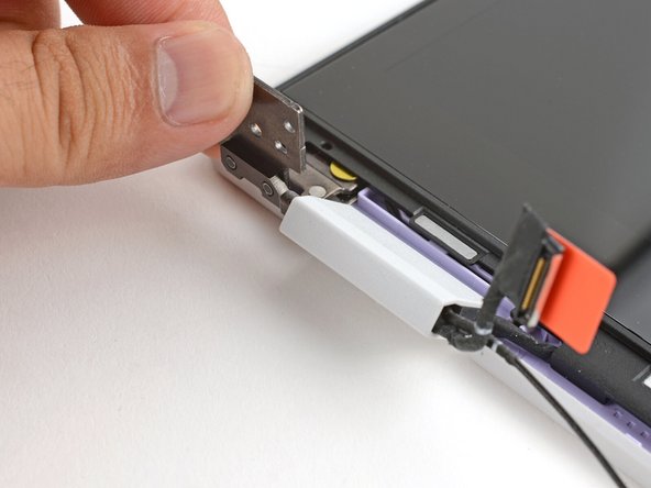

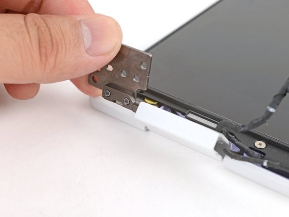

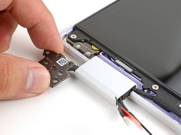

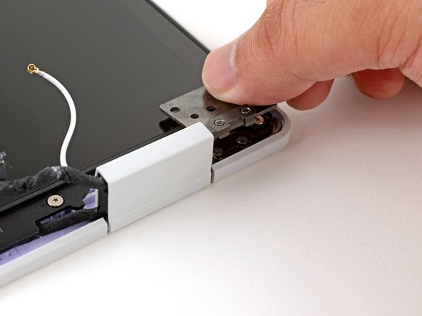

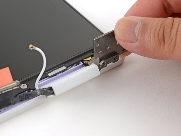

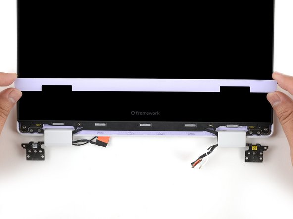

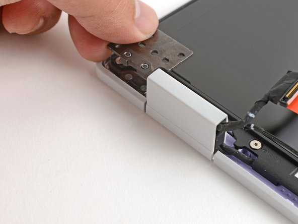

  32. Use your fingers to twist the right hinge plate until it's flipped on top of the display. The stiff hinge can be difficult to twist. Wear some work gloves, or use a cloth to help get a better grip. The stiff hinge can be difficult to twist. Wear some work gloves, or use a cloth to help get a better grip.
    • Use your fingers to twist the right hinge plate until it's flipped on top of the display.
    • The stiff hinge can be difficult to twist. Wear some work gloves, or use a cloth to help get a better grip.
  33. Twist the left hinge plate until it's flipped on top of the display. Twist the left hinge plate until it's flipped on top of the display. Twist the left hinge plate until it's flipped on top of the display.
    • Twist the left hinge plate until it's flipped on top of the display.

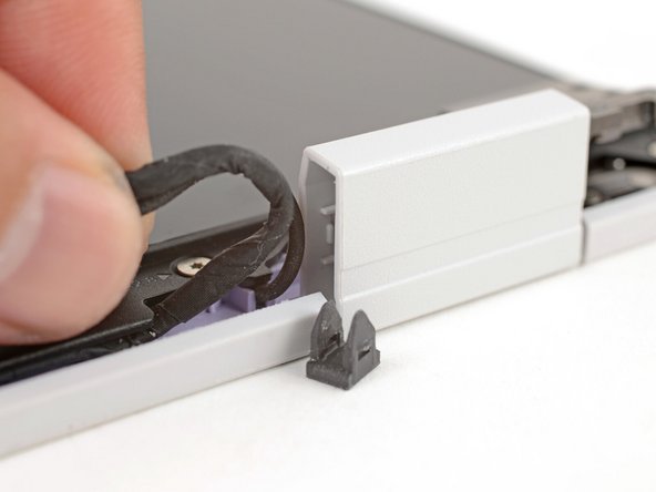

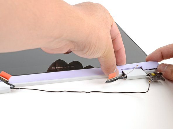

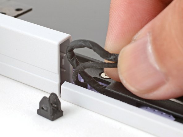

  34. Use your fingers to grab the two cables coming out of the left hinge. Pull gently to pop out the black cable clip and release the cables.
    • Use your fingers to grab the two cables coming out of the left hinge.
    • Pull gently to pop out the black cable clip and release the cables.
    • Store the cable clip for reassembly.
  35. Repeat the procedure on the right hinge to release the cables. Store the cable clip for reassembly.
    • Repeat the procedure on the right hinge to release the cables.

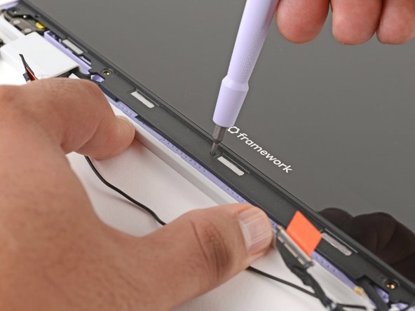

  37. Use your Framework Screwdriver to remove the four 3.3 mm‑long T5 Torx screws securing the display to the Top Cover.
    • Use your Framework Screwdriver to remove the four 3.3 mm‑long T5 Torx screws securing the display to the Top Cover.

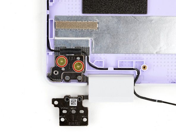

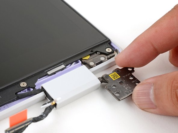

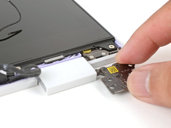

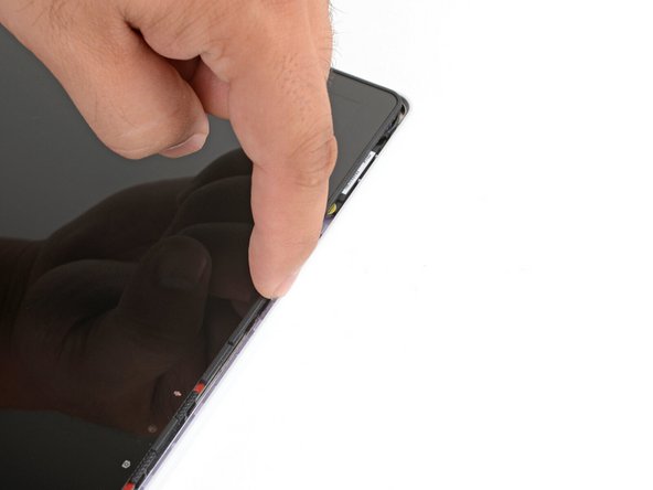

  41. Use your Framework Screwdriver to remove the four (two per hinge) 2.5 mm‑long T5 Torx screws securing the two hinges to the Top Cover. These screws are not captive. Store them in a safe location for reassembly.
    • Use your Framework Screwdriver to remove the four (two per hinge) 2.5 mm‑long T5 Torx screws securing the two hinges to the Top Cover.

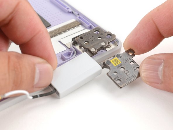

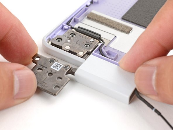

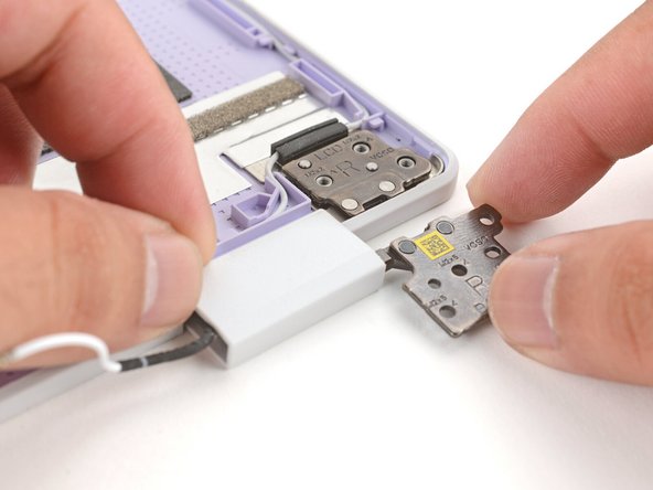

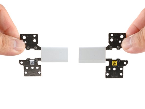

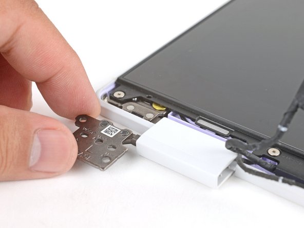

  42. Lift and remove both hinges from the Top Cover. Lift and remove both hinges from the Top Cover.
    • Lift and remove both hinges from the Top Cover.
  43. Congratulations on completing disassembly! The remaining steps will show how to reassemble your Framework Laptop.

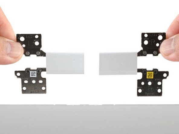

  44. Lay both hinges in place in the Top Cover. Use the alignment pins to help position each hinge in place. Use the alignment pins to help position each hinge in place.
    • Lay both hinges in place in the Top Cover.
    • Use the alignment pins to help position each hinge in place.

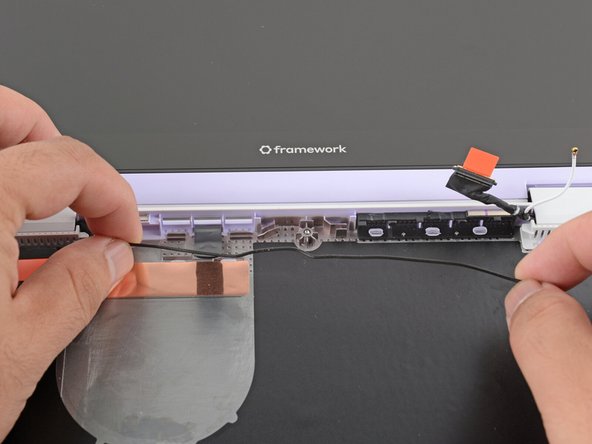

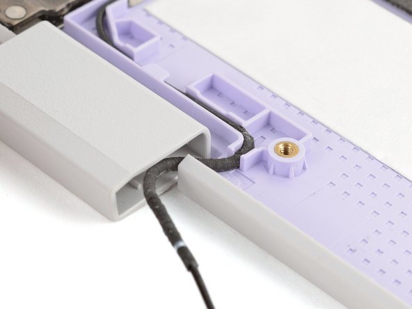

  45. Make sure both antenna cables are properly routed in the Top Cover and tucked into the hinges, as shown in the images. Make sure both antenna cables are properly routed in the Top Cover and tucked into the hinges, as shown in the images.
    • Make sure both antenna cables are properly routed in the Top Cover and tucked into the hinges, as shown in the images.
  46. Use your Framework Screwdriver to install the four 2.5 mm‑long T5 Torx screws to secure the two hinges to the Top Cover. Make sure to install these screws in the marked locations. There are additional screw holes on the hinges that are not for these screws.
    • Use your Framework Screwdriver to install the four 2.5 mm‑long T5 Torx screws to secure the two hinges to the Top Cover.
    • Make sure to install these screws in the marked locations. There are additional screw holes on the hinges that are not for these screws.
    • Make sure you don't accidentally install the silver lower hinge screws here. These screws should be gold colored.

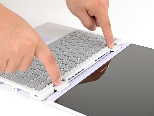

  50. Use your fingers to twist both hinge plates so they're flipped over the display. Use your fingers to twist both hinge plates so they're flipped over the display. Use your fingers to twist both hinge plates so they're flipped over the display.
    • Use your fingers to twist both hinge plates so they're flipped over the display.
  51. Place the cable clip around the right hinge cables, where they were bent from being inserted into the hinge. Use your fingers to press the clip into the hinge to secure the cables. Use your fingers to press the clip into the hinge to secure the cables.
    • Place the cable clip around the right hinge cables, where they were bent from being inserted into the hinge.
    • Use your fingers to press the clip into the hinge to secure the cables.
  52. Repeat the procedure on the left hinge to secure the left cables. Repeat the procedure on the left hinge to secure the left cables.
    • Repeat the procedure on the left hinge to secure the left cables.
  53. Make sure both cable clips are fully inserted into the hinges, so that they won't be snagged when the hinges pivot. Make sure both cable clips are fully inserted into the hinges, so that they won't be snagged when the hinges pivot.
    • Make sure both cable clips are fully inserted into the hinges, so that they won't be snagged when the hinges pivot.
  54. Use your fingers to twist both hinge plates so that they lay flat on your work surface. Use your fingers to twist both hinge plates so that they lay flat on your work surface. Use your fingers to twist both hinge plates so that they lay flat on your work surface.
    • Use your fingers to twist both hinge plates so that they lay flat on your work surface.
  55. Lay the Display Cover in place below the display. Use your finger to press along the length of the Display Cover to snap it onto the laptop. Use your finger to press along the length of the Display Cover to snap it onto the laptop.
    • Lay the Display Cover in place below the display.
    • Use your finger to press along the length of the Display Cover to snap it onto the laptop.
  56. Use your fingers to lift the Top Cover hinges over the Bottom Cover lip. Lay the hinges in place in the Bottom Cover. Use the plastic alignment pins to align each hinge in place.
    • Use your fingers to lift the Top Cover hinges over the Bottom Cover lip.
    • Lay the hinges in place in the Bottom Cover.
    • Use the plastic alignment pins to align each hinge in place.
  57. Use your Framework Screwdriver to install the six 4.5 mm‑long T5 Torx screws securing the two hinges. Use your Framework Screwdriver to install the six 4.5 mm‑long T5 Torx screws securing the two hinges.
    • Use your Framework Screwdriver to install the six 4.5 mm‑long T5 Torx screws securing the two hinges.
  58. Use your fingers to gently press the webcam cable into its plastic channel. Use your fingers to gently press the webcam cable into its plastic channel.
    • Use your fingers to gently press the webcam cable into its plastic channel.
  59. Use your fingers and your Framework Screwdriver to carefully press and guide the black antenna cable back into its channel. Zoom in on the second image to see how the antenna cable sits in its channel.
    • Use your fingers and your Framework Screwdriver to carefully press and guide the black antenna cable back into its channel.
    • Zoom in on the second image to see how the antenna cable sits in its channel.
  60. Press the black loop over the antenna cable and onto the Bottom Cover. If it doesn't stick, use a bit of thin double-sided tape to hold it down. Press the black loop over the antenna cable and onto the Bottom Cover. If it doesn't stick, use a bit of thin double-sided tape to hold it down.
    • Press the black loop over the antenna cable and onto the Bottom Cover. If it doesn't stick, use a bit of thin double-sided tape to hold it down.
  61. Carefully lay the Mainboard in the laptop. Use the two alignment pins to help align the Mainboard to the laptop.
    • Carefully lay the Mainboard in the laptop.
    • Use the two alignment pins to help align the Mainboard to the laptop.
    • Be careful not to trap the webcam, display, and antenna cables under the Mainboard as you set it in place.
  62. Use your Framework Screwdriver to tighten the five captive T5 Torx screws to secure the Mainboard.
    • Use your Framework Screwdriver to tighten the five captive T5 Torx screws to secure the Mainboard.
  63. Use your fingers to grab the orange tab on the display cable, located near the right hinge. Align and press the display cable straight down onto its connector.
    • Align and press the display cable straight down onto its connector.
  64. Use your fingers to grab the orange tab on the webcam cable, located near the left hinge. Align and press the webcam cable straight down onto its connector.
    • Align and press the webcam cable straight down onto its connector.

  76. Angle the bottom edge of the Input Cover towards the base of the laptop. Align and insert the bottom edge of the Input Cover into the base of the laptop. Make sure the slots along the bottom edge of the Input Cover slide into the tabs in the base.
    • Angle the bottom edge of the Input Cover towards the base of the laptop.
    • Align and insert the bottom edge of the Input Cover into the base of the laptop.

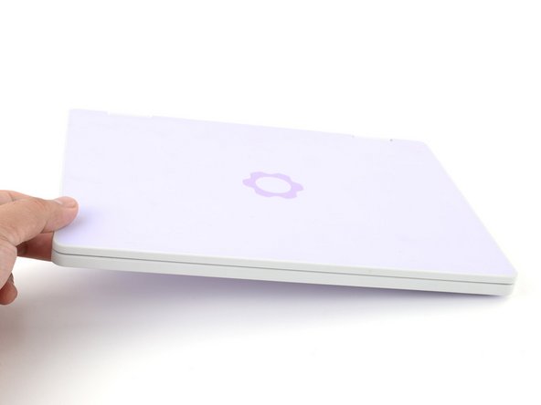

  77. Close the laptop lid. Flip your laptop face-down on a clean work surface.
    • Close the laptop lid.
    • Flip your laptop face-down on a clean work surface.
  78. Use your Framework Screwdriver to tighten the eight captive T5 Torx screws on the bottom of your laptop. Tighten the screws until they're snug. Don't over-tighten them, or you may strip the screws.
  79. Slide each Expansion Card into its Expansion Card slot. Slide each Expansion Card into its Expansion Card slot. Slide each Expansion Card into its Expansion Card slot.
    • Slide each Expansion Card into its Expansion Card slot.
  80. If there's a red bar showing under either Expansion Card latch, use your finger to flip the latch and lock the Expansion Card into its slot. Locking the Expansion Card slots helps keep the cards in place when you unplug cables from them.
    • If there's a red bar showing under either Expansion Card latch, use your finger to flip the latch and lock the Expansion Card into its slot.
    • Locking the Expansion Card slots helps keep the cards in place when you unplug cables from them.
