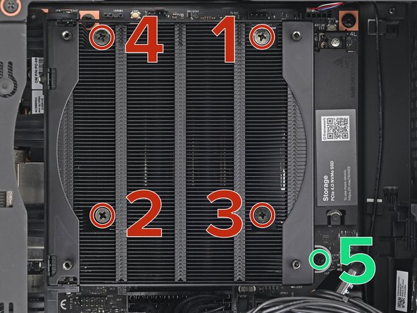

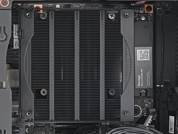

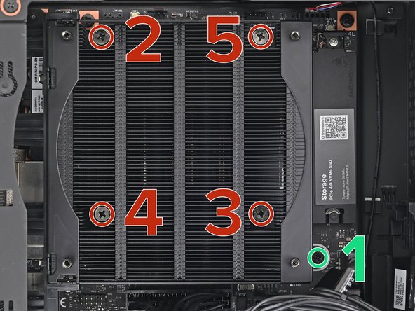

  14. Use your Framework Desktop Screwdriver to loosen the final captive Phillips screw jutting out under the Primary Storage. Use your Framework Desktop Screwdriver to loosen the four captive Phillips screws securing the Heatsink in an "X" pattern starting with the top left screw.
    • Use your Framework Desktop Screwdriver to loosen the final captive Phillips screw jutting out under the Primary Storage.
    • Use your Framework Desktop Screwdriver to loosen the four captive Phillips screws securing the Heatsink in an "X" pattern starting with the top left screw.
    • Only loosen the screws a few turns at a time to avoid applying uneven pressure to the APU.
    • In order: top left → bottom right → bottom left → top right

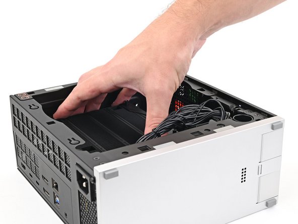

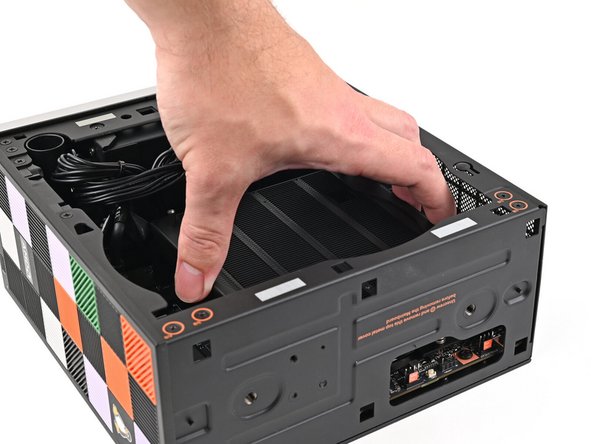

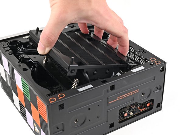

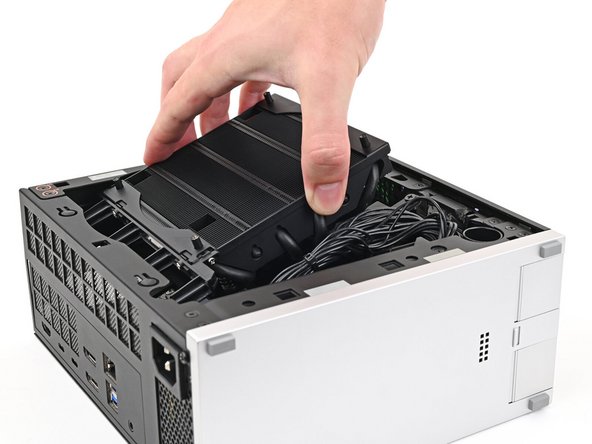

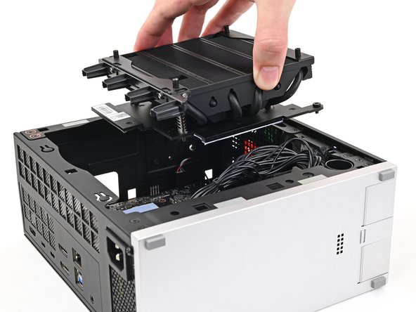

  15. Lift the Heatsink and tilt it up towards the front of the Desktop to navigate it out of the chassis. When handling the Heatsink, grab from the left and right sides (sides facing Front Panel & Back IO) as to prevent bent fins and possible damage to the Heatsink. Remove the Heatsink.
    • Lift the Heatsink and tilt it up towards the front of the Desktop to navigate it out of the chassis.
    • When handling the Heatsink, grab from the left and right sides (sides facing Front Panel & Back IO) as to prevent bent fins and possible damage to the Heatsink.
    • Remove the Heatsink.

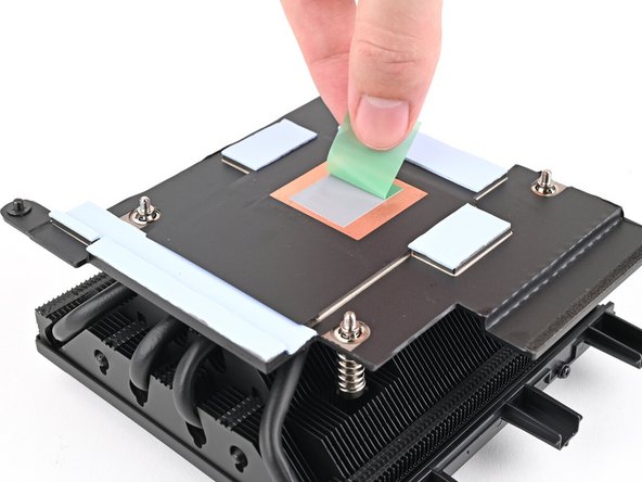

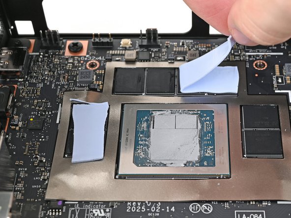

  16. There are two types of thermal pads in the Desktop: One thin, grey pad covering the back of the APU
    • There are two types of thermal pads in the Desktop:
    • One thin, grey pad covering the back of the APU
    • Four thicker, blue pads covering the memory and power management
    • Upon removing the Heatsink, the thicker pads will stick to either the bottom of the Heatsink or to the Mainboard. Since replacement Heatsinks come with pre-installed thermal pads, you just need to clean off the pads that remain on the Mainboard.
    • Follow the next two steps to remove the thermal pads remaining on the Mainboard.

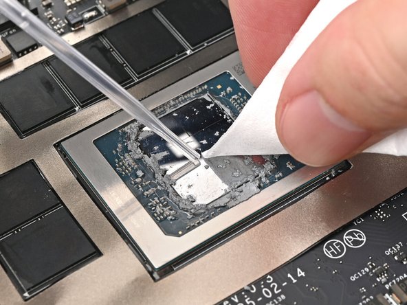

  17. Use your fingers to peel off the thermal pads from the memory and power management. Use your fingers to peel off the thermal pads from the memory and power management.
    • Use your fingers to peel off the thermal pads from the memory and power management.

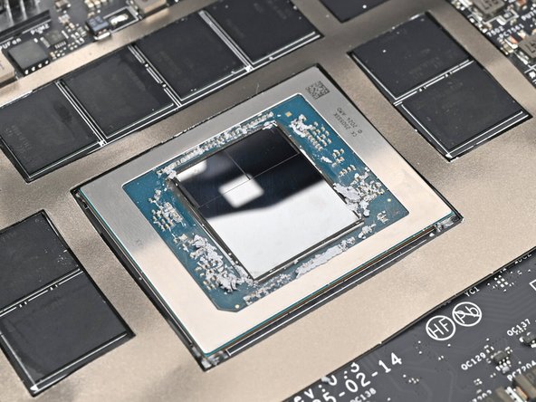

  18. Apply a few drops of isopropyl alcohol (>90%) to the APU and use a coffee filter or a lint-free cloth to wipe away any residue. Apply a few drops of isopropyl alcohol (>90%) to the APU and use a coffee filter or a lint-free cloth to wipe away any residue.
    • Apply a few drops of isopropyl alcohol (>90%) to the APU and use a coffee filter or a lint-free cloth to wipe away any residue.

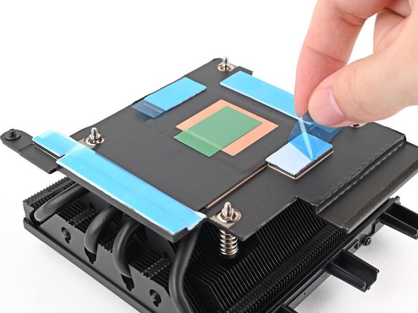

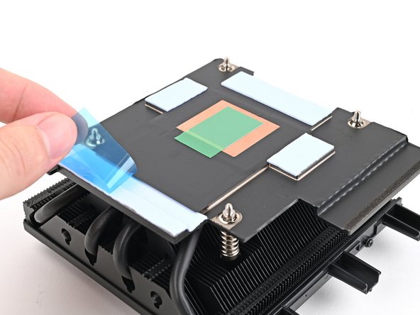

  20. Remove the liners covering the thermal pads on your replacement Heatsink. Remove the liners covering the thermal pads on your replacement Heatsink. Remove the liners covering the thermal pads on your replacement Heatsink.
    • Remove the liners covering the thermal pads on your replacement Heatsink.

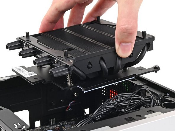

  21. Tilt the Heatsink down towards the rear of the Desktop and place it into its slot on the Mainboard. When handling the Heatsink, grab from the left and right sides (sides facing Front Panel & Back IO) as to prevent bent fins and possible damage to the Heatsink.
    • Tilt the Heatsink down towards the rear of the Desktop and place it into its slot on the Mainboard.
  22. Use your Framework Desktop Screwdriver to tighten the four captive Phillips screws securing the Heatsink in an "X" pattern starting with the top right screw. Only tighten the screws a few turns at a time to evenly compress the APU and thermal pads.
    • Use your Framework Desktop Screwdriver to tighten the four captive Phillips screws securing the Heatsink in an "X" pattern starting with the top right screw.
    • Only tighten the screws a few turns at a time to evenly compress the APU and thermal pads.
    • In order: top right → bottom left → bottom right → top left
    • Use your Framework Desktop Screwdriver to tighten the captive Phillips screw jutting out under the Primary Storage.
