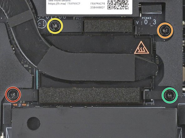

  7. Use your Framework Screwdriver to loosen the four captive Torx T5 screws securing the Heatsink.
    • Use your Framework Screwdriver to loosen the four captive Torx T5 screws securing the Heatsink.

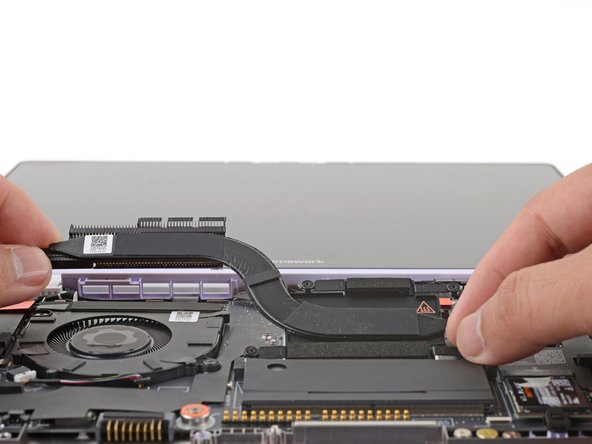

  8. Slide the flat end of your Framework Screwdriver under the Heatsink arm labeled "2". Twist the Framework Screwdriver to lift the Heatsink arm and loosen the Heatsink. You'll feel some resistance from the thermal compound holding the Heatsink in place.
    • Slide the flat end of your Framework Screwdriver under the Heatsink arm labeled "2".
    • Twist the Framework Screwdriver to lift the Heatsink arm and loosen the Heatsink.
    • You'll feel some resistance from the thermal compound holding the Heatsink in place.
    • If the Heatsink won't budge, make sure you've fully loosened the four screws securing the Heatsink.
    • Repeat the procedure with the Heatsink arm labeled "3".

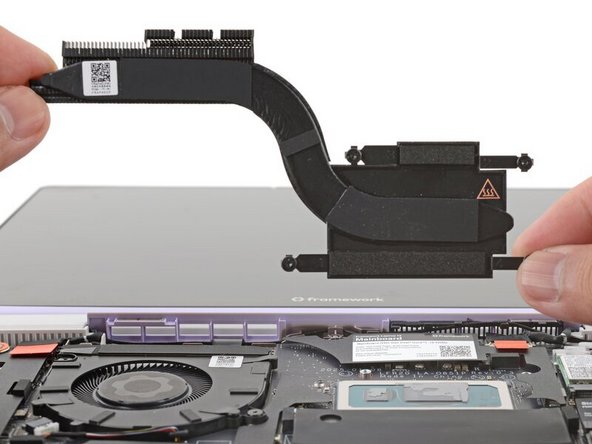

  9. Lift and remove the Heatsink. Lift and remove the Heatsink.
    • Lift and remove the Heatsink.

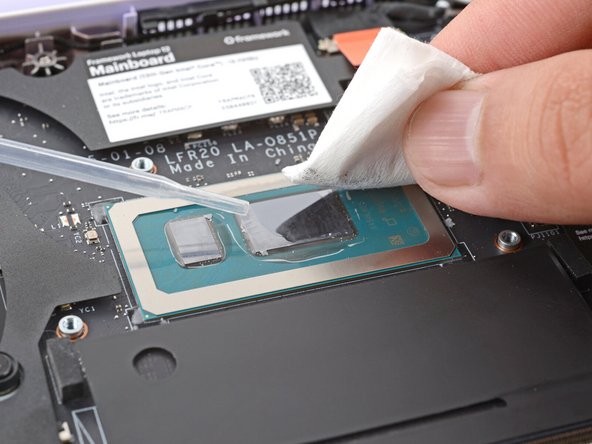

  11. Use a few drops of high concentration (>90%) isopropyl alcohol and a lint-free cloth to wipe away the remaining residue from the processor.
    • Use a few drops of high concentration (>90%) isopropyl alcohol and a lint-free cloth to wipe away the remaining residue from the processor.

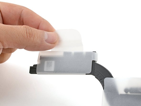

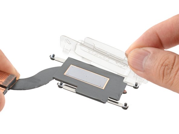

  12. Unwrap the replacement Heatsink and remove the clear plastic cover. Be careful not to touch the gray thermal compound on the Heatsink.
    • Unwrap the replacement Heatsink and remove the clear plastic cover.
    • Be careful not to touch the gray thermal compound on the Heatsink.
  13. Carefully align and lay the Heatsink over the processor. Use your Framework Screwdriver to gradually tighten the Heatsink screws in the marked order until they're snug:
    • Carefully align and lay the Heatsink over the processor.
    • Use your Framework Screwdriver to gradually tighten the Heatsink screws in the marked order until they're snug:
    • First screw
    • Second screw
    • Third screw
    • Fourth screw, then back to the first
    • This helps compress the thermal compound evenly under the Heatsink and apply even pressure over the processor.
